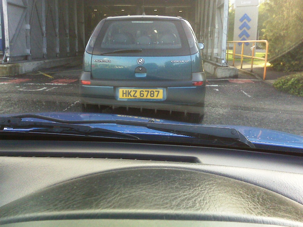

saucedoctor Posted April 5, 2014 Share Posted April 5, 2014 Very different. All computerised, all mechanised. Car gets lifted up in the air about 10 feet, suspension gets a workout. Looks really violent, actually. A couple of years ago when I was up, the Corsa that went in ahead of me had bits falling off it during the suspension test. I could hear them hitting the floor of the Test Hall. Bits of springs included! Here is said Corsa. You can sort of get an idea of the size of the place. This is at Larne, Co. Antrim. The One at Belfast Balmoral is a monster, way bigger. (I have a better pic somewhere, I'll dig it out and attach it later) brickwall 1 Link to comment Share on other sites More sharing options...
saucedoctor Posted April 5, 2014 Share Posted April 5, 2014 Here's the other pic. You can see here in the foreground the ramp in its retracted position. There's a pit under it as well. The padded bit lifts the car by its chassis, and the tester does his poking around. Then the red plates come up and touch the tyres, and it's at this point there's a whole lotta shakin goin on. The first time I saw it I was shitting myself - I thought my car was gonna fall off! Testing order is (roughly) 1. Drive in. Bloke tells you to stop, stuff the probe up the exhaust.2. Drive forward a bit more. Bloke tells you to do all the lights, sound the horn, washers/wipers. Headlight alignment checked.3. Bloke gets a look under the bonnet, opens the passenger door and tries the seatbelts.4. Driver is told to get out and take a seat behind the rail.They do the rest themselves: brakes, thorough poke about underneath, pull on the exhaust etc. Then the chap manipulates the steering by pulling on the roadwheels. Then they shake it up. Grundig, Barry Cade and brickwall 3 Link to comment Share on other sites More sharing options...

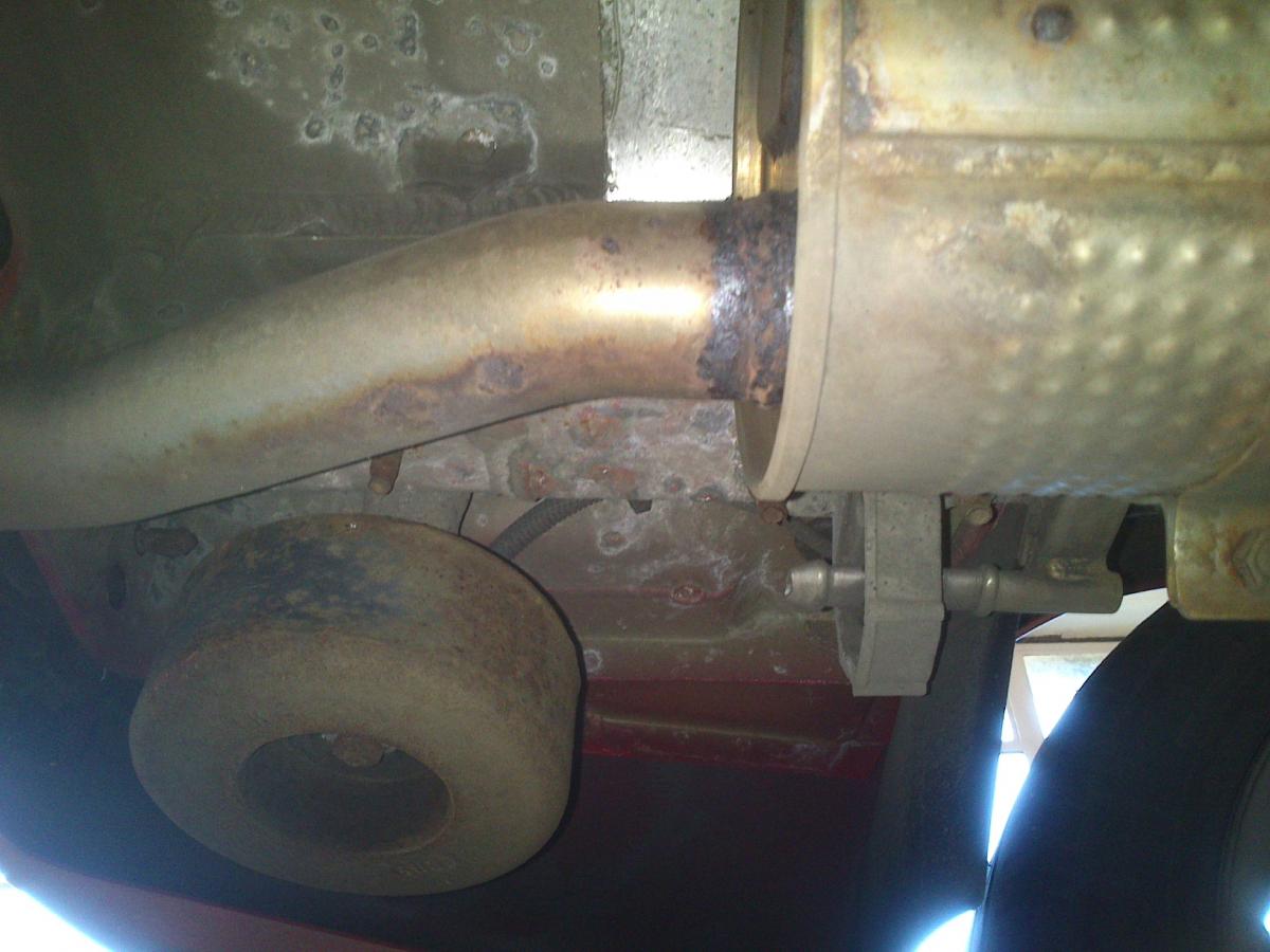

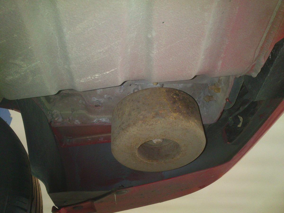

Barry Cade Posted April 8, 2014 Author Share Posted April 8, 2014 Fairly quiet with MOT's today- Mazda 2 which failed on a rear wheel bearing, and another pair of badly cracked tyres, showing cords. Toyo's this time. Took a pic, but my phone is SHITE. Then a 307CC- don't know if I've mentioned this before, but they have huge lumps of metal bolted in the corners just in front of the back bumper, and comedy bracing right along the floor. Love to hear opinions on why.... Phone actually worked for this one. KruJoe, mat_the_cat and drum 3 Link to comment Share on other sites More sharing options...
Negative Creep Posted April 8, 2014 Share Posted April 8, 2014 Same reason that main beam lamps didn't used to be part of the test- you are looking forwards, so should be able to see if they are on or not! Juding by the number of people I see with no lights on at night, I wouldn't be so sure Charlie Croker and Barry Cade 2 Link to comment Share on other sites More sharing options...
Bobthebeard Posted April 8, 2014 Share Posted April 8, 2014 Fairly quiet with MOT's today- Mazda 2 which failed on a rear wheel bearing, and another pair of badly cracked tyres, showing cords. Toyo's this time. Took a pic, but my phone is SHITE. Then a 307CC- don't know if I've mentioned this before, but they have huge lumps of metal bolted in the corners just in front of the back bumper, and comedy bracing right along the floor. Love to hear opinions on why.... Phone actually worked for this one.WTF?Those big lumps of metal....Some sort of attempt to reduce vibration or resonance in the floorpan? Albert Ross 1 Link to comment Share on other sites More sharing options...
brickwall Posted April 8, 2014 Share Posted April 8, 2014 I was just about to ask about the round things. Ballast? Link to comment Share on other sites More sharing options...
