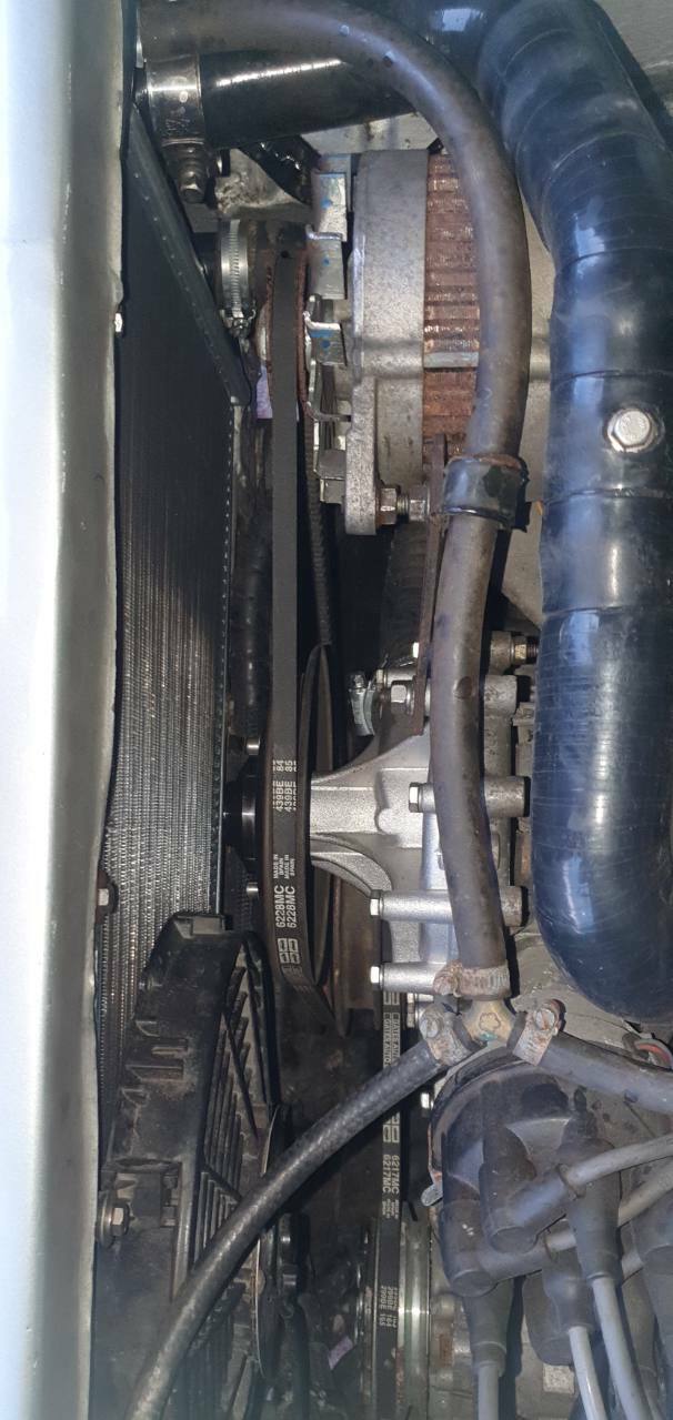

A quick Google suggest the pumps you have would rotate ACW as we look at your pictures, so clockwise as you look at them fitted to the engine
12 hours ago, mat_the_cat said:
I think what I've done is use a pump as fitted to a Discovery serpentine belt model, which drives the pump from the back of the belt - hence designed to be spun anticlockwise.
1 hour ago, bunglebus said:
A quick Google suggest the pumps you have would rotate ACW as we look at your pictures, so clockwise as you look at them fitted to the engine.
Yep, you're right - I'm a numpty. All I had to do was look at one of the two serpentine belt Rover V8s I have here, and the pump is clearly different. So that's a relief in a way that I haven't been completely stupid, but still doesn't explain my apparent reversed circulation.

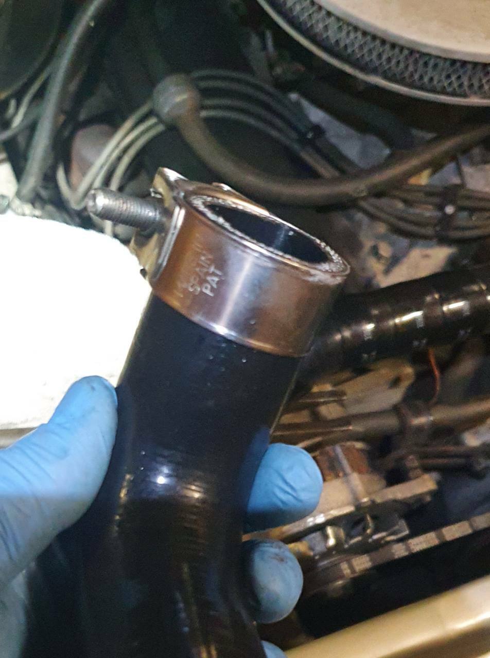

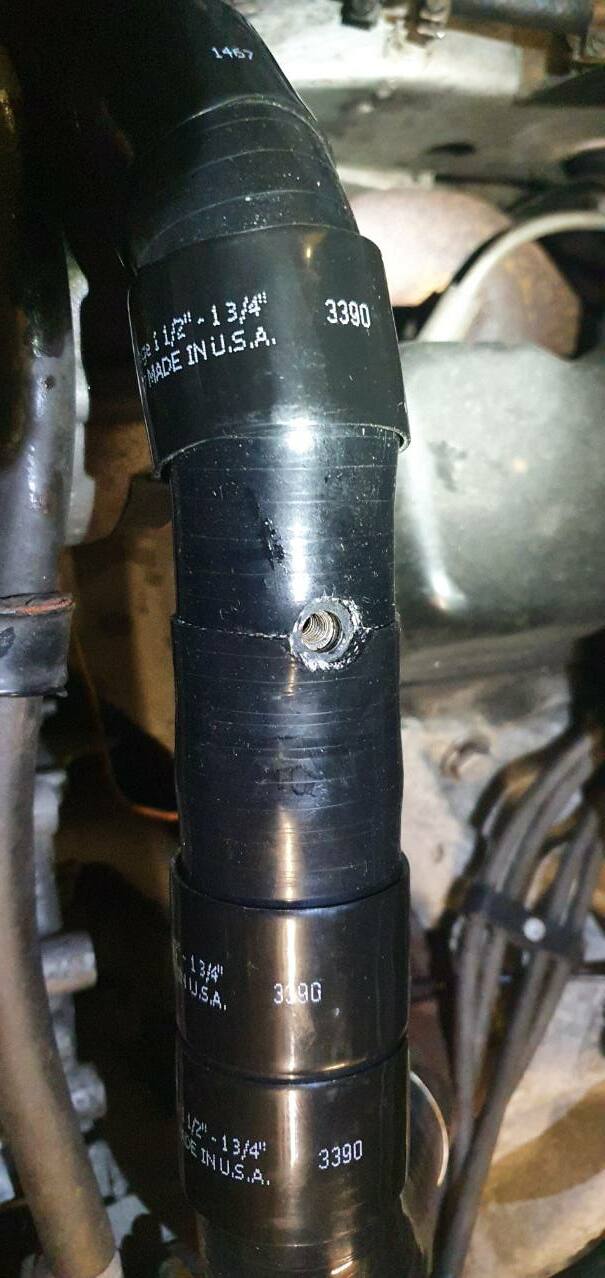

But I still wanted to have the appearance of a factory fit, one-piece hose. So I notched the ends of the hoses to fit around the screw:
I also had to replace a hose, as it had been partly eaten by the alternator fan. There's clearance when the engine is running, but obviously things must shift around under load. A new hose was cut down to fit:
Using a hose clip to try and get as straight an edge as possible, seeing as I don't own a hose cutter.
I then shrunk all the hose 'clamps', and scuffed them up to remove the in your face writing.

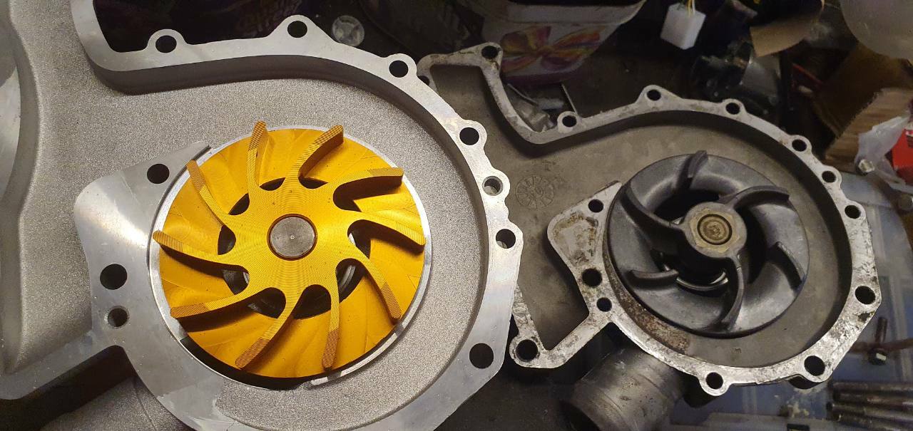

I'd planned to carry out more measuring before making any changes to the cooling system. But I just haven't got round to it yet, and with FOTU less than a week away I'm running out of time. It seems very unlikely to be a clogged rad, but the gradual deterioration does seem to be pointing that way.
So seeing as I had one, I thought I had better fit that, as I'm not confident there won't be a repeat of the queues of last year. Although ideally I'd only make one change at once, seeing as the water pump needs to come off to change the rad, I don't really fancy putting the old one back on.
Here's the difference in impellor design.
As well as more vanes, there is less clearance between them and the pump housing. Trade-off will be more power lost in pumping, but hopefully that's liveable with...
I've modified it by pushing the pulley hub on further (as the factory did with the MG RV8), so it's ready to go on once the radiator is in.
I've removed the old one, but just need to trim the new to fit it in the space available. There was a surprising amount of silty coolant drained, especially considering it's only been in for 3 years.

Yes, I even owned one for a while in the early days of the project. But at the time, the rated lifespan put me off so I sold it.
Running it at idle along with 3 cooling fans would be quite an electrical load though, over 40 amps! So that's another factor which is putting me off at the moment.

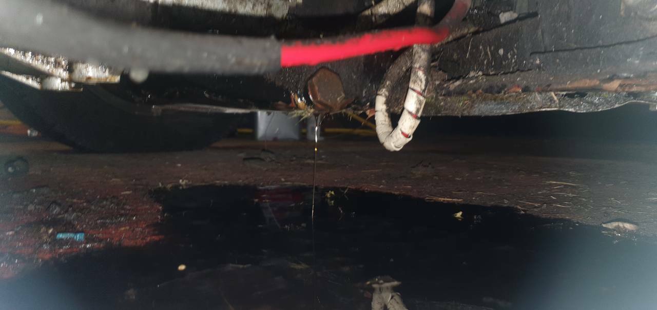

Fuck. Hit the sump on our track tonight and in a hurry so didn't stop to check for damage. Done it before and no harm done, but it's developed a nasty top end rattle. Stopped and it was pouring out, but still oil pressure despite a death clatter!??

It looks to have cracked the boss around the drain plug, so in theory an easy repair however there's no way to remove the sump in situ. It's either engine out, or more likely support the engine and drop the front crossmember. Honestly, who'd design it like that?!
The tappets need about 5-10psi minimum to stop being noisy.
If you drove for a distance then they'll start to pump down and the engine will begin to run like a sack of spanners, accentuating the rattles and bangs.
Pressure gauge is only at the pump, don't forget.  Once you fall below their pump down pressure the tappets will be noisy, particularly if you've revved the engine up a bit.
