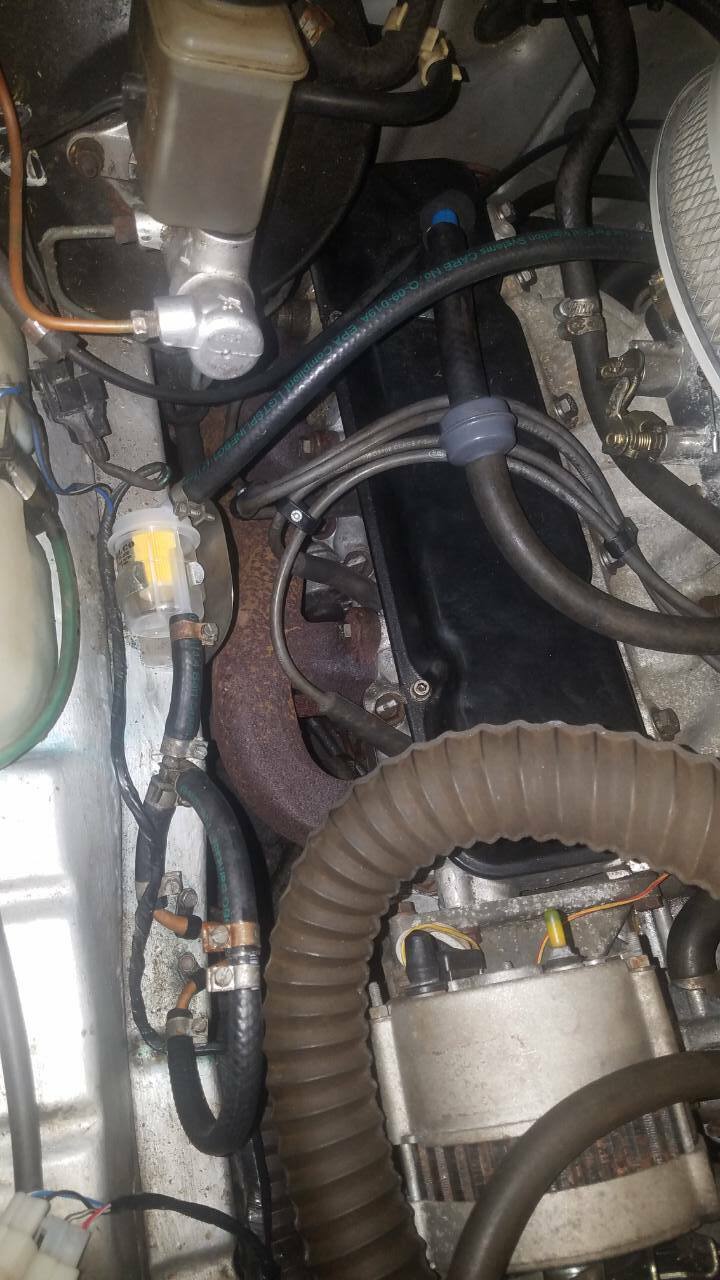

Now that winter is here, I've taken this off the road for now, and time for a bit of tinkering. Main job is the gearbox leak, but I also need to replace the fuel hoses!
That's after 18 months of use :-o I've gone for Gates Barricade hose this time as, like the name suggests, it has a liner which is resistant to the ethanol content in modern petrol.

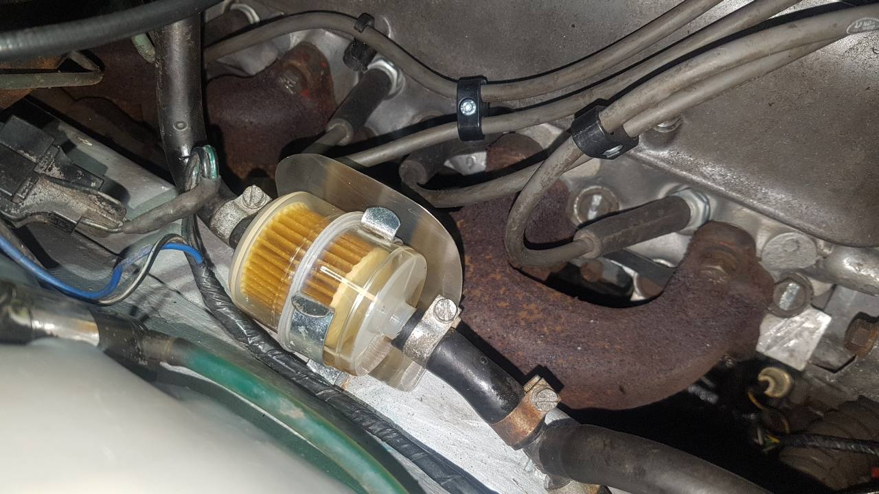

I also needed to replace the fuel filter, but instead of replacing with the same straight through type, I reckoned a right angled filter would look neater, as well as routing the outlet hose slightly further away from the exhaust manifold.
Inlinefilters.co.uk (unsurprisingly) have a large range, so I picked out one of similar dimensions so it would fit my existing clip, and with an 8mm inlet & outlet. It was ironic that after I bought it, I saw the list of vehicle applications!
It was then the simple job of plumbing it all together - that's better :-)

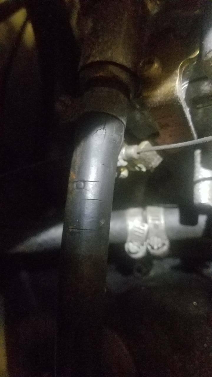

That was my first thought too, and I've yet to rule it out. But the pump seal failure was definitely not due to pressure!
Yes, that's a spring in there! What I believe has happened on both top and bottom hoses is that the springs (designed to stop the universal corrugated hoses from collapsing) have moved. In doing so damaged a hose, before wrecking the water pump. It was a pinhole rather than a rupture in the hose.
Of course, I only realised this after I'd bought a pair of new hoses...

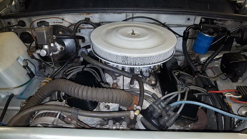

So, I'm not keen to build in a potential failure mode, and I've also never been overjoyed with the obvious non-OE appearance of the coolant hoses.
Trouble is, nowhere lists an option for a V8 converted Hyundai Stellar for some reason. So I've been thinking about alternatives. I'm really not keen on the typical 'dressed up' engine bay...
57-1478_installed_2365cdf3-4799-42ae-953c-652ccc32b380_1200x.thumb.jpg.8061ed2af6a06ef2ddcc90ef114ee213.jpg
So plain old black silicone hoses were ordered, and cut up to suit.
I'm pretty pleased with the way this is looking now, although I've always worried about how close the alternator fan runs to the hose!
I don't want the hose joins to be covered with a collection of messy looking hose clips (not very OE) but I think I have a cunning plan for that...
  • Like 14

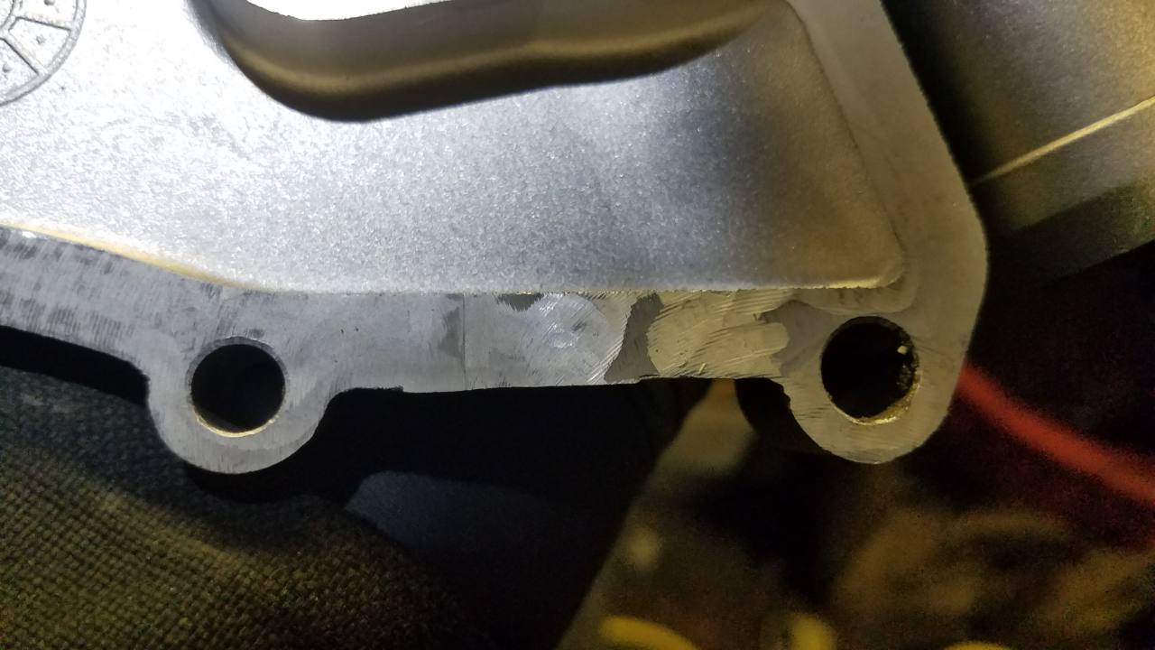

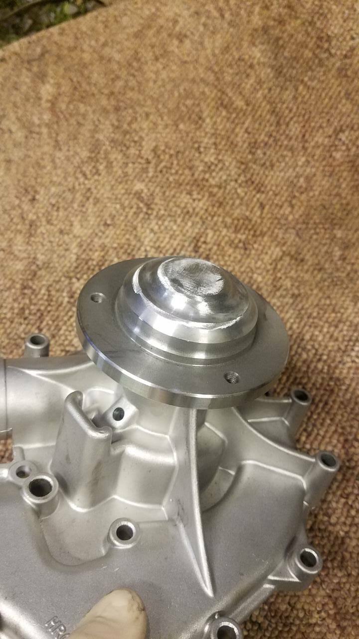

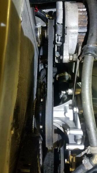

Onto the water pump replacement then, and having worked in their manufacture, I'm well aware of the quality of some of the pattern parts out there. So splashed out on an OEM pump from a well known supplier - at £60 twice the price of a cheapie, although a fifth of a genuine LR pump. First impressions were not great.
Still, I figured it would seal ok, so set about modifying it to suit. To give enough clearance for the radiator, I have to shorten the nose of the pump, which involves pressing the pulley hub on 11mm further. I took it to my local garage, and they let me borrow their press to do the job.
The threaded part was previously in line with the shaft. Now, if I use a Rover SD1 pulley instead of the Land Rover original, this puts the belt nicely in line. Luckily the fixing PCD is the same.
Excess trimmed off and tidied up (pre-paint):
It was at this point I noticed the next problem.
The holes were so badly finished that the bolts would not even pass through! Hardly difficult to drill out, but worrying it's got to me like that. At least the bearing is a decent quality brand, and hopefully the seal too.
