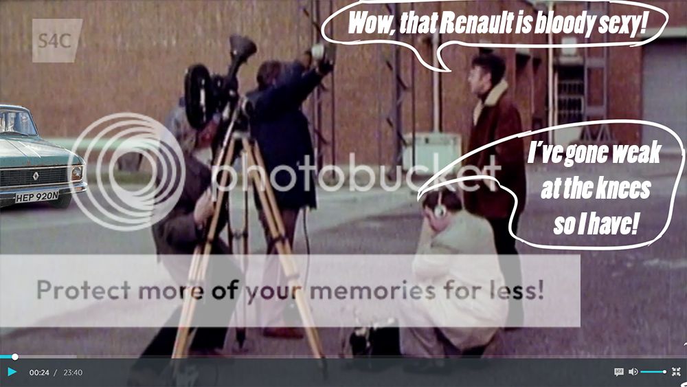

There is a series on S4C at the moment, Cymru ar Ffilm (Wales on film) that is one of these clips from the archives of local news/magazine programs showing us day to day life in the old days.
On the opening credits there is a glimpse of a metallic green square light 6, at least that's what OI think it is, parked behind a film crew.
I like to believe that it is this very car.
Here is the (slightly blurred) screenshot of the opening credits. Do you know I think Louise is right, I can sort of make out the 'HEP' at the start of the plate.
 Watching in HD with subtitles reveals this:

I'm going to happily go along with Louise's and greengartside's excellent sleuthing and assume this car is a famous television personality.  It's entirely likely it is as well, that's the brilliant thing, providing the film is from somewhere between April 1975 and December 1993
Doubleyeller:  Â£450 for the Princess with MoT in 2012.  I couldn't buy the same car for the same money now if it came up for sale so I'm glad I bought it when I did!  The Rustoleum is about £8 a tin, you can sometimes get cheaper bulk orders on eBay.  It does need lacquer as it can fade without it.  You need at least 2 tins of colour per panel, I'd recommend 4 for best coverage, it can therefore be a bit pricey.  For me it works since I'm doing things piecemeal and can spread the cost out further.  As a rough estimate, 13 panels (wing x2, front valance, bonnet, roof, door x4, rear wing x2, boot lid, rear valance) at £16-32 per panel is £208-416.  Plus whatever lacquer you put on and any primer, filler and sandpaper of course.  Rustoleum is compatible with most acrylic paints, I've not had it react with anything I've used yet that's acrylic based.
