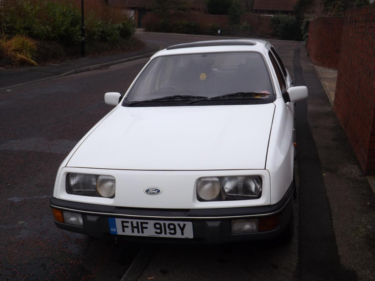

Y plate Sierra Ghia. A little prang.

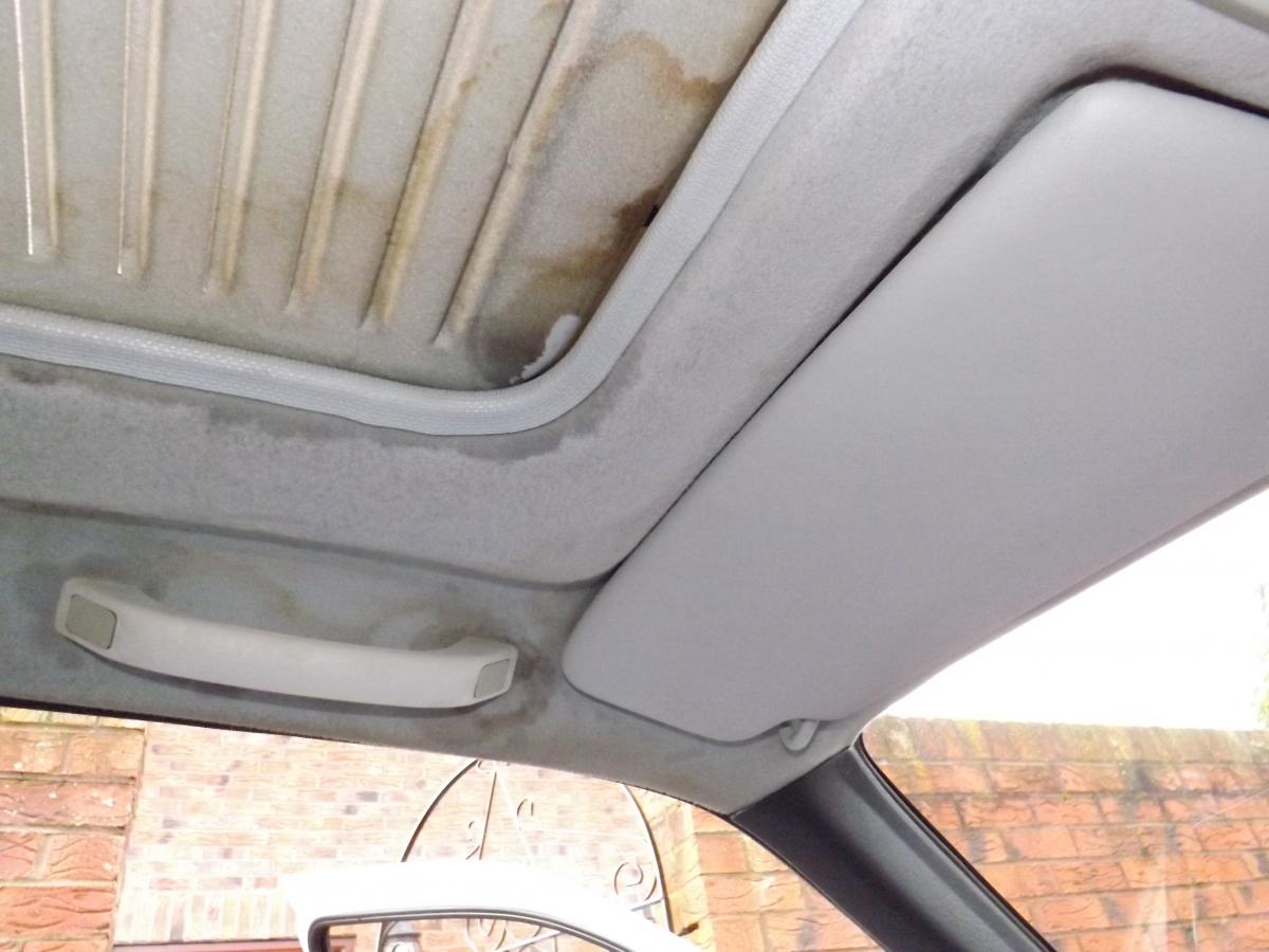

The stains are water thats leaked in around the sunroof
Yeah, that's what I thought as well but thankfully I have experienced no water ingress - so far. The rest is almost definitely nicotine though as all the plastic trims have that telltale grubby patina.
Thanks for the tips about the headlining, guys, I really could have knackered it if I had just gone at it as planned!!

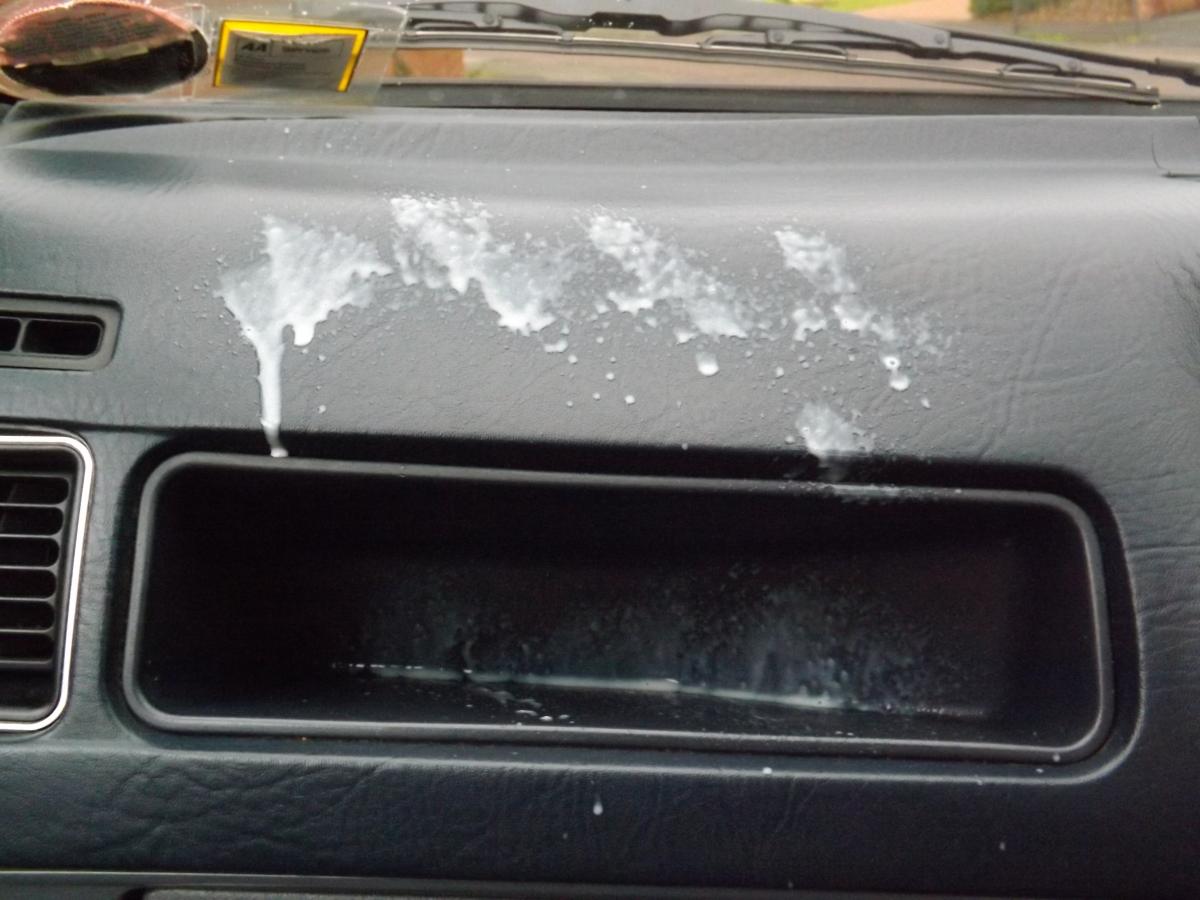

From Halfords picked up some Turtle Wax dry foam upholstery cleaner and some goo for the plastics. After being suitably warned about the Sierras head lining by fordperv and Stixy I thought I would give it a go with some foam sprayed onto a micro fibre towel and just the lightest of touches ...
No.
This happened within minutes.
Feck.

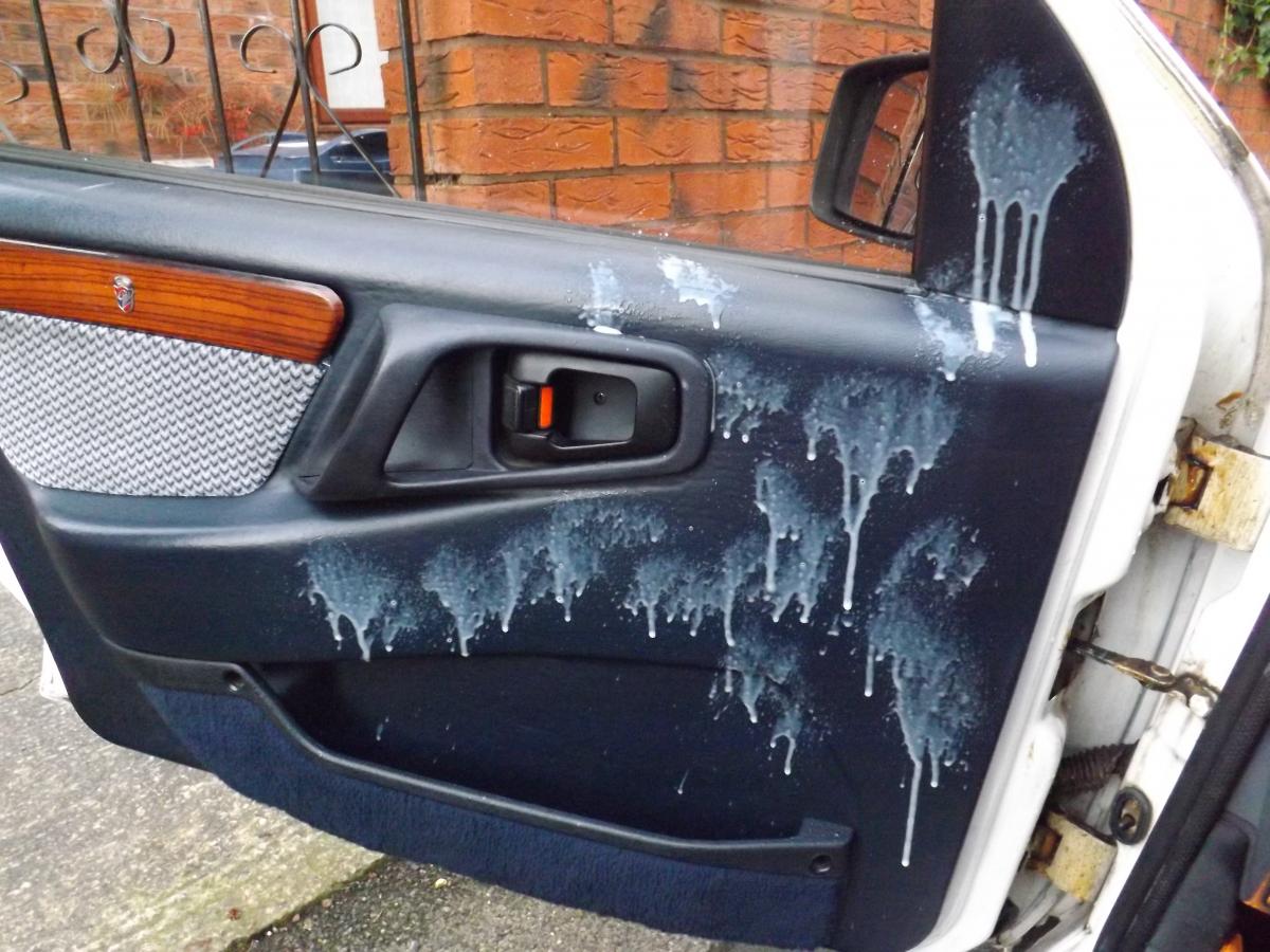

What is worse though is that the foam stuff was great, too! On the plus side I was able to use it on the velour and carpet trim on the doors. The driver armrest in particular had a big greasy patch which this stuff shifted with just a quick wipe over. Great stuff!

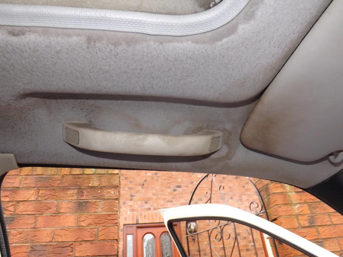

Is there any way of rescuing baggy headliner?
I'm thinking some sort of spray glue - poke a little hole in the headliner, stick a little bit of spray glue in using an aerosol and a thin pipe (like WD40 but stickier) and hold it up for a bit. You'd have to hope that the hole you poked wasn't noticable though.
Or maybe for that bit, lever off one of the handle blanking plates and insert a tube that way.
No unfortunatly this ends in disaster with even more baggy headlining ( tried it ) , the only answer really is either replace or re-cover it
Had exactly this on both my Jags and my Mk1 827. Hateful stuff.
on ebay i picked up 2m of 54" wide, grey foam backed material for £10 all in and bought a litre of high temp brush on contact adhesive £15 (it must be brush on high temp as spray on shits itself on a hot day) and re did mine, if you do trim yours just be careful when removing the old material from the fibre board as no doubt the board will be brittle mine was and had broke down in a couple of places at the rear (you can see on the picture what looks like dents on the rear edge of the headliner) but that didnt fuss me to much as it looked 500% better when done than it looked before with its staining and baggyness
theres a couple of places around where the sunviser's tuck into where it didnt quite stick at first because of the shape which i sorted after i took this picture with a bit of pressure and heat
