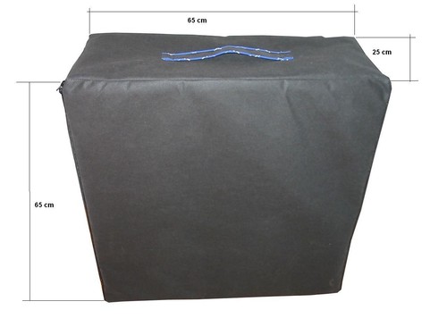

Do you have somewhere to stash the mattresses?
Those beds fold up into a block like so...
$T2eC16JHJGYE9nooiM5!BQVvBTC1GQ~~60_12.J
I got a couple of them - they can be stuffed on top of the box in the back, or just left on the back seat.
