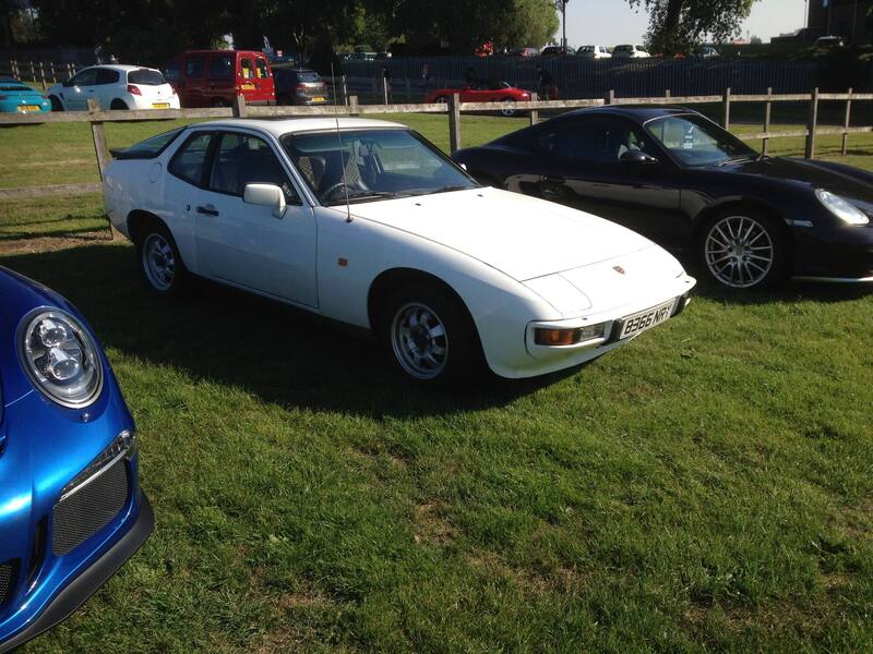

September 2018
It was finally back together the night before so I drove it over to BH and parked up amongst the proper Porsches. I thought it looked nice and I was very pleased with the summer’s work.
Slim sexy car surrounded by big bloaty blobs:
Or maybe I should have left it as it was...
