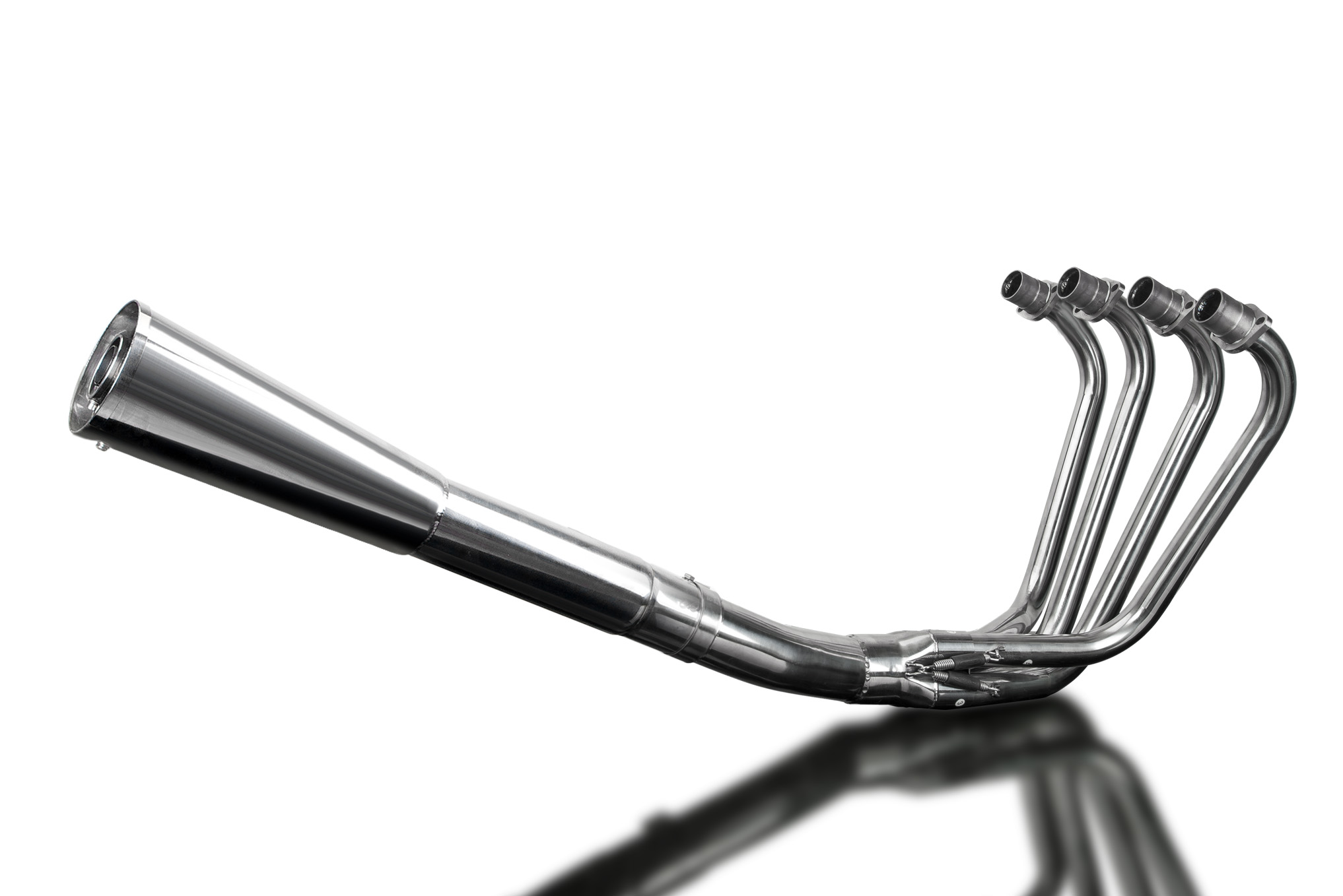

Where is it rotten? If it's just the silencers you could fit generic pattern items. Motad used to be good for after market systems - I have one on my cb900
It's rotten in the collector area and then also blowing at the back/underside end of the silencer.
I've got a Motad Nexxus system on my 86 GSX-R.
The trouble with the Zephyr Motad system, is that it looks like the crappy styles from back in the day but as mentioned above they did go bust earlier. Looks like £330+ for one if available or if you prefer EU pricing levels, £600 will get you this:
https://www.ebay.co.uk/itm/MOTAD-Auspuff-Exhaust-Kawasaki-ZR-550-Zephyr-91-99-ZR550B-Edelstahl-INOX-NEW-/262755537307
There's not a bad looking system made by Delkevic but don't see a 550 variant on sale...
Motad went tits up didn't they?
Have you tried Blackwidow, formerly Sandy Bike Spares? Not listed but worth a call.

Feck! For that money I would be wanting another bike! How about having a system made up for it?
After I get the bike on Monday, I'll see about taking the exhaust off to have a better look. Was speaking with one of my pals that thinks brazing might be an option for it.
When I had a look at the bike last night, the collector area wasn't as crispy as I was expecting. That opinion might be revised once it's removed from the bike of course...
Thing is, the bike is generally very corrosion free, everywhere else, the exhausts must be very low grade to begin with.
