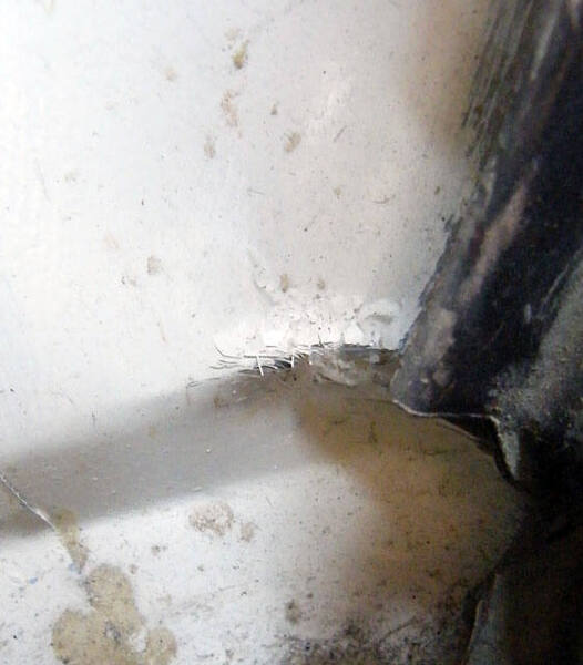

I think the leak is coming from the seam on the top side of the boot as I noticed some sort of grey paste has been applied badly in an area suspiciously close to where I've seen the water in the boot, noticed this when I was rummaging around getting stuff out of the boot after doing a bit of shopping today.

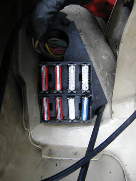

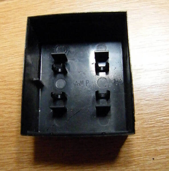

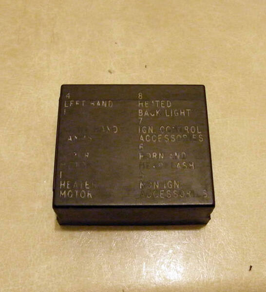

Next, I wanted to find out why that washer jet pump had stopped working. First stop was the fuse box.
All present and correct, so it's not that. Worth noting that I've brought the cover in and I'll be filling in all the letters anew with white paint which is a job I've been putting off for no good reason.
It's quite neat that on the back of the fuse box cover there are clips to hold spare fuses in the likely event that the ones in there fail.
Perplexed, I turned the motor around on the side of the washer bottle and noticed the plug was loose. Pushed it back on properly and hey presto, my washer jets work again. That was easy.

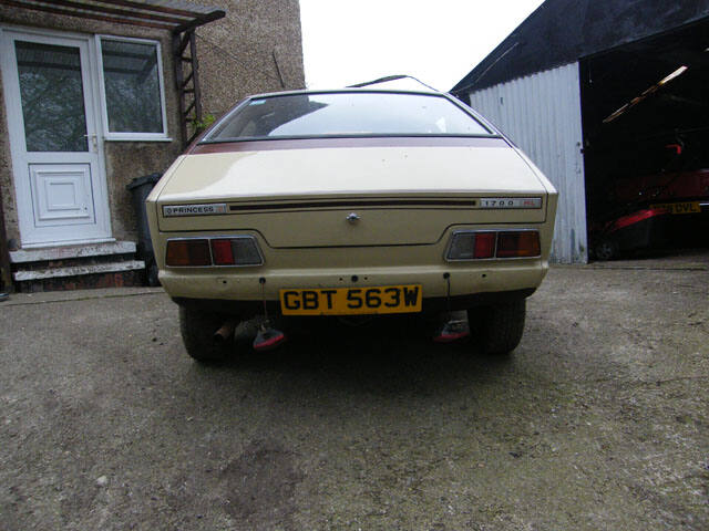

What I started off doing today was some exploratory demolition of a flower bed which, before I began, looked something like this (photograph taken last year, but it shows what was there well enough). Bear with me, there is a reason for showing off my manly* rock moving skills.
After much grunt work, I'd uncovered a big concrete slab. I'll extend this a bit and reuse the big rocks to build a new retaining wall before more digging and demolition, possibly moving the shed too, so we can plonk a small single garage here. The reason for doing this job first was to get the little cars out of the way a bit.
As you can see, there's still a skinny line of dirt and rocks to remove, but it was getting on and I was just about done from all that lugging.

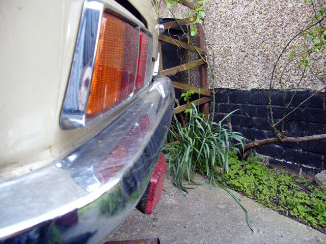

Next thing was to see if I could get the Princess at least a bit out of the way using this space. I knew I probably couldn't, but it didn't hurt to try.
Once that wall is down and the new wall built to the left, the Princess will just squeeze on there, which means either the Polo or my housemate's Peugeot will both sit on there very happily and it gives me some flat working space at home.
However, I knew it wasn't ideal for my housemate when he got back from work so I thought I'd put the Princess back in her usual spot, but for some reason decided to reverse her in instead of driving her in... which is when I hit the house. You'd think nobody could be that special, but here I am, licking windows.

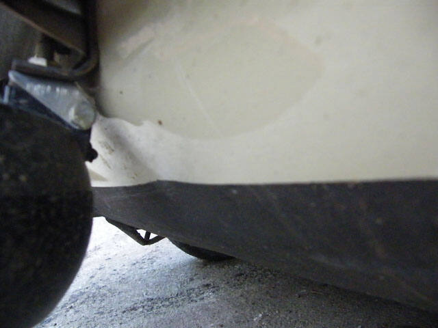

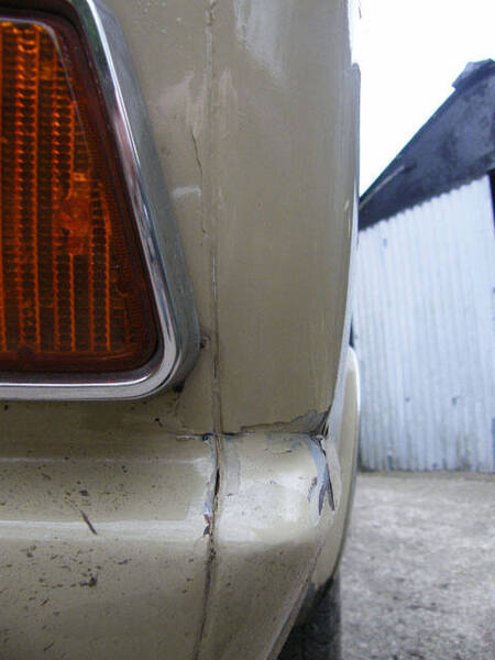

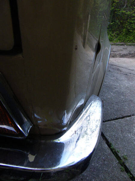

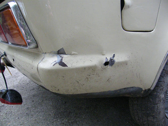

Turned her around to assess the damage a bit better. Swore at myself a few times, then at the car, then apologised to the car, then realised I was talking to myself...
So, that's the best panel on the car now dented, well done me. When I said I was going to spend my week off working on my cars, this is not what I had in mind. Best of all, it's a bank holiday so I can't go and get any grey primer to sort out that panel until Tuesday. Bumper off tomorrow to inspect the damage properly and see what I can do about the shallow dents I've gained. Shame about the inverted pimple on the bumper corner, up until now that's been a really good bumper and I've probably wrecked it now.
I am not happy with myself, this was a really stupid thing to have done.

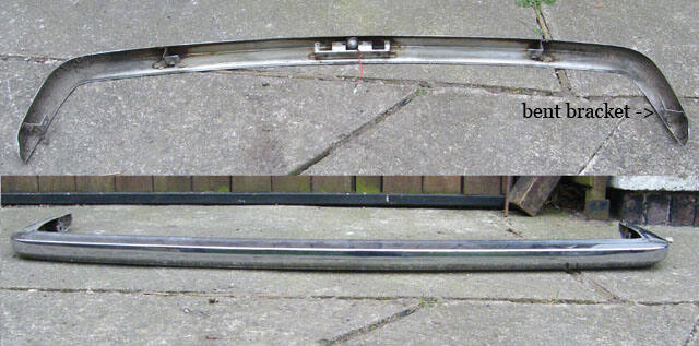

That bracket picture is super useful! My bracket only had half the metal left and that was the half attached to the exhaust so I'll definitely be knocking a replacement up and now I have a decent guide to go off for what to make. I'm not really using the car at the moment, lack of petrol, lack of funds and waiting for parts to arrive mean that I'm focusing more on getting that new hard standing area tidied up so I can do maintenance at home rather than having to drive to my parents for the flat space there.

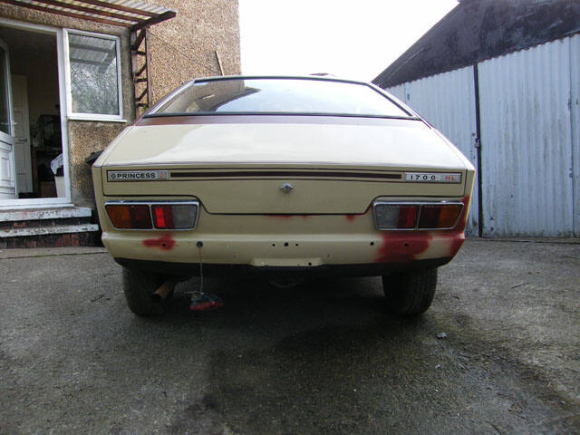

This is the week I hope to achieve many things, not least getting my exhaust to stop blowing, then fitting the new gaiter... then it's all cosmetic really which just takes a lot of time and not too much money doing it the sensitive restoration sort of a way I'm going. At least I now know better than to reverse onto the driveway in this car.

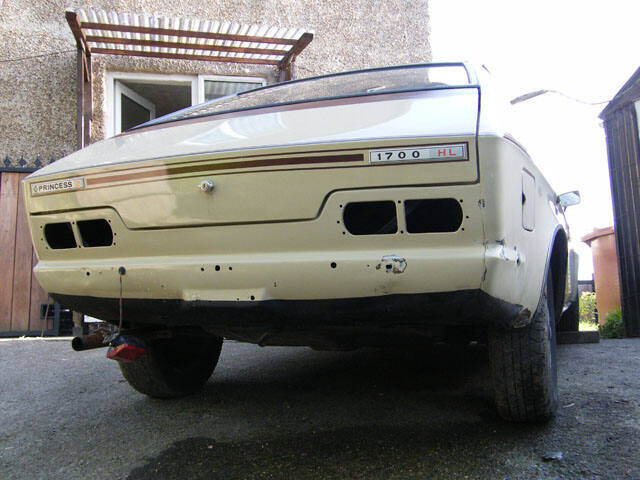

Today I decided to have a look at what I'd actually done to the car. It's nowhere near as bad as I thought, as I had been reassured by other readers, so that's a good thing.

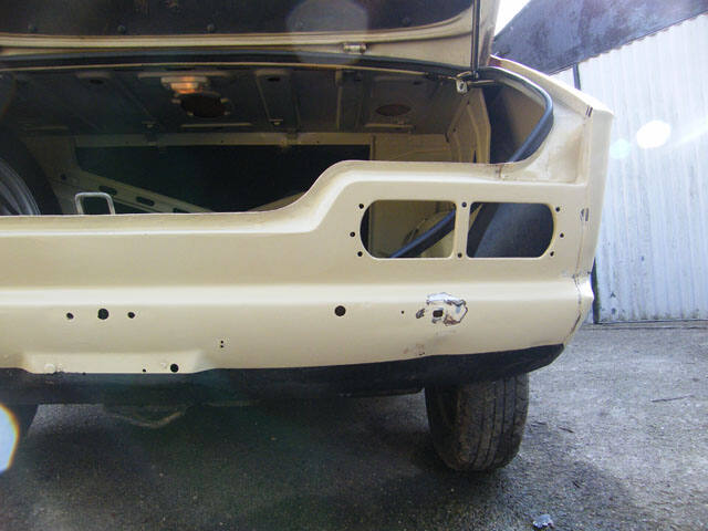

First job was to remove the bumper. Two 14mm bolts on the side which were quite stiff and two 13mm bolts in the middle which weren't. The twist in the bumper untwisted as soon as the driver's side bolt was undone. I was very happy to discover it looks like the back of the bumper has been waxoyled too just like the inside of all the doors and probably the inside of the arches. I've bent one bracket but the two centre brackets look a bit bent too, so I'll pull these back to shape when I refit. I'll give this a jolly good clean with the Autosol I've got before refitting it. There's nothing I can really do about the dented corner, but it's not so bad I feel I have to replace it with a new item right now.

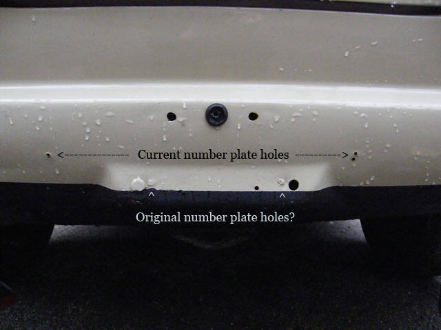

While I had the bumper off I thought I'd have a look behind the number plate too and investigate the whole rear valance for damage and repairs. This way I can rectify it all before putting the bumper back on and it gets a bit more of the car finished that, admittedly, I wasn't going to do just yet. First thing was to remove the number plate and I think I now know why the number plate light doesn't illuminate it so well.

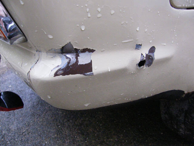

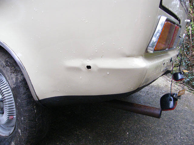

Next, inspect the damage proper. This is about when it started drizzling fine enough to get everything damp and mean I couldn't do paint, or filler, or much of anything. Bumper off, some paint came with it.
I knocked the rest of the loose stuff off too, and I'll get this sanded back before painting it so I don't end up with paint blistering up.

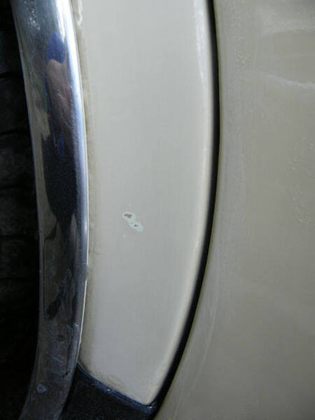

I noticed a crack in the paint on the rear panel too, and some paint has come off the seam. I'm going to have to remove the light cluster to tackle that properly, another job I didn't want to have to do yet.

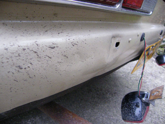

After everything had been cleaned down with some plain water, I had a look at what other damage was there. There's a lot of little dents in this panel, mostly invisible when the bumper is attached, so I guess I'm not the only one to reverse into things.
There's even a matching (though less severe) dent and crease on the passenger side that's been resprayed before I got the car.
All in all, I'm at least comforted that I didn't do too much damage to the old girl. We're supposed to be getting slightly better weather over the course of the week, so I'm hoping to get this all rectified and put back together again.

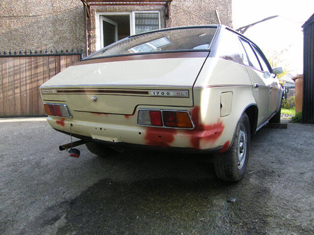

So my goal this week for the Princess is to flat back and tidy up all the paint on the lower rear quarters, rear valance and rear panel. I'll also be getting the exhaust fixed of course which I've been saying for some time now, but the weather has meant I've not been able to get it done.
After a somewhat shakey start to the weather today, it cleared up nicely and I managed to get cracking on the back end of the Princess putting right what I did wrong.
First job was to get all the loose and cracked paint off. I did manage to crack a bit more paint knocking the worst of the dents out. There's a lot of dents on this part of the car, it looks like it's hit a fair few things in the past. Most of the dents were large and shallow and so only need a bit of persuasion in the form of leaning on the panel a bit, but the driver's side bumper mount had been pushed in a fair bit so I bashed that out with a hammer. The worst dents will need a puller to rectify properly because it's double skinned areas with no access from the back with the tools I have.
Eventually, I flatted back the incredibly thick paint with 400 grit getting rid of a few sags and some heavy orange peel in the process, and only just cutting back through to the old paint. This panel looks like it's been repainted a few times, the paint was very thick and there were a fair few layers compared to the other side I'd been working on before.
There was a rust stain starting at the bottom of the rear quarter/arch area that had just started to crack. I had a poke and a big chunk of filler fell off to reveal a small repair to a common rot spot. It's actually pretty solid and the filler that's left in the panel is very well stuck so I'm not sure exactly how I'm going to remedy this bit. I'll probably knock as much filler off as will come off and after rust treating the area, blend some new filler in and finish it better than it was.
On the same arch, door side, there was a bleb that I thought was rust coming through but was actually a splot in the paint. Seems to be a common theme with this car for 'rust bubbles' to turn out to actually be globby paint, not that I'm complaining.
After getting that rear quarter flatted back ready for paint, I moved round to the rear panel. Removed the lights and enough of the boot seal to get access before going at it with more 400grit paper. The top of this panel was really rough, like it had got a lot of muck in the paint or the brush used to apply it. There was also some rust staining where the lock sits, but this turned out to be little more than staining in the paint so I'm wondering if the contaminate was iron filings perhaps?
Likewise, over the rear light on the driver's side the paint was rough, and quite thin. It's a lot better now, but will need a top coat blending in.
Apart from the dents, this area isn't actually all that bad at all, it's certainly nice and solid. The more I prod at this car the more it seems she's been given an appalling paint job that hides what is a pretty solid body.
I only got as far as the lower part of the rear quarter and the driver's side half of the rear panel before having to call it quits as the temperature was dropping a bit and I wanted to try and get some paint on. Quite pleased with how it's turned out, I was expecting much worse.
Can't go and buy any grey primer as I'm out of funds so I had to make do with some red. The metal on the Princess starts to go orange a lot faster than the Polo, presumably due to a lack of factory rust-proofing, so I didn't want to leave it to chance too much. Didn't get chance to get any top coat on tonight so I'll tackle that tomorrow when I do a bit more remedial work. For now, it's tidy and at least not exposed metal. Unfortunately my can of red primer is now almost empty, but I do still have a big tin from when I did the work on the Polo, so if I need to I'll get that opened up.
I also discovered the rear lights are completely reversible. I won't be keeping them this way, the panel lines clash too much. I have no idea when this information will come in useful, but there you are.
Tomorrow, providing the weather is fit, I'll try blending in some new top coat and doing more flatting back in preparation for polishing the back end up and then fitting the bumper. Many, many hours to go on this to get it how I want it.
