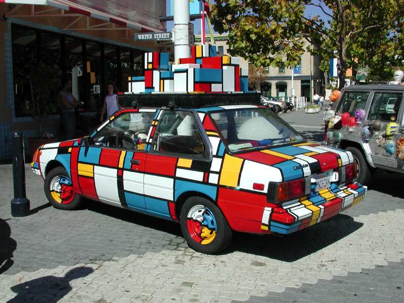

rml2345 Posted October 30, 2013 Posted October 30, 2013 I quite like that! It's like something from an 80s TV continuity sequence. cms206 1

Partridge Posted October 30, 2013 Posted October 30, 2013 Mondrian...I was going to say just the same thing. I'm glad I'm mixing with cultured people, here.
Wilko220 Posted October 30, 2013 Posted October 30, 2013 That beige, orange and black scheme looks very familiar.Perhaps you could add "AUTOSHITE.com" in big orange letters down the side. You can't be in any doubt that it makes sense... vulgalour and eddyramrod 2
Shep Shepherd Posted October 30, 2013 Posted October 30, 2013 That's pretty nifty. Puts me in mind of "Look Around You 2" for some reason D-Dubya, rml2345 and oman5 3
