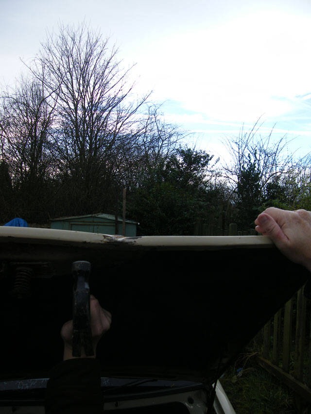

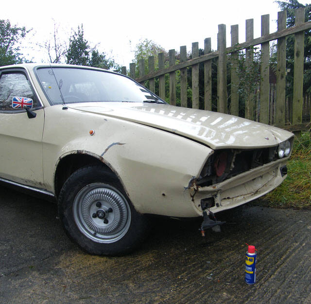

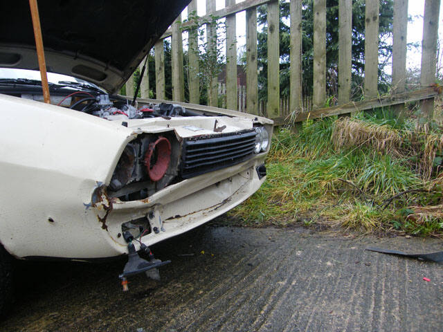

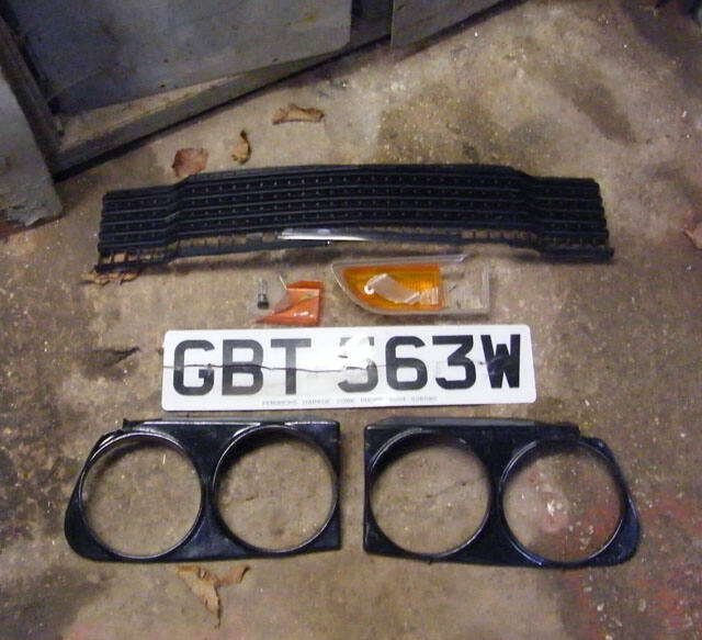

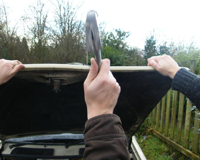

vulgalour Posted November 11, 2012 Author Posted November 11, 2012 I'm sure you'd like an update with pictures in it, so that's just what this is. Remember this? Veh sad. Not to worry, as you know, I got her home and tucked up warm and safe in the garage. I did have issues selecting reverse and it turns out the issue was me, not the car, because for some reason I thought reverse was at the opposite end of the 'box to what it is. Problem solved there very easily, herpaderp. I've not been able to devote masses of time to the Princess while she's been at home, what with the new arrival in the form of Steve the Maestro but I have done some work on her. First thing I did was straighten out the kink in the bonnet, which was actually very easy to do without any tools. The dent in the leading edge is a bit trickier as it's double skinned, but I did find out today that a neighbour has a dent-puller and really this bonnet looks salvagable now I've started working on it. I also checked the panel gaps, just because. It's not far out really, I feel more and more confident the more I look at what's actually damaged. Pictures like this make it look far worse than it really is. And pictures like this make it look more obvious what's happened. Anyway, got the bumper removed, straightened it a bit while it was on the car so I could get at the bolts. The bumper isn't kinked, the chrome isn't cracked or split and it will straighten, as will the brackets. I've put it safe for now. I then took all these bits off. The grille is actually repairable, but the headlight surrounds are borderline. I have got all the black bits ready to go back on and Des was kind enough to supply a passenger side indicator/sidelight unit so I'm only missing one piece (and a number plate) for the face of the car now. With all that off I could see more clearly what's been damaged. The bottom corner where the wing meets the valance has been pushed in, but the headlights haven't, they've just been readjusted and pushed back something near straight without any effort because the adjusters are fubarred anyway. I did notice the headlight bracket on the crashed side is a new one as the black primer hadn't been keyed for the beige paint which has just flaked off. The central support for the slam panel to valance is bent which has pulled things in and down, this too can be straightened and pull everything true again. The deformed wing is only like that because of the bottom corner where I hit the corner of the van's chunky bumper. I reckon with a puller tool most of this will go back to how it ought to be, it's really not that bad at all. I haven't quite got enough strength to pull it all back into shape myself, but I did manage to get things a little straighter. The wing may be salvagable, but it has rotted out on the bottom edge so I may be as well replacing it anyway as it'll likely be as difficult to repair the original as it would be to put a new one on. Until I have better tools, this is as far as I can get on this job now. I'm confident that the damage is reversible and with some patience and hammers followed up with more patience and paint, that I can get this tip top again. It's also nice to have an old car that's happy to start first time, every time. I'm feeling very positive about the old girl, I think once I have the next month or so out of the way I can start rebuilding this front end without actually spending that much cash on parts. Most of the work needs time and effort, something you guys know I'm willing to spend on the Princess.
Split_Pin Posted November 11, 2012 Posted November 11, 2012 Good work on that, pretty sure a Porta-Power will sort out what human strength cannot. Look forward to more updates on the Princess Dermist 1

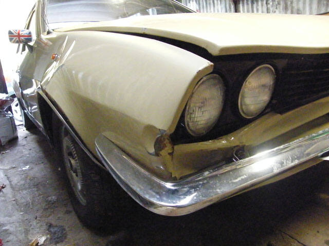

vulgalour Posted January 1, 2013 Author Posted January 1, 2013 Not a lot has been happening of late. 2012 is finally over and can hopefully be forgotten, what an appalling 12 months it was! The plan, as it stands, is to get her in for an MoT as soon as I can. I've had plenty of time to assess the damage and, looking at what's good and what isn't, I only need to work through a few items to get her booked in. The shortlist is:- Straighten the bent stuff- Align the headlights- Reseal the one leaking tyre... again- Resolve the minor oil leak... again- Sort out the tracking- Paint any bare metal- Weld any MoT-failing holes- Locate replacement drivers side indicator/sidelight unit- Purchase new front number plate To regroup I've sold much of what I own, given much of the rest away and moved back in to my parents spare room. It's not a great situation, and I'm not on my own. As odd as it may seem, keeping the Princess is important, it's a possession I can use to focus on and keep myself feeling positive, a goal to reach towards. I'm realistic to the fact that things could get worse still for me, that I might have to sell the Maestro and of course the Princess, but I hope it doesn't come to that, things are stable at the moment, I'm just working on getting them to improve once more. So, on with the positive vibes, and looking forward to this weekend when I should have everything together (weather permitting, as always) to get to work on bending and bolting the old beige bus into shape again. I'm excited and I'm scared about what 2013 has to offer, but I'm hopeful that it's going to be an improvement on 2012.

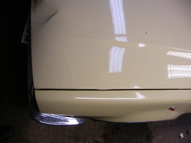

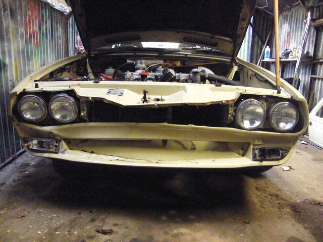

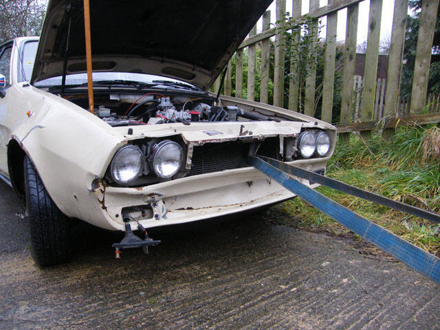

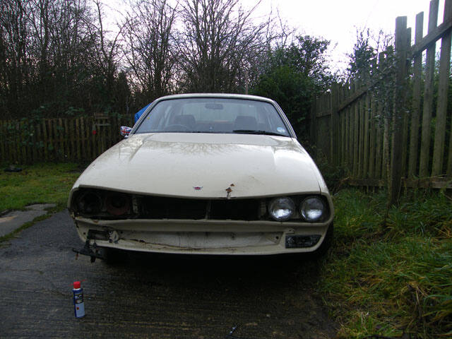

vulgalour Posted January 3, 2013 Author Posted January 3, 2013 2013: so far, so good. This morning we had the Princess A-framed over to the new residence and installed in her new place of rest. The plan was then to get some other errands sorted and assess the works ready to undertake tomorrow, but instead we all got too itchy fingered about it and got on with the job at hand. Between the three of us, my Dad, Brother and I all have some experience of bodywork repair and some little knowledge of physics, so a plan was hatched that involved the Maestro, a ratchet strap and careful application of hammers and knowledge. We could only spend about 2 hours, but we did get a lot closer to sorted in that time. First of all, we wanted to get the slam panel something like straight again and the easiest way to do this was to try and get that central support straightened. Rigged up the ratchet strap to the tie-down loops under the back of the Maestro and carefully ratcheted it up. It did take a while until we couldn't get more tension on the strap, and it wasn't enough to get it right. So we very carefully used the strength of the Maestro to pull this part straighter and, with a satisfying *pwong*, much of the damage was undone. It was then a case of assessing where bits were pushed back and where they weren't and ratcheting them forwards or leaving them put. This is one of those things you learn through experience more than anything and while it looks like we're about to pull on the middle of the slam panel here, we decided on different, stronger locations that rectified much of the damage and pulled the radiator closer to the angle it should be. A trial fit of the new grille after much bashing and pulling saw that things were getting closer. This was quite an important thing to check as the grille is known to be good and I don't have another undamaged car here to compare mine to. All a case of working with what I have. It's not too far off either, once things on the bottom edge are pulled forwards again. Much of the metal on this section is fairly thin and not massively structural so it's fairly easy to manipulate, and to over-manipulate if you're not careful. Next up was to tackle the bonnet which is quite badly bent. This can probably be repaired, but may well end up getting replaced as it'll likely never look right. The V dented into it was fouling everything and needed to be straightened out so that we could get the bonnet to close properly now that the slam panel was where it needed to be. I can't really demonstrate how we know everything is mostly where it needs to be, but suffice to say it's where it needs to be to sort out bonnet operation. Here's some hammer action. After yet more fettling, and much less ratchet strap action, all was ready to try to close the bonnet. It took a few attempts to fine tune things but as you can see, it's already looking better even with the bonnet up. Now for the happy moment, the bonnet closed properly and able to be opened on the release pull. Okay, so it's still bent up at the corners and has an ugly dent in the middle, but that's not too important right now. This corner still needs some work, we haven't straightened the headlight bracket fully yet, but it's a big improvement on what it was and the big fold in the wing has almost completely gone, so much so that I can probably get the panel beaten straight again with some care. Finally, a comparison picture. Eventually, I plan to replace much of the sheet metal on the front with properly straight stuff, but for now I'm more concerned with obtaining an MoT and making things look presentable if a little battered. I think we're heading towards that goal rather nicely at the moment.

Split_Pin Posted January 3, 2013 Posted January 3, 2013 That's a remarkable difference between before and after. Good on you for keeping the faith. I'm looking forward to seeing the letters "M-O-T" in the thread title.
Alexg Posted January 3, 2013 Posted January 3, 2013 I love the erm, 'rustic' way you've gone about sorting this. Truly excellent.
vulgalour Posted January 3, 2013 Author Posted January 3, 2013 I'm a proper Autoshiter, I do things the Autoshite way. I'd've used a tractor if I had one to hand, but beggers can't be choosers. I've gained a target to aim towards* to get the Princess taxed and MoT'd: Austin Morris day at Brooklands. It's a three hour drive and at the start of March but will be celebrating the tenth anniversary of the Princess club and of course, Austins and Morrises. I'm hoping I'll be road legal and able to afford the petrol to make the journey while the Princess will still look like a bit of a bruiser just to give some contrast to the shiny-shinies that'll be there. *it's an unrealistic target, but meh.
purplebargeken Posted January 3, 2013 Posted January 3, 2013 Using a Maestro to fix a Princess will go down in Autoshite lore! Marvellous work!

vulgalour Posted January 3, 2013 Author Posted January 3, 2013 @Timothy: They are not, and surprisingly the headlights and adjusters aren't actually broken, just a bit bent on the bracketry. They still function perfectly fine on all settings, which was comedic on the drive home from the MoT station after the crash in the pissing rain.
