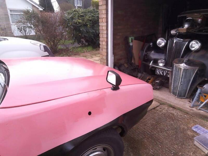

vulgalour Posted January 27, 2024 Author Posted January 27, 2024 Finally, a nice day of weather when I'm not at work! Decided to crack on and do a few jobs that weren't video-worthy but all needed doing. Found lots of little rust bubbles that will need attending this year, I foresee a summer of welding lots of patches that are almost too small to bother with and too big to be able to leave alone. First thing was to replace the broken wing mirror. This one was my fault, somehow my coat caught the mirror glass, popped it out of the housing and dropped it on the floor. I then broke the mirror glass trying to reinstall it, because of course I did. Old mirror housing had one spinning bolt, naturally, so I had to carefully cut through the stem of that. Fitting the new one was pretty easy and setting it up wasn't too onerous a task either. I didn't do the other side since it isn't broken and I didn't want to go making more work for myself. Next up, wheels off so I could wrangle the front arch liners back into place. There's no nice way of doing these and they're damaged from before I got the car and have picked up more damage since. I've got mixed feelings about putting these back in really, just can't bring myself to do away with them permanently while they're still at least functional. They're held in with three or four screws and the arch lip itself, none of which you can see because I didn't try to take a photo until it was all back together and the car was back on the floor. Between putting the mirror on and the arch liner on I did splash some paint and underseal over the new mirror's nuts and bolts to hopefully prevent rusting, the arch liner will also help since it covers everything away from the splashed up grime. Another job I've been procrastinating on was refitting the fuel filler flap because I wanted to get the paint done. I can do the paint later, for now it makes more sense to have the car back in one piece. Easy enough to do once I found some proper fixings and suitable washers, then splashed some black on the primer just to stop rust. I do need to repaint this flap because of a reaction that happened when I was doing a test run on the enamel paint I got, possibly a reaction between the primer and the gloss. Finally, after clearing out the boot and tidying it up, I fitted the replacement light lenses. The inner passenger side red lens had developed a crack that was going to start letting water in and causing corrosion issues. Finding '64 Galaxie rear lights isn't that easy in the UK and the ones I could find that would match in the US were often from sellers who wouldn't post at all. Luckily, I had a friend in the States willing to be the middle man and got a really nice pair of basically new lenses to go on. They do have a different chrome boss, there were several different designs, but I don't mind that in this instance. I replaced both inner lenses so I've got a matched set. Car is sitting wonky because it had just come off the jack and I didn't jiggle it to settle it out level, just Hydragas things. The driver's side front inner wing has a bunch of little patches that I'll have to weld in this year, nothing serious or complicated, just age related stuff really. I've got a new outer wing to go on this side so I'll likely bundle fitting the wing and doing the repairs all together in one week of welding fun. Access is at least pretty good for the most part and it won't need to look nice. I'm unlikely to be able to do any welding before I move house now, which is a shame. It's another logistics thing really, having the good weather and spare time in February is unlikely and I'm nearly out of gas in the current bottle. I don't want to have to buy a new bottle of gas right before moving house/part way through a job and then have to buy another when I'm at the new place (I don't want to put a gas bottle in the van we've hired for moving with). It can be a spring/summer job instead when we've got longer days and I can take a bit more time over it. Last job I found to do was topping up the dashpot on the carb as it was a bit low. That'll help just in general, it always does. MorrisItalSLX, Asimo, Stanky and 7 others 10

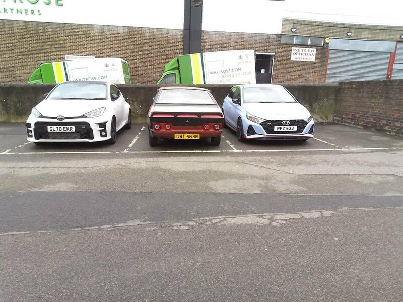

vulgalour Posted February 7, 2024 Author Posted February 7, 2024 Today has been full of errands, to save time (the weather was dreary and I didn't want muddy shoes) I rather lazily drove to the gym. In protest, when I stopped at the end of the street the Princess hurled a hubcap off. Luckily I could grab it and pop it back on and it seems pretty secure so I've no idea what that was about. Car is definitely driving a lot better now it's been taken out once a week minimum, which is nice. On one errand found myself parked between a Toyota Yaris GR and a Hyundai i20N. I didn't blend in very well. Was also weird how small the Princess looked between them, stood alone it still looks like a good sized car. timolloyd, PhilA, danthecapriman and 10 others 12 1
rattlecan Posted February 8, 2024 Posted February 8, 2024 So much wider (particularly) modern cars seem to be lesapandre 1
2flags Posted February 8, 2024 Posted February 8, 2024 When these were new, they were considered a large car. Now they seem so small when compared to moderns. bunglebus, High Jetter, egg and 1 other 3 1
