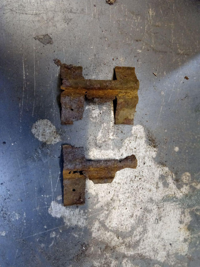

vulgalour Posted April 28, 2019 Author Posted April 28, 2019 End of Week 22 Report. I forget to do an end of week report for Week 21, so I've rolled the two together. On attempting to rebuild the spare calipers I've got, we learned that 3 of the 4 pistons in each caliper are completely stuck in place. We also learned the old brake pad retaining pieces are rusted away, like so. This is an ongoing issue, so far we've tried putting 300psi of pressure into the calipers and the pistons simply won't budge so it may be a job I have to farm out. I'm loathe to dismantle the brakes on the car in case something goes wrong and I end up without the car, so I've basically done nothing with the brakes since fitting the skimmed disc to solve the warped disc issue. This is fine as a short term solution, but not as a long term one and it's annoying to have the new parts to go on the car, but not quite be able to fit them because I want the calipers rebuilt to make the best of the job I possibly can. I don't want an old sticking caliper or similar to ruin a set of brand new discs and pads. The massive socket I ordered arrived so I could do the balljoint that was advised at MoT. I re-used the old shim which seemed to be the correct size, fortunately. I've not done pre-load balljoints like these before so I'm hoping I did it right, time will tell of course if these wear out much sooner than they should. The passenger side wasn't advised but I wanted to do it anyway, I was thwarted by simply not being strong enough to undo the balljoint that's fitted, even with very long poles. It could do with being on the workshop lift, but that's been occupied for quite some time by a Rover 75 so I just decided to leave that side alone for now. Here's new and old parts. I did have to swap the spring-type o-ring from the old balljoint boot to the new one because the new balljoint boot had a rubber o-ring that wasn't strong enough to hold the boot in place. Next MoT item was the upper steering column bush. This is fortunately an easy part to get, shared with a plethora of BL vehicles. Removal is somewhat involved, requiring this scene to happen again. Eventually I had the inner column out of the outer sheath and had the old bush removed. It was very clear to see where the play was coming from once it was removed, the whole thing had shattered. I couldn't find a replacement bush for the lower end of the column but given how tight a fit the existing one is and how fiddly it was to reassemble everything as a result, I doubt that's going to be a problem. Unlike other BL stuff, the Princess has a narrower bush at the bottom of the column of a different design to the top one, and I couldn't find that part, so I'm glad the one on the car was okay. Assembly was fairly straightforward and I've now got rid of an occasional dashboard squeak and a dashboard rattle I couldn't place, so that was a happy little bonus. Steering feels more direct, and also heavier at lower speeds, the latter is less welcome than the former. The other item I wanted to resolve was the interior light. I'd had a problem with the old festoon bulb melting the holder, which is also integral for the rear view mirror. I had a spare, and that too had obviously suffered the same issue since it had a partially melted spot where mine had a melted hole. To resolve this I ordered a warm white LED - this was a pain to find, ended up going to my local motorfactors and special ordering it - since I hate ultra bright LEDs in cars. The light quality isn't as nice as the old incandescent bulb, but now it never gets hot so I'll never have the melted holder issue. richardthestag, mercedade, Paul Dupart and 3 others 6

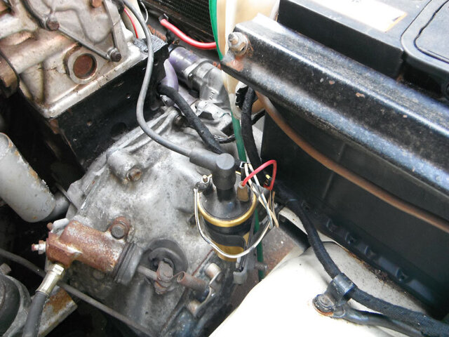

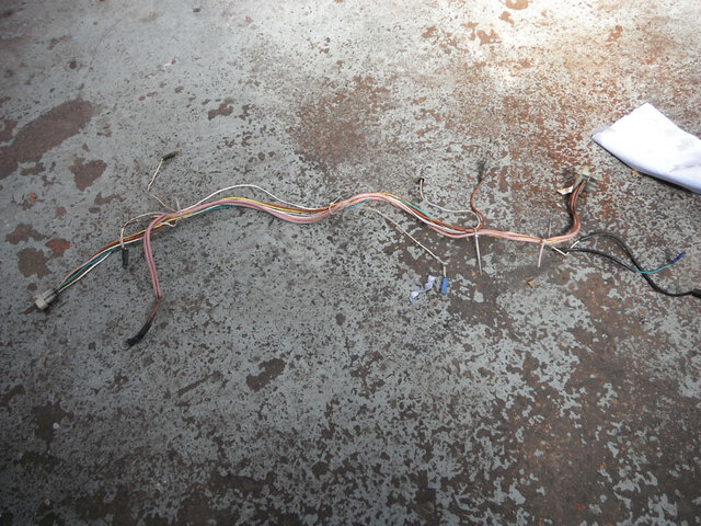

vulgalour Posted April 28, 2019 Author Posted April 28, 2019 Next up was to try and identify the cause of the minor oil leak. Normally, I'd just take this opportunity to wave my hands in the vague direction of the car itself. However, I wanted to be a little more methodical so I started by giving the engine bay a quick clean down. That highlighted that the wiring that runs across the front of the block needed to be re-wrapped. The old electrical tape someone had used has gone brittle and isn't sticky on the inside any more so it just flakes off. This had been hidden when the engine was much oilier on the outside than it is these days. The main oil leak at the front is the O-ring for the distributor shaft. I've had recurrent problems with this as finding an o-ring that's the correct size is surprisingly difficult and after a while, they seem to stop being effective which means it weeps oil all down the front of the block, into the spark plug wells, and onto the floor. You can see from the cleaner portions where the oil has been seeping. The other oil leak was a surprise. The engine used to be very oily on the passenger driveshaft side and I'd assumed this was the driveshaft seal. It's not, the oil is actually seeping up from the speedo cable. Another o-ring here should fix that and might even fix the rattle it has. Happily, the rebuilt carburettor is staying spotlessly clean, never sweats fuel, and never gets oily. I gave the fluids a check too. Brake fluid isn't terrible, though will be changed when I do the brakes. Coolant has gone from being quite blue to now being very pale blue, the gunge in the bottle is just residue on the bottle itself, I could do with chucking the whole bottle in a dishwasher really. Oil is getting ready for a change, it's not terrible, but it's due June/July time anyway. The underside of the engine used to always be slightly greasy looking. Now it's mostly dry apart from the aforementioned leak points. This is a huge improvement over when I bought the car and I'm happy about it. Another irritation has also been solved which was something rubbing on a tyre on full lock and certain suspension articulation points. Turns out, one of the arch liners had got broken and an edge was catching the tyre. I trimmed that back and the problem is now gone. Shown here is the good side and the now-trimmed broken side. Other than that, the only problem its thrown at me is that the alternator is sporadically charging incorrectly, not at all, or too much. danthecapriman, SiC, LightBulbFun and 3 others 6

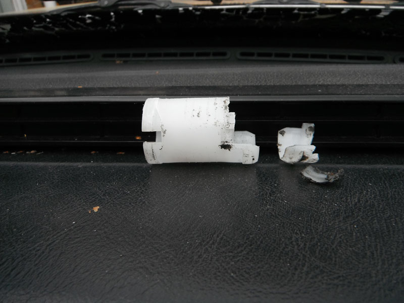

LightBulbFun Posted April 28, 2019 Posted April 28, 2019 happy to see things are continuing to go relatively well on the festoon bulb front, are things melting from poor electrical contact, or from the heat of the bulb? if so it might be worth making sure the festoon bulb you have fitted is not too high a wattage for the application (iv seen Festoon bulbs in everything from 5W to 21W) richardthestag 1
vulgalour Posted April 28, 2019 Author Posted April 28, 2019 Heat of the bulb. You can't actually turn the interior light off so if you leave the door open the bulb does get hot enough to melt the plastic of the holder, which is exactly what's happened. Some sort of heatshield would have fixed it, or the ability to turn the switch to an off position, but I guess BL didn't have that much money available. MarvinsMom, LightBulbFun and richardthestag 3

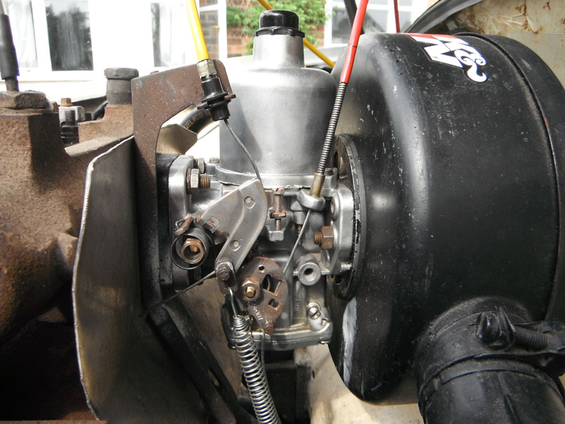

SiC Posted April 28, 2019 Posted April 28, 2019 Is your HIF carb still running the poppet valves on the throttle disc still? Or did the rebuild one have them replaced with ones without? richardthestag and Coprolalia 2
vulgalour Posted April 28, 2019 Author Posted April 28, 2019 That is a very good question to which I do not know the answer. Coprolalia 1
richardthestag Posted April 28, 2019 Posted April 28, 2019 These spiteful feckers on the throttle butterfly into the inlet manifold. cut the horrible things off and soft solder the disc of the valve to the disc on the throttle butterfly. Lots of plumbers flux, some plumbers solder and a smidge of blowtorch. SiC 1
vulgalour Posted April 28, 2019 Author Posted April 28, 2019 I don't think mine has those fitted. From what I remember the flap is just plain, there's no additional thing on it. richardthestag and SiC 2

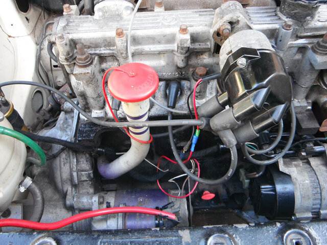

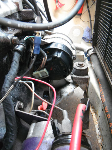

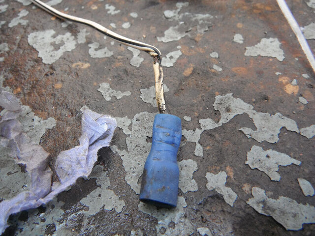

vulgalour Posted May 13, 2019 Author Posted May 13, 2019 Right then, the Daily Driver Challenge got derailed somewhat by a BX but that doesn't mean I haven't used the Princess at all. I'll be collating the info and experiences from the experiment today and will have a write up on that a bit later. For now, it's alternator time. Shiter Danthecapriman very kindly sent me his old Capri alternator to use on the Princess. We were unsure as to whether or not it was correctly handed but knew it was otherwise a suitable swap. Worst case, we could always use the good bits from one to fix the bad bits on the other. This was going to be a little How To on doing the repair, my camera had other ideas unfortunately, so you'll have to use your imagination a little bit. With both alternators on the desk we could see one was left handed, and one was right handed. This is to do with where the pivot bolt and adjuster bolt holes are on the casing, they're otherwise identical. Fortunately, if you unscrew the bolts holding the casing together you can dismantle the whole distributor and swap the casings over. You also have to desolder three wires that connect the regulator to the commutator ring. The intention was to use all of the internals from the Capri alternator and just the outer casings from the Princess alternator, this changed when we inspected the various components and ended up Frankensteining one alternator out of the two to make the best of the components available. This is the Princess alternator internals, and you can see at the front the three wires with white-with-green-dots wire that are soldered to the regulator. On the Princess alternator, most of the componenents were in reasonable condition, but it was the regulator that was shot. We cleaned up the commutator surfaces, checked the bearings, and decided against splitting the commutator ring from the casing since it was in better shape than the one in the Capri alternator. The bearings in the Capri alternator weren't quite as good either, though that's not too surprising since the Princess alternator dates from about 2011, where the Capri one is from the mid-80s, so had a fair few more hours clocked on it. The Capri regulator design was slightly different. It was the same where it mattered, it was just the quality of parts of soldering, etc. was better overall and the regulator on the Capri didn't have a condenser added on, presumably because there was no need for it as there was on the newer Princess one. To make things extra confusing I've made sure that this part is photographed from a completely different angle to the Princess one above. Now I have no more alternator rebuild photographs because the camera ate them all. Essentially, we used the commutator ring, the main spindle, and the metal casings from the Princess alternator, with the regulator, and Lucas branded plastic cap from the Capri alternator. We also used the best of the various bolts from both units in rebuilding the new Frankenstein. The net result is that the alternator now works properly, which is what this was all about. So a bit thank you to Danthecapriman for providing the spares, and to Mike for basically cracking on and doing the magic soldering work. With the alternator off the car, I could address a couple of jobs I'd wanted to do for a while and hadn't had a good excuse to get done. First up was the alternator bracket which has always been a bit crusty looking. Treated it to wire brush and black caliper paint, it should bake well since it does get quite hot being bolted straight to the block. Cleaned up the bolts for the bracket, and the wiring loom, while I was in there. I also cleaned down the grease that had been hiding behind the alternator. With the wiring loom removed I could unwrap the brittle old electrical tap and use a few cable ties (cheers for that idea, Project Binky!) to keep things where they needed to be for when I re-wrap it. I also degreased it so the new tape had the best chance of sticking. Typically, found another bodge in the form of a half-cut wire under some electrical tape that had been added after the rest of the loom was wrapped. This is the only bit of the wiring loom I've not had off the car (that I know of), so it's hardly surprising there was yet more damage to it. Mike splice the wire back together with fresh solder and new heatshrink since we didn't have suitable connectors to remake the whole wire. Again, I'd show you progress but the camera ate a bunch of illustrative images. Fortunately there was exactly the right amount of loom tape in the drawer to wrap this section, and not a millimetre to spare. I repainted the steel P-clips that hold the loom to the front of the block and we extended the electronic ignition wire with a new piece so that it could be more tidily incorporated into the loom. The wiring on the front of this engine needs all the help it can get when it comes to being tidy. With all that reinstalled, we started the car and tested the alternator to see what it was doing. We now have a reliable, steady, predictable charge that will keep up with system demands as and when required. It was good to get everything cleaned up a bit too, removing all the historic grime really helps keep everything look much nicer and means I can see when there's a problem that much easier. The Lucas branded end cap on the alternator is quite pleasing for reasons I can't explain. It's still a very messy face ot the engine, it always will be. There's some cosmetic improvements I can make, I still haven't colour coded the oil filler tube or starter motor to match the new colour scheme and the purple is just starting to bug me now on those. At some point soon I'll pop them both off and repaint them, they're very easy jobs to do. Didn't have time to crack on with the brakes today. I'm not in as much of a rush to sort those as I was since the BX can pick up the slack. Mike and I are hoping next Monday can be brakes day, providing our schedules don't get all clashy. mercedade, Coprolalia, Stanky and 6 others 9

MarvinsMom Posted May 14, 2019 Posted May 14, 2019 On 4/28/2019 at 6:24 PM, vulgalour said: Heat of the bulb. You can't actually turn the interior light off so if you leave the door open the bulb does get hot enough to melt the plastic of the holder, which is exactly what's happened. Some sort of heatshield would have fixed it, or the ability to turn the switch to an off position, but I guess BL didn't have that much money available. the original interior light on the Mini 1000 has the same issue, the heat from the filament bulb melting the (very thin) plastic cover thing, though the mini bulb holder does come with a sort of switch thing that means it can be turned off! top idea on changing the bulb to an LED thing, may i ask where you got the LED from?
vulgalour Posted May 14, 2019 Author Posted May 14, 2019 Ended up having to order it from the local motorfactor. Trying to find a warm LED bulb in an actual shop was quite difficult and I didn't trust trying to get one online.
