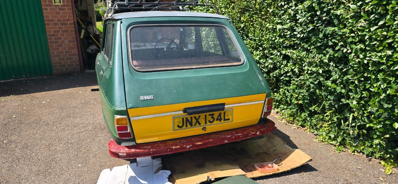

Today I attacked the rear bumper, not perfect but better
  • Like 8
10 hours ago, Slowsilver said:
When we had Bob we managed to acquire a good second-hand  chrome rear bumper which went with the car to @djoptix. If you didn't get it with Bob maybe it would be worth asking him if he still has it.
I'd promised that to @wuvvum for his 6, but I'm happy for it to go wherever it's most needed...
Everything looks better lowered,
Excellent work on this by the way.
  • Agree 2
this one isn't overly bad so no pressure on anyone

Can't help but think this would look smashing painted all in that yellow that's on the tailgate!

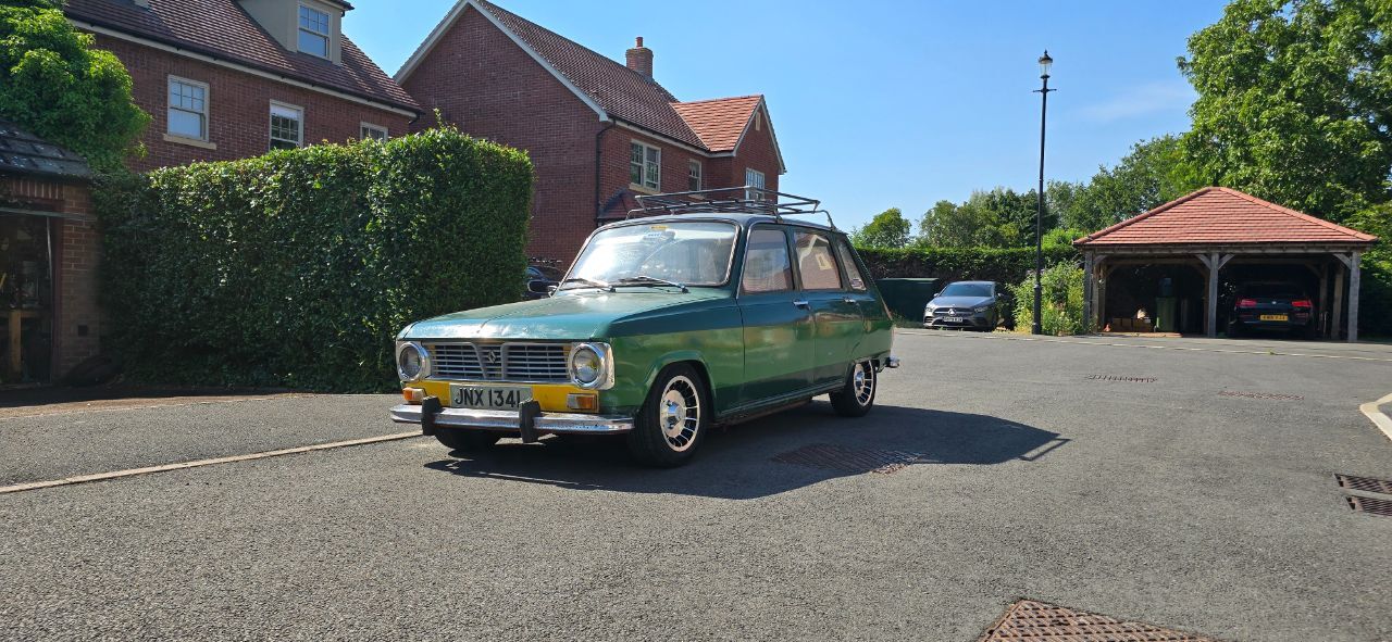

I agree, but that's (IMHO) too much for a R6. I think the whole point of the motorcar is its rolypoly handling.
  • Agree 2
Plenty of little bits going on in the background, waiting on a carb rebuild kit for the new carb I've got, then hopefully I can get it setup and running properly. Will update a bit more in the next video but..... check these out
on a side note, i have raised the suspension a touch too, extra wallow reinstated
I like this latest development very much. Class choice of wheels.

I've been keeping an eye out for a set for a while, then found a company called Iconic Alloys that supply them new/reproduction from Germany
In other news, insurance sorted. Through Lancaster as usual with it lowered and alloys fitted 150ish for the year SDPC with 0 NCB as they are attached to the R8 and the Clio RS
Little update, getting ever closer to being usable. Managed to set the ride height, have raised the rear a touch, roof line now sitting pretty level. Not going to lie another inch off all round would look great in my eyes but its got plenty of travel now so should be pretty comfy. Struggling to get it to run sweet off choke, with a slight bit of choke it runs very well, without it tries to fall flat on its face. Will give everything a blow out but as the carb is off a 950cc engine it could be jetted wrong 🤷‍♂️we keep on plugging
