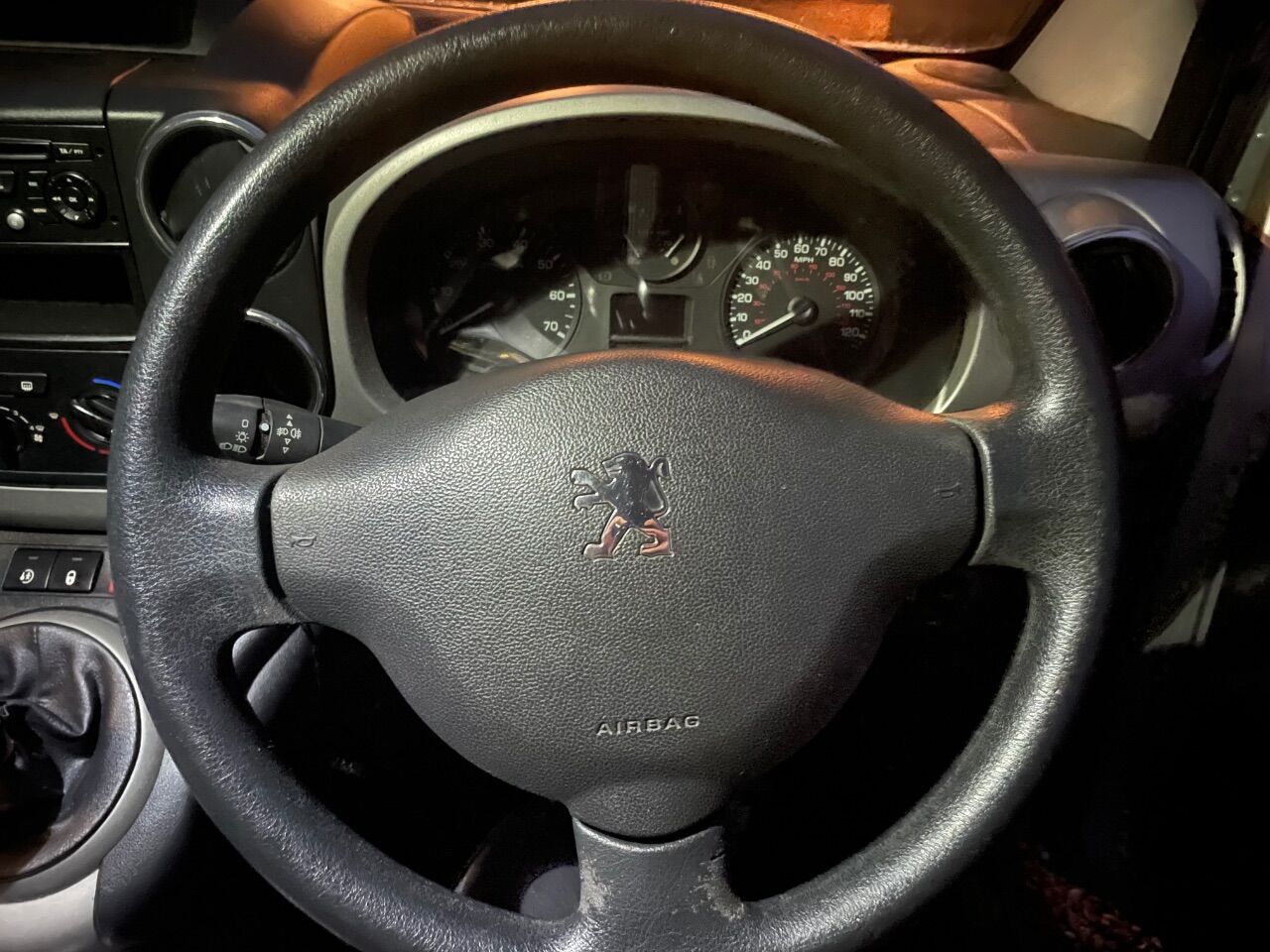

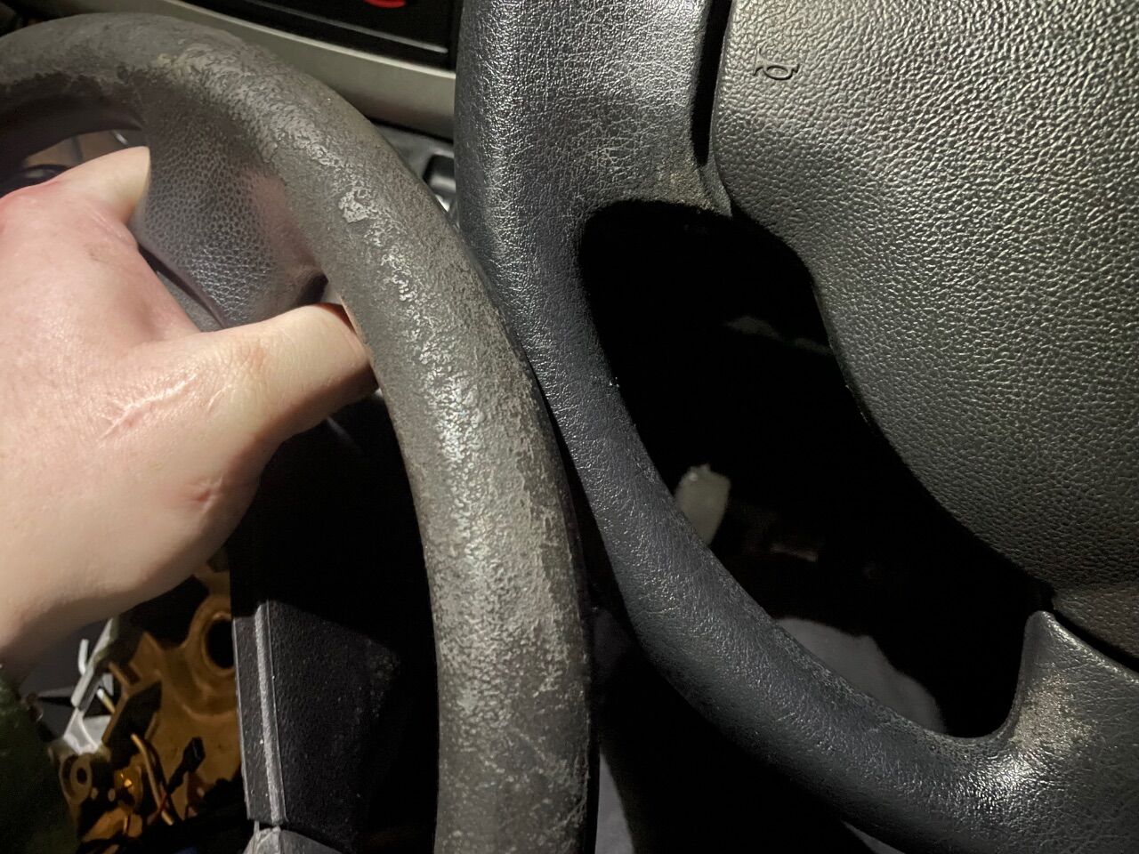

Also can confirm a steering wheel from a Peugeot 207 fits perfectly.
Much nicer than the original.
Original on left btw.
Going to swap out the ignition barrel for the original tomorrow at work as I can avail of a new screw for it there and tidy it all up tomorrow lunchtime.
Great success! Finally.

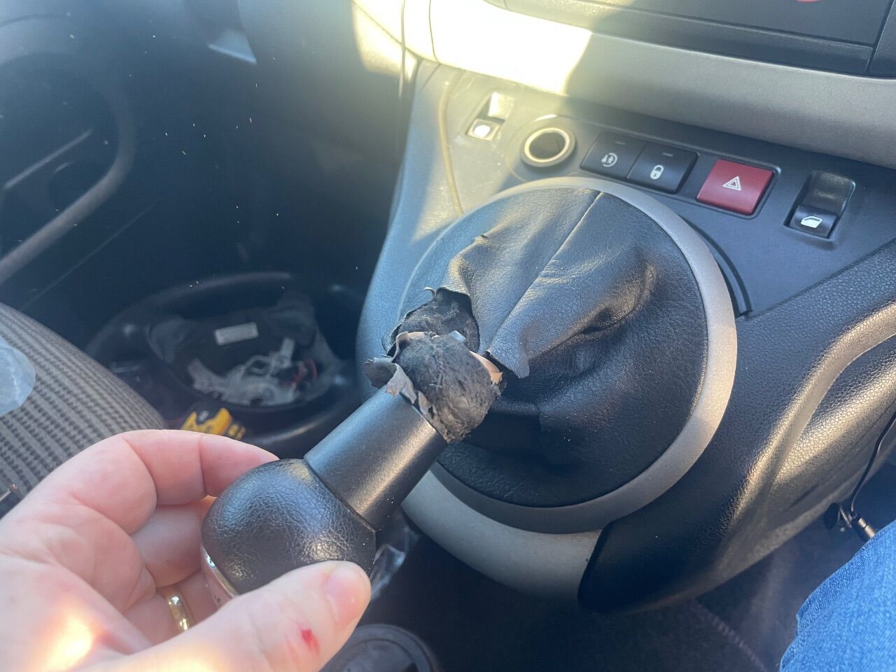

Spent half hour this morning swapping out the ignition barrel for the old one - so far that behaves. I’m hoping to do a bit of a longish drive in it tomorrow so if it behaves then I can send the new one back.
Also swapped the gaiter over as it was shit.
New one is in place, and while it looks better, feels shit.
Makes it look nicer inside anyway.

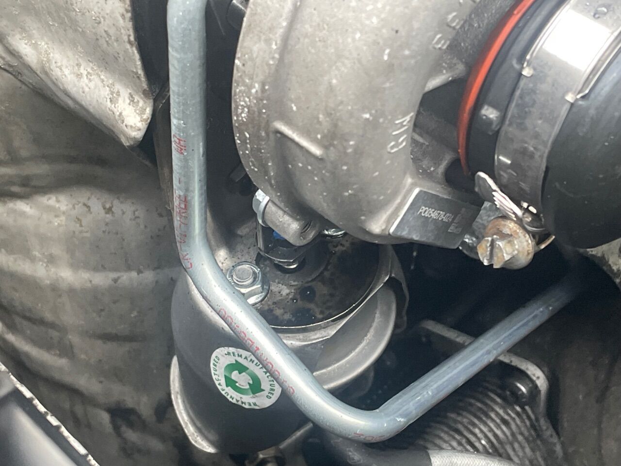

I gave it a look under the bonnet as I’ve not checked the oil since it’s been done. Tbh I’ve not gone far enough to use any but it’s good to keep the habit. The oil isn’t full on the engine. Granted, I haven’t checked it since it was done so maybe the guy didn’t top it up all the way.
I spied this though under the turbo.
That was there last time if you recall. But everything here is rather new. I wiped it clean with an idea to keeping an eye on it. And to top up the oil. Just so I know whether it wasn’t filled properly or it’s using it.
