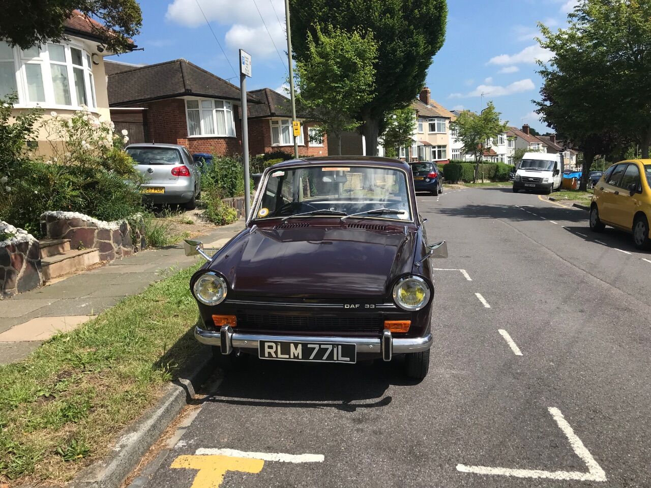

RobT Posted November 20, 2025 Author Posted November 20, 2025 Nocturnal exhaust bodgery was going on here. A blow from the silencer meant it stank and was noisy, so Liqui Moly exhaust bandage was applied. That's my go to fix* these days as it's much better than the Holts shite. Yeah yeah I know, the number plate. But it was £4.99 and will do for now. It was blowing here but the body of the silencer is fine, plus the majority of the pipe is still solid so it won't shear off. A real improvement so I hope the bodge proves robust. I've also checked the ignition timing this week seeing how crucial it is to the correct running of the transmission, and done the basic blow test on the vacuum system by blowing through the two pipes at the bulkhead that lead to the rear of the car. Resistance and blow back was felt from both pipes so hopefully that indicates the diaphragms are OK. Feeling buoyed up by this progress I took it for a run around the block. No FTP after 10 minutes so that's good! It was dark so I'll try and get a video of it running another time. The battery light remains on at idle, so despite replacing the battery and dynamo hopefully the £8.18 NOS voltage regulator I've ordered will be the cure. Obviously I should've replaced the cheap part first but it needed a new battery anyway. The only fly in the ointment (at the moment) is an oil leak from the OS reduction gear. I replaced the oil on both but that will need doing as it's too heavy to ignore. I'll see if I tackle that or pass the job to a new owner. The main goal for me was to get it running and stopping which I've managed to achieve. Whether it's running as it should is another matter, and next steps are to check the fuel mixture again and the vacuum system setting. Rear brakes still need doing properly, but with adjustment and the fronts done fully it's safe to use at urban speeds. Rightnider, Tickman, Sigmund Fraud and 12 others 15

RobT Posted November 26, 2025 Author Posted November 26, 2025 5 miles in this tonight and goal achieved. Photos next to the local 44. I adjusted the vacuum system the other day by measuring the pressure and winding out the rotary valve rod. It now does the high ratio effect after you've thrashed it up to speed. Time to sell it now as that's project achieved, and before I break anything and render it immobile. I've enjoyed getting it to this point. auntiemaryscanary, Spottedlaurel, angle and 16 others 19

Andrew353w Posted November 26, 2025 Posted November 26, 2025 15 hours ago, RobT said: 5 miles in this tonight and goal achieved. Photos next to the local 44. I adjusted the vacuum system the other day by measuring the pressure and winding out the rotary valve rod. It now does the high ratio effect after you've thrashed it up to speed. Time to sell it now as that's project achieved, and before I break anything and render it immobile. I've enjoyed getting it to this point. YEA!!! Blimey, TWO Dafs! Setting up the point at which the vacuum "kicks in" is critical, and best done with a tachometer (rev counter) attached to the engine while adjusting it. If you set it to come into effect too early the car will stall as you move off and if it's too late the car will over-rev and use more fuel. When it's set correctly you'll "feel" the car's "just right". I've fitted a rev counter & two vacuum gauges to my 33 & monitor this as I drive around. Happy to offer more help if needed. yes oui si and RobT 1 1

Andrew353w Posted November 26, 2025 Posted November 26, 2025 Looking at the bodywork your "M" registration 33 is pretty good! Mine's a little hors de combat at the moment & need some serious T.L.C. in that regard, but mechanically it's spot-on. If you need any parts please D.M. me. yes oui si, HMC and RobT 2 1
RobT Posted November 26, 2025 Author Posted November 26, 2025 Thanks Andrew. I like the colour of yours. The paint is shite on mine but that doesn't bother me at all. Regarding the vacuum, I've set it up using approximation mostly and I reckon it's over revving at the moment so I'll keep tinkering. Much better than it was though. HMC 1
