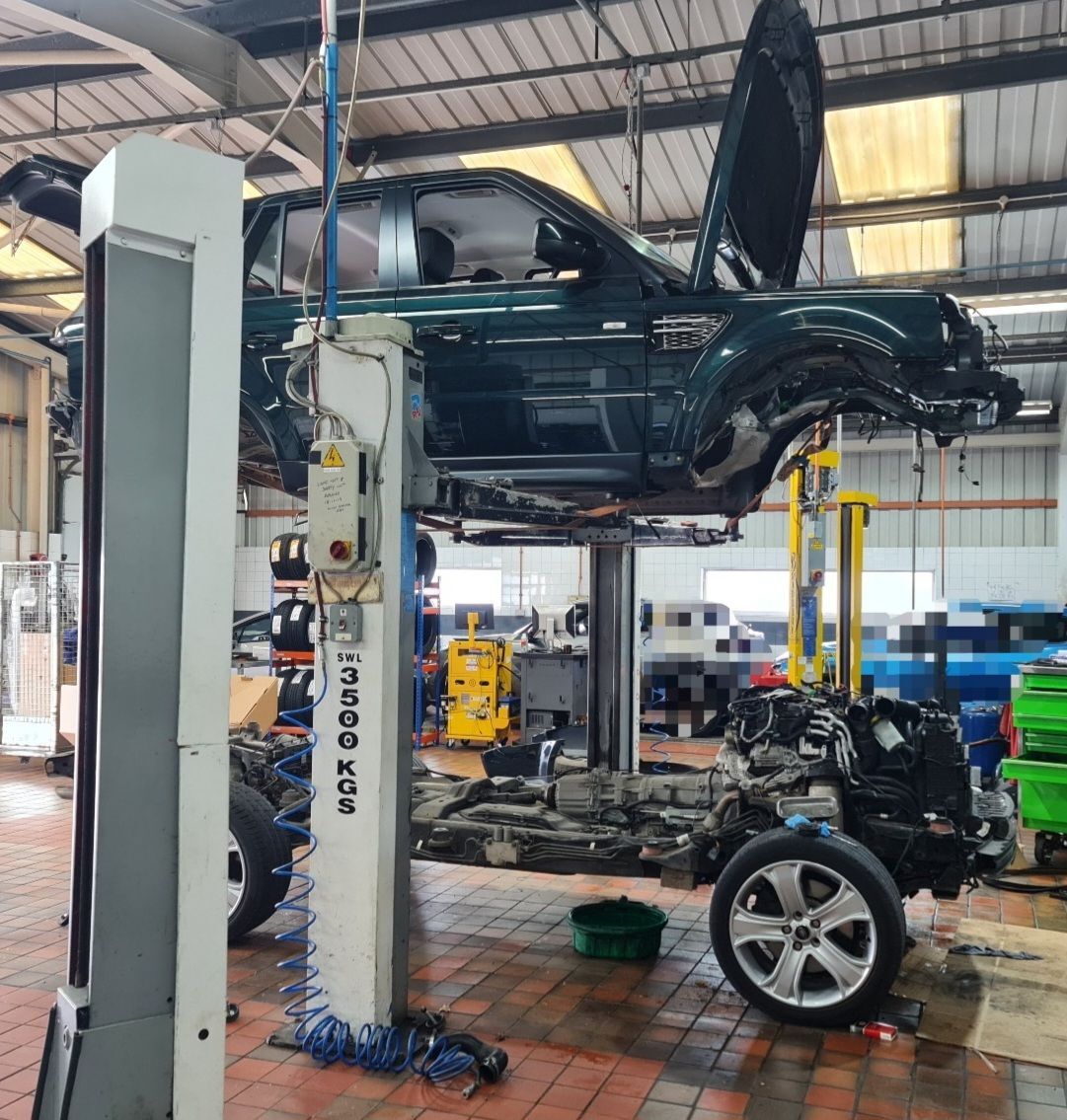

56 minutes ago, cpjitservices said:
snapped cam chain
Belt not chain? (Or is there a chain in the system as well?)
Funny crunching noises, engine not turning over, sudden clunk or just a FTP?
Front belt is doable without body-off.
Rear belt is sometimes not changed as it's only for driving and 'timing' the fuel pump and does no damage when it fails.
At 170k+ miles, without any previous changes, possible for just the rear belt to have failed?
Sorry - clutching at straws.... or just factually incorrect!
Timing belt drives the exhaust cams on each bank then a timing chain in each head linking exh to inlet cam. Chains have been known to fail like. Gutted for you @cpjitservices
Rear belt was doen not so long ago, with actual cam belts, but there are 2 chains running the cam shafts... i think thats whats snapped... on bank 1. Just had all 4 injectors done as well as 2 where poorly... that wasnt a cheap bill nor was gearbox service really as I had the mech unit out and all the seals replaced, it was driving better than it ever had. No warning it was going to shit itself at all.. no EML etc
