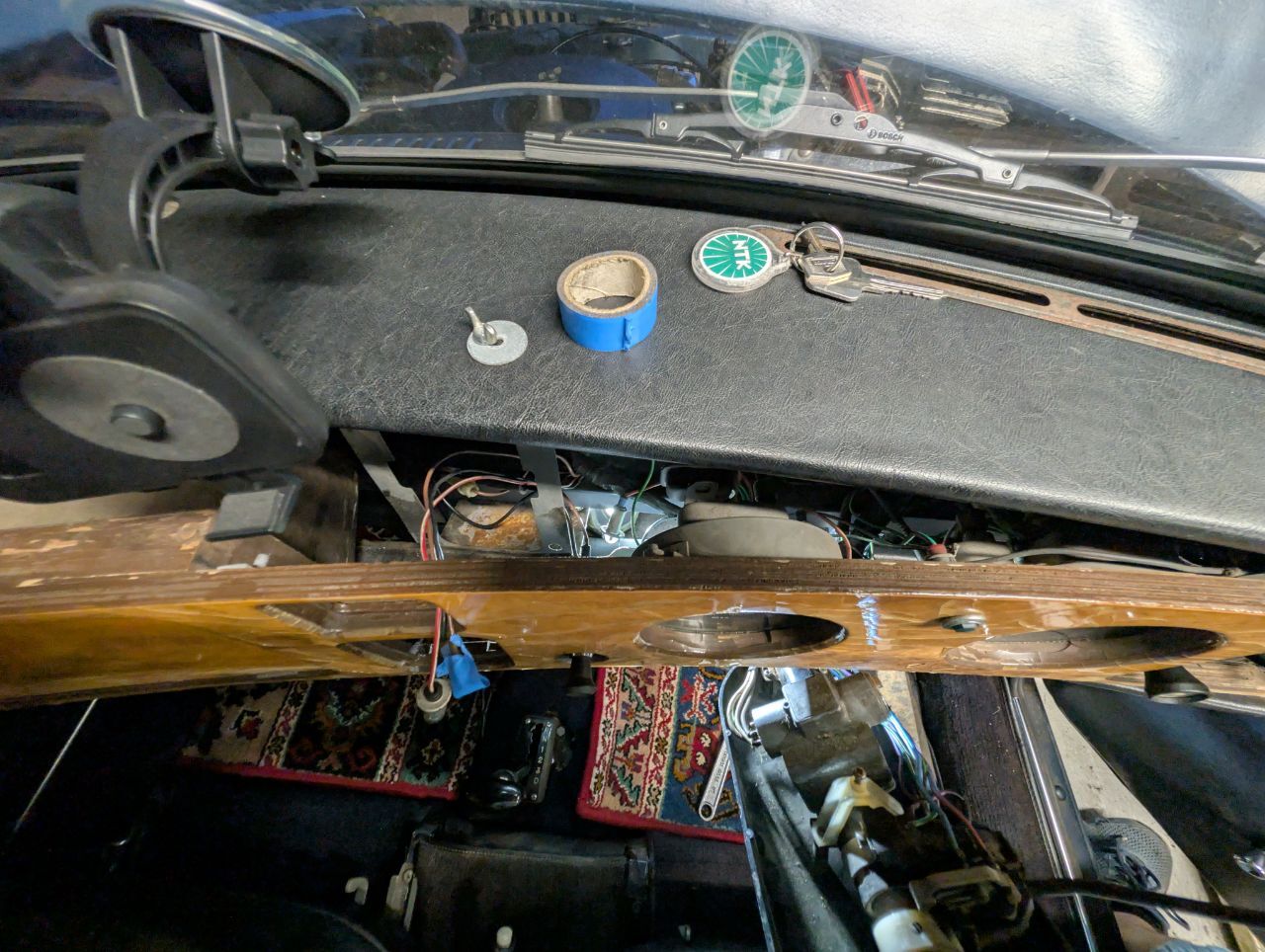

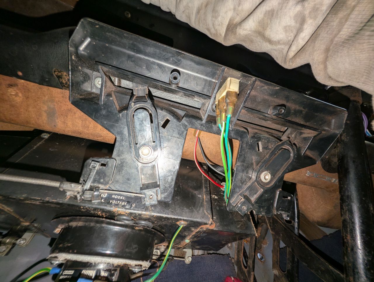

So last night I pulled the dash...

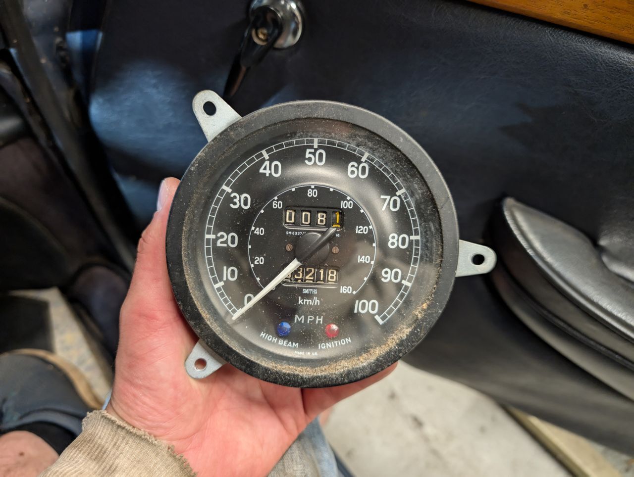

The main aim was to remove the speedometer. It does the typical old car thing of the needle waving about and it's also hideously inaccurate. Every time I've driven it, it's been getting worse. Andy told me it wasn't too bad before Scotland but during and after it has been worse. Also when the car is warm it's especially bad.
When it arrived, driving off the truck and into storage had it doing 20mph on the gauge despite being completely stationary. If I was doing 20mph here, I'd been through the back of the barn in no time!

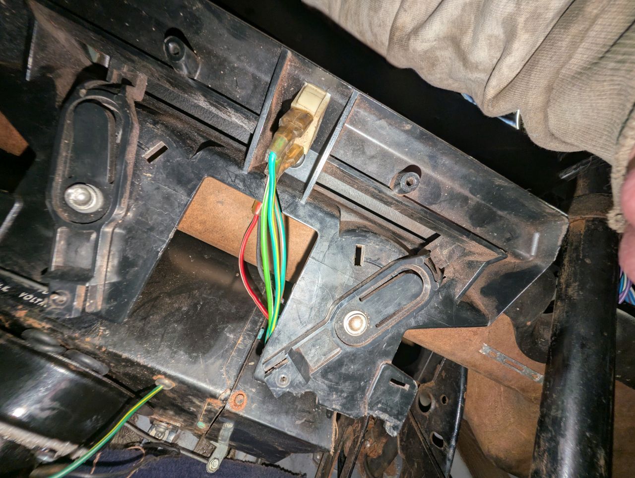

I didn't remove the whole thing. My expectation was the whole thing needed to come out however poking around the back I found a whole lot of wing nuts. No idea if this is factory (I suspect not) but it made removing it pretty easy. I also undid the top bolt on the steering column to let that drop down to give some more room.
Even with that all undone, it didn't allow the whole dash to move forwards. Wiring, oil pipes and such stopped it moving too much more.

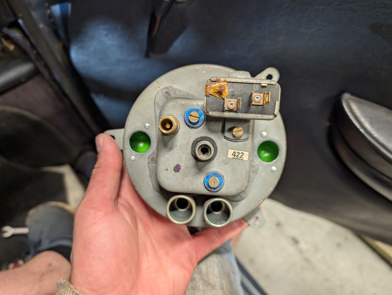

However just enough for me to get my hands and a small spanner in to remove the Speedo head.
The prize.

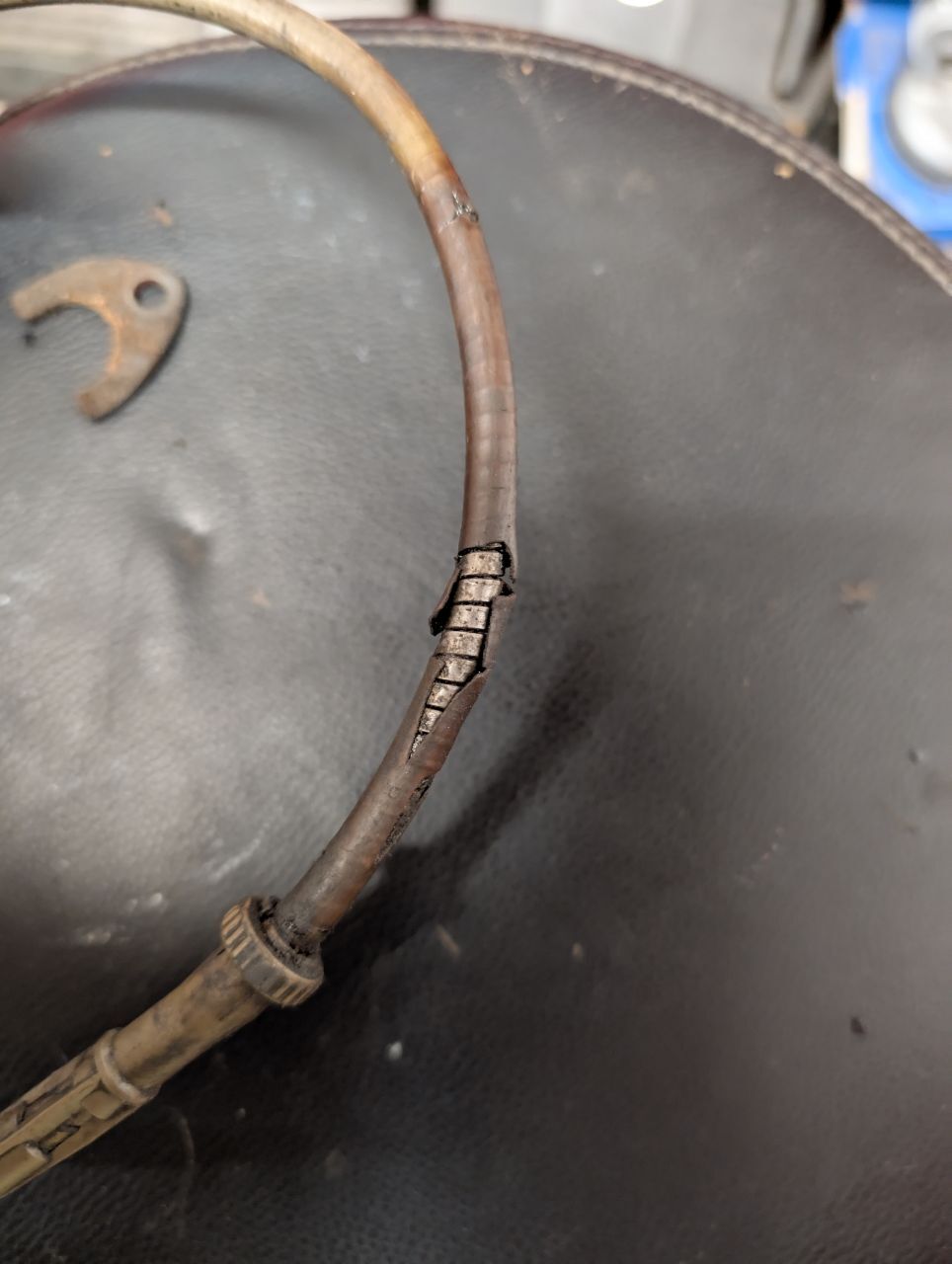

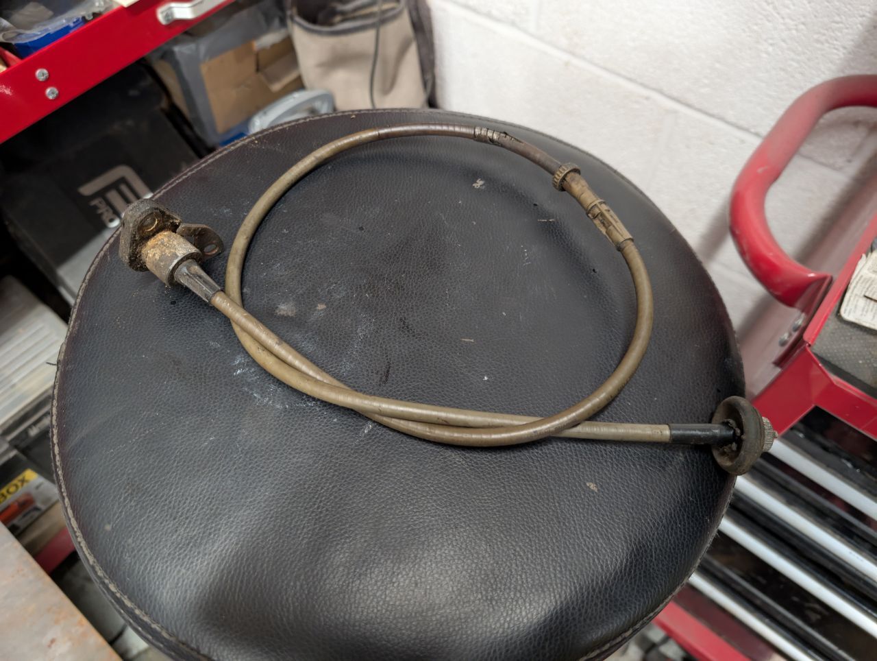

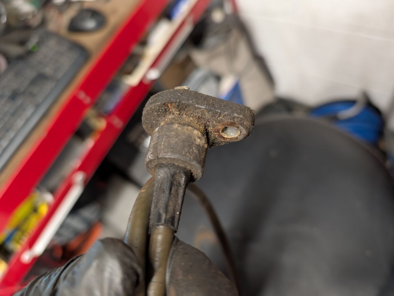

There was a whole lot of oil in the cable connector and pulling the cable out, it was filthy.

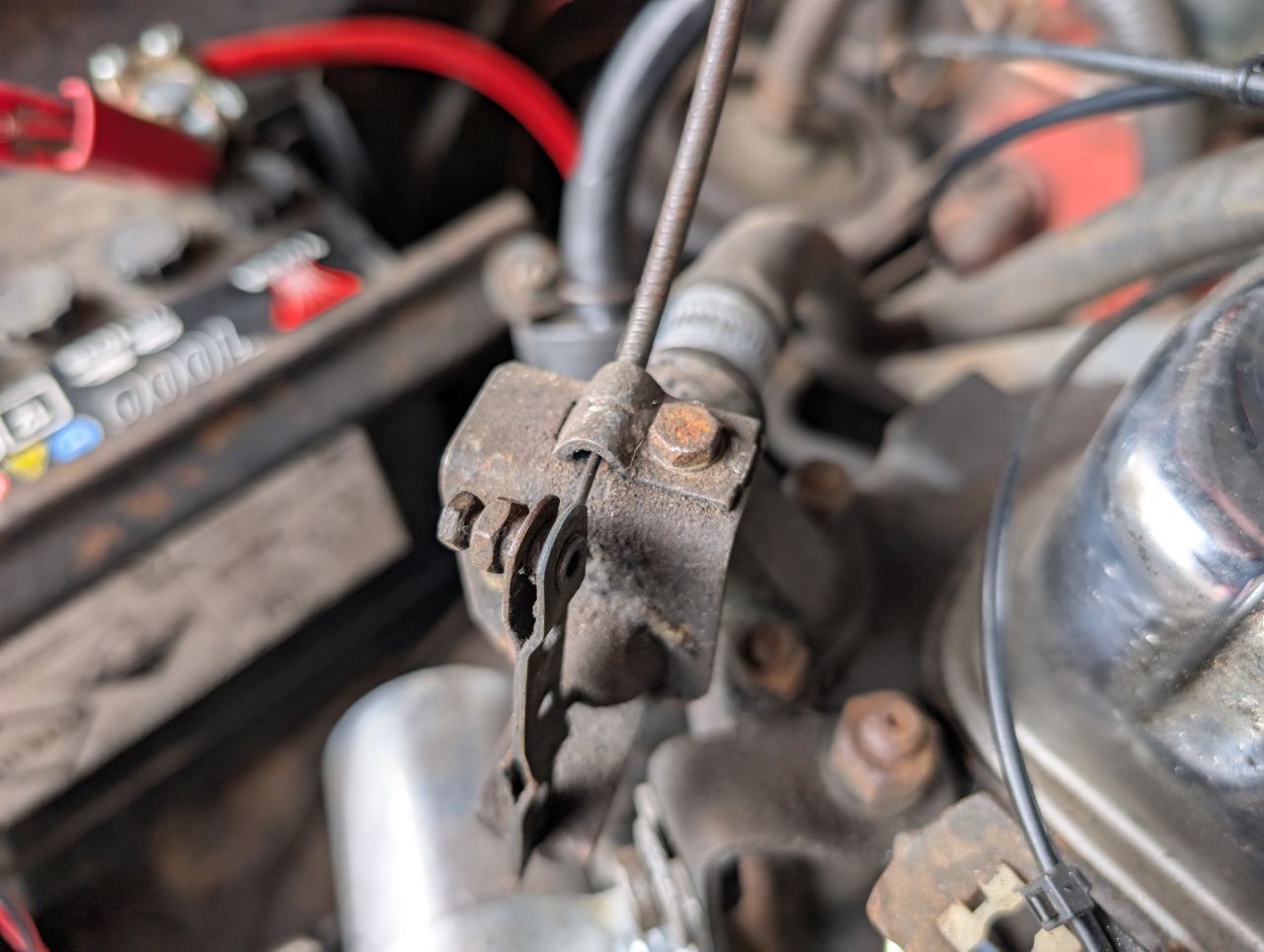

I decided to remove the cable for an inspection at least with a possible replacement.

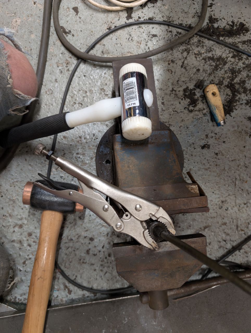

Getting it off the engine was a nightmare. I ended up removing the coupling so I could brute force the cable off on the bench/floor. Hitting mole grips with a nylon mallet (they're my good mole grips!) and coupling in a vice eventually got it shifted.

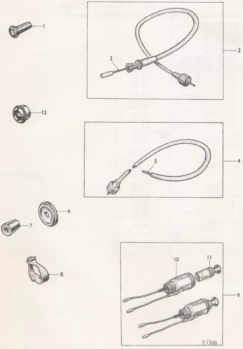

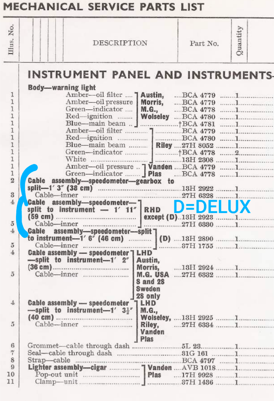

Cable itself is fubar. It's a two piece cable which is going to be really old and possibly original. They're all now one piece - presumably for manufacturing simplicity.
The worst bit is the top half to the speedo head. This melted/broken sheath section is near the exhaust manifold. So unsurprising it's degraded.

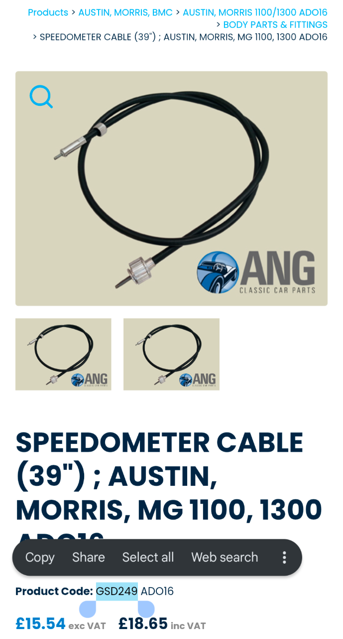

A quick Google said that a non-overdrive MGB GT speedo cable will work. 2 inches longer but what's that between friends.
GSD249 is the magic part number.
A "proper" cable from one of the 1100 part suppliers is £28. That cable above can be had elsewhere for £12 inc vat.
Last night I ordered it from MG Owners club store. Mostly because of cheapness but also because I ordered a few heater cables and pieces that I plan to repair the broken heater controls with. Again not exactly the same but slightly longer and hopefully can be made to work. £5 a cable each versus £25 from a 1100 supplier.

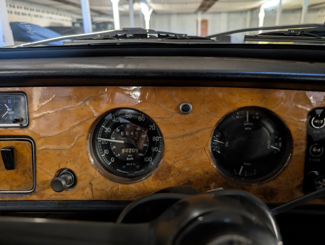

Is it the veneer itself failing or a gloss varnish is lifting? Not sure how viable removing one without damaging the other would be - if possible at all.
@Wibble may know a reasonable method of repair?

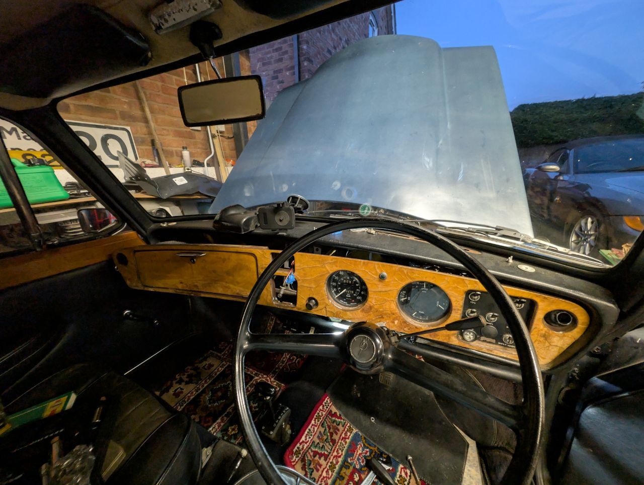

It's not only the lacquer that has gone but the wood veneer is cracking and falling off, starting to leave the base (ply?) wood visible.
I have some cherry veneer in the boot and my father was a professional carpenter (however he admits he wasn't that good and why he didn't carry on with it 😂), so in theory it could be done with old fashioned materials. Just that's a huge more amount of work that sticking a wrap on wood that's been smoothed off.
Yeah. I'm not joking.
I did the gear selector surround with that horrid vinyl on the RRC. It looked rubbish, and on a dashboard would have been really grim.
I'm not totally kidding about the Karndean. Their images are really good, and a board of it glued to something the right thickness then cut accordingly would look spot on, IMO.
Good grief, please don’t resort to plastic stick on fake wood. That dash looks eminently restorable to me.
It will be a lacquered finish and quite feasible to strip, re-lay loose veneers and refinish. There has been some shrinkage, but a hot iron and cloth should be able to melt the original glue and get them flat again.Stripping and sanding would bring back the original colour, you can’t match fading, so would look different but stick on plastic would be criminal, imho. I documented doing the real wood veneer of my Cortina Mk4 dashboard on my car thread, before they went plastic on the Mk5. There are places that will do this professionally , a line I suggested my past employers explore years ago. Loving the progress by the way.

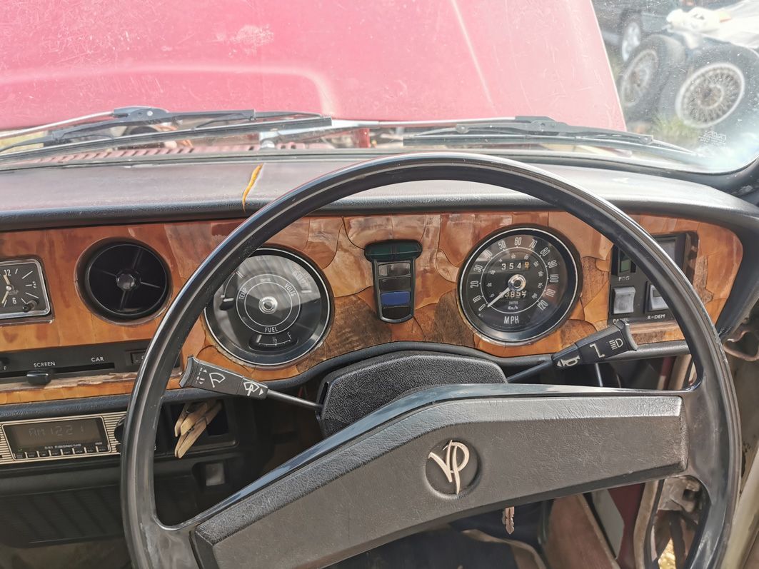

Flip side is that if the veneer is going to need to come off and be replaced, it's a cheap thing to give it a go. On the MK3 Austin/Morris 1100/1300 they ditched the ribbon dash and went to round clocks on a fake fablon style dashboard. So wouldn't be too out of keeping on what BL might have done in the 70s!
1972 Austin 1300 estate dash
Worse case if it looks crap then pull it off and do with proper wood veneer?
Or rewrap with carbon fibre effect wrap 😇

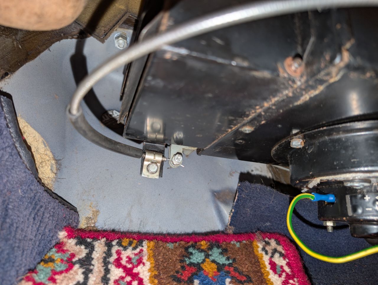

The two rubber o rings stuffed in the blower motor to stop it rattling are holding up well!
Having my foot wedged under it for a long time wasn't the most comfortable but at least it shut up the low speed rattling
Picture of my left shoe after
I couldn't figure if that motor was installed 180 degrees or so out. There are 3 fixing holes and only two have bolts in with the other having no hole in the casing. Also there is a small extension wire to connect the positive side. Plan is at some point to take it off and have a gander to see if there is anything that can be done. Whether realign or just drill new holes to match the motor.

Flipping it back again, at the moment the original looks salvageable, stick that fake stuff on and it won’t be. Originality and all that.

I'll take some closer up photos but the cracks you see aren't the lacquer coming off (well it is in parts) but also the veneer coming off too. There is even a small chunk completely missing. So while it can be re-lacquered, I imagine the cracks in the veneer would show through too?
The Triumph 2500 estate I borrow sometimes has had its wood covered in Fablon (sticky back plastic) because it had lots of peeling veneer and lacquer.
Looks ok at a glance, but does not stand up to inspection.
This is probably the easiest example to give without taking new photos (I'm in the office so not near).
Starting from around the air vent is cracked lacquer. However as you go down, that veneer is cracked too.
Is cracked veneer saveable? Or would there be lines all over even if restored?
Yes, it’s still salvageable. The cracks are natural shrinkage, you’ll see the same on an antique burr walnut veneered table. They can be filled and are just a natural sign of age and part of the patina.
  • Thanks 3
I'll leave it alone for now. To do it properly will require removing the whole dash and all that entails. It's not trivial to remove like many other older cars as everything is attached to the loom. I don't want to start disturbing old wiring as that risks ends up creating new electrical issues.
