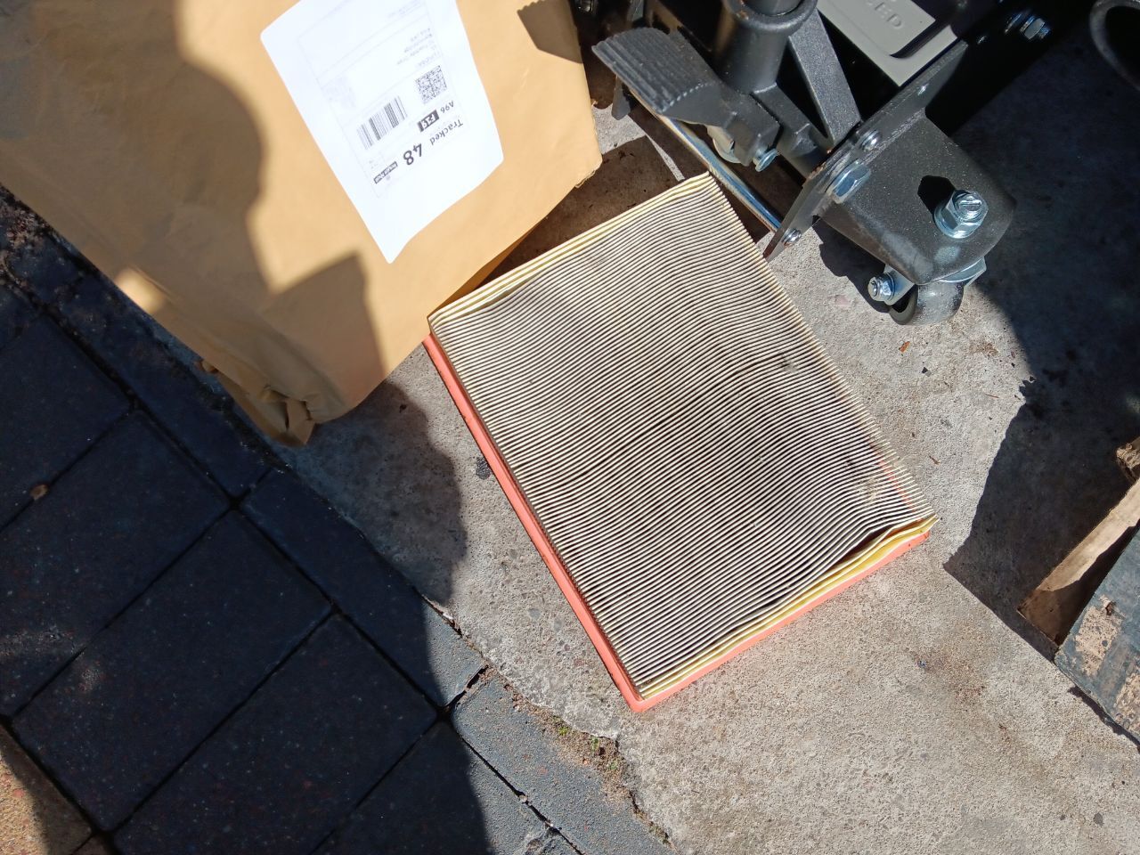

I need to get a new air filter as judging by the rusty screws on the air box, it was done quite some time ago.
Yes, they are rusty. That was going to be the next thing on my list.

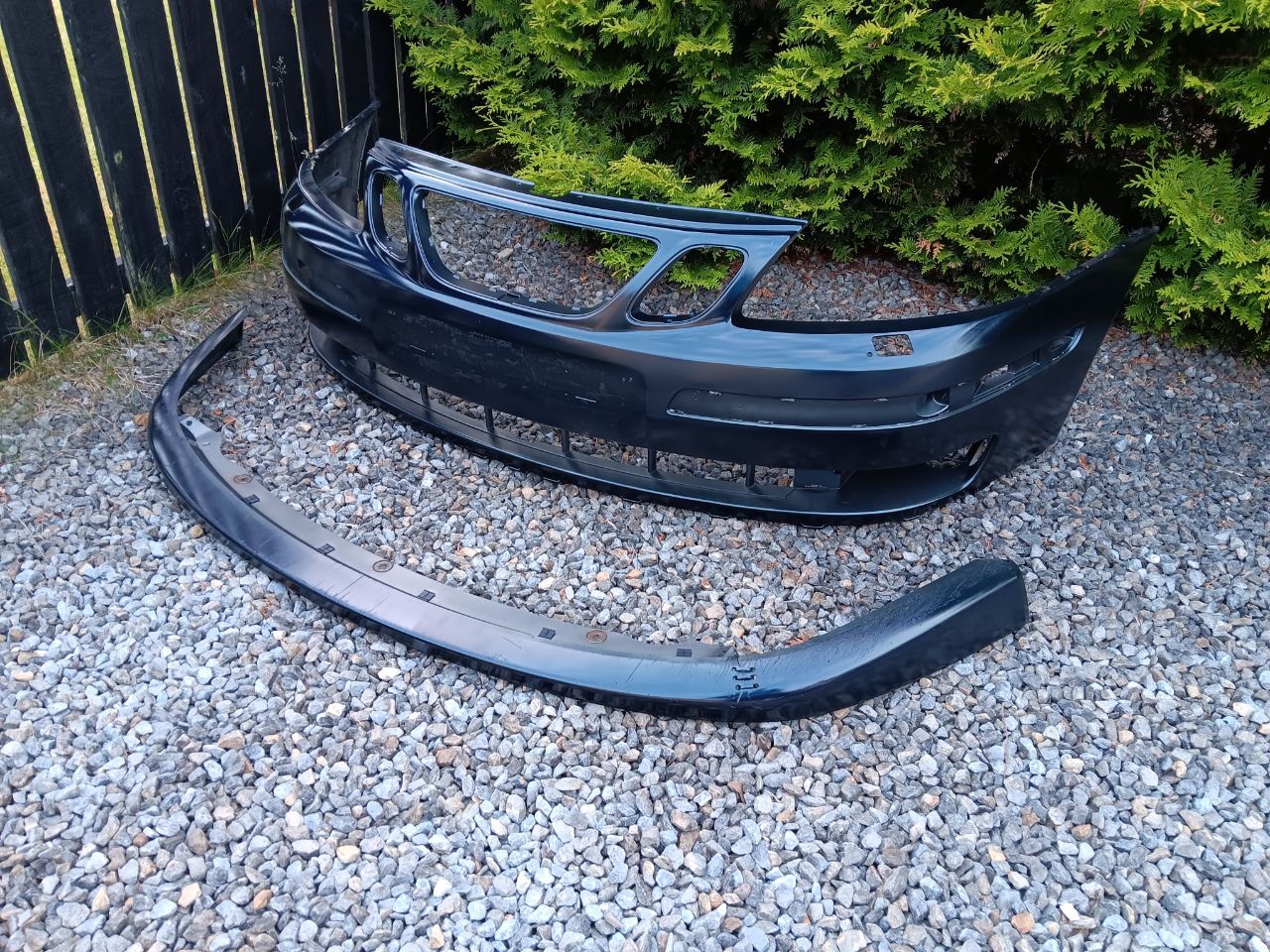

New bumper collected tonight.
Convertibles are great for collecting bulky items. Just drop it in and go!
I changed the air filter tonight. The screws were rotten and one rounded off, bloody Torx crap.
Old one wasn't too bad:
4 is enough to hold the airbox for now, I'll put a few in my toolbox buy a few next time I'm at U-pullit.
I've sanded down the new bumper. Unfortunately there are a couple of small splits but they are hidden so holes drilled and cable ties applied. The paint has arrived too, I'll lay that down when I next have time.

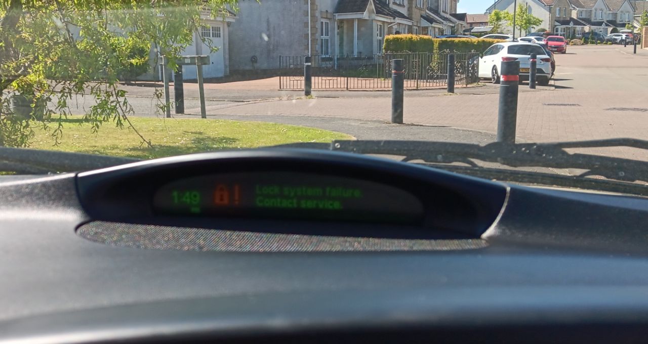

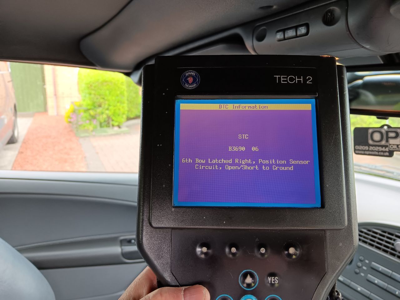

Complete failure of the drivers door electrics all of a sudden. Lock and drivers window not working although all the others are. The soft top goes down but frequently stops saying manual operation only.
Will need to get to the bottom of this as I don't want a Saab Coupe 😂

I dug the car out the garage last weekend and since the weather cooled, everything has gone back to normal. Apart from the car thinking I'm trying to open the roof while driving and at the same time telling me there's obstacles in the boot so I can't. There's a lot to unpack there.
Anyway, it's been largely fine and drives well  but I wanted to identify what had been going wrong.

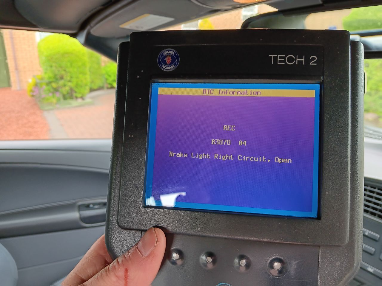

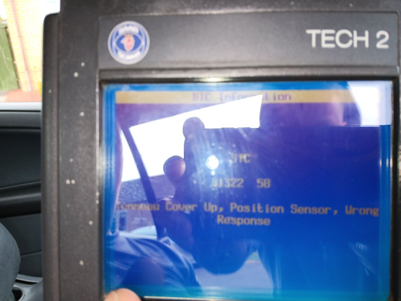

So, I dug out the details of a Saab guy that @SRi05 had given me years ago and gave him a message.
I drove over to a less than fantastic area of Glasgow tonight and he plugged his Tech 2 in.
20250529_165546.jpg.07231e48e020841ef07465dfb067ff48.jpg20250529_165501.jpg.45c27ead72f825ee09007ab1e1e8d905.jpg
No surprises except nothing stored for the door shiz. At least the door module is not fucked which is good because you have to divorce and then re code a replacement. He recommended cleaning the contacts in the loom plug and on the modules themselves, so I will do that. Oh, and replace the brake light bulb.
Can't believe I'm talking about modules and codes on Autoshite. Who'd have thought.
I'll need to get the bumper finished off as well as the paint that's on it went down quite well considering.
Wires broken in the door cables? That used to be a problem back in the day - no idea if still the case. Plus the modules play silly buggers and stop locking but I'd thought you'd got errors for that.
Yeah I got a message saying there was a door lock error.
I think, potentially, other than checking the plugs/loom, my fix will be to not ever press again the interior lock/unlock button 😂

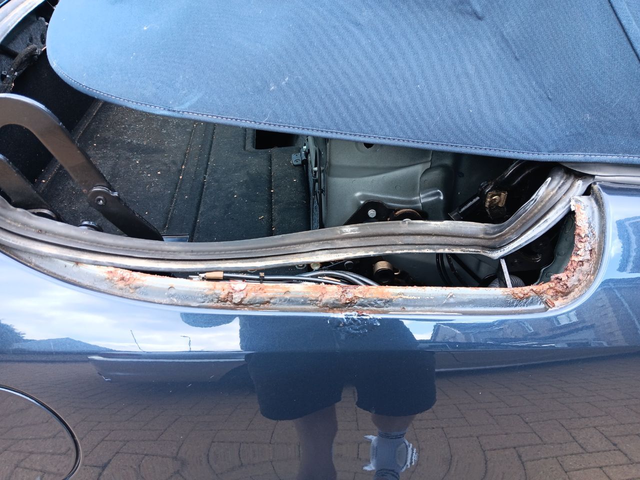

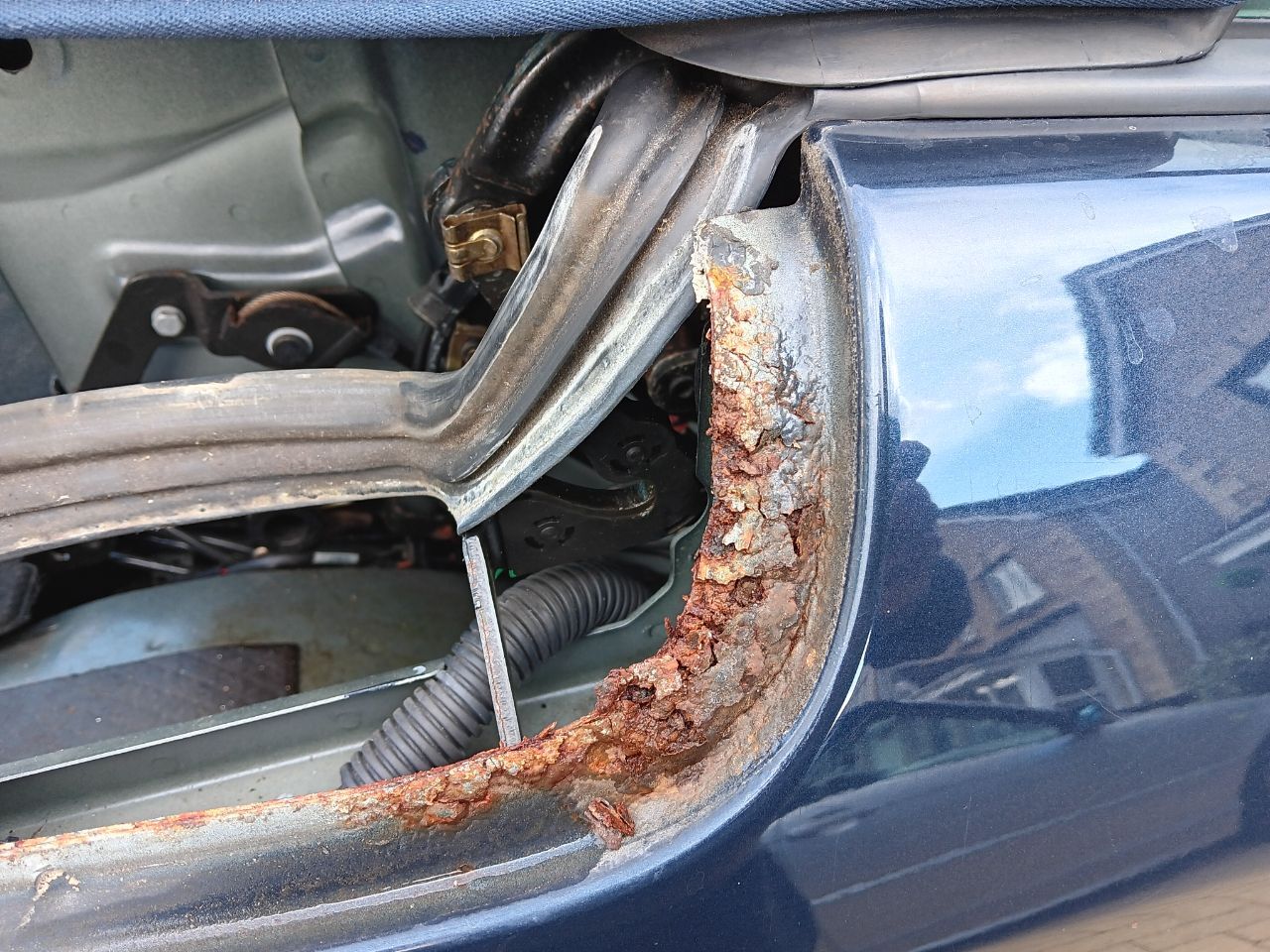

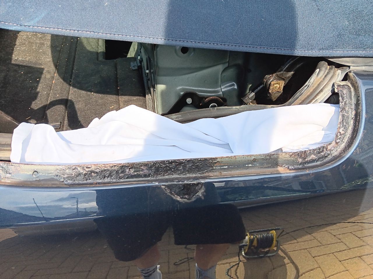

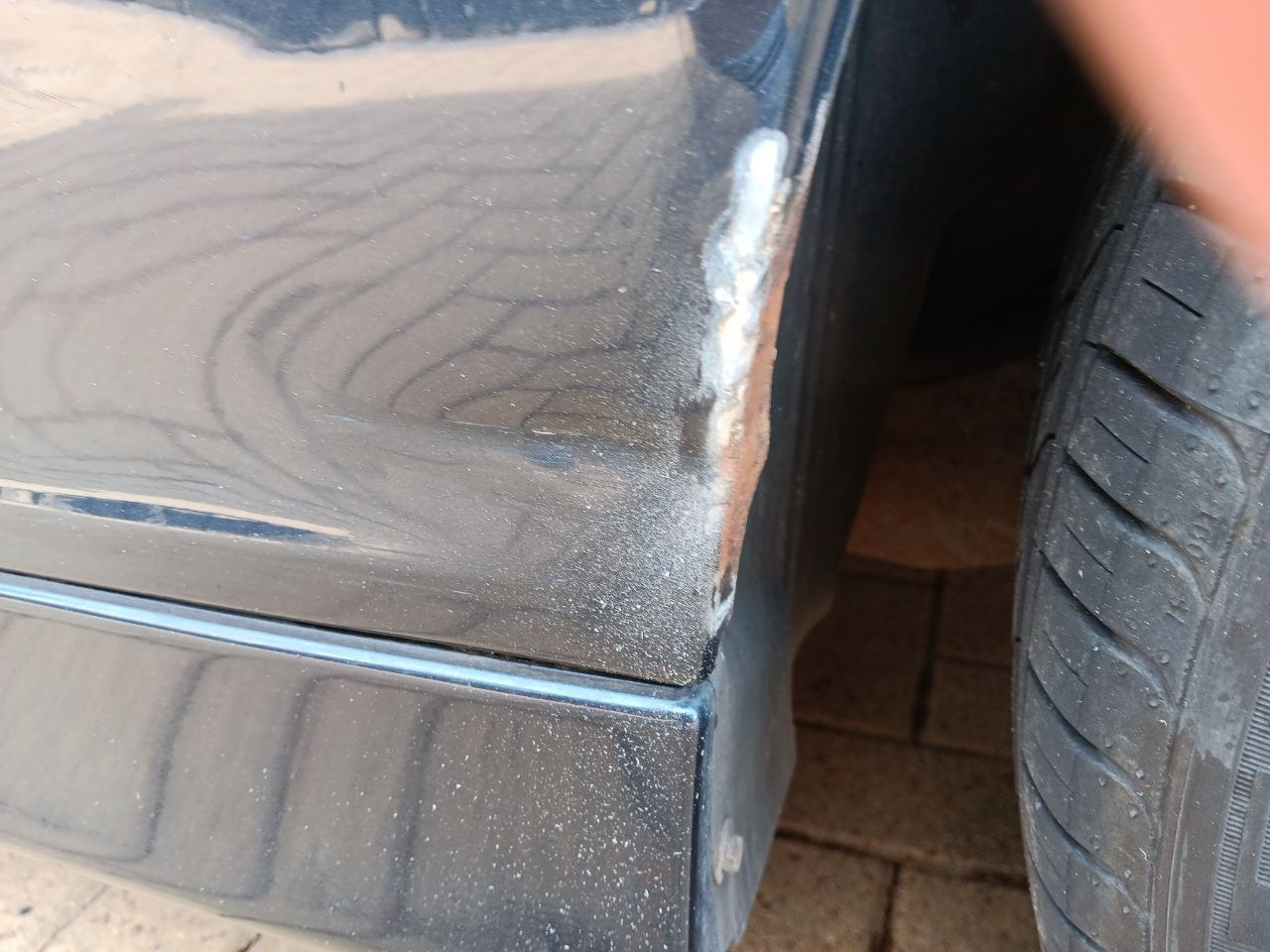

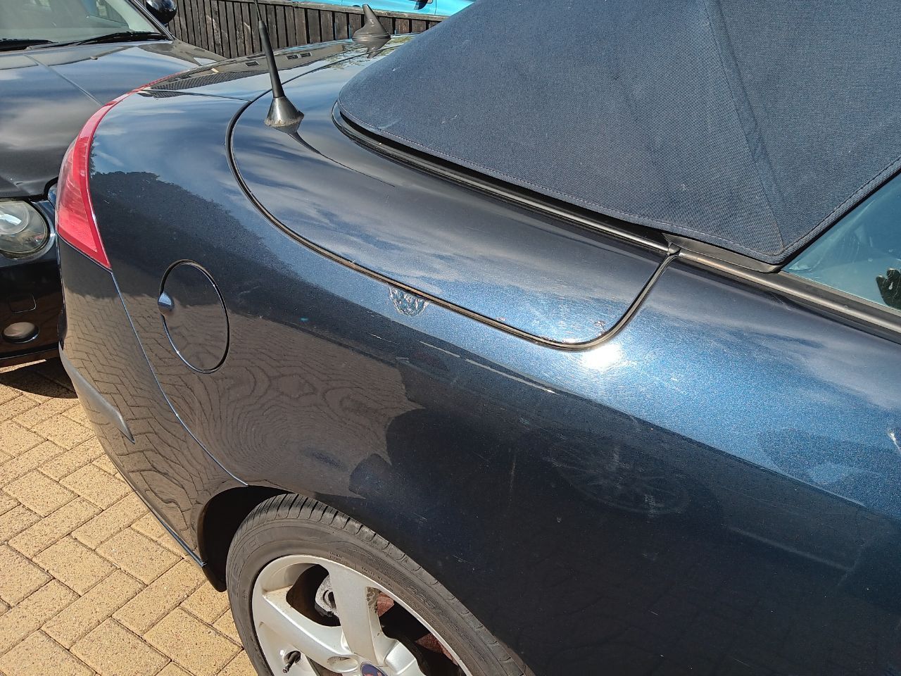

Next job, some rusty bits.
Thankfully these are the only ones.
Hmm
Thankfully it's a seam so there are 2 skins. The outer one is a bit thin but the inner is fine.
Better
20250530_155316.jpg.cb708d52904cbf1bb688a05a6c54113d.jpg20250530_155304.jpg.a402881931fcd604adefbaea83a675bf.jpg
A coat of Vactan
A coat of special* paint and then some approximately blue paint from the garage.
I found a touch up pen rolling around in the spare wheel well which was great, so I could touch in the visible surface in the right colour.
The paint is quite nice in the sun.
Same for the wheel arch. Its only rusty because its taken a kiss as some point and burst the paint.

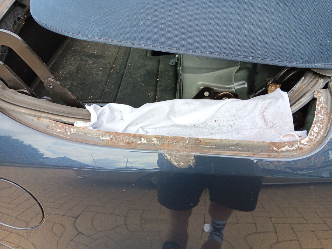

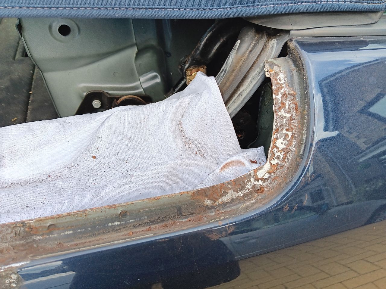

Sanded
Vactan
..and then special paint, before colour
Front bumper next!
Hmm
*snip
:o
Is that normal for 9-3 'verts? I thought they were mostly galvanised.
2 minutes ago, 83C said:
:o
Yeah they all go there, the rubber traps moisture. I normally leave them alone but I wanted to remove the visible bleb. Sadly they're not galvanised and they do rust but nowhere near as bad as earlier 9-3s or the 9-5. The bonnet is aluminium 😬
  • Agree 1
Surprised given where it was made that they didn't galvanise them. I saw the bleb just below the panel line and thought oh, that'll be alright for a while, had no idea that was just the tip of the iceberg!
Didn’t see this when you originally posted! It used to do that to me randomly on occasion. I found wiggling the wiring bundle coming from the door generally fixed it for a while.
It was very random, but I did find it was more likely to do it if I opened the door fully to the limit of the hinge.
Aye it's been OK for a bit now, definitely the loom then, fix process noted!
These are actually made by Steyr-Puch in Austria who build anything from trucks to kids bikes. They have their weak spots, rusty rear arches normally indicate the cars too far gone, so this ones good! They also go in the outriggers under the floor and in bad cases the sills can corrode. But overall they're not too bad compared to older Saab designs.
The facelift models are built from notoriously shitty metal and rust much worse, I probably wouldn't bother with one of those.
  • Split_Pin changed the title to Forum Saab IV: Good Bumpers
3 minutes ago, Split_Pin said:
I finished painting the new bumper today.
Looks alright for a rattle can job!
It really does, I’m impressed, fair play, it’s way better than I’d have achieved.
Looks really good, damn sight better than I can manage anyway.
That’s going to look spot on when it’s fitted.
Cheers, it's nowhere near as good as a pro job but I didn't want to bother Gingernutzz with it as he's already having the 75 over in a few weeks' time for a fair bit of work.
I'll start building the bumper back up tomorrow before swapping them over. I'll be glad not to see the sellotaped original any more!
