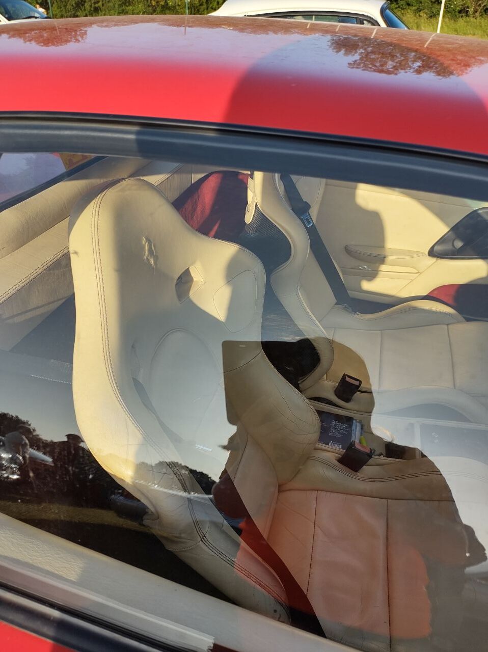

Have a couple of pics of it after my first drive in weeks...!
IMG_20250607_114031935_HDR.jpg.a200189458283925770487bfcb8d8d7f.jpgIMG_20250607_112433194_HDR.jpg.fdce3262001da5e2f9b51de57f1e0831.jpg

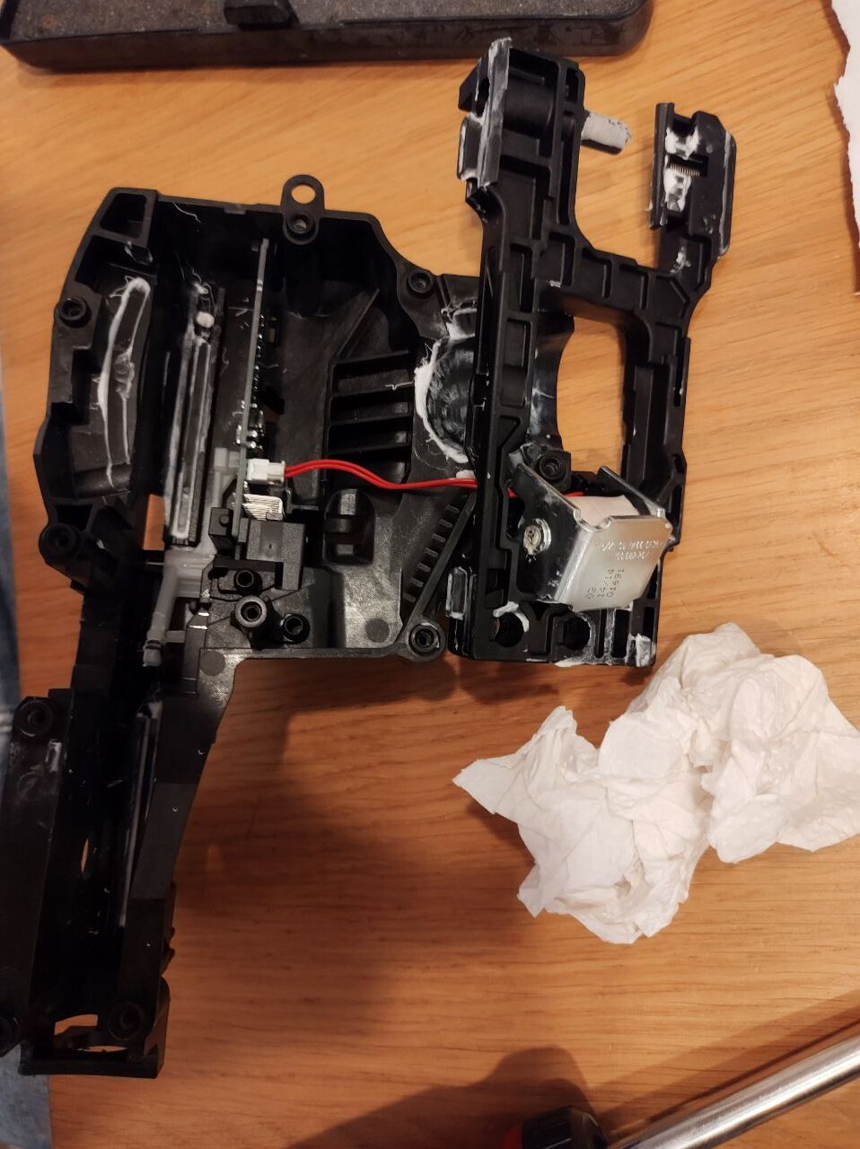

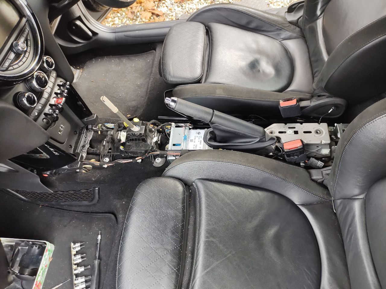

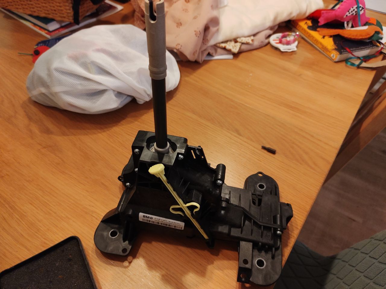

The Mini has now decided that opening of the boot is not possible. I've had a tinker for 20 minutes or so and got the panelling clips out, but nothing doing. Probably needs a new latch as I can hear it actuate off the key or external handle. Just physically not undoing. But I need to be able to get at it first...
Any ideas on how to get at it from experience of F56s from anyone??

And not a lot has happened..! Still awaiting the boot latch for the Mini. Seems my order from Lithuania is taking an age. Happy to wait - £35 vs over 200 from Mini....

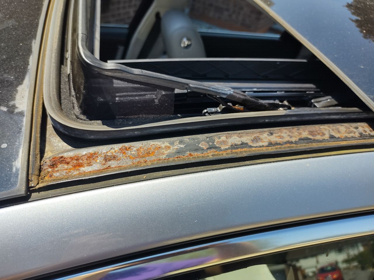

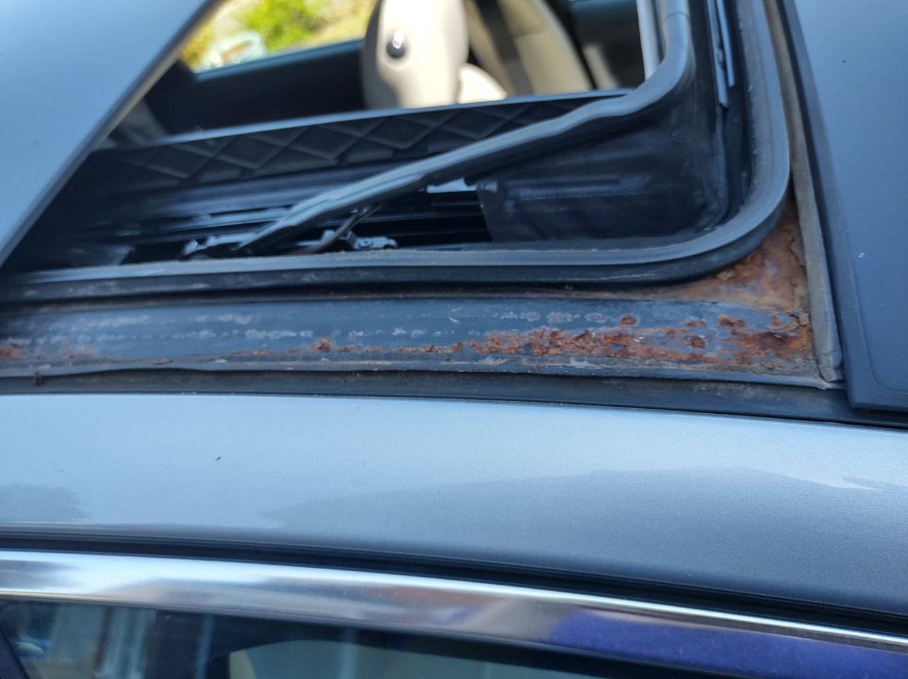

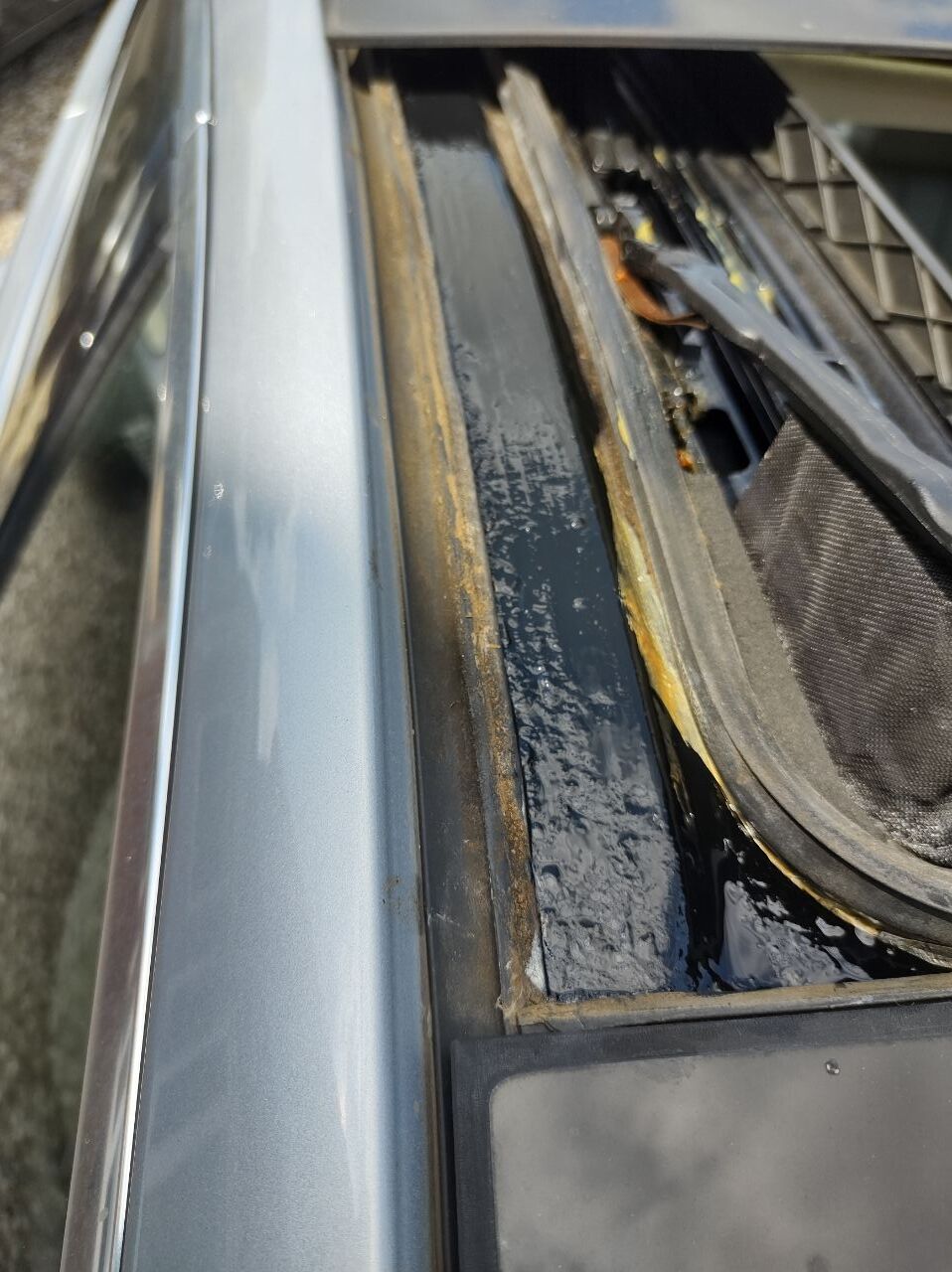

Finally, the Jag. I've been wanting to do something about the creaky roof for some time. I grease it and it's quiet for a few weeks before starting to knock/creak again. They all do it pretty much ..
I'd seen a chap online who'd put some thick tape along the edges with good success. Mine already had old tape on but very thin. So I removed it. To find:
IMG_20250712_113916958_HDR.jpg.885fd9d7297f351d16dbed9a37472856.jpgIMG_20250712_113714864_HDR.jpg.60be600c583c27cb1ad04dd538865e6b.jpgIMG_20250712_113928748_HDR.jpg.cec676b18e81319aea8975fde6c3496c.jpgIMG_20250712_113728743_HDR.jpg.8e7cd750e73cccdec44c7fec08731bed.jpg

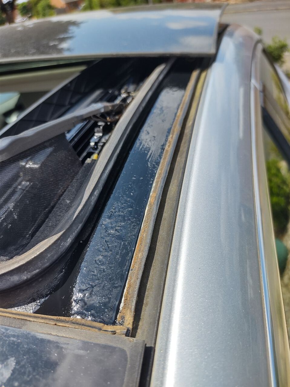

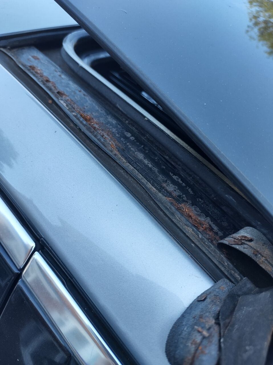

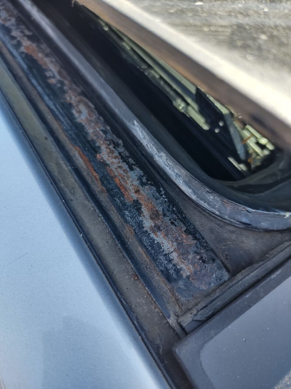

Hmmmmmm, grotty. Seen worse etc and can't get upset really as, again, they all do it. So, set to with sanding it back and then two coats of kurust, then two coats of fake hammerite:
IMG_20250713_125457205_HDR.jpg.cf9df83a44e736a493125d872da1ab11.jpgIMG_20250713_125513251_HDR.jpg.c3164853ec1cd9a3dc30071ac070db40.jpg

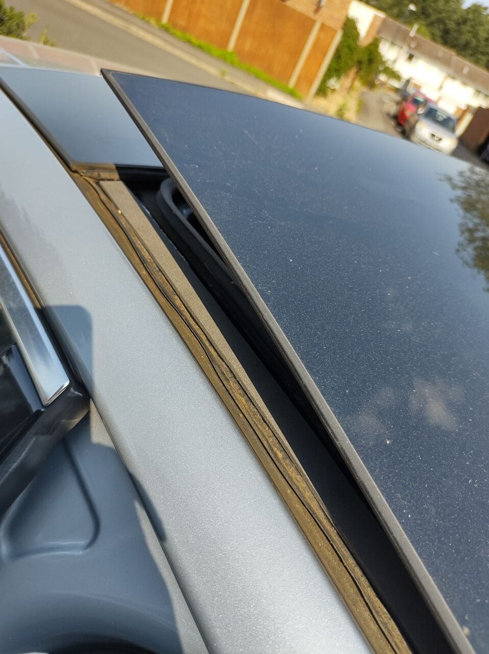

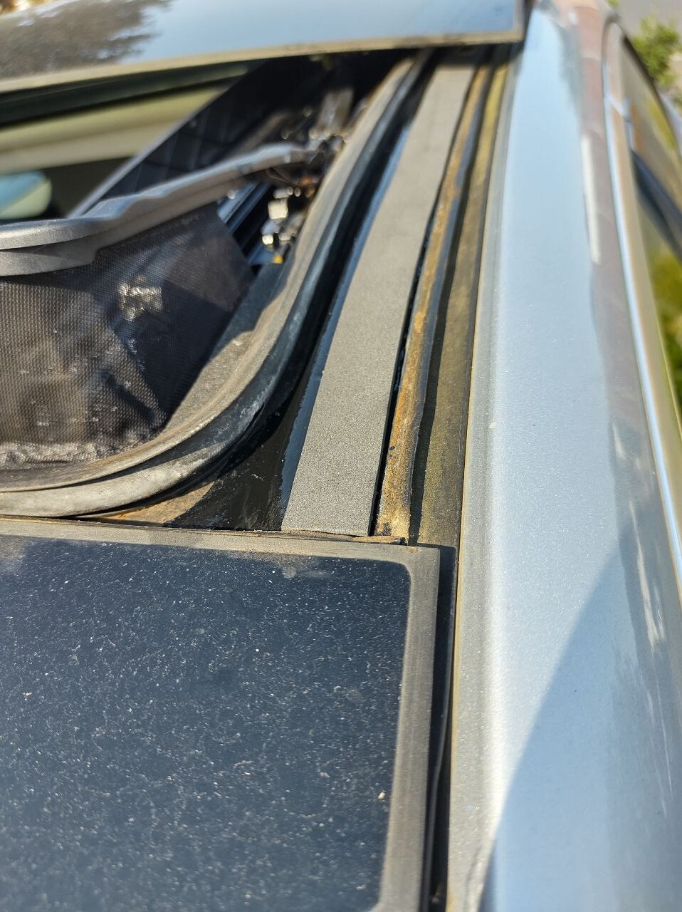

Then finally some new deep tape to hopefully make it less noisy on the move:
IMG_20250714_095547525_HDR.jpg.885b40f9eb4897028996c2e3245633dc.jpgIMG_20250714_095619353_HDR.jpg.4a19f36e737b05890d05b1875d5855ef.jpg
We've a trip to South Wales at the weekend so that should be the acid test. Also, partially in prep for that, I've replaced the pollen filter. Best £6 I've spent in a while:

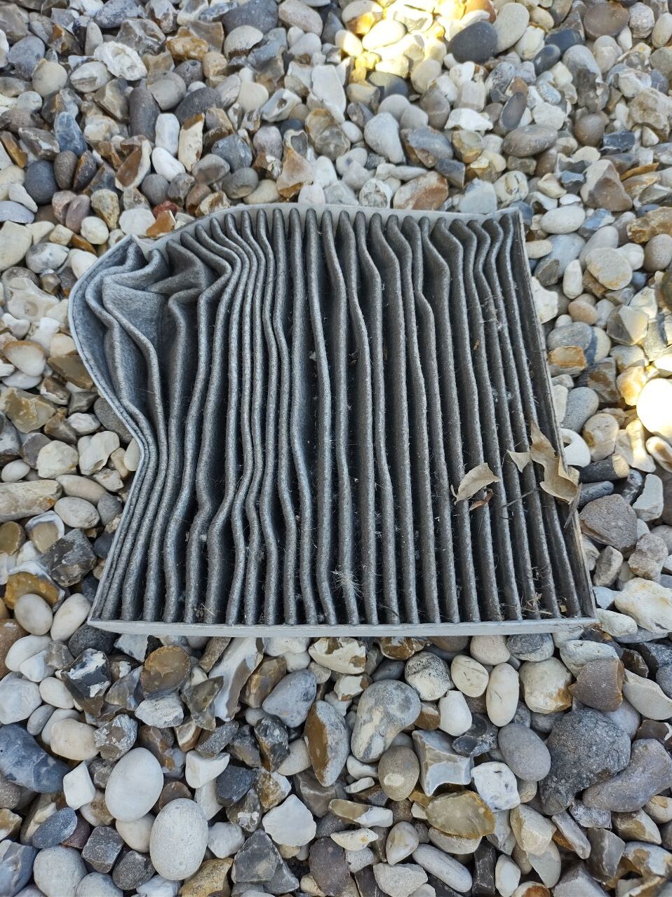

Pretty grotty and now with the new one there's a much less foisty smell when not running a/c. A cheap win.
  • 2 weeks later...
440 miles complete in the Jag over the last week to South Wales and back Zero noise from the roof to report, so my thick tape fix appears to have helped massively (for now!). Even bigger test coming soon with a road trip through France.
The Mini boot is finally fixed. The latch arrived before my jolly to Wales but I had Covid and felt crap. Easy to unbolt but a pain to unplug. A bit of corrosion on the plug so cleaned that up and all back to operational. It has its MOT on Monday so fingers crossed for that...

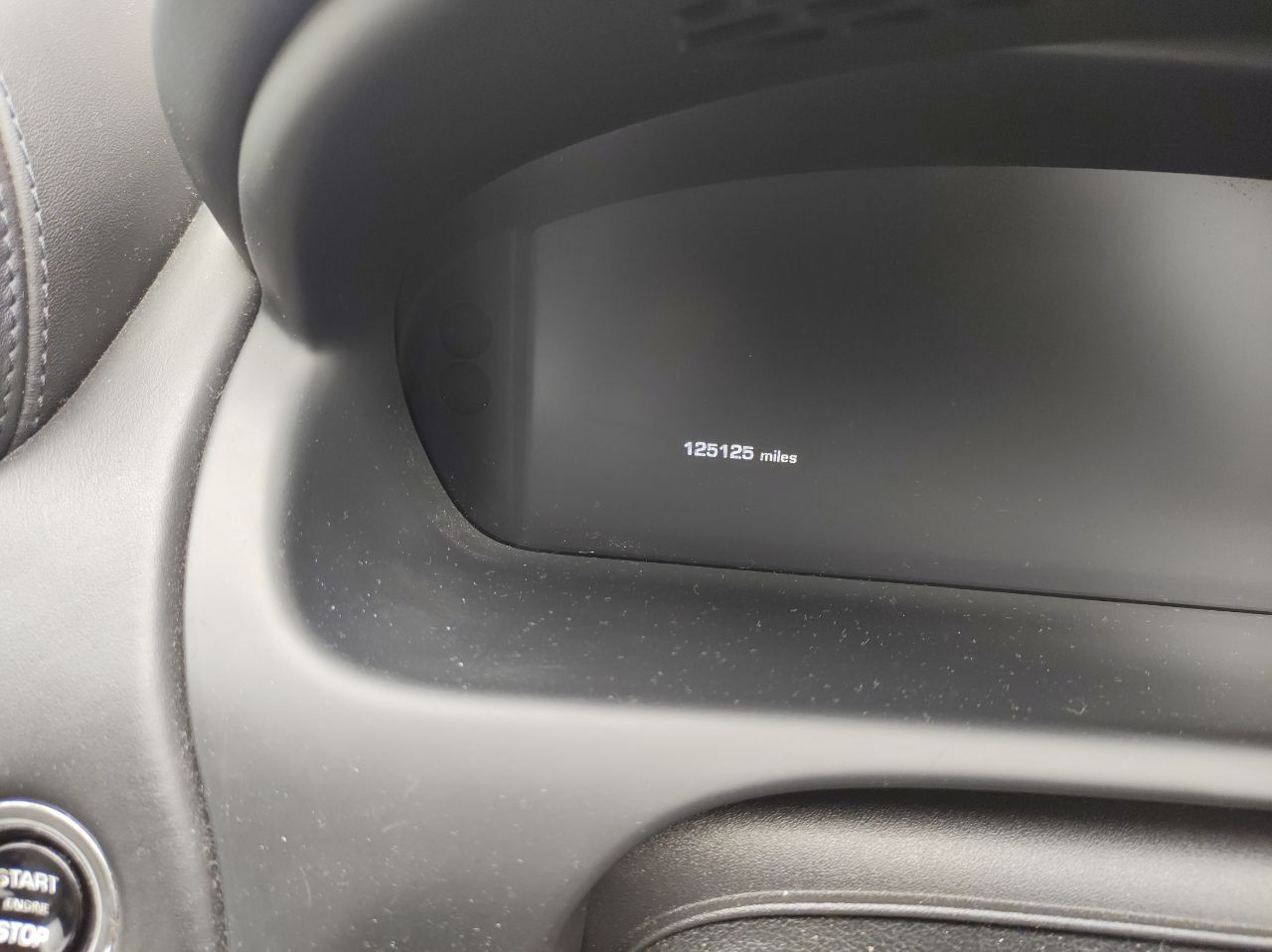

Oh and having just popped out for post-holiday essentials, we now have this milestone reached:IMG_20250831_123354733_MP.jpg.905e31befe35d0401c72e3135465511b.jpg
