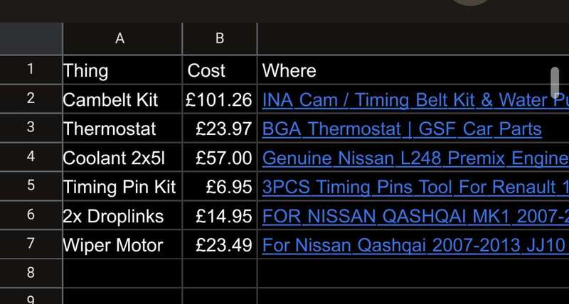

Gah, if I'd seen this 20 minutes ago before I fired the parts cannon I'd have saved myself a few quid... But I didn't and now have 2x 5l coming from that exact link (or the other identical one that as above it)ย
Screenshot_2025-02-08-12-47-58-34_f90b96e7af3c5a594eb0c92de7fc5fe1.thumb.jpg.fa6959737946cb48cc35a09074699781.jpg
ยฃ220, not awful.ย
