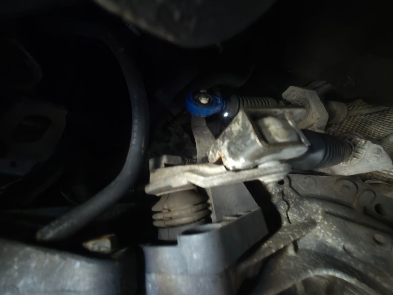

Also looking at the black cashcow/gear selector pic, it has a bodge clamp over one of the gearcable ends in the engine bay. Check there's no play in the socket, as the bodge clamps are fitted to stop cable popping off, i guess somebody has had issues before

The black qq (my mates wife's) certainly has issues in the gear dept. Tbh the gearbox side is better, it's the gear shift mech in the car that's fucked.
I think the centre pin is snapped which causes the issue, and can be fixed with some drilling and a big long bolt. However I'm trying to find another unit (5 speed manual if you know of any/if it's the same part in x or y) so I can mod it without disabling their car (when it's not doing that itself) then swap the whole unit in. Will buy a big pack of the end clips/bushes too as mine click on me, and the black qq's are quite sloppy.
If/when we get that far and sort that and have spare end bushings at hand I'll maybe then look at the bodge clamp 😂

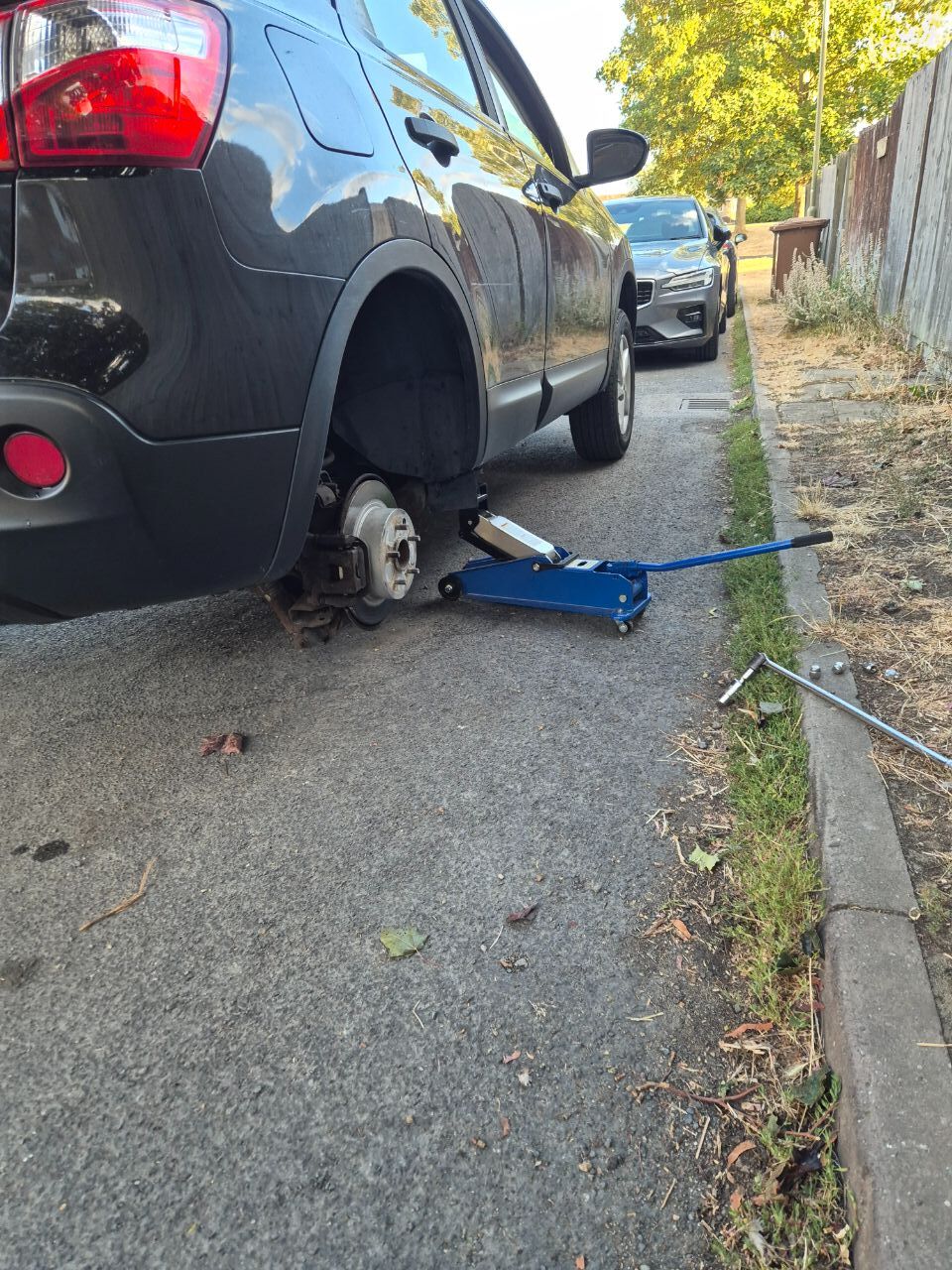

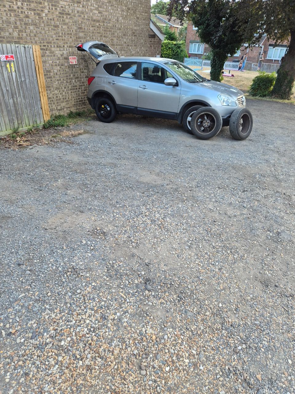

My friend booked their mot for tomorrow. Which meant a job had to be done.
Its now wearing my rear wheels. Has to be wearing both as their a size bigger than the black one has.
20260806_192253.jpg.dac502e06456d72ed5edddee9c1d6b7b.jpgThe rear tyres are quite shit, and would be a fail. So it's borrowing my excellent wheels (as it's not a fail to have a different size front to back as long as their the same on the axle) to avoid an easy fail. Once it gets through the test new tyres will be obtained.
The fronts are on the edge though... Almost right on the wear marker but not many miles into it like the rears were. Probably be a balance of 2 new tyres on the front then 2 good part worn tyres on the rears.
Then all needs to be swapped back before my mot on Monday 😂

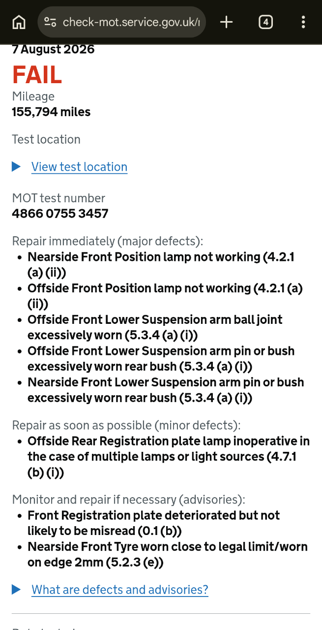

Oh dear, it was a fail
Is that the front side lights that are out? Tbh we didn't do any light checks, that was silly.
2x new lower arms ordered to sort fails 3,4 and 5
Garage quoted him £500 to sort it all 🤮
  • beko1987 changed the title to 2009 CashCow - Mates car failed
£497 inc vat, 3 hours labour and tbh not awful parts prices, pretty much double what we spent on the ebay arms and probably the same parts.
They could have had it sorted today too which was even more reasonable.

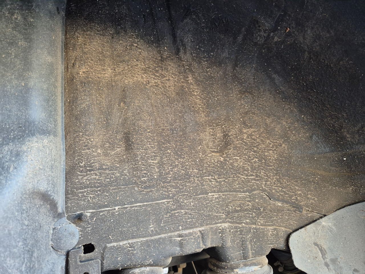

The last thing I spotted was some surface rust on the inside corner of the sill. Was under that side checking no more exhaust clips were fucked and spotted this beginning

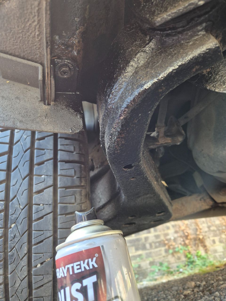

Had half a can of rust converter about so fixed that
And used the rest on the back of the rear subframe.

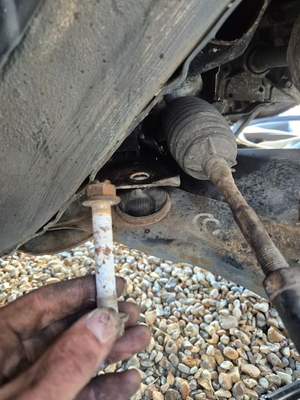

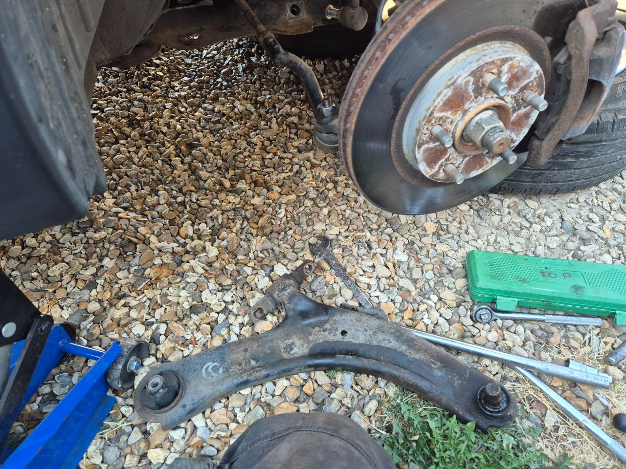

What a fucking lovely evening for front arm replacements
The car has had 1 new passenger side shock in its past
Didnt take long, everything cracked off really easily. Almost too easily...
No fight from anything
This little Aldi wrench made a great nut runner
All the bolts put up no fight
Certainly doesn't look great (both these failed)
But soon! Even the bottom ball joint came out of the hub really easily, and near slid back in by itself. I manouvered the hub and strut more than I did on mine to line the back bolts up and it worked so much better

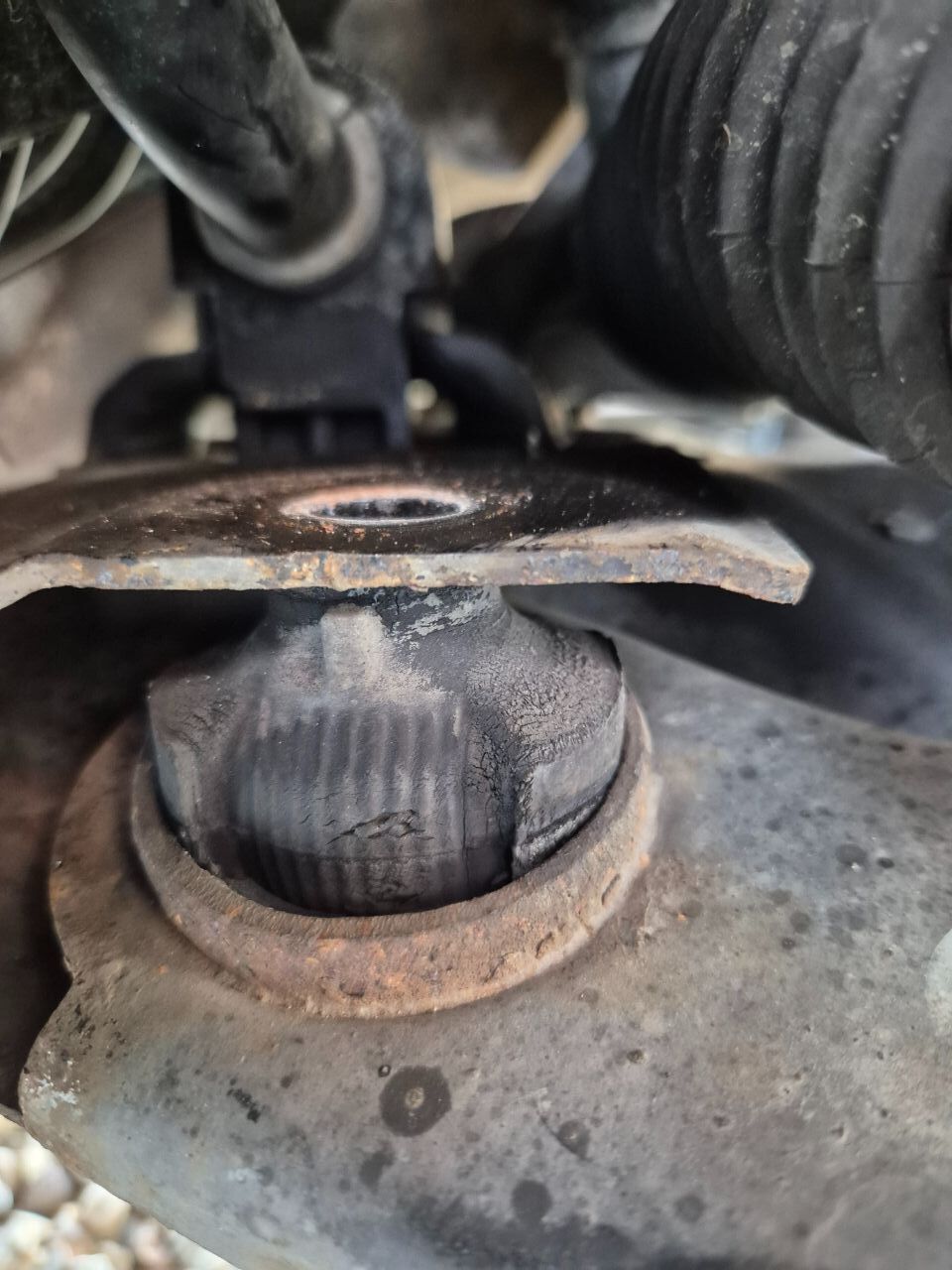

The passenger side was a bit worse
And neither lower ball joint great so no harm done changing these.
Got a better look at the gear cable bodge bracket @Brigsy. Sure is loose in itself although securely attached. Guess I won't know if it just needs the new bushes and clips or not without taking it all apart 😬
Passenger side was soon done

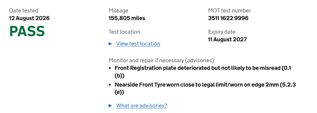

Mates QQ just passed it's re-test
Tyres are next on the expense list for them and we need to fit the clutch master cylinder soon but after that hopefully it will be fairly trouble free for many months 🤞🤞

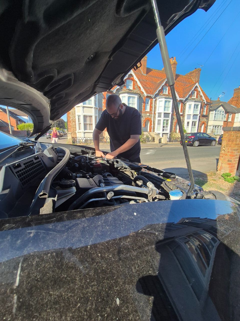

Was silent the rest of the day but when I got home I popped the bonnet and spent a good 5 minutes studying everything and there's nothing obvious. Which is annoying as I'll probably need to take the aux belt off and spin things by hand (watch it be the bastard air con compressor now it's all working lovely 😡😂)
Certainly sounds like it comes from the outside of the engine so I'm not too worried about the cambelt exploding off, but ive got things to do pretty much every day for the next week inc Spalding and back again so it needs to behave for now/become really obvious in a non destructive way so I can quickly replace whatever it is)
