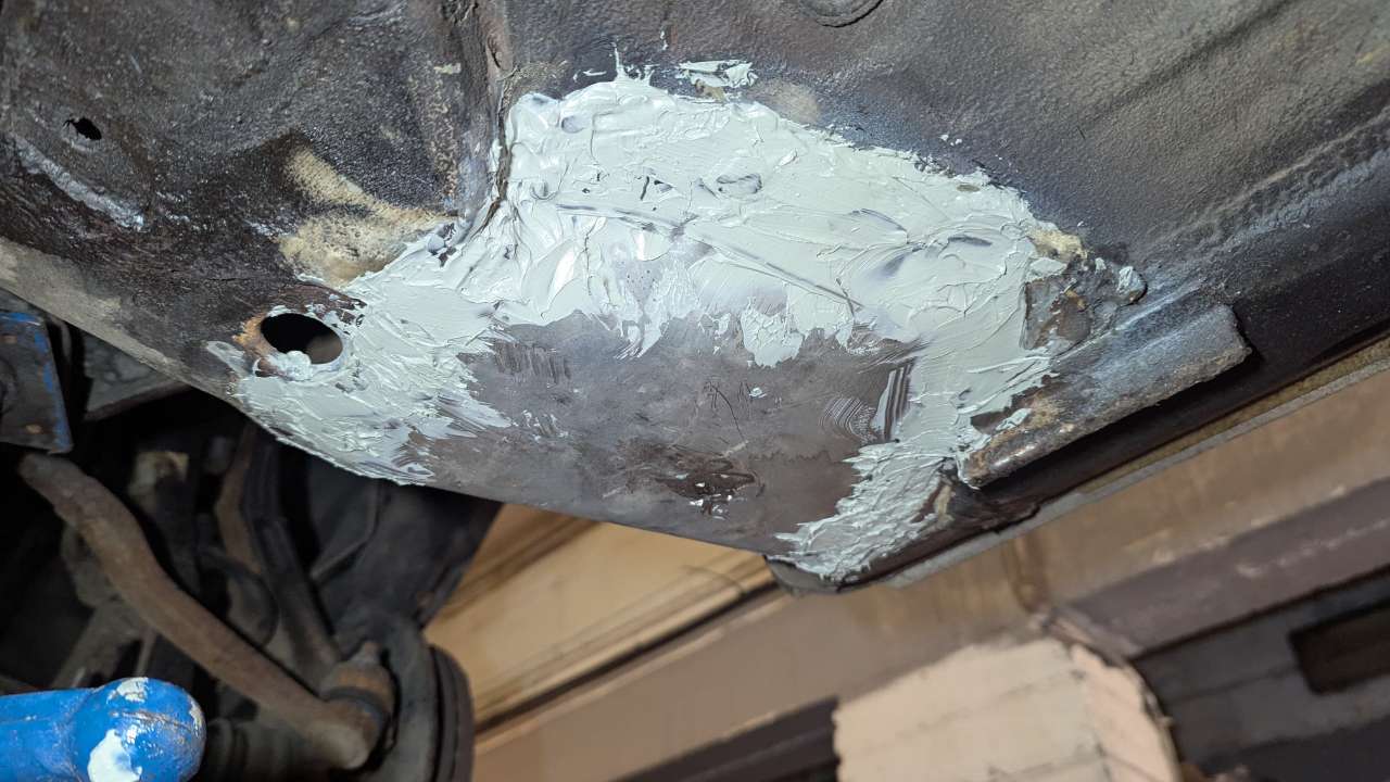

I poked a little bit harder (with a hammer 😅) than the MOT tester (they're only allowed to use the official tools, and obviously can't remove the arch liner) which did expose a hole nicely hidden away out of view

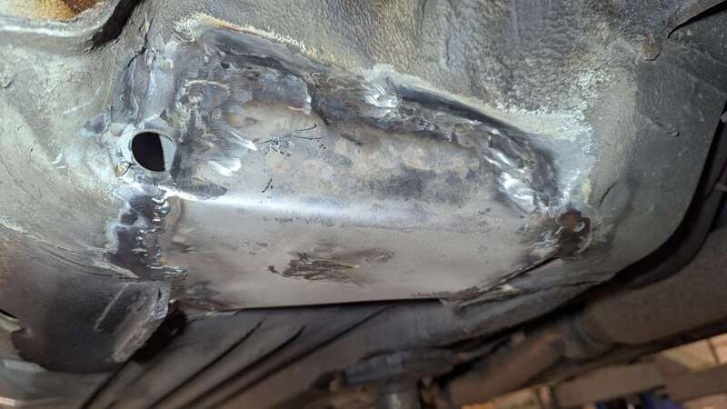

Never fear, chop chop
Treat and zinc prime inside
Tack weld to shape
Seam weld
Seam seal!
Cavity waxed

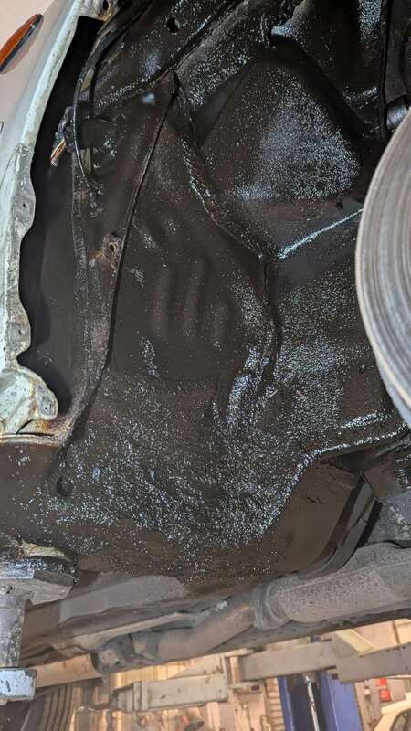

Undersealed and waxed (no it's not the rubber type underseal which traps rust!)
And that's the only advisory now taken care of! I didn't want to ignore it until next year because that would have undoubtedly grown into something a lot worse

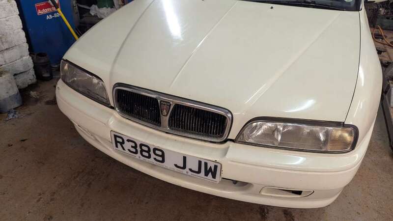

Fit the replacement silver grille! I think it looks so much better than the black one with the paint flaking off
Finally we have a very happy looking, road ready Rover 600!

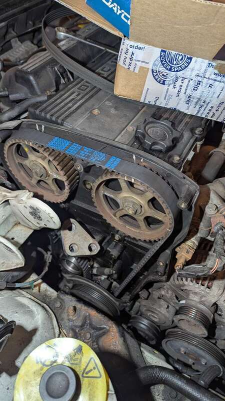

Still waiting in limbo on the bodywork, but I decided to put a fresh cambelt and tensioner on it in the mean time to end the roulette!
Pre-existing tippex marks aplenty so it's evidently been done before. The old belt didn't look awful but wasn't brand new either, so definitely worthwhile sorting it for peace of mind.
For service history purposes, cambelt replaced on 19/02/2025 @ 118315 miles :)

Yes! If it was checked a few years ago it implied to me it was probably another few years older than that. Interval is 60k/5 years as far as I can tell so it was probably due on age more than mileage.
Belt and tensioner was £49 delivered from DMGRS, (opposed to £110 + vat from ECP?!) - probably took me an hour to fit it, so no brainer really for the peace of mind :)

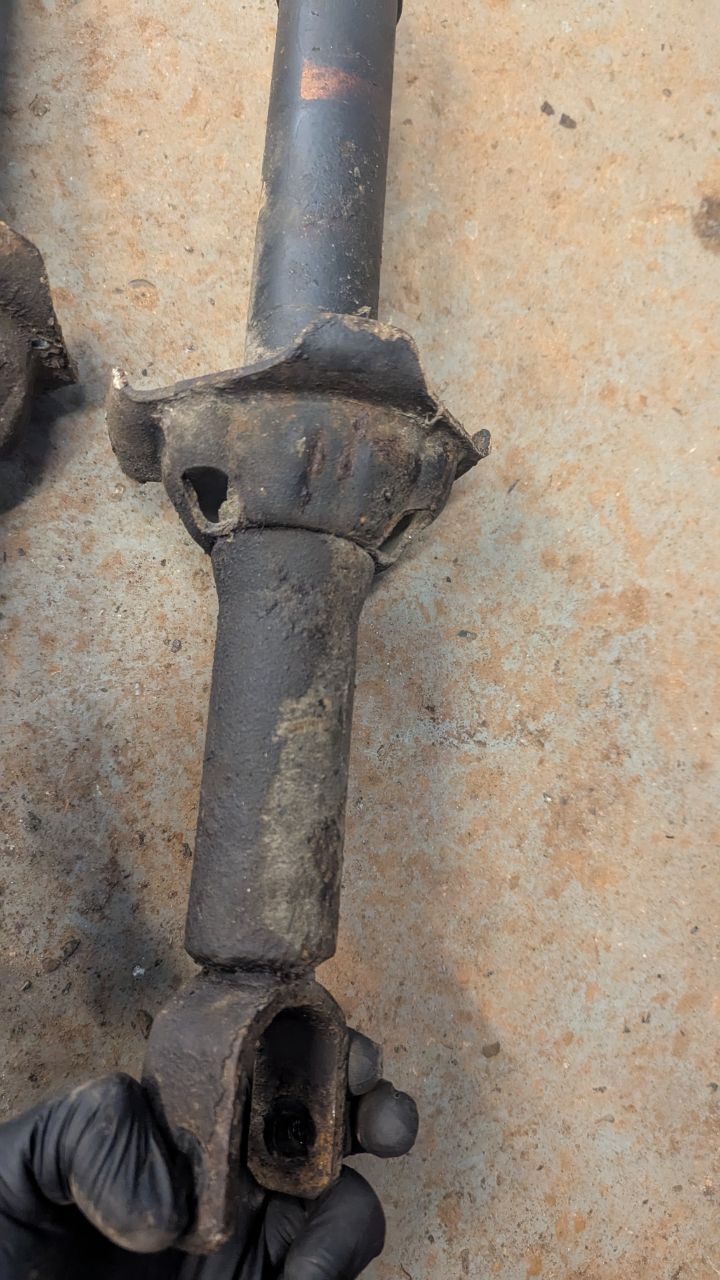

The new shocks from Autodoc landed on Thursday afternoon which wasn't bad considering I only ordered them on Sunday evening!
Set about replacing them this afternoon. For some reason the top nut on the nearside front was seized solid as if it had been cross threaded or overtightened at some point, to the point it had rounded off the centre hex on the shock shaft when I tried to undo it. There's no access to the shock shaft on these due to the design of the dust cover so my only option was to chop it off to salvage the spring and top mount to go on the new shock!
The offside shock was seized solid. I can't compress it by hand. The nearside one was also surprisingly stiff, definitely excessive, so it's a good job I got both of them.

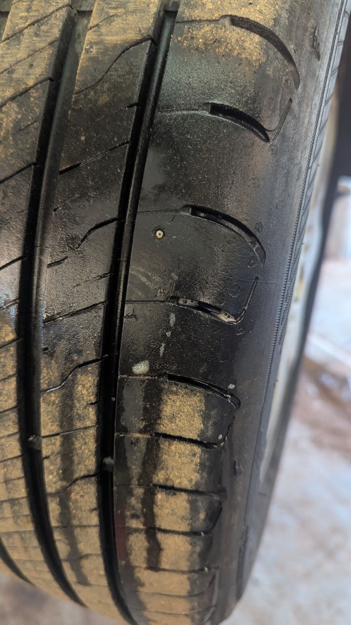

I noticed the nearside front tyre looked a bit flat...
Well that's a bit of a bastard on a near enough brand new tyre.. Luckily it was just within a repairable region, any further towards the sidewall and I'd have been looking at ANOTHER new one 😅
Anyway, got the new shocks fitted and repaired the puncture so it's now had 4x new shock absorbers

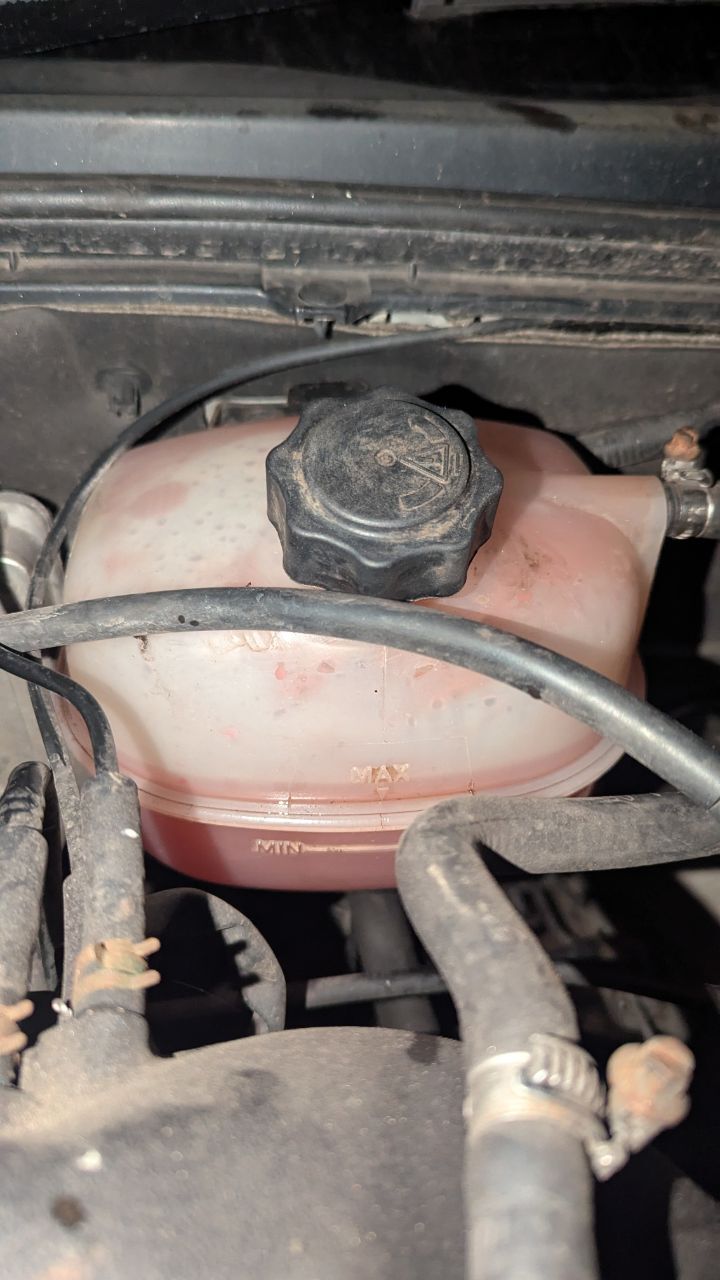

I was in the mood for some preventative maintenance, so decided to do a cooling system flush by removing a few accessible pipes and running a hosepipe through the header tank outlet hose which nicely back-fed and flushed out the radiator and heater matrix with those hoses disconnected.
The header tank was all horrible inside with a layer of grime to the point it was impossible to read the level, it responded very well to a few dishwasher tablets and boiling water being shook around inside vigorously.
Vacuum bled the system and let in a few litres of fresh antifreeze, upto the correct level and strength, and now the bottle is actually clean enough I can read the level!
