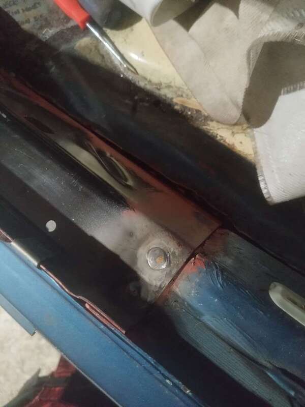

Made a start on picking out the rotten inner sill today.
Front seat rail removed first. Glad I done this as there is some surface rust to treat.
Now had access to all of the spot welds on the inner. Cracked on with that. Sorry for the crap picture.
I have managed to get towards the rear of the panel. Should have it out tomorrow. Don't regret taking this route now, as I'll have room to fix other rusty sections with decent access.
As a precaution, I have welded a brace in. These shells are actually pretty stiff. Buuuutt I don't wanna test that theory either!
