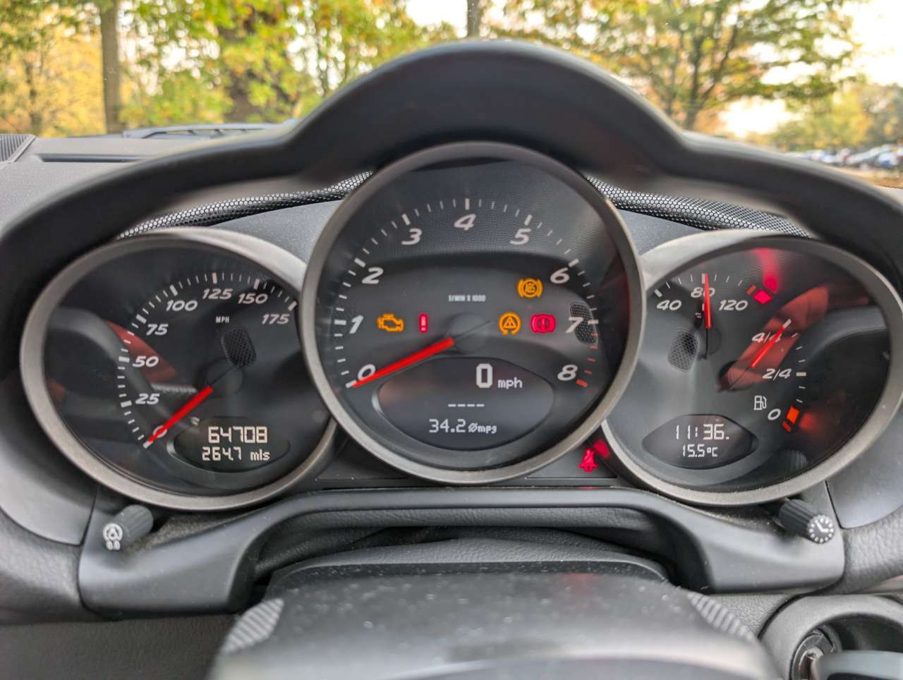

The 3-series being a dick again. 😔

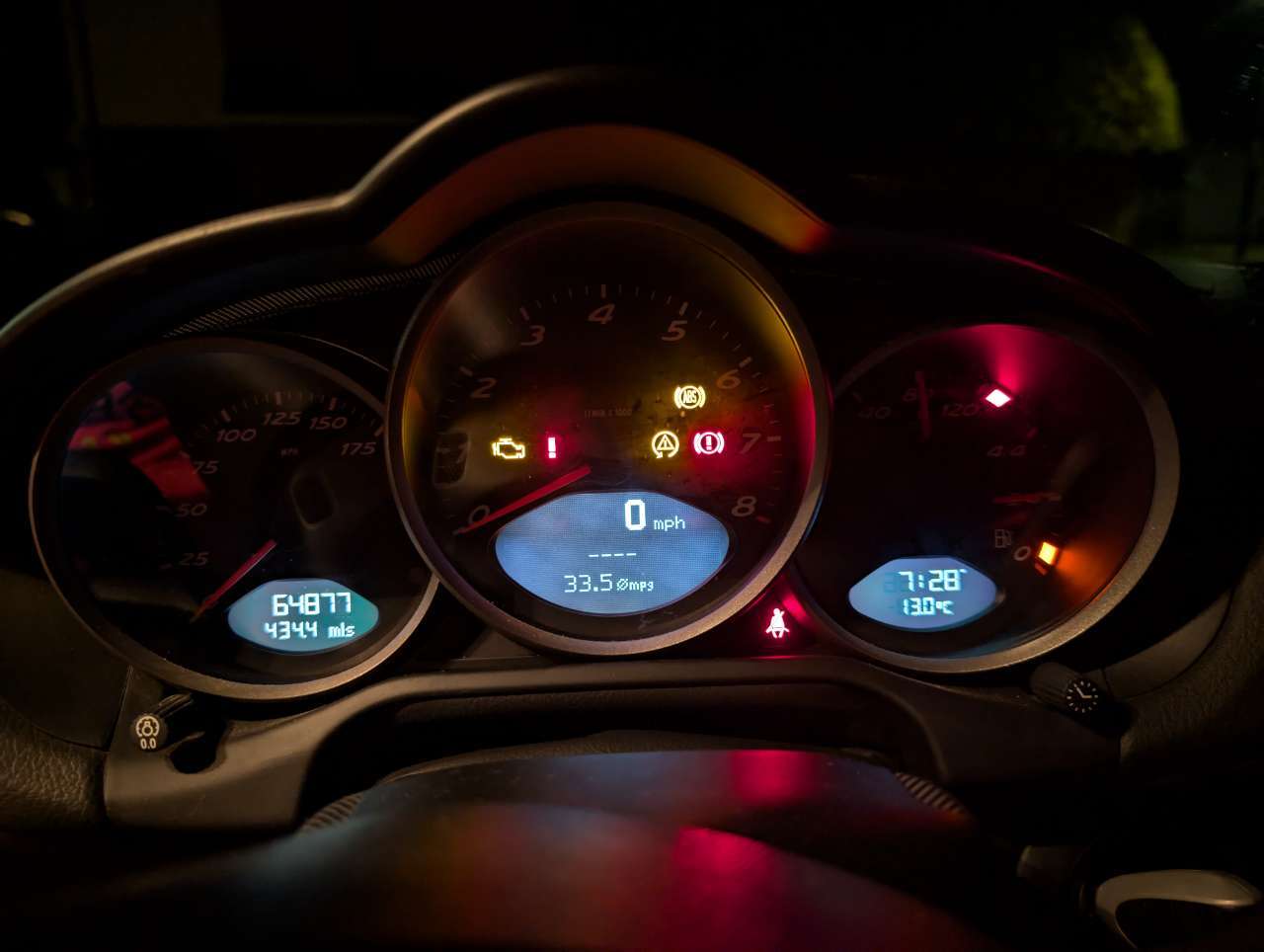

Pulled out of here with quite a lot of angle to cross the road and floored it as busy.
Except it lost all power again. Usually it's for a second or two absolute maximum but this time it chugged chugged chugged itself along. I straightened up on the road and the hazards while it slowly pulled itself along.
My foot was about three quarters down on the accelerator pedal but the engine sat at 800rpm thereabouts. Felt like it was missing but no engine light flashing.
It was doing this for what felt like an eternity. I scanned my chances for where I could bail out and if I could get it back into the petrol station again. There was cars backing up so it wouldn't be easy.
Massive bonus is behind the petrol station is a BMW indie specialists. So kinda the perfect place to breakdown.
Then as quickly as it lost power, it came all back at once. My floored (but not quite kickdown) accelerator pedal gave me all the power and we shot off like a scolded rat.
Absolutely fine again after that. These scenarios is when you really need it to give you the power right now and not fanny about. Doesn't help confidence in a car.
Feels like it's missing and why I've bought the coils. However I don't think it's actually them. The one commonality is if you take a sharp turn from slow speed and accelerate hard. I don't think it's the traction control as I'd expect some sort of flashing ESP light - which it normally does in such scenarios.
I really don't know what the issue is. No codes are stored. Given it's sharp turns, I can't but help think it's fluid related somehow. Maybe Vanos solenoids getting starved of oil from screens being partially blocked? The transmission service that was supposedly done last year maybe didn't have the fluid levels set correctly? Valvetronic eccentric cam sensor failed, full of oil that goes into the wrong part and causing incorrect readings?

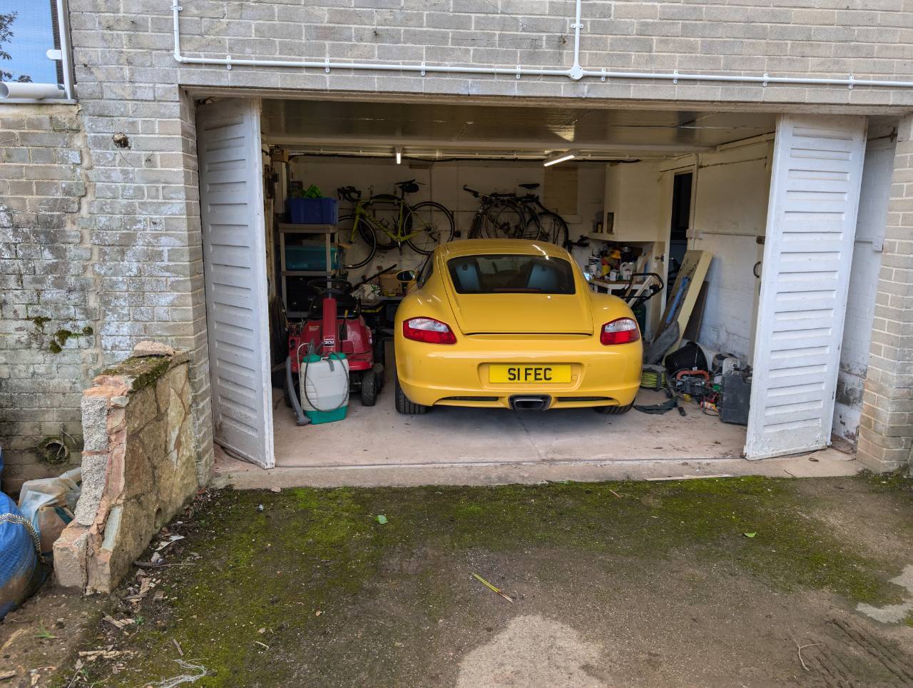

In other news, a garage find.
I have become the temporary custodian of this for a while, with the view of acquiring it in the future.
One owner from new and 64k or so on the clock. 2.7 but 6spd gearbox option was ticked. Very few miles in recent years as my parents have had building work and blocked it in. Plus my mum's lost a bit of confidence driving recently with eyesight troubles and such (getting old! 😬).
She always intended to replace it with a newer model but every time ended up having other stuff more important (like moving house, paying for my sisters+me to go through uni, etc) and so never got around to it. Also while newer ones are new and shiny, didn't really bring much more than what she had in this. I've had my eye on it for years and actually hopefully to had it sooner (why I sold my MGB GT earlier this year). However she intended to keep it a bit longer.
Anyway the plan is to use it a bit and get some miles back into it. I think I've done as many miles driving it home as was driven last year. My mum was worried that it hadn't had its annual oil change yet this year. However Porsche I think only require bi-annual services and the oil in this sump has done less than 100 miles since it was changed last year... Tbh given it a good run first and then an oil change when I give it back, will probably be the best timing for it.
It feels very special to be sat in and drive. Handles tight as a drum. Power doesn't feel very punchy and I remember this last time I drove it back to back with my Boxster (also a 2.7 but older and less power). My suspicion/hope is simply that it needs a good few fresh tanks of fuel running through it and a good run.

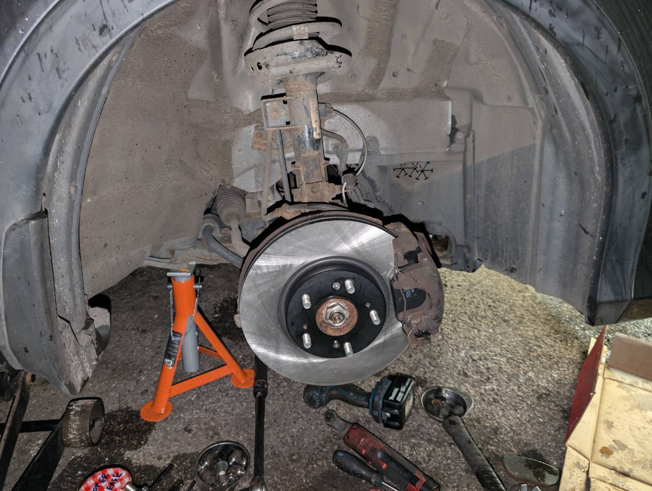

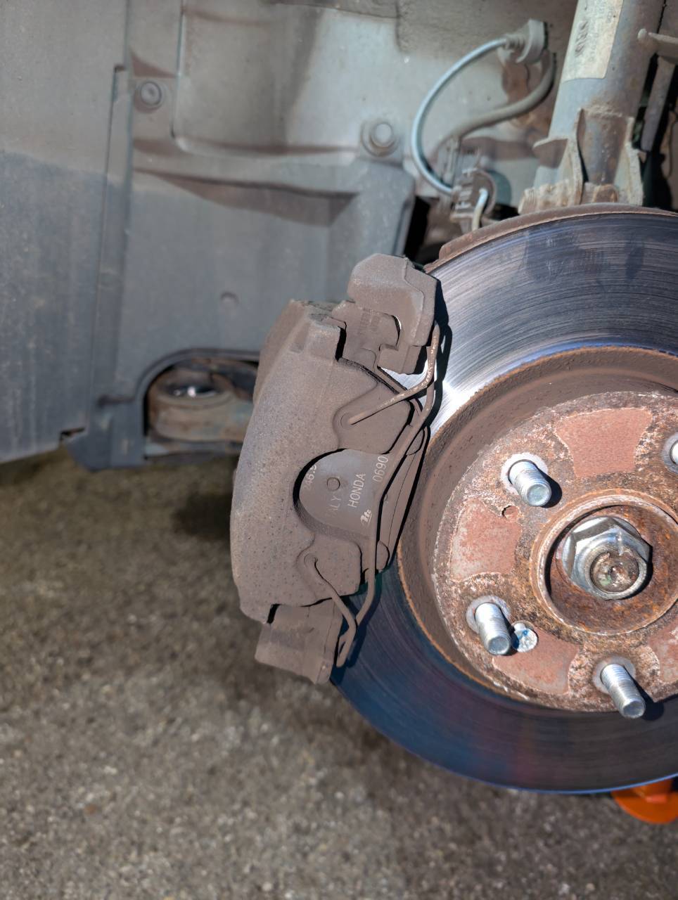

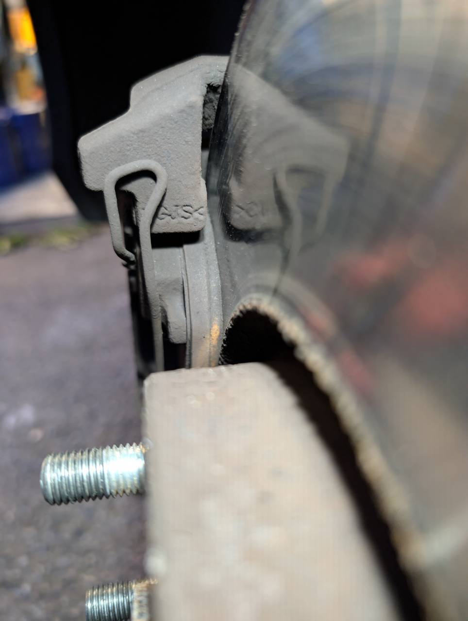

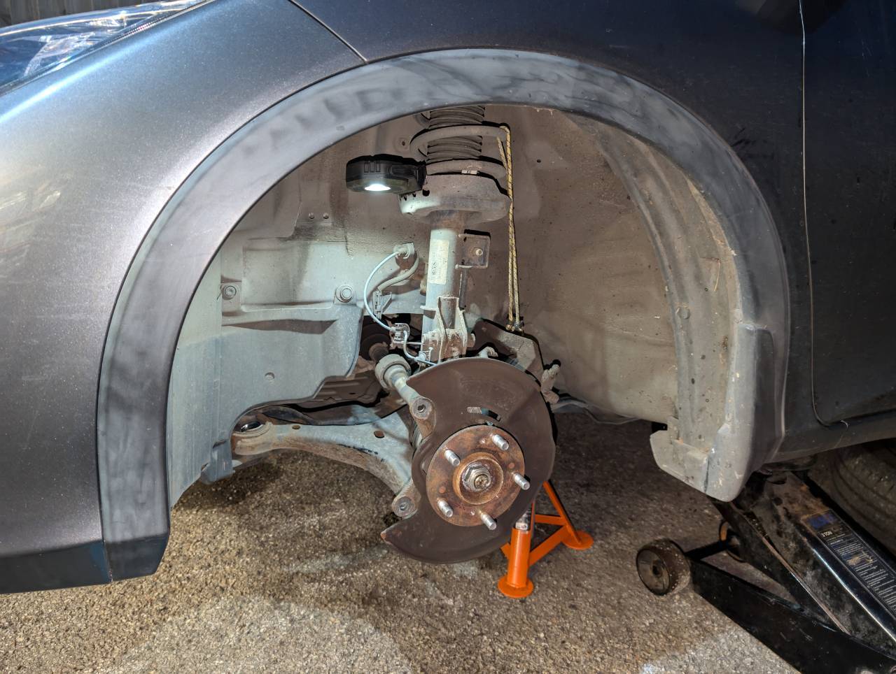

What else has happened? Well I replaced the front pads and discs on the Civic. Not very exciting tbh and easy enough job apart from one retaining screw had  to be drilled out (soft as butter they are). Probably should outsource this sort of stuff to a garage as I cba to do this usually. However it's better to be outside doing something constructive than watching some wank on TV in an evening.
I put APEC Red discs on this. Really impressed with the quality feel of the parts. Hopefully they'll last as long as what was on there. We've had this 2.75 years and put on 35k in that time. The stuff that came off was genuine Honda parts, so definitely I've not had them done as I wouldn't have paid out for that. Previous 2 owners both kept it as Honda main dealer serviced up at the same Conwy garage.
Still had 4mm pad on them so probably could have lasted a bit longer. However I rather did this job when it wasn't below zero and/or raining which it will be soon.
I forgot to take a finished photo on the left side, so have one on the right....

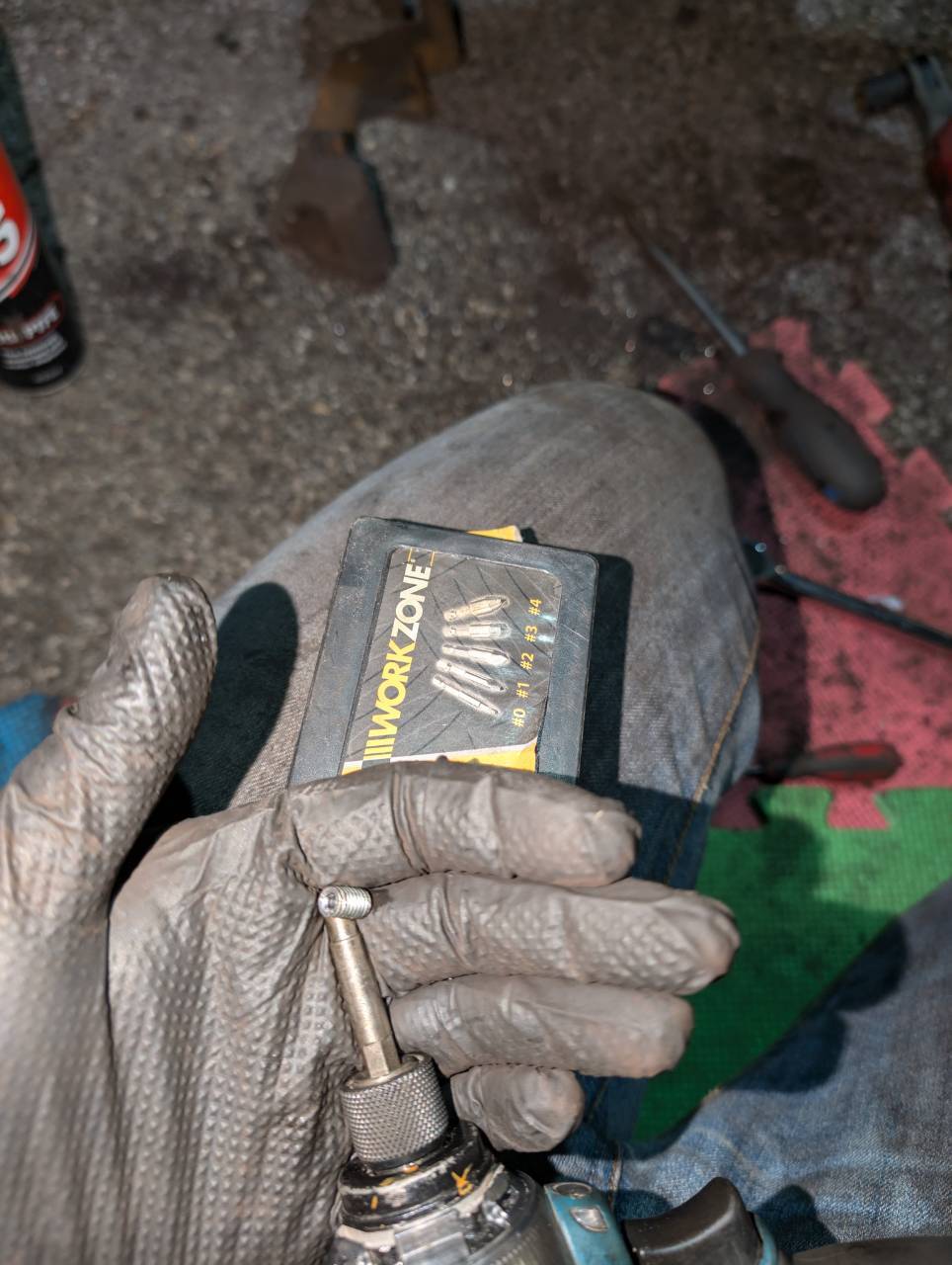

Again nothing exciting about this. Apart from these Aldi screw removers actually finally was useful for once in removing the drilled out screw remains.
Even less exciting is that I put four new tyres on it. Goodyear All-Seasons as on offer and cheaper than the Michelin CrossClimates I was going to get. Fronts lasted 26k. Rears at least 35k and going by the date code, probably over 50k miles.
So spent nearly £500 all in on the Civic this month. Still need to do the rear pads and discs but I think they can wait a bit longer. By far the biggest bill it's had in our ownership apart from insurance. In that 2.75yrs/35k it's had 2 tyres, 3 oil change services, plugs, air filter and a single coil pack. I'd say that's really good going but then it's a Honda that's "only" done 112k.

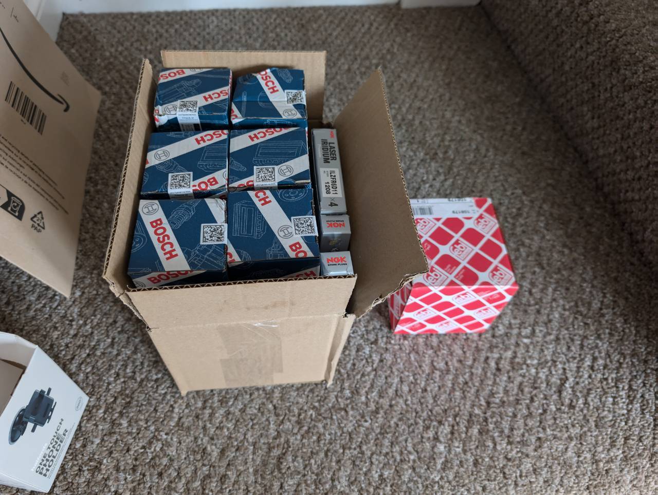

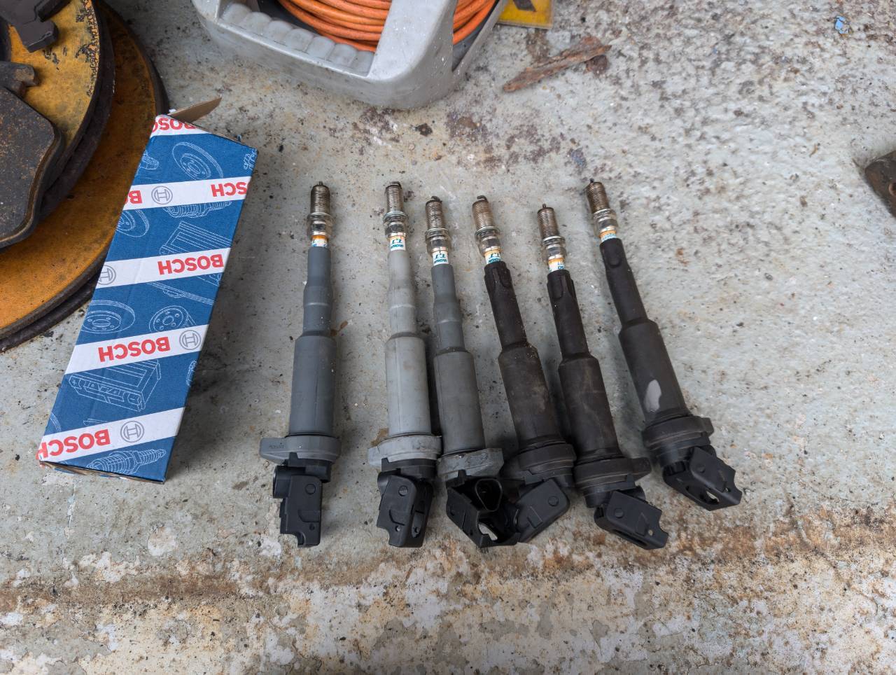

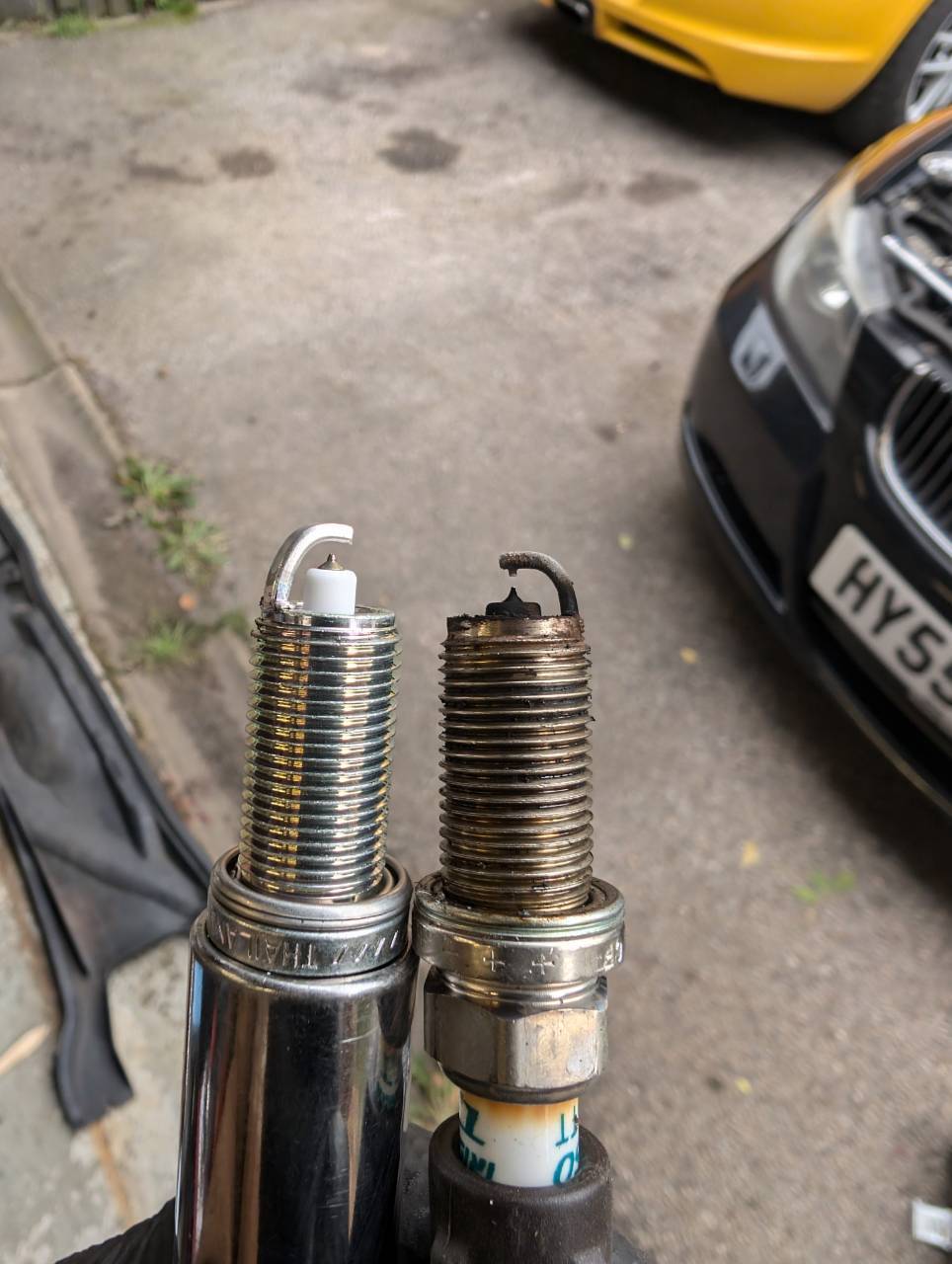

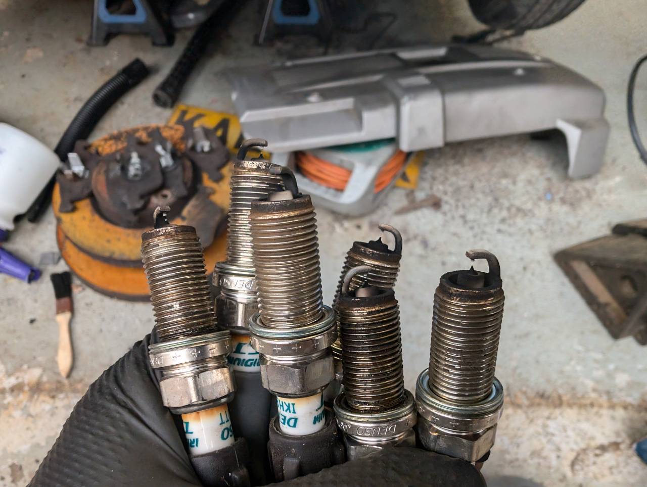

Onto 3 series news, I finally bought a set of NGK plugs to go with the new coil packs I bought. It's far more of a faff to work on than the Civic. Stupid shelf above the engine needs removing and obligatory beauty cover over the engine too. Managed to loose two of the bolts holding that cover on in the process. Left it off for now as I don't care for it being there.
Old coils are all mismatched. 3 are original (back bank) and 3 were all different (front bank). This is why I changed them to keep them all the same. The far right coil (coil 6 on the engine) had lost some of its rubber protective coating too. I won't throw these coils and keep them as backup spares.
Plugs weren't awful but these have only done 10k miles if the service indicator on the dashboard is to be believed. Some scorched marks on the insulation. Denso branded.

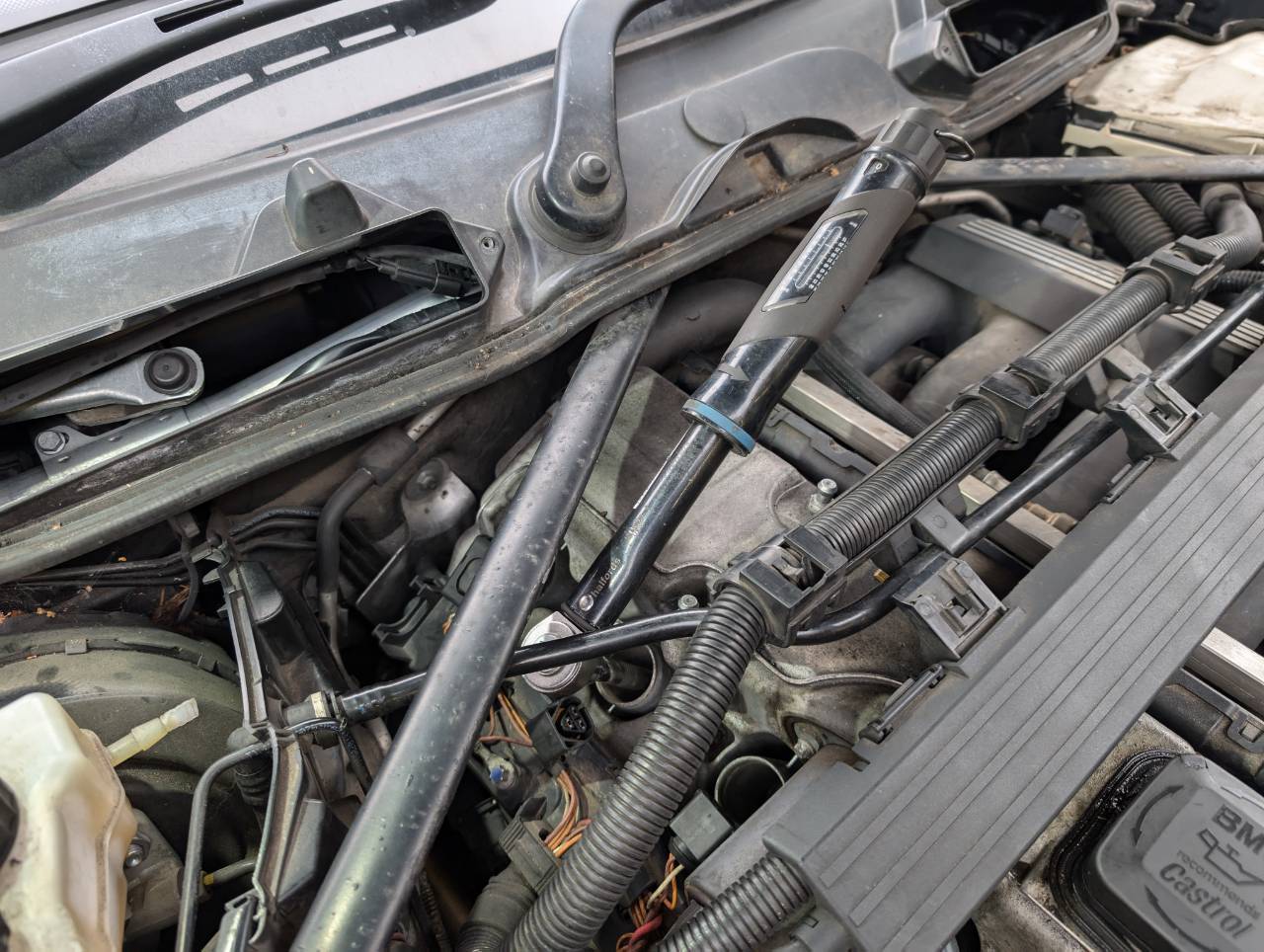

I actually torqued up the new plugs as these early N52 engines have a magnesium block and I really didn't want to damage anything. I'm not being paid per job or hour so the extra time to do it doesn't bother me. 23nm +/- 3nm is the spec apparently. You can see that the access isn't exactly amazing even with the covers all off. Certainly not like the Civic.

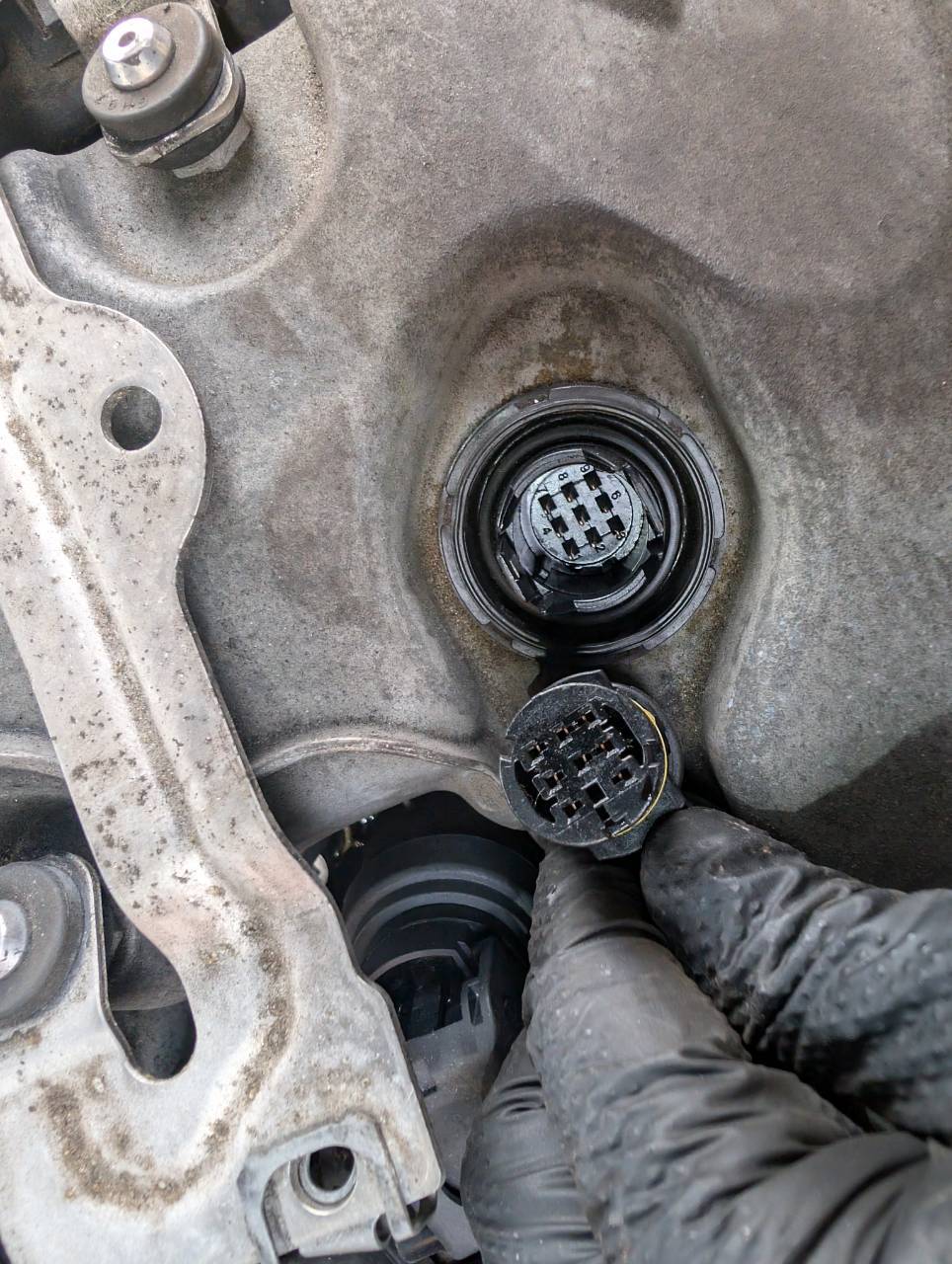

Also checked the eccentric shaft sensor connector that is used for the Valvetronic system to vary valve lift and what acts as a throttle. These fail internally and get oil from the engine into them up through the connector. I cleaned off a small amount of oil about 1k miles ago and its stayed bone dry since then. This is good as I don't really want to change this sensor. Like a hundred quid plus replacement rocker cover gaskets as the top has to come off.
I also removed the oil filter cap in the expectation of replacing it from the centre basket being missing. Apparently these usually get lost on an oil change and cause unfiltered oil to circulate around the engine. Just turns out mine is absolutely fine so I put the new one back in the box again for now...
Started it up and ran absolutely fine. Well almost, it still had the slight rough running for a bit that it occasionally does and a reason why I changed those coils and plugs in the first place. Along with not needing to do the filter cap, I basically spent an hour or so not fixing a single thing on it but spending money on parts.
Go me.

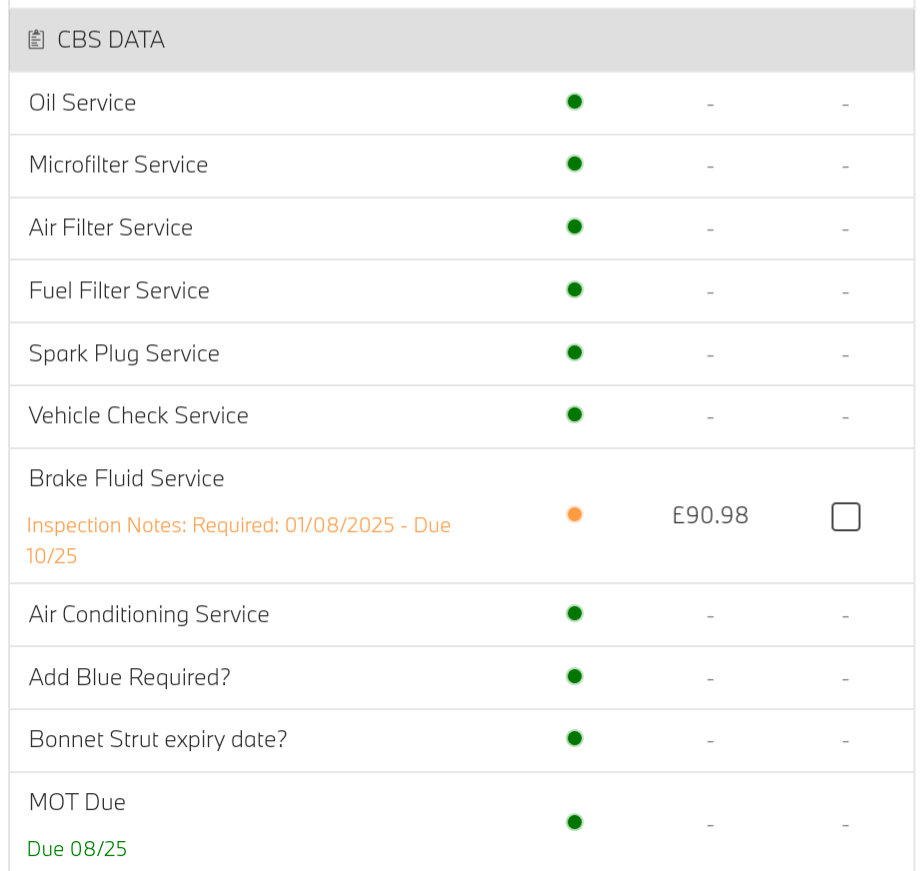

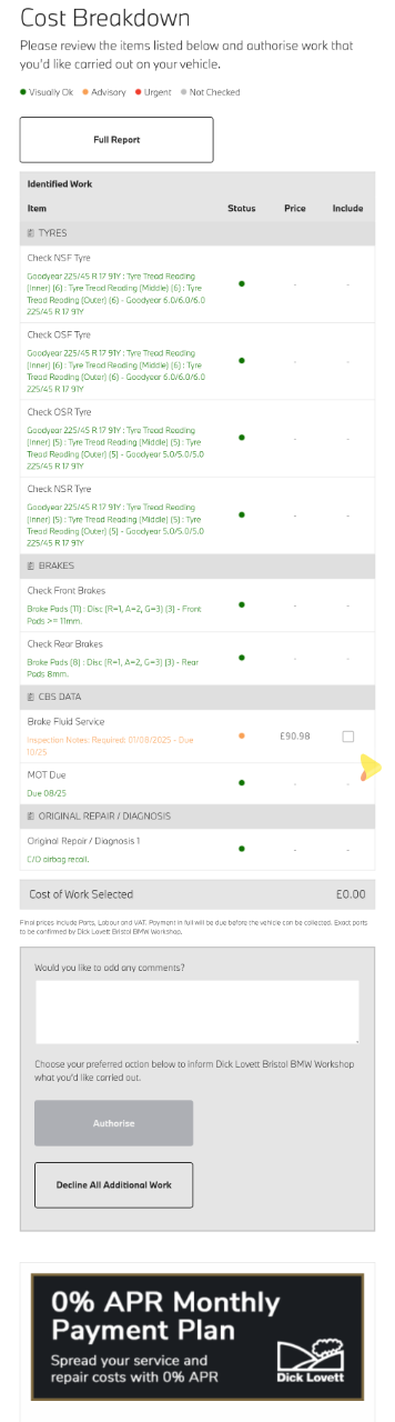

Currently sat in BMW waiting for my airbag recall to be done. They're going to do a free "health check" so we'll see what they find on a 20yr old BMW  🤣 (probably oil leaks)
I know the wheel arch access cover for the drivers headlight is missing, so they might find that if they're looking properly.
Health check video
I don't think it's too bad considering it's age, miles and just being worked as a car. That wheel arch liner definitely wasn't pulled out like that when I bought it in though...
He says the rear arm has play (I mean it's done 155k miles...) but I'd like to have seen him go in and show actually that it has play. Can't helping think it's perfectly fine with no play but easy sell.
Condensed report - full report is just a list of everything they looked at. Basically nothing wrong apart from needing a brake fluid change ... due in a years time but could have it done now.
That's quite re-assuring. I always get intimidated in the BMW dealer as their coffee machine usually looks more expensive than my car.
Dick Lovett just had a Nespresso machine. Which is probably about all my car is worth.
I did get a bit stressed when they said they were going to do a health check as I didn't really wanted to be held to ransom/argue for a non issue that they made out to be. At least its better than my colleagues turd bad buy X5 he took in for an airbag recall. It had an oil leak so bad that they had to put a tray down on the floor in their shiny clean workshop  🤣
Bonnet strut replacement? I didn't even know that was a thing. Presumably something on moderns to do with pedestrian crash protection.
Probably to prevent the bonnet falling on the service technician’s head.
Nope. Just speaking to my mate who had his done on his X5 at a (German) dealer. They expire after 5 years and are supposed to be replaced after then. They're part of the active pedestrian impact system. Googling confirms that this is a thing on modern BMWs.
No idea why they only last 5yrs when airbags last for the life of the vehicle.
So basically the bonnet struts are a service item on a BMW. Nothing new there except it's on the service sheet now!
90 quid for brake fluid change is not that bad for a main dealer.
I wonder if they bleed it through or just suck out what's there in the reservoir and top it back up?
I think those health checks are a mixed blessing. They do inform the customer of any issues but they tend to highlight stuff that's not all that relevant on older stuff.
I watch a youtube channel with a mercedes specialists and they're pointing out 5 grands worth of work on a 3 grand and it can be difficult to tell what actually really needs done. . I guess a lot of it is arse covering so when the engine does fall out they can say they highlighted it to you.
That maybe but I think the iDrive is programmed for 2yr intervals so it was only done last year and really does not need doing again already! Easy job for them. Lob up on the ramp, attach pressure bleeder, go around each caliper and crack the nipples.
These health checks are "free" as they exist solely for the dealer to make money. Same with the fast fit garages doing free checks you can redeem. If someone is actively going into a garage for a "free" check then either they suspect something is wrong or that they want to make really sure everything is okay. Easy pickings for a garage/dealer to make money from.
Also the technicians get commission (at least that what I got told by a warranty claimer who worked in dick lovett and bought my wife's mx5) for jobs they find and are done. So they are effectively trying to find anything they can to get some work and more money.
I guess for example a £3k on a newish/older car still going through a dealer network, many owners will go "Oh dear that's a lot! I'll pay it this time but I think now I'll start considering this/next year to upgrade it to something newer if it's going to cost me money". What I also didn't say is that I had a couple of emails from sales advisors before my visit asking if I wanted to speak to someone when I'm there to "upgrade" my car. I didn't respond as I didn't want to be a dick and say how shit modern BMWs look (TBF he's probably heard it already).
Although presumably on a more modern BMW the new brake fluid would need coding into the car using ISTA.
In all seriousness, I think it needs resetting with a dealer tool yeah. More modern BMWs iDrive keep a log with what was done, when and where. Hence the need for a plug in tool to update it with the garage name, etc.
The issue is that if it's not also logged online into BMWs central system (like many independent garages wouldn't do), a BMW dealer tool replaces it with just what's online. So your FSH mostly at an independent garage suddenly gets wiped to no service history (unless you have the receipts).
It's win win for the dealer other than the half an hour the spend doing it. They potentially upsell work and have an almost PDI type audit of the vehicles condition when it came into the dealer.
The only one that feels bad is the customer when it's pointed out what shit heap their car is.

Trip up on the M5/M6 got a respectable 34mpg - mostly motorway at 50-70mph speeds. No cruise control so my foot started to ache a few hours in. Also the speedometer over reads by only 0.5mph. So you're fully aware that there is no margin for error on motorway variable speed limits. Because of this I ended up just driving slower and cruising behind the wagons in restricted sections.
Back down we got stuck in an hour tailback near home which dropped the mpg further.
Still pretty decent. Albeit actually lower than what my Boxster could get to (peak was 40mpg). Same engine but less power (20bhp). That said I don't know if that was inaccurate - this was pretty much bang on based on fill ups.

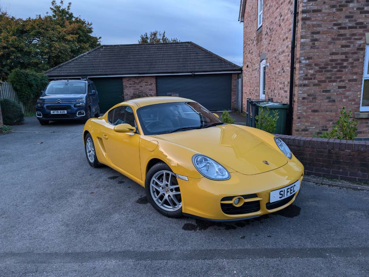

Back home now and gave it a quick wash.

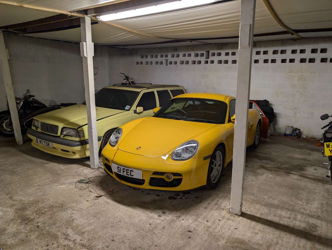

And put it to bed for a while.
That yellow 850 T5R next to it I think is worth similar to/more than the Cayman now. Cool car but I know what I'd prefer to own.

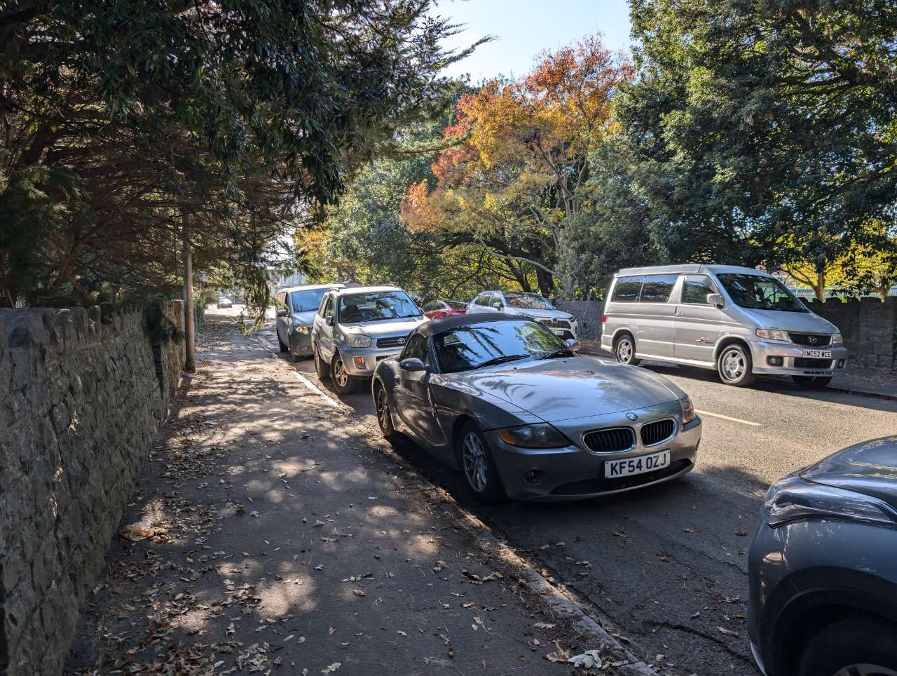

With that away, I pulled this out.
Don't get me wrong, I love the Cayman and it's comparatively oodles better than this crock o' shite Z4.
However it's reminded me how much I like driving older worthless cars. The Cayman feels special and a treat to drive. But I have to park it miles away from everyone else to stop scumbags smashing their doors into it and ruining it. Tight country lanes I need to yield well in advance and super careful that I don't catch the side to risk scratching it. Keep it clean with fresh sponges to keep it looking nice. Be aware that abusing it hard can easily lead to big bills. Etcetera etcetera.
Z4 I just hammer the shit out of it, bucket of water and sponge over it occasionally, park wherever I want and generally not have to give a damn. If I break it, it's reasonably simple to fix or worse case chuck away and get something else. So much less worry and stress. A welcome refreshing change.
I'm just predisposed to and love old, worthless shite too much. I don't think I could ever spend five figures (excluding inflation!) on a car and daily it without getting pissed off, stressed and ultimately trigger enough anexity to not want to go places and do things as much as I do.
