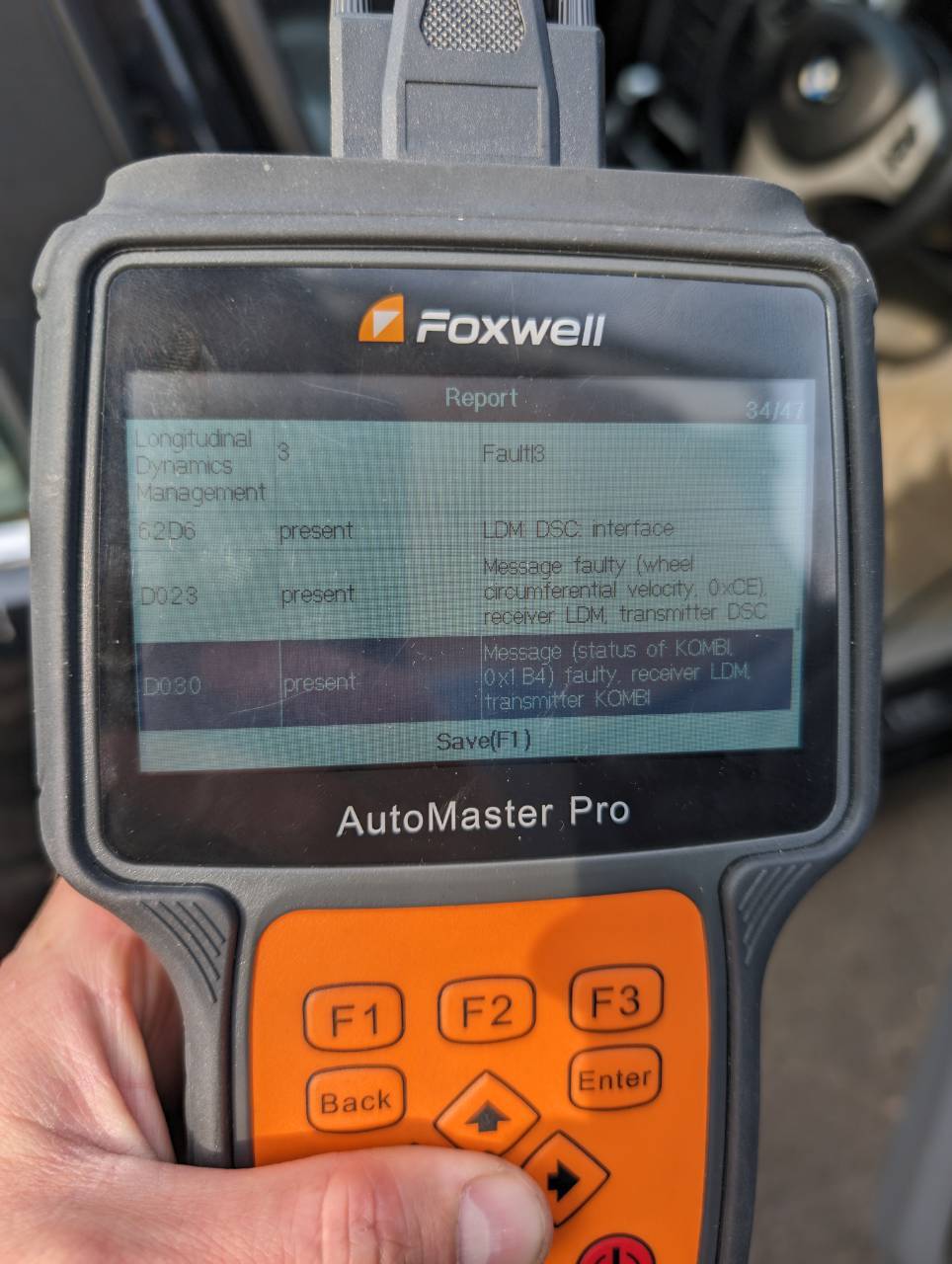

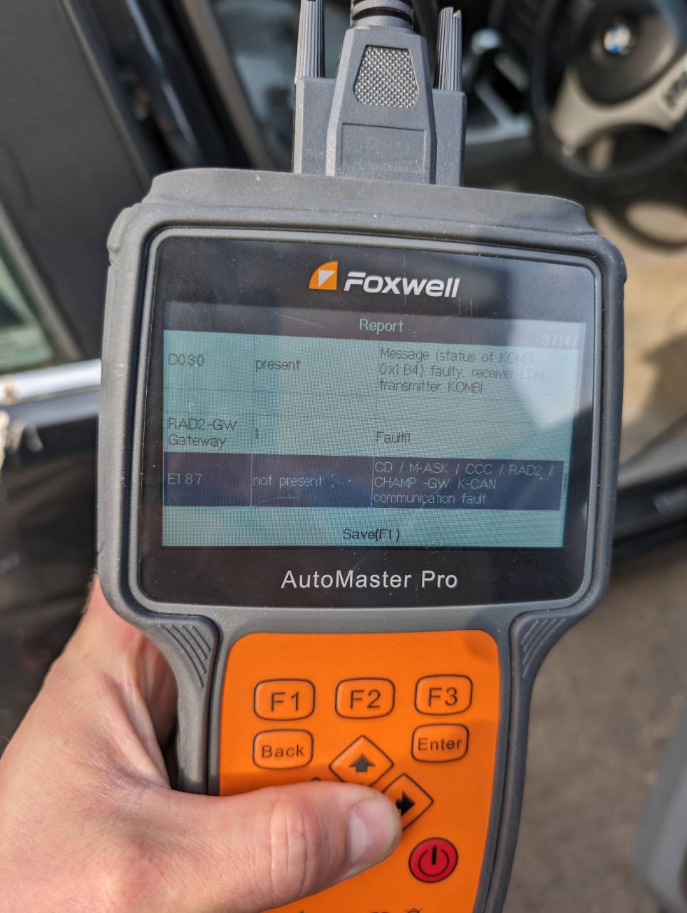

So error codes. There are loads of them because it's a BMW.
Firstly these codes I think all relate to the idrive (big dash sat nav screen thing) module is dead and not communicating. I don't think it's the display as I get a flash as if it's about to start up and then nothing. My suspicion is the power supply in that module is dicky. Electrolytic capacitors maybe given the age??
These two are the cruise control module (Longitudinal Dynamics Management - what a name) and Airbag. They all relate to the fact the ABS module isn't giving the car network a vehicle speed information. The transmission has a similar code as these.

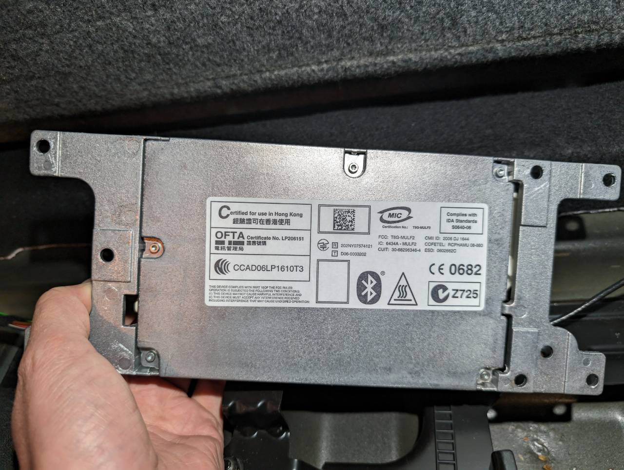

A few questions: (!)
 - Does the CCC have Bluetooth? If not, if I upgrade to a CIC does that have Bluetooth?
 - Do you have the E9x SP Daten files?
 - I heard about the chap in Romania. Do you a link or contact details for them?

For 1. It may have Bluetooth, it was an option outside of Nav. If it has it, on a CCC it will be calls only, and it’s quite basic. You can retrofit a CIC unit and it’s a big upgrade (in my eyes). From that, you can add something called a combox. That gives you A2DP for bluetooth audio, a proper USB port, and a higher resolution screen. My car has these and it feels modern as they used that system up until 2015/16 in some cars, you can also enable BMW apps, but only a few work still. Spotify does, and it’s very handy. I’ll add a picture below. (Excuse the music taste)
2. I’ll take a look, I am a big INPA user and haven’t got a fully working version of ISTA yet, but we’ll see how it goes. I’ll dig my car laptop out tomorrow and take a look.
3. https://mca.electricmura.ro/en/ Are the ones to use, and they’re reasonably priced. I’ve seen people send off dead units with symptoms like yours and them come back just fine.

Had a poke around on this wheel speed sensor. Disconnected it as I wanted to double check that the abs module isn't playing silly buggers.
The connector box was absolutely packed with dirt. I don't think it's ever been disconnected.
Wheel speed reading went to 0kmh. Reconnecting it also still kept it at 0kmh.
Am I confident this has fixed it? Not really. NorfolkNWeigh mentioned it stayed off for 50miles the other day until it pinged on. Tbh for £25 to get a genuine Bosch sensor, I might just parts dart one on anyway.
I have this MULF2 box in the boot. Dated 2012 and has the Bluetooth symbol on it. Presumably retrofitted going by the date.
Is this Bluetooth handfree? Tbh this is what I want the most.
It also has an old fashioned car handset dock in the arm rest too. I was disappointed when I saw that as I presumed no Bluetooth. But presumably the MULF2 replaced the dock.
Also presumably under the module is where woodlice go to die.

Oh yes, in that case you’re set. The cradle will still work though, and you can get what are called snap in adaptors for various phones. They will connect to the MULF too, and even have a passive aerial that boosts phone signal.
I am guessing the original TCU In your car died and someone retrofitted a MULF2. That can add USB too.  Ute you’re right, will work for calls just fine.
