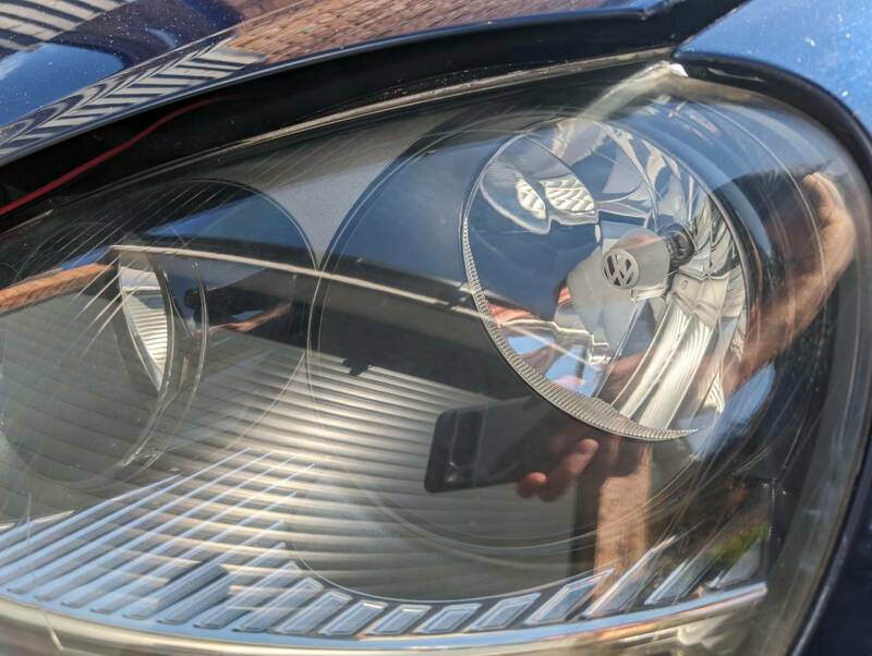

SiC Posted March 3, 2024 Author Posted March 3, 2024 Polishing headlights always brightens up a car a treat. My usual trick of G3 and a felt wheel on a grinder works well and makes it a ten minute job for both sides. Lights have condensation build up inside. Probably from where it's been sat & not used. Hopefully use will make the bulbs boil off any moisture in them. Now I could see inside, I noticed that the nearside main beam reflector had melted! Explains why I could sometimes smell a hot melting type smell on occasions after a drive. What has happened is that someone has hamfisted the bulb replacement. They've managed to loose the retaining clip and just shoved the bulb back in place. But without the clip in place, any bump moves that bulb. So it ended up sitting on the plastic reflector and ruining it. The otherside still had the clip but the bulb was in the wrong orientation. Thankfully nowhere near as much reflector damage on that side. The proper solution will be to replace the headlight unit. Only £30 or so off eBay for second hand but I want to keep the budget low on this still for now. As it's just the main beam, it won't affect blinding oncoming traffic. Bulb envelope is damaged but still works. It's coming to spring soon and clocks change, so won't have to do much. If it blows it blows and I'll have to replace this light cluster anyway. For the mean time I got a Split Pin (yes I shipped him all the way from Scotland for this before anyone says...!) and bent it into a rough clip shape fashion. Worked much better than I expected! The side light kept flicking a bulb out warning on regularly too. Again in the same place as the above bulb. Looks like someone has pinched the wire and damaged it. Didn't take much for it to snap. A bit of soldering with my handy Milwaukee soldering iron and some heat shrink fixed this. Not my best soldering but it'll hold and it's only low current. Plus I need a new light cluster at some point due to the other damage. Popsicle, JMotor, mk2_craig and 8 others 11
Minimad5 Posted March 3, 2024 Posted March 3, 2024 I might have a headlight for this in the garage, 100% a VW, so let me dig it out and confirm. God knows why, but I also have a TT, MK4 Astra and other random lights 😅🫣 Good work on keeping this on the road SiC 1
SiC Posted March 3, 2024 Author Posted March 3, 2024 23 minutes ago, Minimad5 said: I might have a headlight for this in the garage, 100% a VW, so let me dig it out and confirm. God knows why, but I also have a TT, MK4 Astra and other random lights 😅🫣 Good work on keeping this on the road That would be fantastic! You can get brand new aftermarket headlights cheap on eBay but I don't know how good they are. Plus there is a little VW logo on the bulb cover on the front and I don't think my OCD could put up with not having that on one side. 😅 Dave_Q, Joey spud, CGSB and 2 others 5

Joey spud Posted March 3, 2024 Posted March 3, 2024 You can't beat the satisfaction of making cloudy headlamp lenses look new again. The sister in law put a wide scratch along the whole length of her caravans side window getting too close to a tree and was in tears but half an hour of sanding with an 600 pad and cutting back with various compounds had it looking like new again. SiC, GrumpiusMaximus, louiepj and 4 others 7

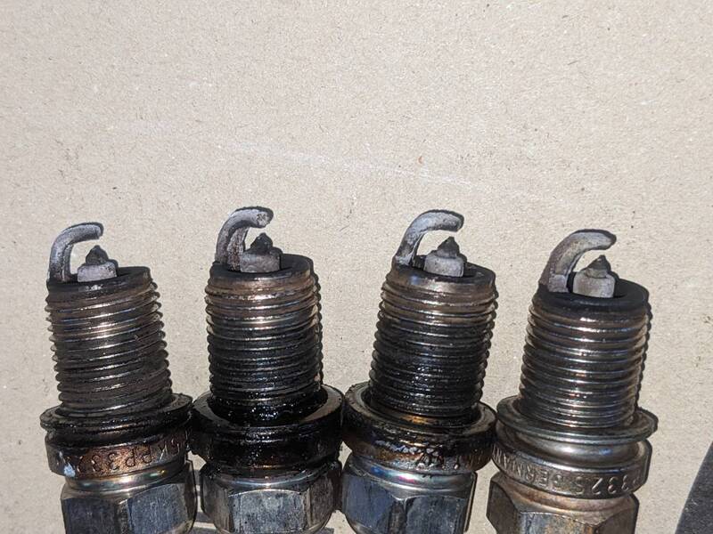

SiC Posted March 16, 2024 Author Posted March 16, 2024 This has always felt a bit lumpy on idle when sat at lights. Its worse when holding the brake pedal down. I think it might be the engine mount knackered or TADIS. However the spark plugs were of unknown vintage, so I reckoned it would be worth changing them anyway. A set of four NGKs were just under £40 from my local GSF. I wanted to get them from a major retailer to reduce the chance of getting fakes. All the plugs came out and were all pretty tight. I hate removing plugs that you have no idea when they've been out last. I've never broken a plug in a OHC engine and I don't ever want to! They're pretty manky and well worn to my eyes. While I had the plugs out, I decided a compression test would be a good idea. First thing was to stop fuel getting into the cylinders. Dave_Q suggested to me to disconnect the injector multiway. This is easy to get to on the front by the throttle body. Worked fine but just needed the codes clearing before the engine would run again. So what compression am I running in these cylinders? Bear in mind these are on a cold engine (60s run to move onto the drive), dry and 198k on the clocks. So between 195psi and 200psi (probably the accuracy of the gauge). I don't have the factory figured and I'm used to British Leyland lumps, but they sound very healthy numbers to me! Of course having no history, I don't know what degree it's an original lump. But I have no reason to believe it's been changed. I also changed the coolant tank and cap. I bought these when I have the coolant leak, before I had a chance to diagnose the source. Was a hope it was the tank/cap but ended up being the thermostat. I left it too long to send these back to Amazon, plus given I want to track day the car, it's going to get very hot and risk bursting the old, discoloured tank. It was only £20 for this Febi tank+cap anyway. I mean at the very least a new tank looks better in the engine bay! In other news, I tried sticking the headliner up with spray adhesive. This worked for about a week and looked passable. It's fallen back down again. I believe it's the foam backing that it sticks to and then comes detached again. I've noticed it smells more with the headliner down. I imagine the smoke has got into the foam backing (maybe why it's more likely to deteriorate?). I did enquire at a trimmer but they wanted £200 to replace it. I have seen foam backed material on eBay for £12 a metre (I think I only need 2 metres). Headliner spray glue for £8 a can. How hard can it be....? We'll find out soon! 😅 Dave_Q, Shep Shepherd, MJK 24 and 14 others 17
