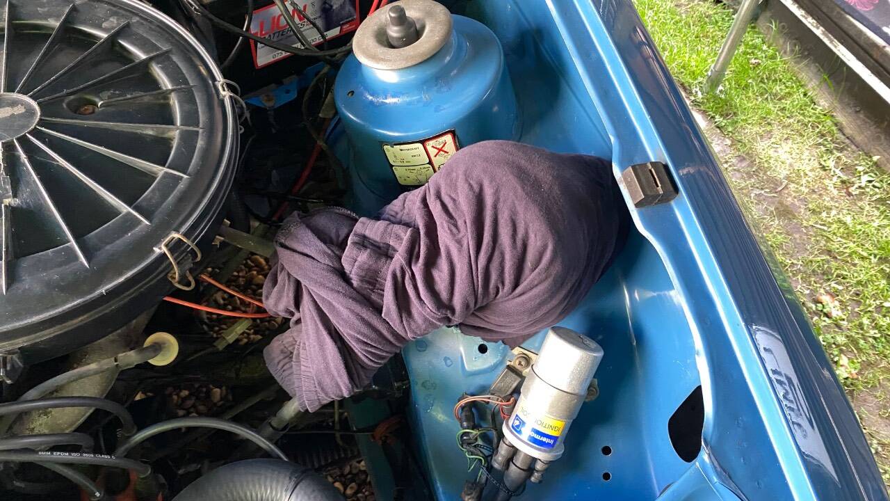

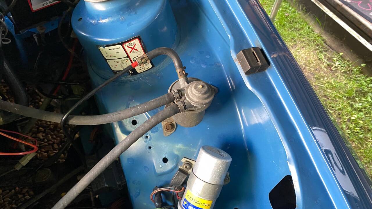

egg Posted May 27, 2024 Posted May 27, 2024 4 hours ago, Peter C said: It's definitely not the carburettor. I have stuck my head as deep below the air cleaner housing as possible and it smells fine. However, the fuel vapour separator whiffs. It's a metal sealed unit. Three pipes extend from / into it - fuel supply from the pump, supply hose to the carburettor and a vent hose that connects to a solid line, which extends beneath the car and into fuel tank. The top of the unit and the three pipes all smell of fuel. But, they are completely dry. I'll ask what is probably a stupid and incorrect question - but as it could be a safety issue - could it be deterioration of the fuel hose due to E10 pez? Also, when this first came up I did a bit of reading (by which I mean I put 'vapour separator' into Google) and did find that in principle how these work - there should be a filter inside maybe? This looks to be a very old one, but principle may be the same - and could the filter rust or get blocked? I dunno, one for the more engineer minded on here, I don't want to pretend I actually understand the physics.

Peter C Posted May 27, 2024 Author Posted May 27, 2024 @egg The fuel / return hoses smell of fuel but there’s no evidence of any leaks. Perhaps you’re right, the hoses could be deteriorating from the inside. Shame this has come to light today as there was a stall at the Enfield Pageant with every type of fuel line and fixing ever made. The separator looks like a sealed unit, there are no fixings that I can see, which would enable me to open the unit and check the filter. I will wrap the separator and hoses with an arrangement of rags, which for a short period would absorb the smell. If the smell disappears then I will know for certain that I have identified the problem area. egg 1

Peter C Posted May 27, 2024 Author Posted May 27, 2024 @egg Smelly. No smelly. I think you’re bang on with the hoses deteriorating. Coprolalia, mercedade and egg 3
Zelandeth Posted May 27, 2024 Posted May 27, 2024 Yes. E10 (or indeed E5, just less quickly) will almost definitely attack any hoses not made specifically to withstand it. Only ones on an older car that you don't need to worry about are metal or nylon. Peter C 1

Peter C Posted May 27, 2024 Author Posted May 27, 2024 33 minutes ago, Zelandeth said: One thing which springs to mind about that vapour separator - it's two halves crimped together, could there be a leak from the seam between the two halves? Bit fiddly to test for. I will give it a full once over when I replace the hoses. egg and mercedade 2
