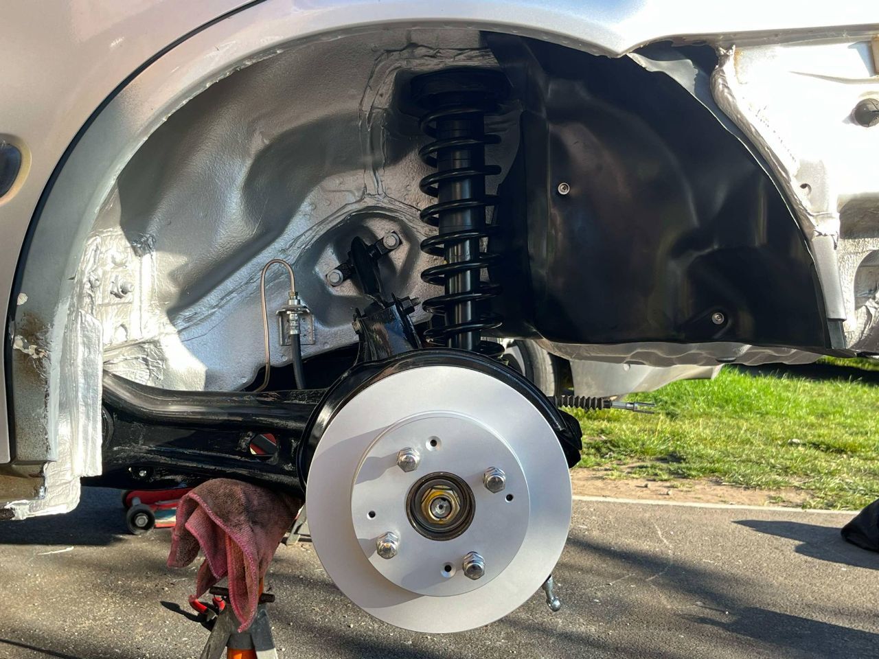

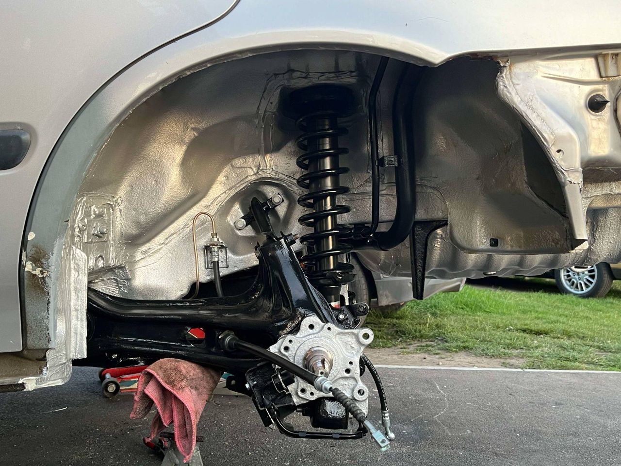

Ive been busy these past couple of weeks, just doing odd bits. not really had much time or motivation at the moment as ive been revising for my Class D License but the good news is ive managed to get the boot floor all sorted, epoxy'd, seam sealed, stonechipped and painted! very very happy!
Also got the brakes fitted to one side, it looks so good now, im in need of some new banjo bolts and washers however so they are on my list of things to get this week.
also ive had to get some new brake pipe clamps as the old ones just crumbled when removing them. £20!! for two brake pipe clamps tempted to just get a 3D printer for bits like that next time lmao.

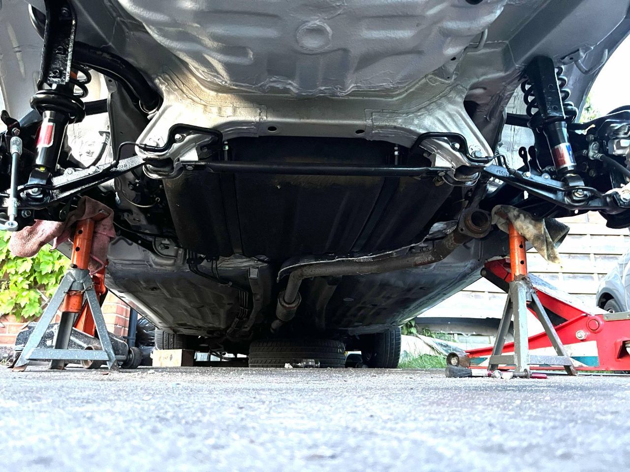

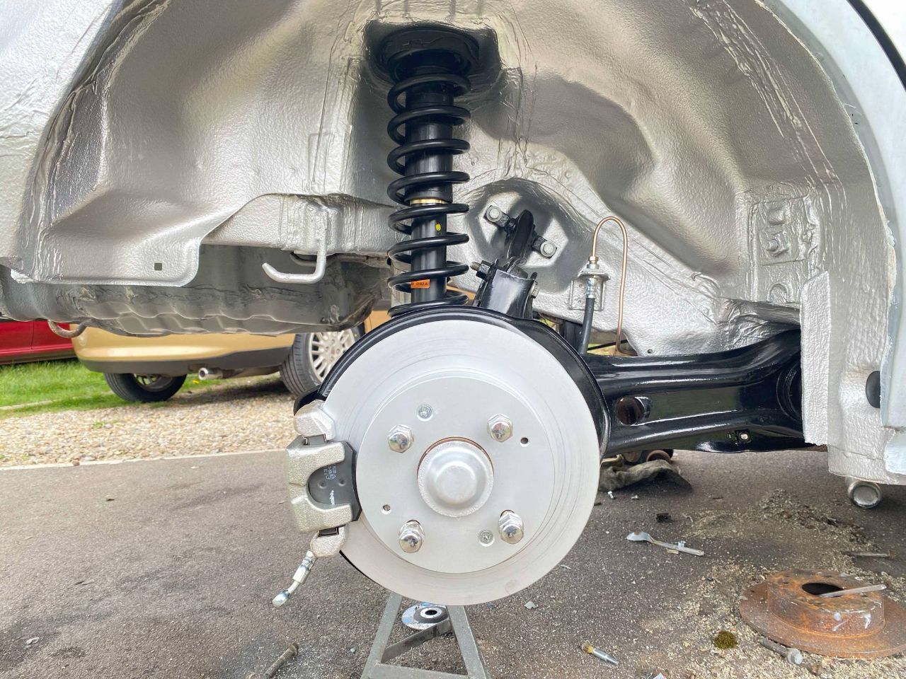

So the Rear Suspension, is all 100% fully on!
I had a bit of a nightmare fitting the Rear Anti Rollbar. Rather than using the original i used an MG Rover one as they are a better. plus more readily available in regards to parts for it like bushes etc so i converted it.
Although there were little differences that i noticed. The Rear ARB Brackets that mount to the car are slightly different to one another the Rover one, the mounts are further apart by a few mm which was annoying as i had to source some new brackets as i didnt want to ruin my Honda ones.
2362bd7d-485e-482e-a87d-8446c53b891b.jpg.9b20a14e09e517b38ef66c8af7a84e45.jpg6b8a56e8-ef54-412b-9576-076a5bbe9cf6.jpg.81b4b2625aaad04d6454de44852dfe2a.jpg
The Rover one is the Top, The Honda is the Bottom, see the difference, its very minimal but very annoying!

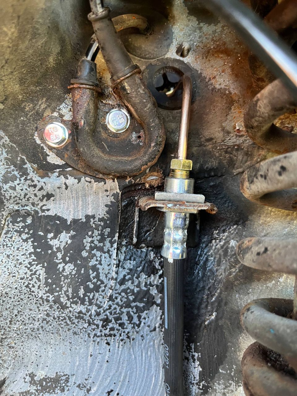

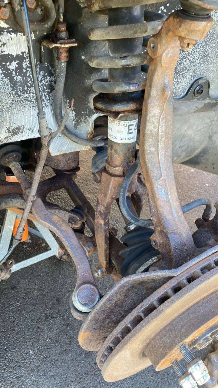

With FOTU around the corner, i really wanted to get the car ready for then. I had a look at the front suspension. it doesn't look that bad to be honest. Even the bolts for the Brake Hose and ABS Sensor came off without using heat or WD40 which was very nice to see.
So i have decided that im going to risk putting it through an MOT earlier to get it ready for FOTU. im going to just do the bits that need doing for now. Such as the Brakes, that being the Hoses, Pipes, and Pads. The discs although rusty arent badly pitted and will probably clean up after a little drive. This isn't to say im not going to do the front arches. I will defo be doing the same to the front as i did the back. I have a few parts ready to go on in the shed, such as the lower arms etc.
Its nice to see that the CV Boots, and other rubbers are in fair condition to say the car has been sat. They have not split so i will see how it goes at the MOT.
I Just finished doing one front side regarding the brakes i fitted a new hose and pipe. I just need to do the Passenger side now.

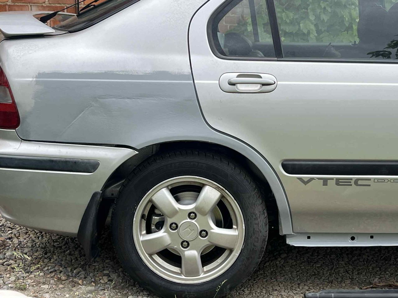

The Civic has been Painted on the Drivers side.
Theres been a lot of work going into this regards to filling etc. It was quite a time consuming task getting it right and even then its not 100%.
I Probably will get it done properly by professionals in the future however for now its just to get the car an MOT and back on the road.
for starters the area was epoxy primed, as this will be a good base for the filler. You are able to fill over epoxy primer which is nice as i never liked the idea of putting filler over bare metal as it likes to absorb moisture.
Im not fantastic at filler work so i could only do my best at this stage, here is the process of me filling and sanding down.
2e011d3e-d47d-4b1e-98cd-f65d8ce6d906.jpg.a07453213188dccb826f99726169256a.jpg17cf49fe-abc2-4b64-be23-f90b18132168.jpg.ac44f5e1961cff3f65427e78aab85901.jpg
I was quite surprised with how well it came out.
Especially around this section where i had to weld.
Here is the sill all filled.
Now i dont have a garage so i had no other choice than to spray outside. I tried to make sure that it was still, no wind. no direct sunlight and low humidity.
Certainly not the best paintjob, but for outside it aint too bad. I blended the new with the old at the top of the C Pillar where it will be least noticeable. With it being silver it is a hard colour to match especially when its 27 year old paint too.
7bec5c49-a533-413a-8b79-f77282cf67d5.jpg.6c2efee4811d64ed6e58d14f2bd2d971.jpg597c5fcb-6ae1-4180-9df8-d79de21cf1fb.jpg.69c606ed92def86893f88a5d26b93422.jpg
Heres the Quarter all painted, next job is to get it all aligned now regards to the doors.
I gave the paint a good wet sand, went up to 2000 grit and used some G3 on a Polishing machine and the shine has come up wonderful.
I was impressed with the door jamb area as this was all non existent at one point!
to say it was my first proper attempt at painting the side of a car, i dont think ive done too bad.

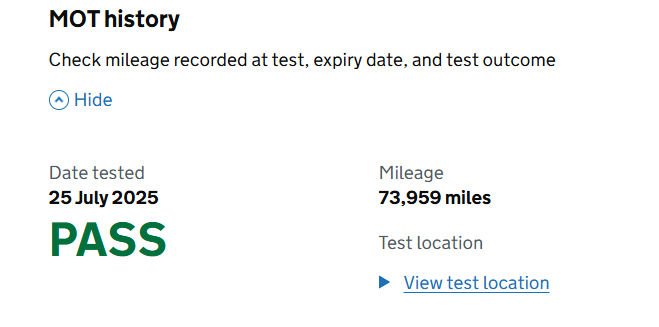

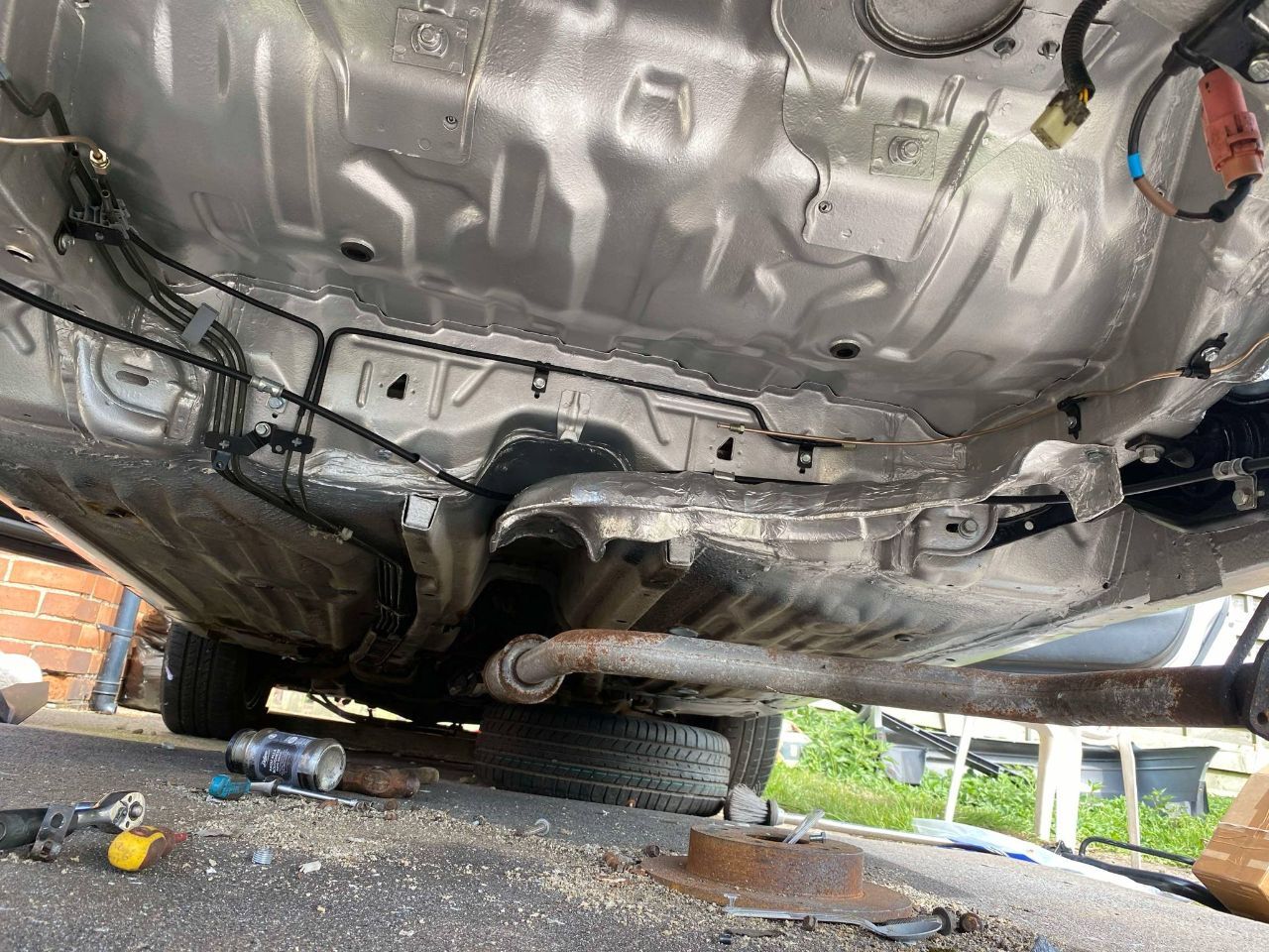

I have some really really good news! the Honda Finally has an MOT after 15 Years!!!!
Ive been busy the past 2 weeks getting her all ready, making sure everything is in good order. The MOT guy was very impressed with the work ive done underneath and said its crazy and that hes never seen a car this age so clean.
Even better was that it Passed with NO advisories! im absolutely over the moon!
Well done sir!
Happy to see your hard work has paid off and you can start enjoying using the car.
Not in the least bit surprised. Always amazing work, congratulations for getting it road legal again.
MOT tester must have thought he had gone back in time!
Look at the underside on the last pic, up on the ramp then compare it to what you can see under the Corsa to the left.

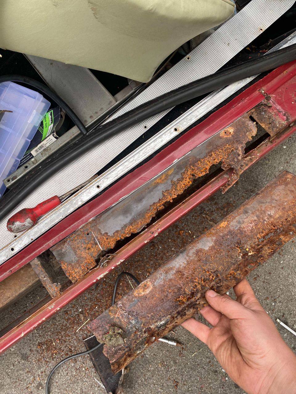

Shes sadly not looking very good underneath the shiny paintwork, i discovered yesterday that shes been poorly restored and im quite upset about it.
An Example of what i mean below, That is the Treadplate...
