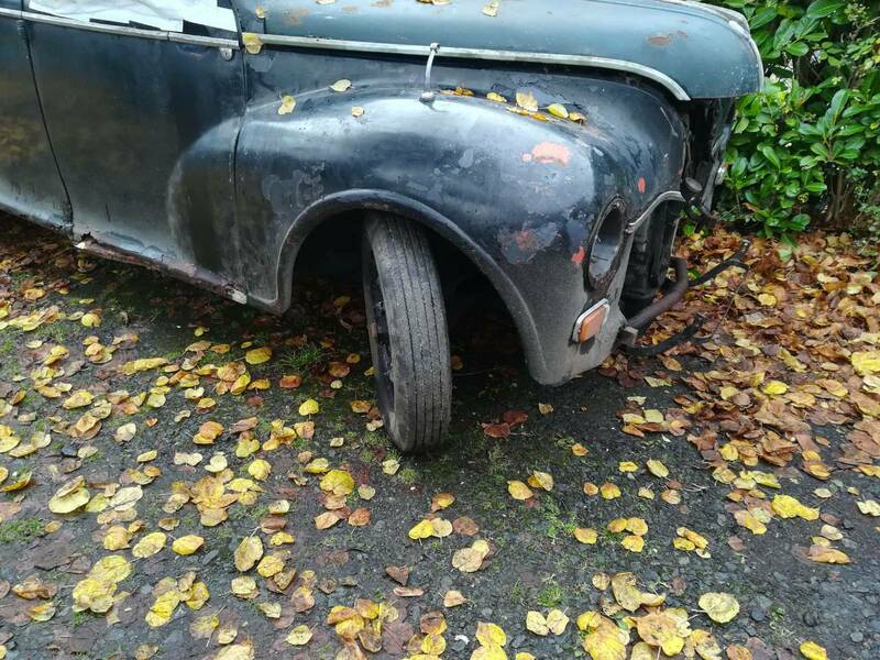

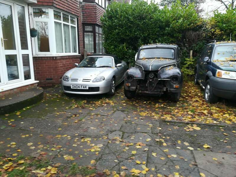

The Old Bloke Next Door Posted November 18 Share Posted November 18 Continuation from the original For Sale advert, where else can you obtain a classic car for free! https://autoshite.com/topic/56113-free-borked-jowett-javelin-deluxe-–-ideal-for-christmas/#comments This was going to be parked up over the winter at my unit and then next spring assessed as to the viability of restoring it into road going condition on a budget. However due to unexpectedly selling two of my fleet that were parked on my garden last week, I had a spare parking slot for it at home. Initial inspection looks positive, lots of previous welding repairs on the chassis and bodyshell structure, most of which appears to have been done to a good standard. First task was getting it parked into the available parking slot. Three of the brake drums were partially seized and needed dismantling to free up. This took longer to do than would be usual as I had to find my Whitworth spanners to dismantle the components. Once that was sorted and with the help of my assistant, we got it parked. Dave_Q, AnnoyingPentium, bigstraight6 and 45 others 48 Link to comment Share on other sites More sharing options...
The Old Bloke Next Door Posted November 18 Author Share Posted November 18 The drivers door window has detached from the winder mechanism and is is currently inaccessible inside the door shell. It appears that the car has been in dry storage for many years previously, as a temporary fix , I have taped a plastic rubble sack over the window aperture to hopefully keep the interior dry First job tomorrow is to remove the framework at the front of the car, check if there is any coolant in the radiator and have a look at the engine and chassis number. Pictures include the amount of steering lock that was standard on most rear wheel drive cars of the era and the front framework. LightBulbFun, DeanH, Low Horatio gearbox and 43 others 46 Link to comment Share on other sites More sharing options...

Matty Posted November 19 Share Posted November 19 12 hours ago, The Old Bloke Next Door said: The drivers door window has detached from the winder mechanism and is is currently inaccessible inside the door shell. It appears that the car has been in dry storage for many years previously, as a temporary fix , I have taped a plastic rubble sack over the window aperture to hopefully keep the interior dry First job tomorrow is to remove the framework at the front of the car, check if there is any coolant in the radiator and have a look at the engine and chassis number. Pictures include the amount of steering lock that was standard on most rear wheel drive cars of the era and the front framework. Little bit of weekend work ala Derek Matthewson? The Old Bloke Next Door 1 Link to comment Share on other sites More sharing options...
