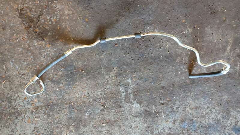

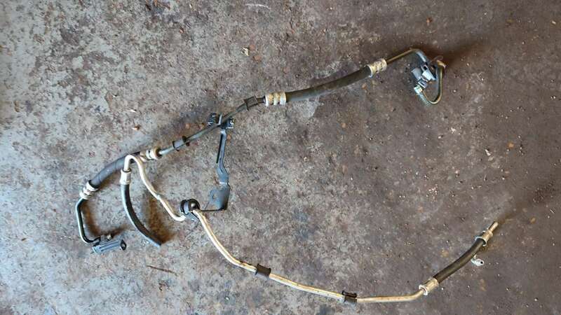

RoverFolkUs Posted July 23, 2023 Author Posted July 23, 2023 Ahhhhh fuckit... Remember the power steering union from hell that I was desperately trying to avoid disturbing? Well it's not that union, but the power steering pipes have been fucking disturbed alright... Just managed to snap the return pipe while feeding it through. Bastard GMcD, High Jetter, Rust Collector and 5 others 8
RoverFolkUs Posted July 23, 2023 Author Posted July 23, 2023 Ok, decided to stop now for today I was trying to wrestle the lower radiator hose into place towards the thermostat housing, but the power steering and air con pipes were in the way. With a bit of fighting I managed to get the coolant hose through but for some reason it was fouling the power steering pulley Raised the car to investigate, then I realised the engine is sitting forwards because I hadn't yet installed the rear torque mounting. No bother While it was up in the air, I noticed the power steering return pipe was snapped...! Argh!!! A new set are about £150 for these from Ford, or shitty eBay ones for about £40. I then had a small brainwave, because when I had to replace the pipes on my old Focus, I kept the old set "just in case" ... I had lobbed them in the communal workshop pipes/hoses/wiring loom bins that we rummage through and find something useful for something every once in a while Well, I had a rummage through and sure enough there were my old pipes left untouched.. The original failure on them was the high pressure pipe. I set about separating them, which was a bit of a fiddle because they aren't supposed to be separated Bingo! Slightly different shape, but oh well, it fits, I think. And most importantly isn't snapped. Got that all in place, the brackets were rusty and won't really clip back together but that's a problem for another day. Set about reinstalling the alternator Then it dawned on me what I was originally doing, sure enough it was that hose on the thermostat housing, for which the clip is still sitting on the floor... Fuck!! Now I've got to take the alternator back out. When you start doing stupid shit like that, it's usually a sign to stop. In theory, it should drive now but there's no coolant in it at the minute.. and no belt on the water pump either for that matter. So we'll pretend the grand start up is happening at a later date. But I was getting pretty peeved and wondering "why the fuck didn't I just scrap this thing" which is probably good because I think that is an obligatory part of any job like this. adw1977, GrumpiusMaximus, High Jetter and 14 others 17

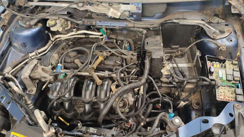

Popular Post RoverFolkUs Posted July 24, 2023 Author Popular Post Posted July 24, 2023 So, as the title suggests, it only bloody runs!! Properly this time! Video evidence if you so require! https://streamable.com/m0djqr Unfortunately my oily sausage fingers did not hit the record button while I was one handedly trying to turn the key while also monitoring the dash to make sure the oil light went out in good time.. But anyway, it "runs like a swiss watch!" Removed the alternator to refit that poxy clamp I left off, fitted the alternator, fitted the power steering lines (which do not appear to be leaking, yay!) , fought with the stretch belt and got it on via the frowned-upon method which is rotating the engine backwards. No, you shouldn't do it, but that won't stop me 😄 Filled the cooling system, went for the grand start up, and it fired into life straight away! Idle was a bit lumpy again to begin with, but a later fault code scan revealed it was historically trying to relearn the throttle idle position. It's sorted itself out now EML and ABS lights were on due to everything getting it's knickers in a twist, but after clearing the historical codes out which were triggered after removing the original engine - we had no warning lights with a running engine!! Fantastic - that means I didn't forget to plug anything in! I ran out of time to get it fully up to temperature, but the heaters were getting nice and warm quite quickly thanks to the new thermostat - something I had always ignored on this car and subsequently suffered every winter! Something that was doing me a slight concern is that it unfortunately seemed a bit smokey.. I'm hoping this will clear and stay away, it may have even been a sensible yard that put some oil down the bores during storage, but I strongly doubt this.. so I'm hoping it will fix* itself. Wasn't plumes of smoke, but it was that unmistakable smell of burning oil But I'm not going to sit there stressing about it, the engine is installed now and it's not coming back out! Fingers crossed it all turns out to be ok 🤞 Asimo, Supernaut, Tepper and 58 others 61
