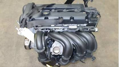

RoverFolkUs Posted June 23, 2023 Author Posted June 23, 2023 1 hour ago, omegod said: I have a 1.6 2005 engine and gearbox removed from my brothers Foci that was broken due to body damage, t'was a fine runner but has been sitting for a couple of years now You want it ? Ooh, whereabouts are you/is it located and do you know if it's the Ti-VCT? Notable by the inlet manifold design among other clues? Ti-VCT Non Ti-VCT Also, I assume it was a MK2 and not a very late MK1? As that's the changeover year which complicates searches sometimes Cheers!
RoverFolkUs Posted June 23, 2023 Author Posted June 23, 2023 13 minutes ago, omegod said: It's the Non Ti-VCT Ok, so the bare bones of the engine is all the same, I'd just have to swap over the ancillaries and camshafts Since my last post I looked at your profile, is it in Liverpool as per that? I'm over 5 hours away 😞

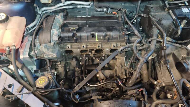

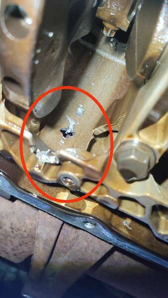

RoverFolkUs Posted July 7, 2023 Author Posted July 7, 2023 Oh dear 😳🤣🤣 .... Oh hello number 1 conrod, you decided to make a bid for freedom... Yep, it's even smashed the crank ladder carrier...!!! That shouldn't be facing that way... A 2nd hole in the block.. Let's not waste any time stripping this down and getting it out then.. more tomorrow! mercedade, UltraWomble, Coprolalia and 11 others 14

somewhatfoolish Posted July 7, 2023 Posted July 7, 2023 Air conditioned crankcase; the rare factory option. 🤣 CreepingJesus, RoverFolkUs, GrumpiusMaximus and 2 others 5
RoverFolkUs Posted July 8, 2023 Author Posted July 8, 2023 9 hours ago, somewhatfoolish said: Air conditioned crankcase; the rare factory option. 🤣 Well it is a GHIA you know so the original owner spared no expense 🤣 AnnoyingPentium and somewhatfoolish 2
sierraman Posted July 8, 2023 Posted July 8, 2023 I hope you are using nothing less than the finest components in this rebuild. I’d expect the replacement crank ladder to have been made by hand in a workshop on the side of a mountain in Bavaria by a 90 year old engineer that made cuckoo clocks for Nikki Lauda. AnnoyingPentium, CaptainBoom, Popsicle and 4 others 7
Zelandeth Posted July 8, 2023 Posted July 8, 2023 That's some impressive carnage. Guessing the engine was turning at some speed when this happened then? RoverFolkUs 1
Jenson Velcro Posted July 8, 2023 Posted July 8, 2023 Is throwing a rod a common problem with those engines? What do you think caused it? RoverFolkUs 1
High Jetter Posted July 8, 2023 Posted July 8, 2023 2 minutes ago, Jenson Velcro said: Is throwing a rod a common problem with those engines? What do you think caused it? There's a clue in the first post, it got flooded GrumpiusMaximus and RoverFolkUs 1 1
Jenson Velcro Posted July 8, 2023 Posted July 8, 2023 And I’ve been there and done that myself. With a Citroen ZX though. RoverFolkUs 1
