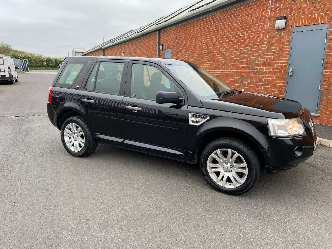

The now redundant Freelander 2 got new rear pads and a good scrub from top to bottom ready to sell, doesn’t half look good still.

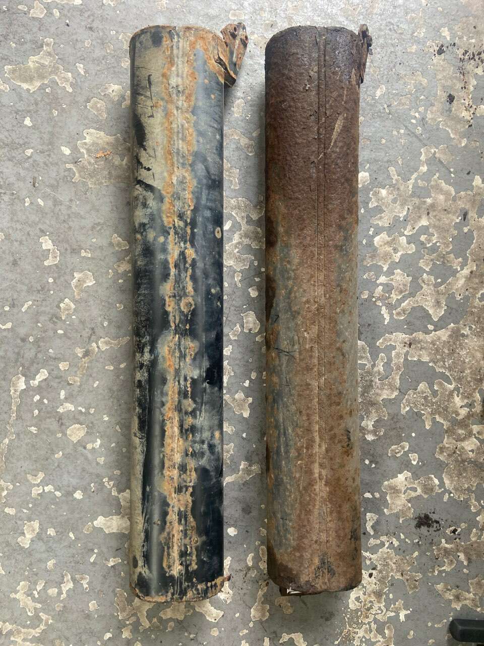

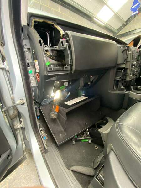

Disco of doom got the sunroof leak attended to. Stripped down the passenger front lower dash and removed the fuse box, sure enough lying in the background was the long since perished sunroof drain, helpfully depositing its contents now into the footwell rather than outside.
Added an extra bit of hose after removing the perished elbow to extend it back through its hole to the outside and built it all back up. Still got to dry out the carpets but as a bonus tried a recalibration on the sunroof and it burst back into life, ready to never be used ever again most likely 😆

Freelander 2

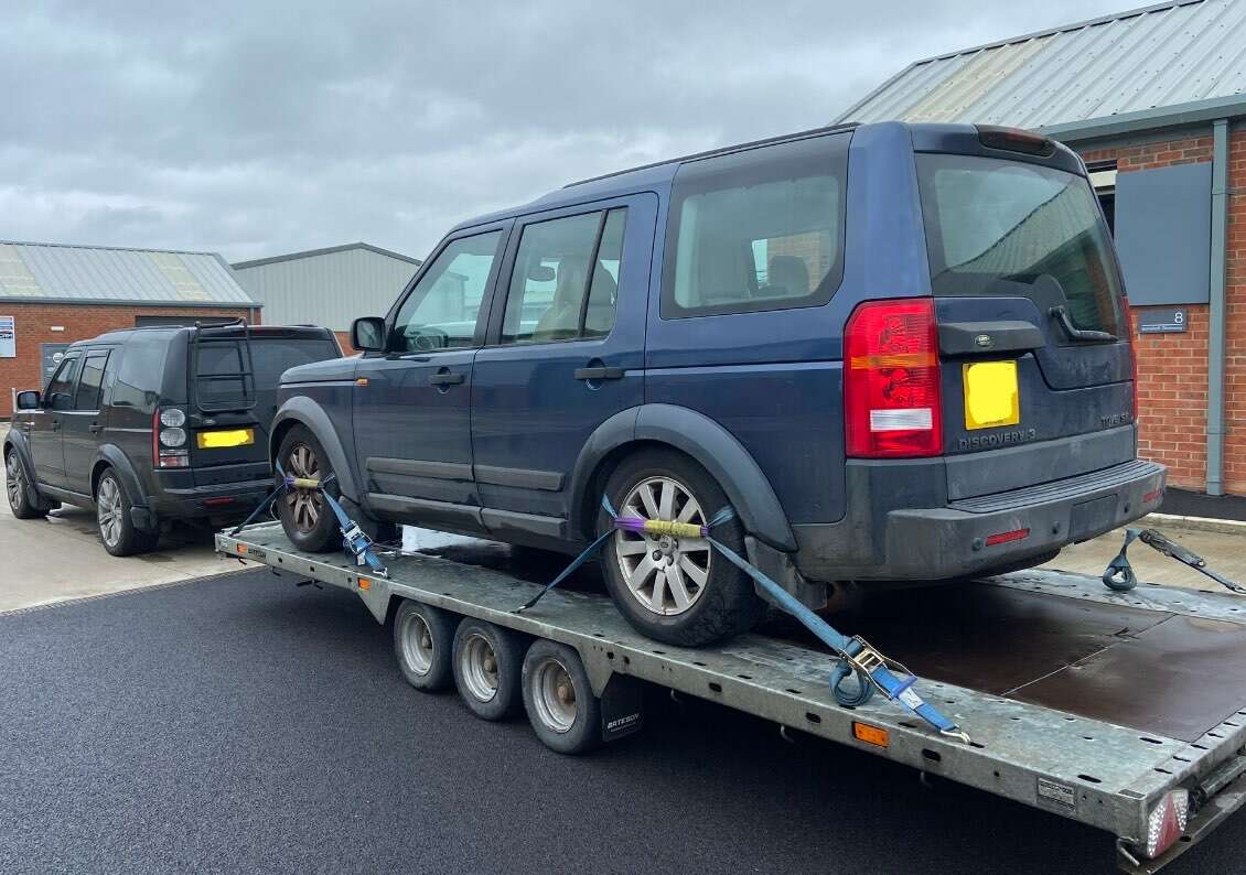

Got this all spiffed up nice and sent it away to a mate to be sold. Sat around for a bit before finally selling, shame some skid mark on society cloned it during that time and performed a spectacular hit and run in Sheffield, leaving me in a spot of very hot water with the Police. Situation ongoing…

Now showing 257k miles and still worked hard every day. Struggled with a shake on the steering since March that I’ve finally gotten to the bottom of last week but only after battling with faulty new front calipers and lower arms along the way. Made for some ultimate hair pulling but the original issue was traced to a restriction in the ABS module for the front n/s caliper, causing enough of a drag/heat to shake at speed but no excessively hot wheels or any usual stuck caliper symptoms.

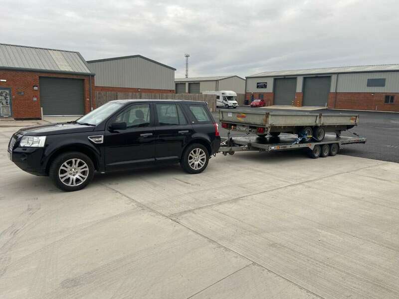

Threw on some spare wheels and ditched the mudflaps, even put it on the big trailer which it tackled with ease.

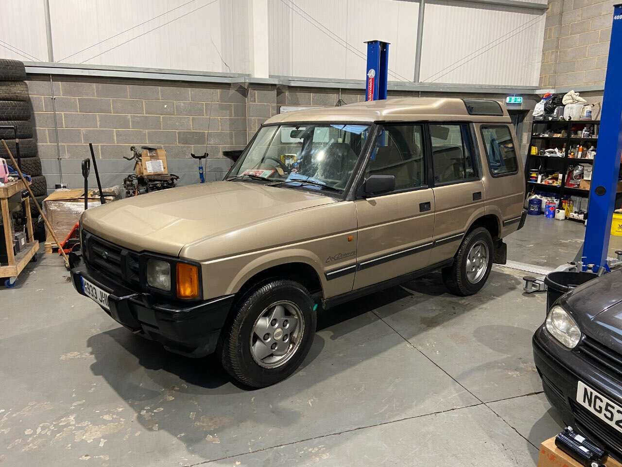

Having reduced the fleet and got caught up with some jobs I decided it was only right to pile on the stress again, quick jaunt out with the big trailer to pick up this absolute stunner
No idea what to do with it yet, she’s a good runner but needs some suspension bushes and an air tank thrown at it. See how I feel tomorrow when I wash some of the grime off it.

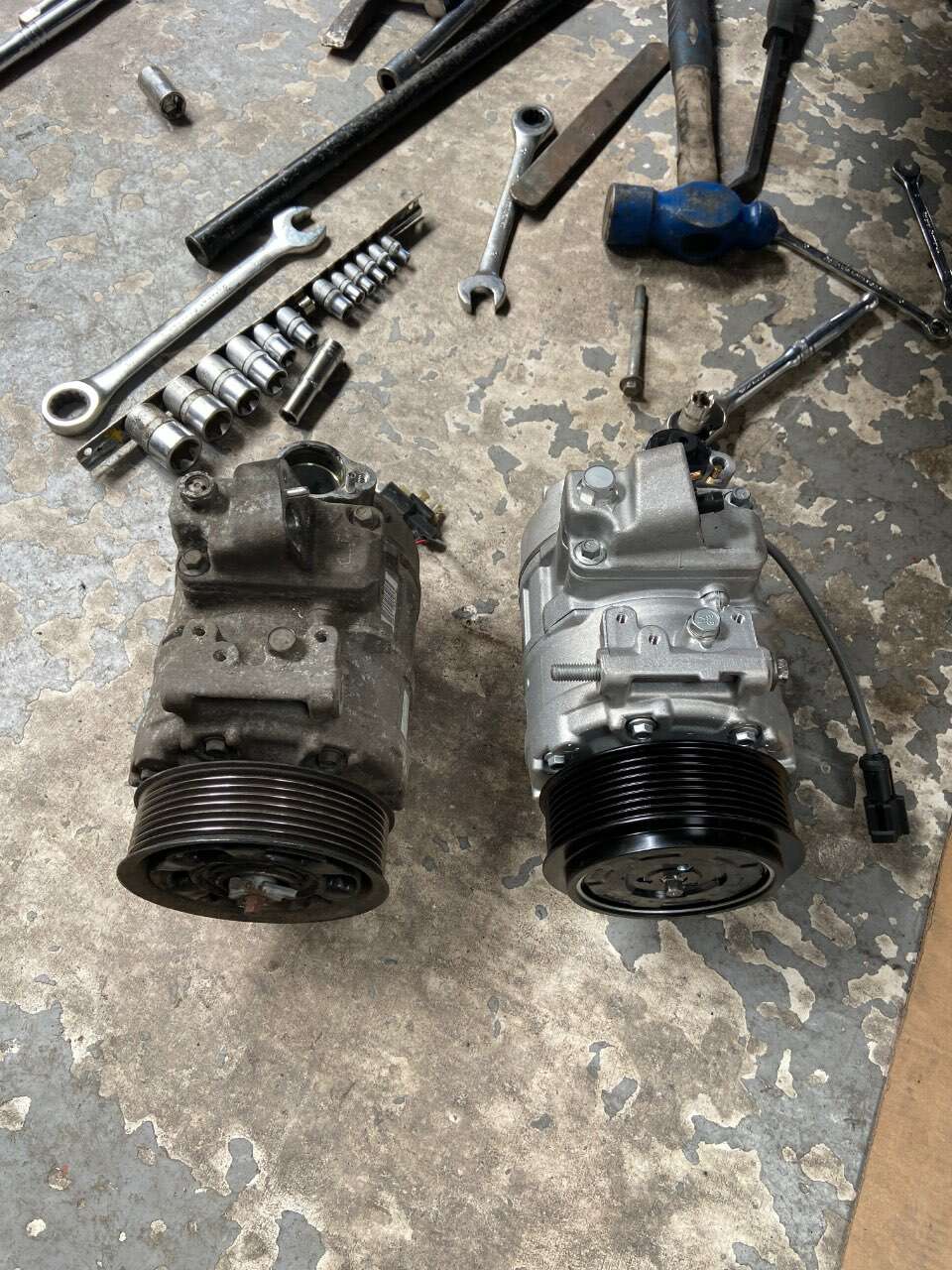

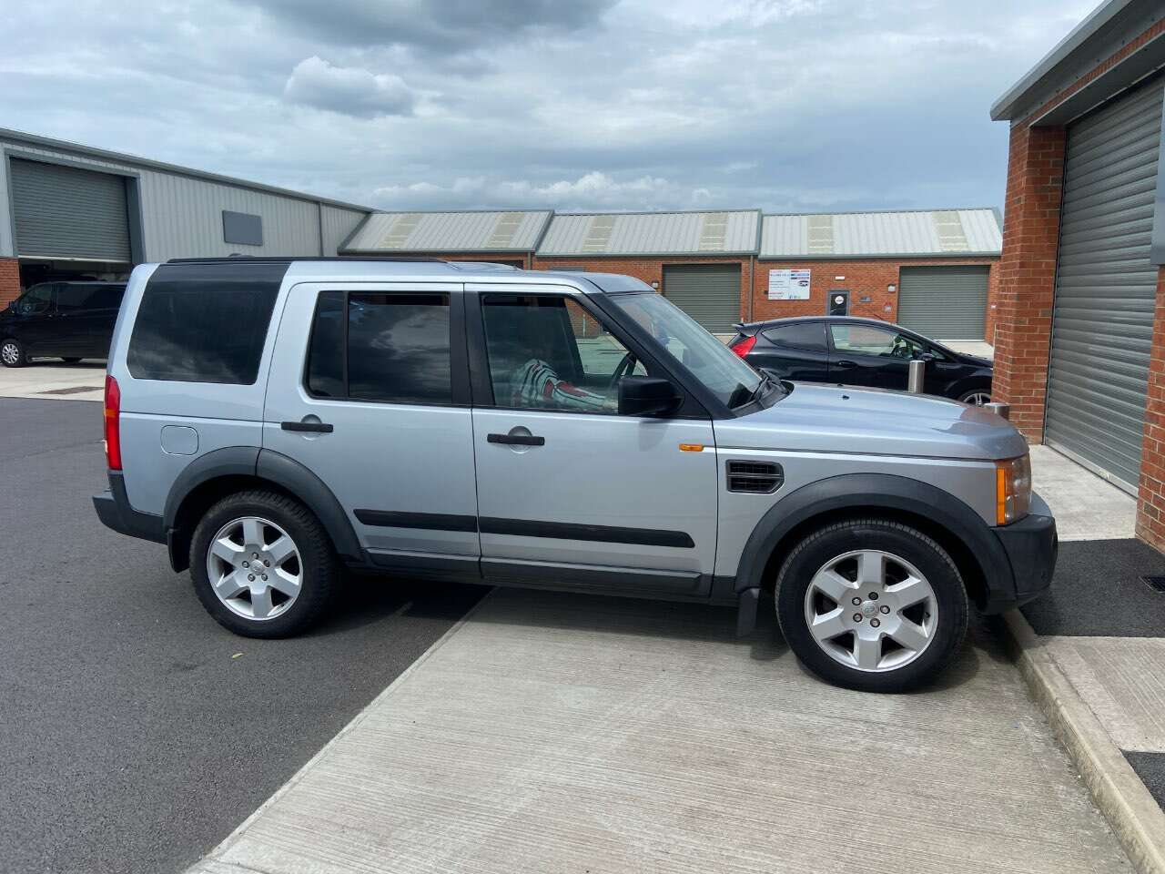

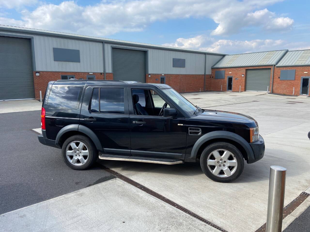

Well that was easy, replaced the air tank with a good used one and rebuilt the air dryer that was completely shot. That got the air suspension working again
Recharged the aircon while I was at the suspension, now ice cold as it should be
With all that sorted out it was time for a test drive and a quick scrub up. Really drives well with no knocking or banging, I’ve driven bad ones and this is far from it.
A mate dropped by to have a nosy and with that it’s sold. Kinda breaking the golden rule of don’t sell Land Rovers to people you like but he’s been fully forewarned! He’s going to sort out MOT etc so my journey with it ends here. 24 hours ago it was off for scrap but now it’s off to start a new life, I’ll take that.

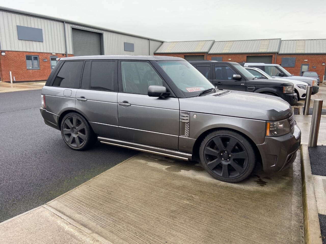

I’ve always wanted a last of the line l322 Range Rover and ideally in Overfinch flavour, so when this exact combination came up while idly flicking through copart one evening I knew I had to have a bid. I knew nothing about it other than it wasn’t a write off and it had a run and drive marker (which doesn’t stand for much!). I ended up winning it for less than my top bid but a bit more than I was comfortable with. After a nervous 4 day countdown and it was time to see what I’d won.
To my surprise it started up straight away and ran lovely, went through all the gears and even the suspension worked. In fact the only immediate issues were absolutely no brakes due to a burst hard line and 2 flat tyres.
A new brake line was made up, a spare set of wheels was chucked on and the interior was given a scrub. Been rocking this thing for a few days and it’s awesome, needs tlc for some small issues and some bodywork but nothing drastic at all.   Current plan is to run it for a bit while working through its niggles then get it into the bodyshop next year to make it mint providing it hasn’t blown up

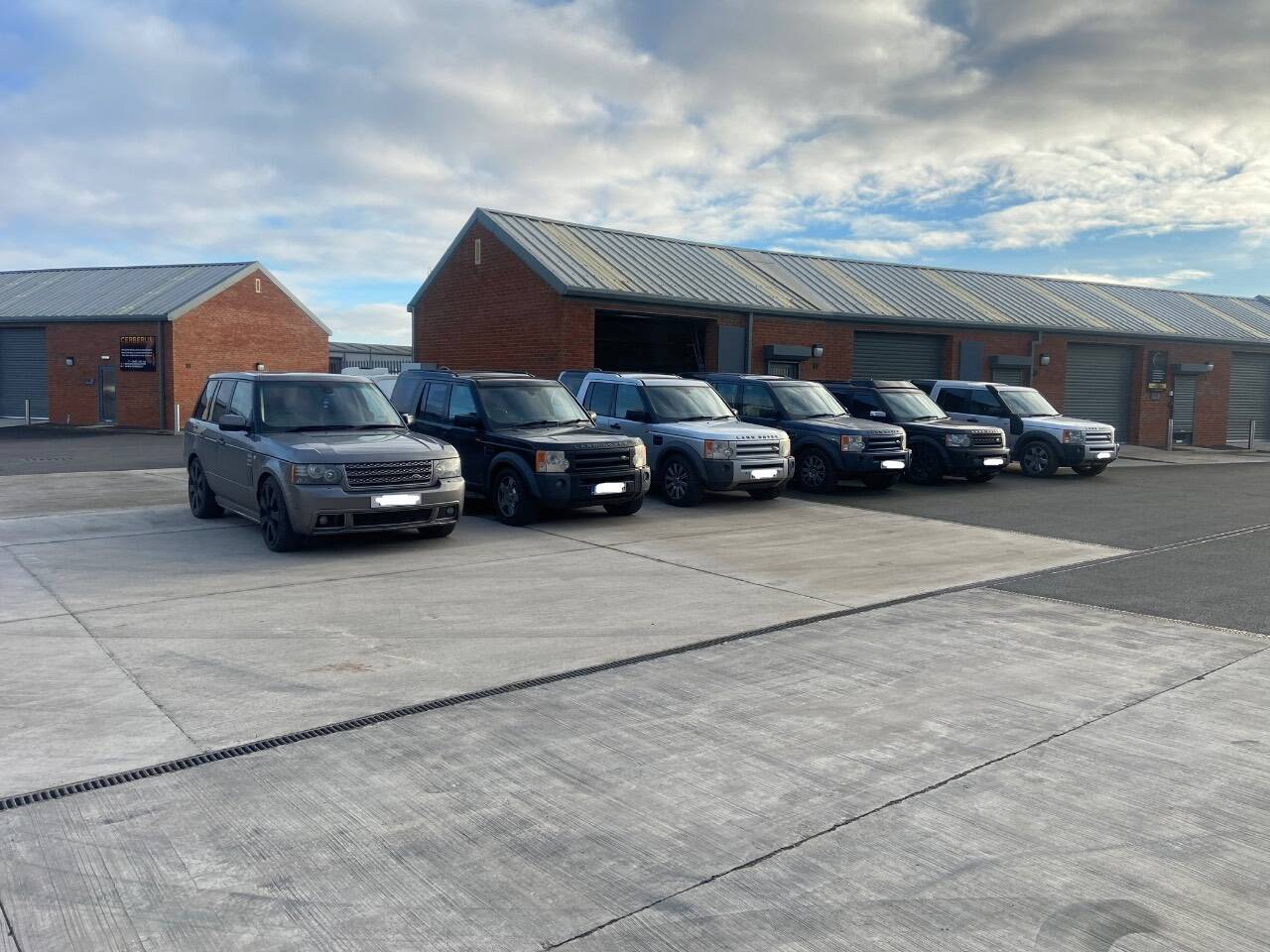

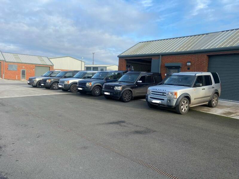

Finally managed to get all the Solihull outcasts together for a photo, shiters may have noticed a disturbance in the force earlier as a black hole of unreliability opened up somewhere in South Yorkshire! Keen eyed viewers may notice the blue one that featured earlier, my mate still has it and hasn’t put a foot wrong in 4K miles. He absolutely adores it, so much so he sold his other motors and is currently in search of a facelift auto version.
#allLandRoversareshit

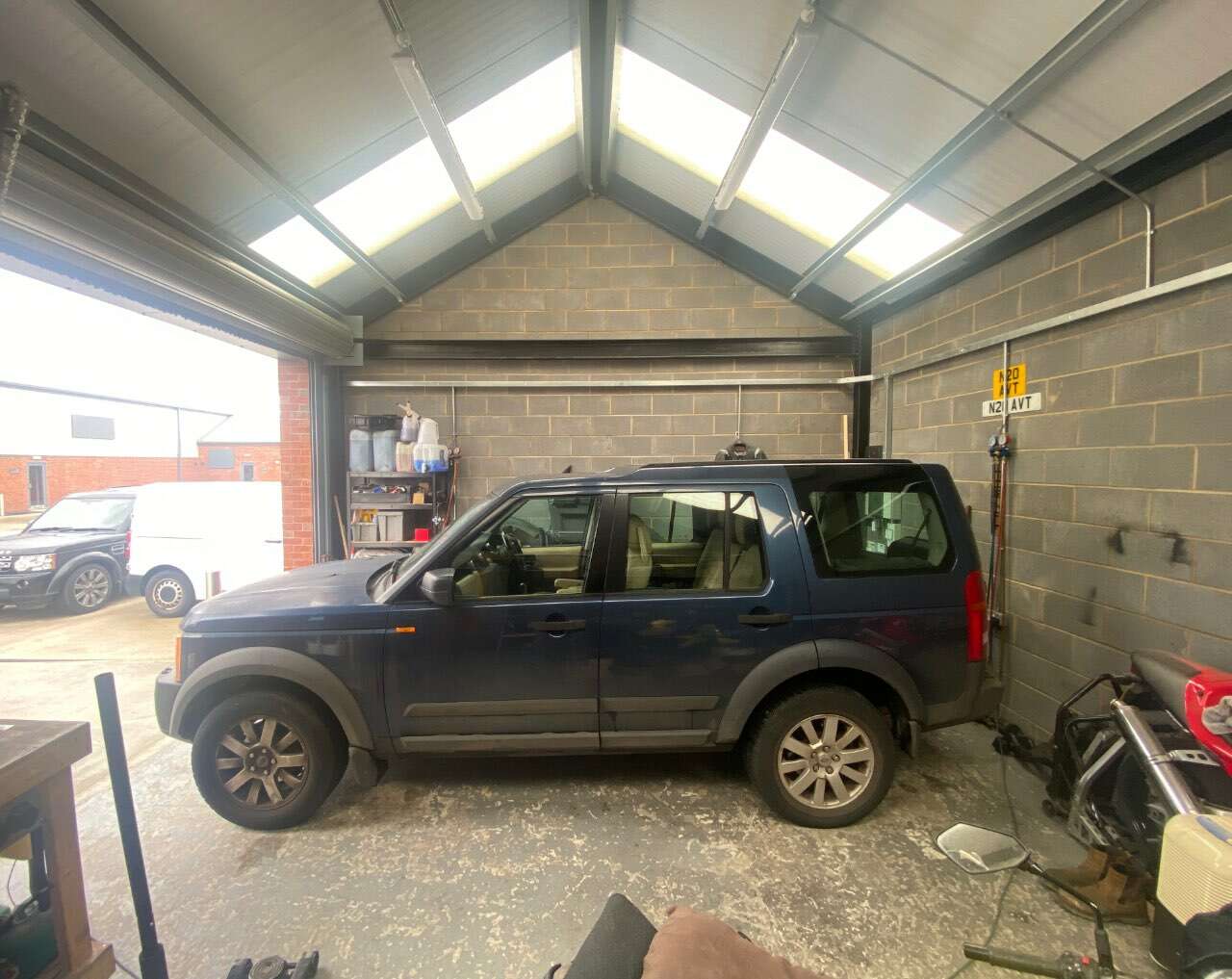

Been a while, had little time for extra curricular shiteing solely due to being absolutely flat out with work.

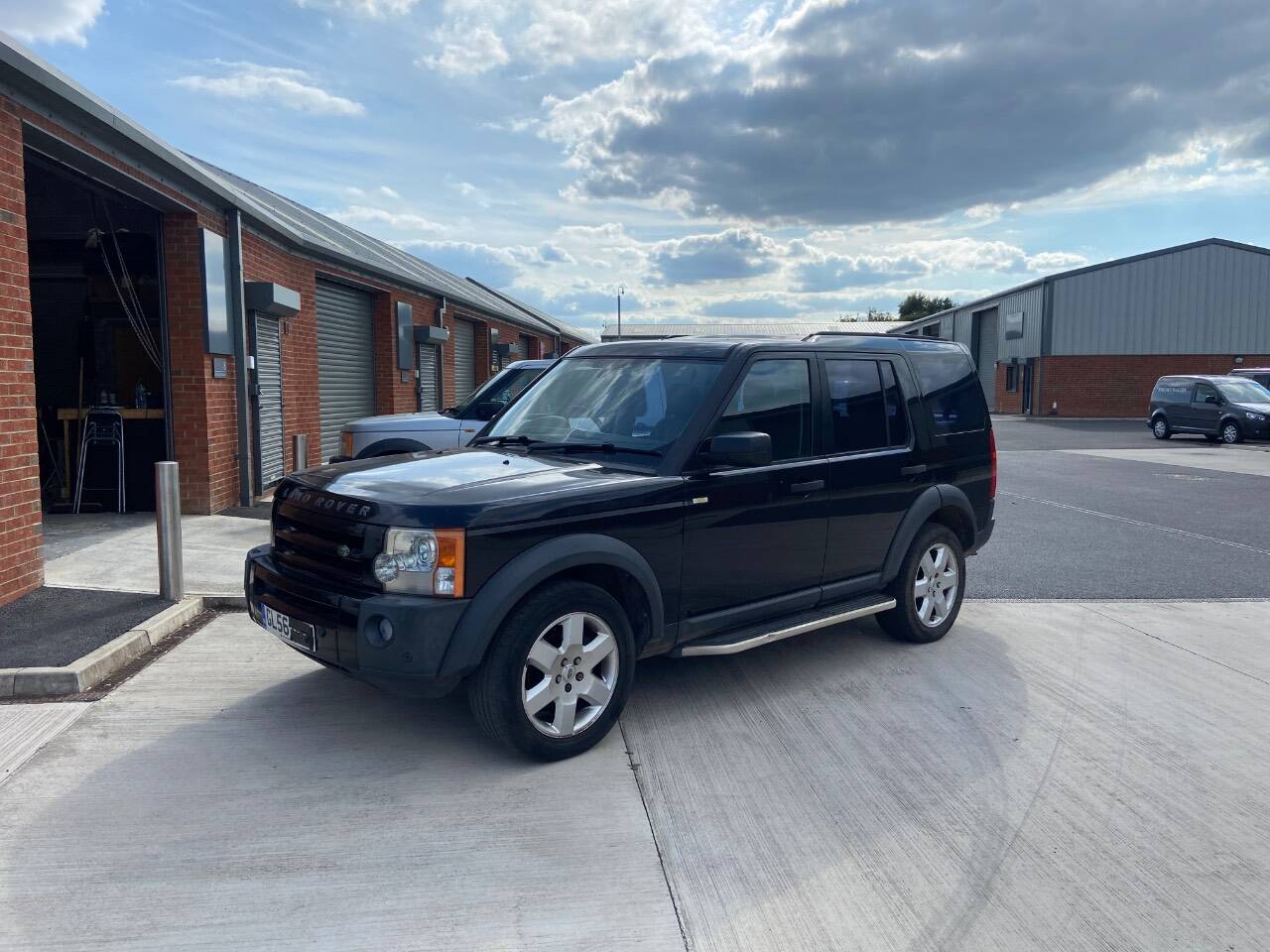

In all the madness though I’ve managed to buy a honey of a Disco 4 with slipped timing which is tucked away awaiting its turn in the workshop:

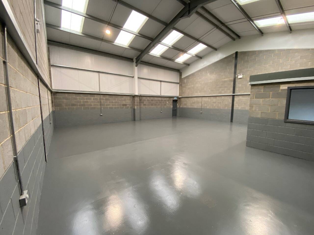

Moved workshops after too long struggling with too little space:

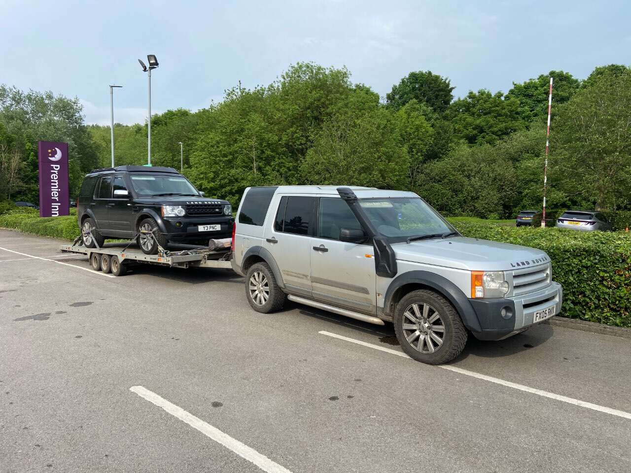

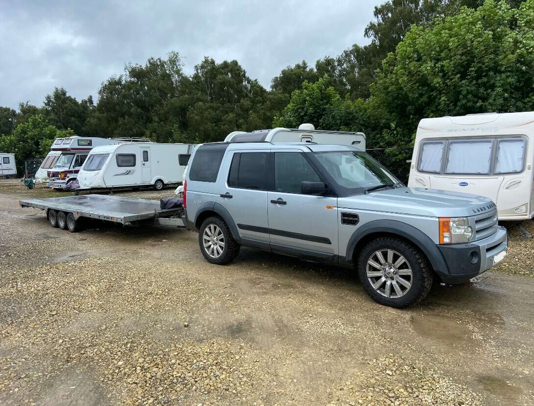

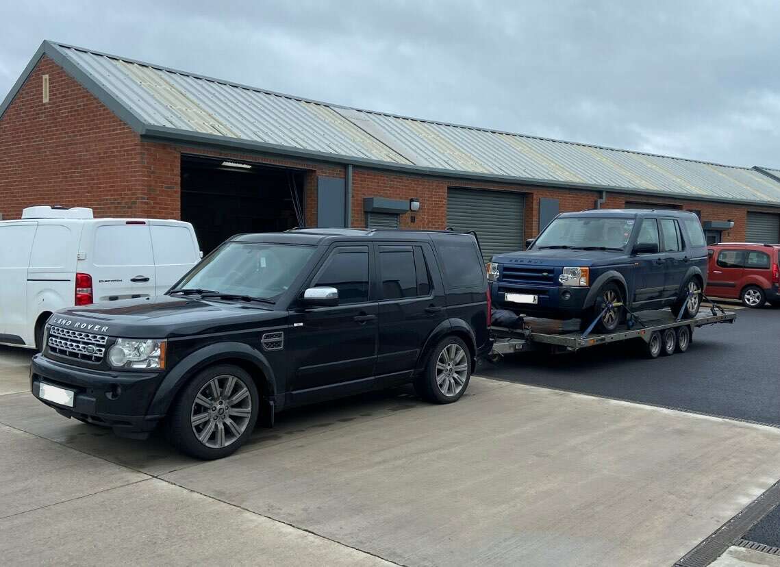

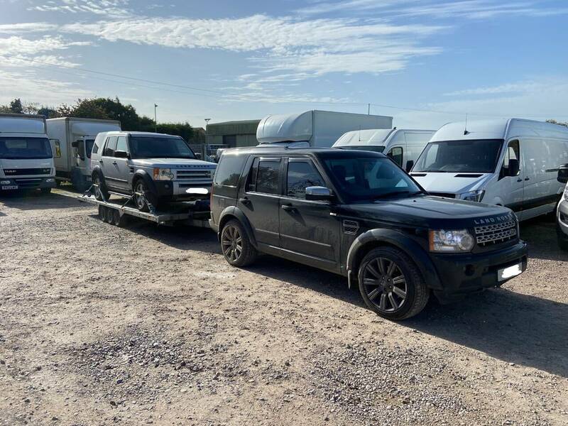

And today after getting itchy bidding fingers on copart again, hitched up the trailer and headed for York. Ominous photo of thoroughly deflated Disco3:
Bought as a non runner with the intention to break, assuming complete engine failure as 07-08 is right in the danger zone for oil pump casting failure. Back at base looking sorry for itself:
20 mins after unloading it’s only bloody running, just a loose injector nut making it lose fuel pressure. Runs a treat, suspension works great and only a single warning light on the dash for low pads. Looking a lot happier:
Now to shovel out the interior tomorrow as I’ve got a potential buyer coming to look at it 😅

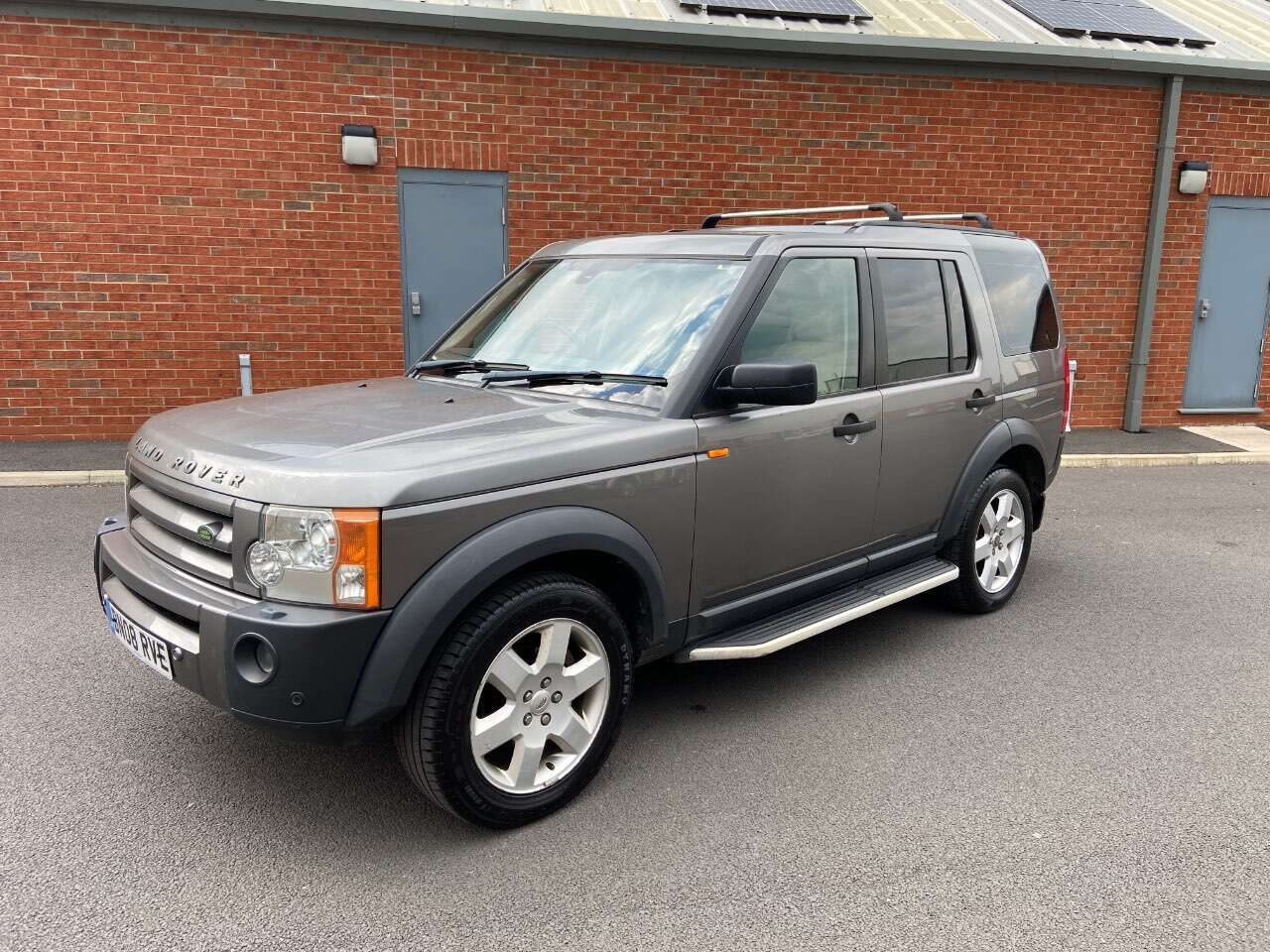

Slowly putting miles on the big grey whale and unknowingly falling in love with the thing. Properly understated car, one that at the start of the year neither me or the wife thought we had gelled with. You’ll hear about this later…

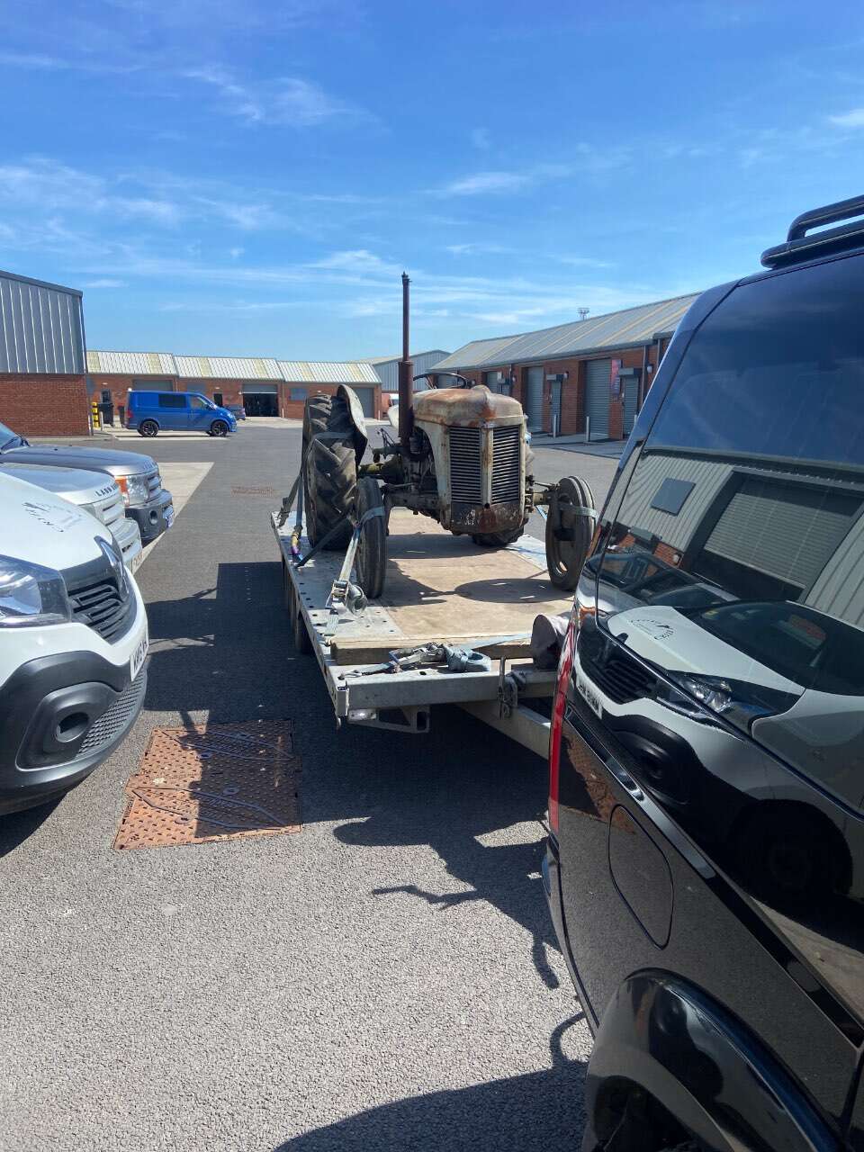

Sold the grey fergie after doing literally nothing with it for a year. Went to a cracking young lad who had bought it to restore with his younger brother who had learning difficulties so definitely off to a good home.

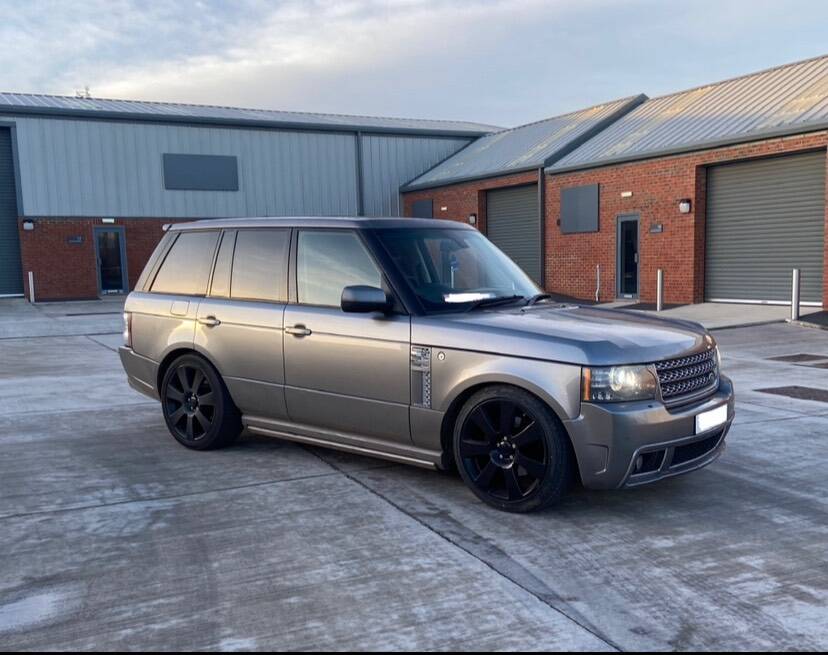

Put a plate on the L322 to really make it ours and took it to Shedfest - we seemed to be some of the very few who got straight in no problem

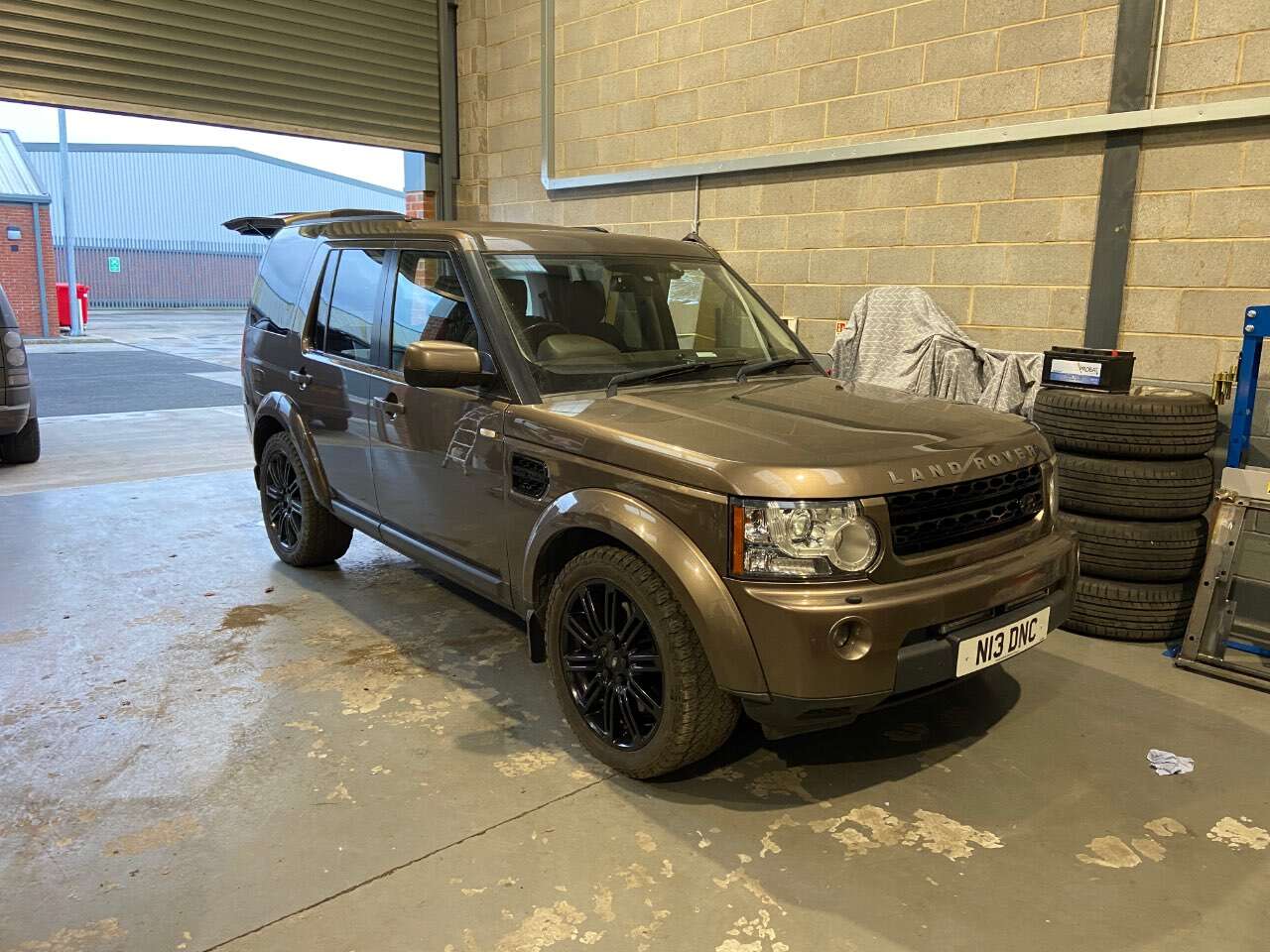

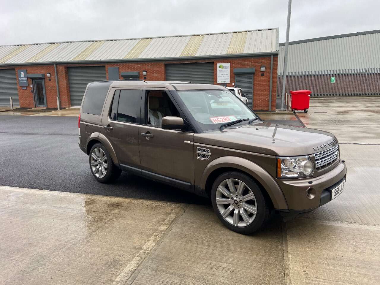

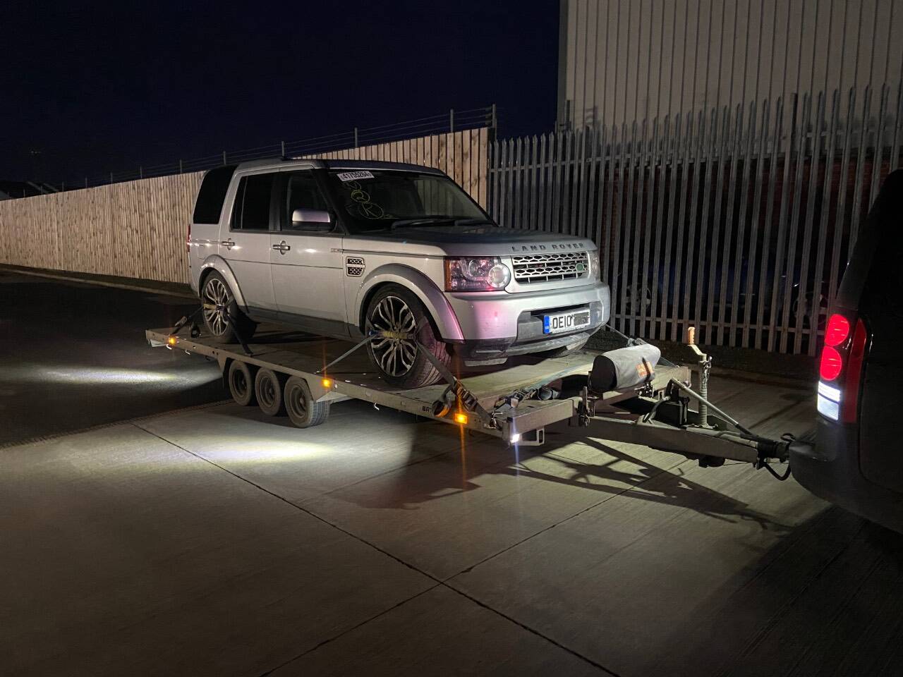

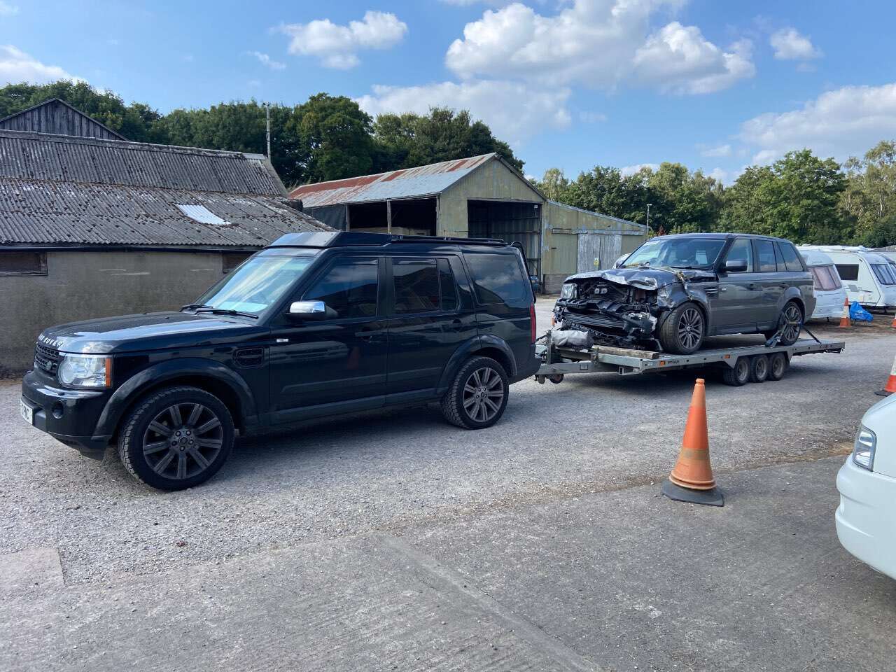

Bought a beautiful Bronze top spec Disco 4 from Copart, went to retrieve this from Wolverhampton. Bought as a non runner but with loads of accessories (apparently recently) thrown at it. Can only assume someone spent loads on bits, it then immediately ate itself and they just gave up and got rid out of disgust!
The wife immediately fell in love and asked to have this over the Range Rover, so naturally I then had to find an engine. I found one, still attached to a smashed up Range Rover Sport

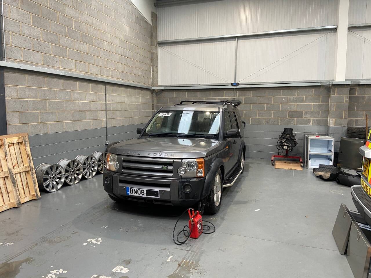

While this was going off I’d got the grey Copart Disco3 clean up (better than first imagined!) and advertised, and had agreed a sale with a chap. Sadly the next day I had to pull out of the deal as I found myself in need of an engine…

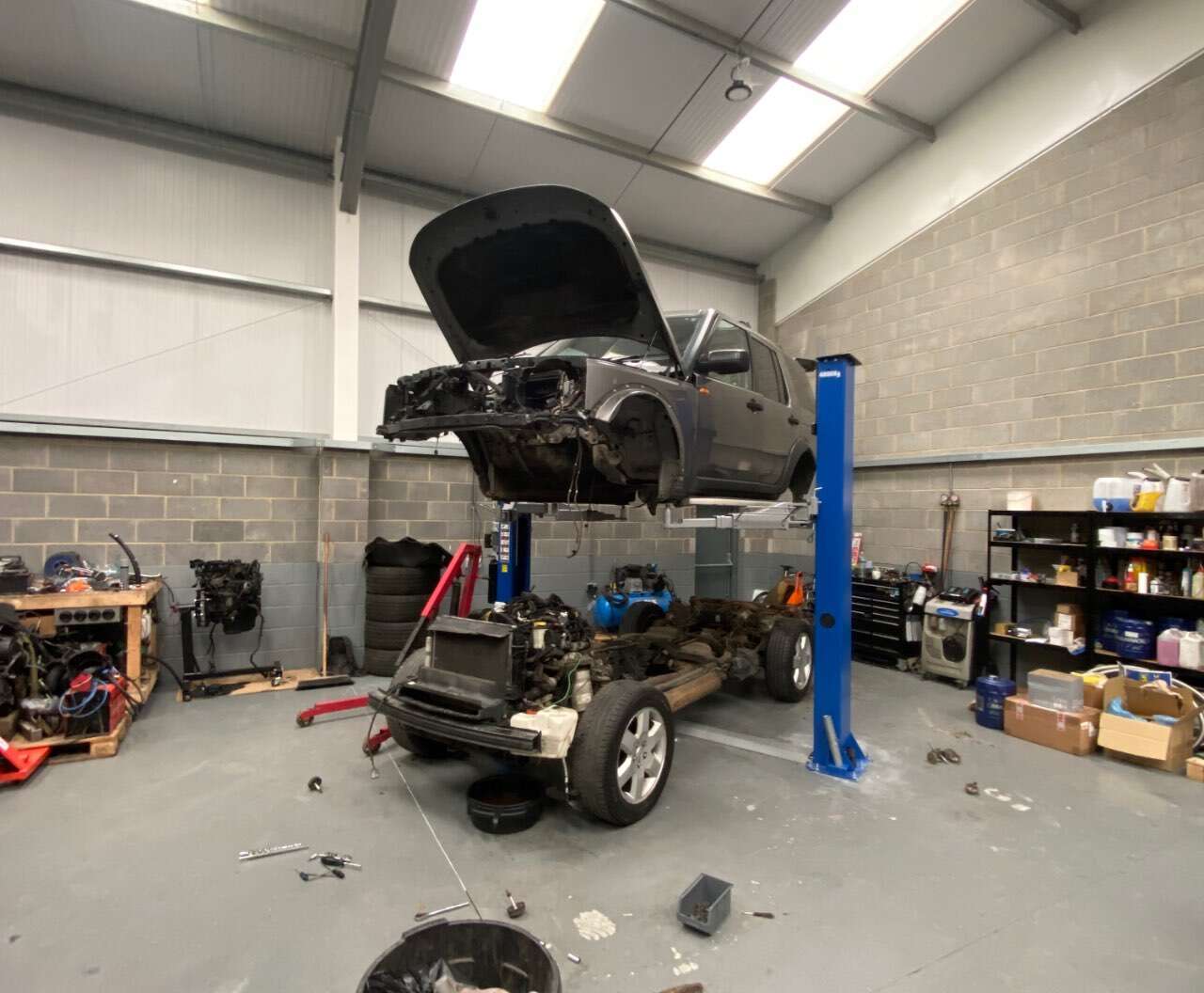

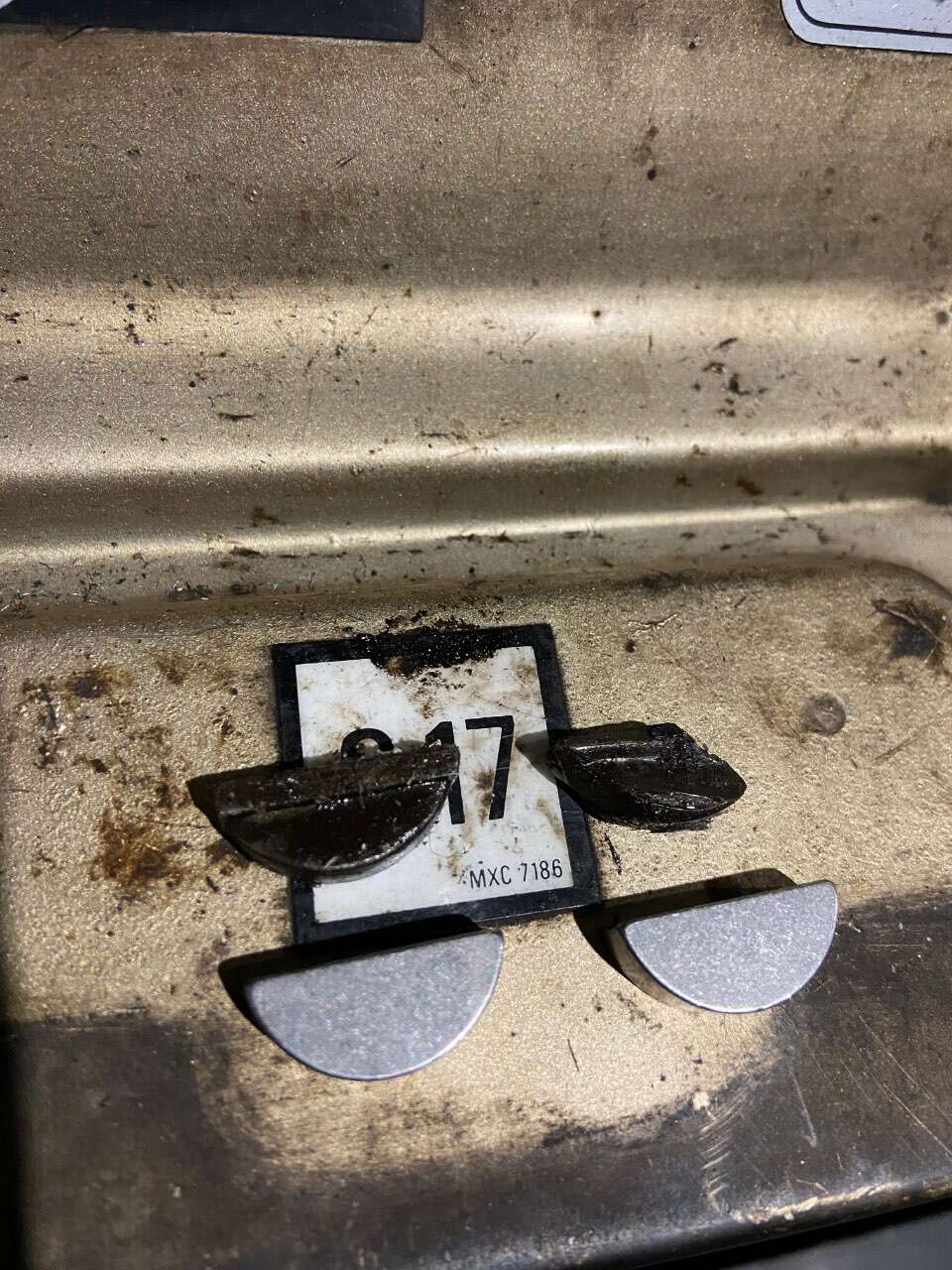

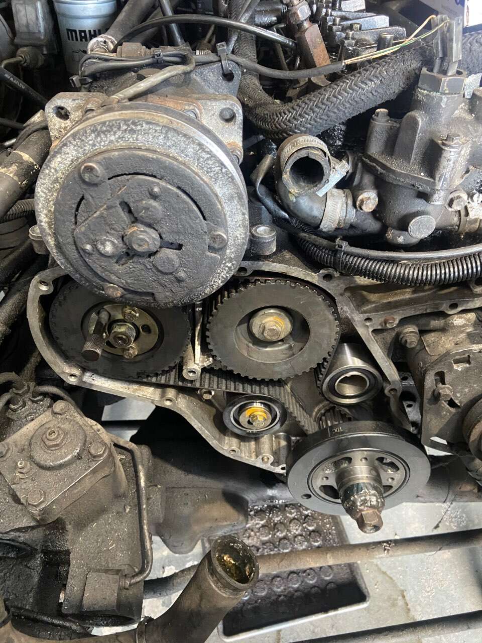

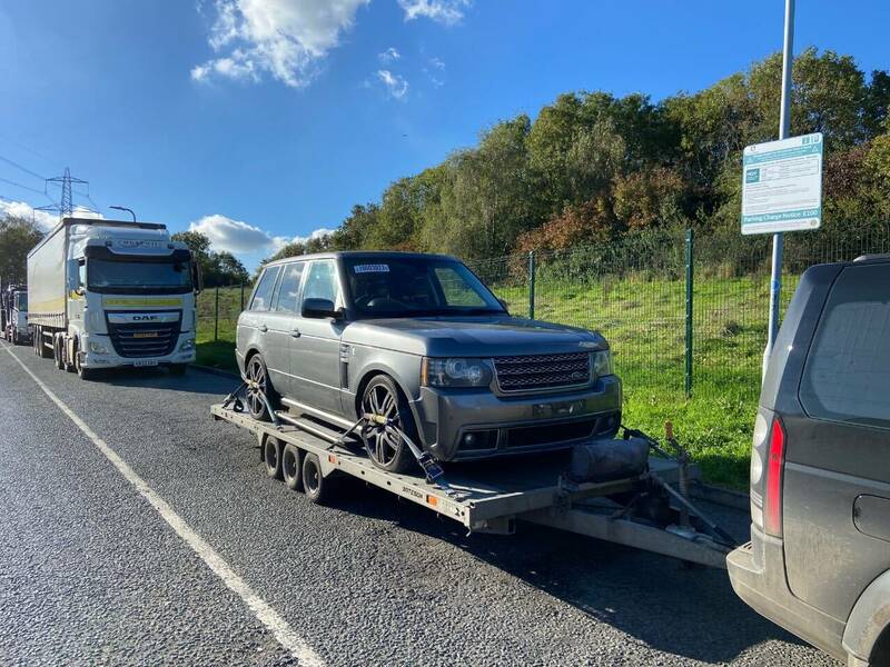

The day had finally come. At 276,053 miles it finally happened. Driving along the M62 I suddenly heard a proper din, thinking there was a loud car or bike behind me initially. Checked my mirrors and nothing behind me, put the clutch in and the pedal was half way down and shaking.
Sure enough yes the bottom end had gone, in the fast lane of the M62 ‘smart motorway’. The faithful old girl held together 6 miles to limp me to the next exit, and only locked up completely at the bottom of the slip road. There was no chance I was stopping on that motorway.
Rang the wife to come get me, grabbed the commercial with the trailer and went back to recover it. Faithful old thing still started back up to drive itself onto the trailer 🥲

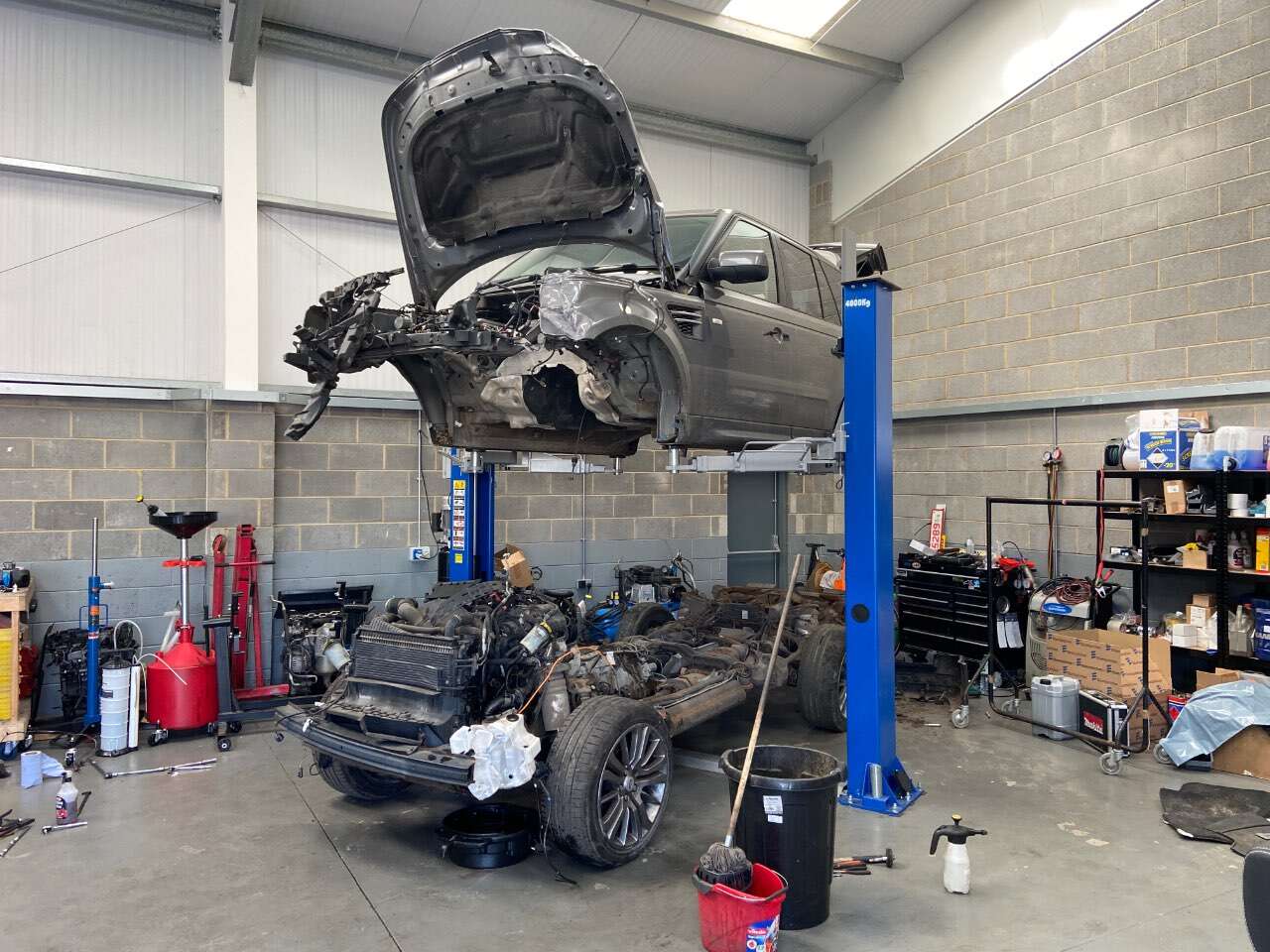

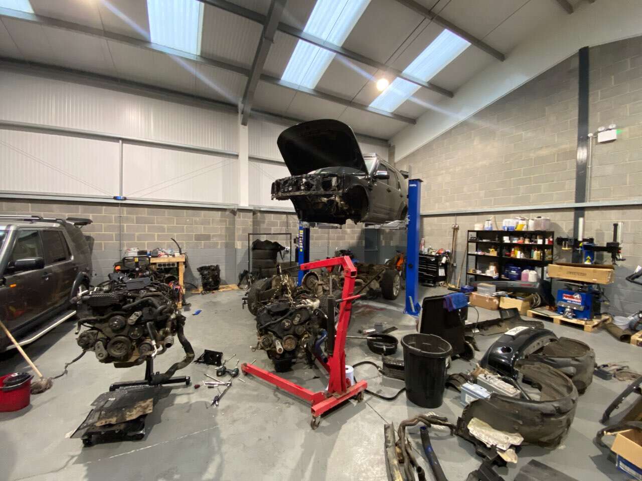

We had the space and the resources, only thing left to do was get stuck in. Grey Disco with the body off to donate its heart
Rinse and repeat on the recipient:
18 days later we were back up and running. Only took so long as I had a nightmare with stuck injectors in the donor engine meaning having to build a good compatible lump from 3 engines. If it wasn’t for that we’d have been going again in a weekend.

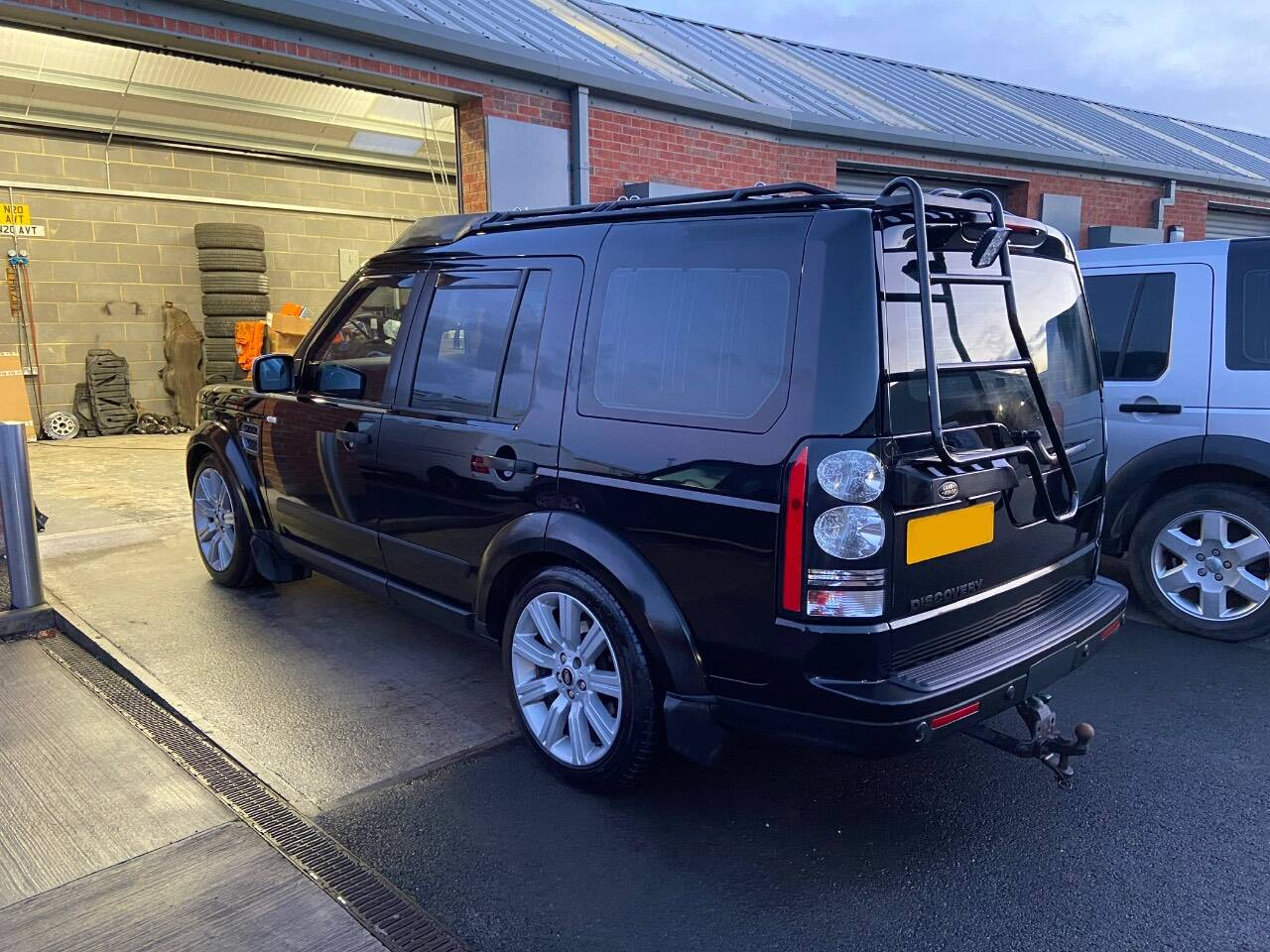

Now we were on a ‘fresh’ engine I was keen to do a couple of improvements I’d never got around to before, one of them being a big intercooler (rs500 sierra cosworth pattern!)

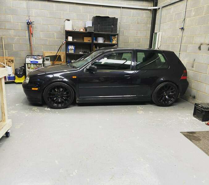

I then sold the Fiesta van and dug out the old golf for running to work and back

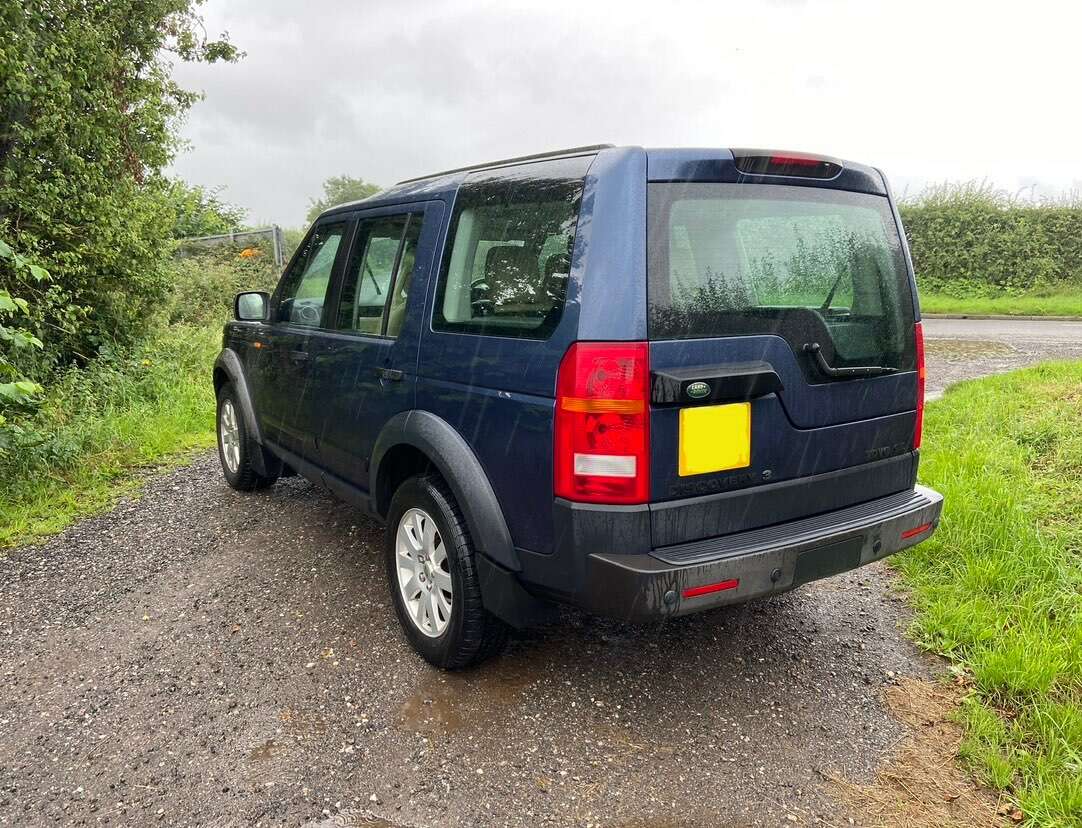

At some point in all this my mate who bought the blue Disco3 early in this thread had been noseying around the Disco of doom as he fancied a lower mileage and automatic example. Said Disco of doom having provided over a year of sterling trouble free service for my mother. He made me an offer I couldn’t refuse so off it went, leaving mother with no wheels. I was checking out Quashqai’s but as a Land Rover man I just couldn’t.

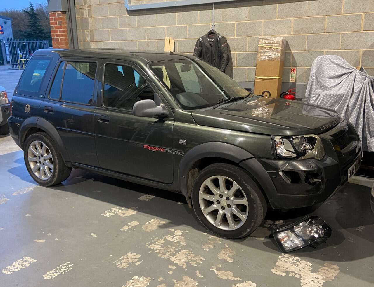

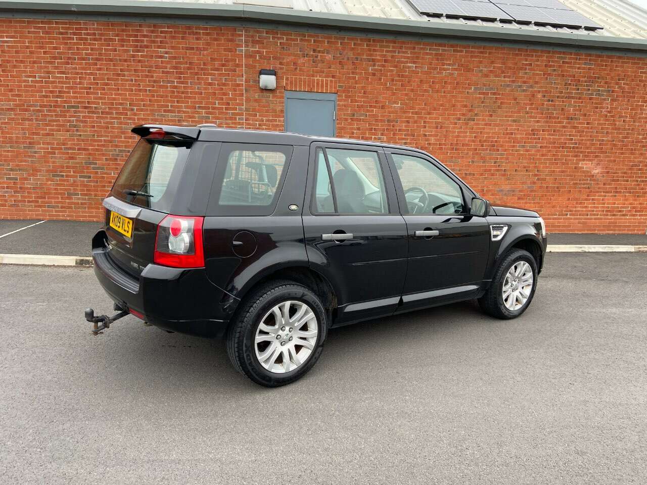

Enter stage left a very cheap decent spec freelander
And after a headlight, tyres and a track rod end here we are

I’m grateful that the day to day work allows me to have such facilities to play with. That being said the Land Rover job didn’t half grow some legs last year and now I look after quite a few for people on top of the playing about buying and selling.
It’s just been diesels as petrols aren’t really my cup of tea. Not scared of em but I’m more workhorse than racehorse 😁

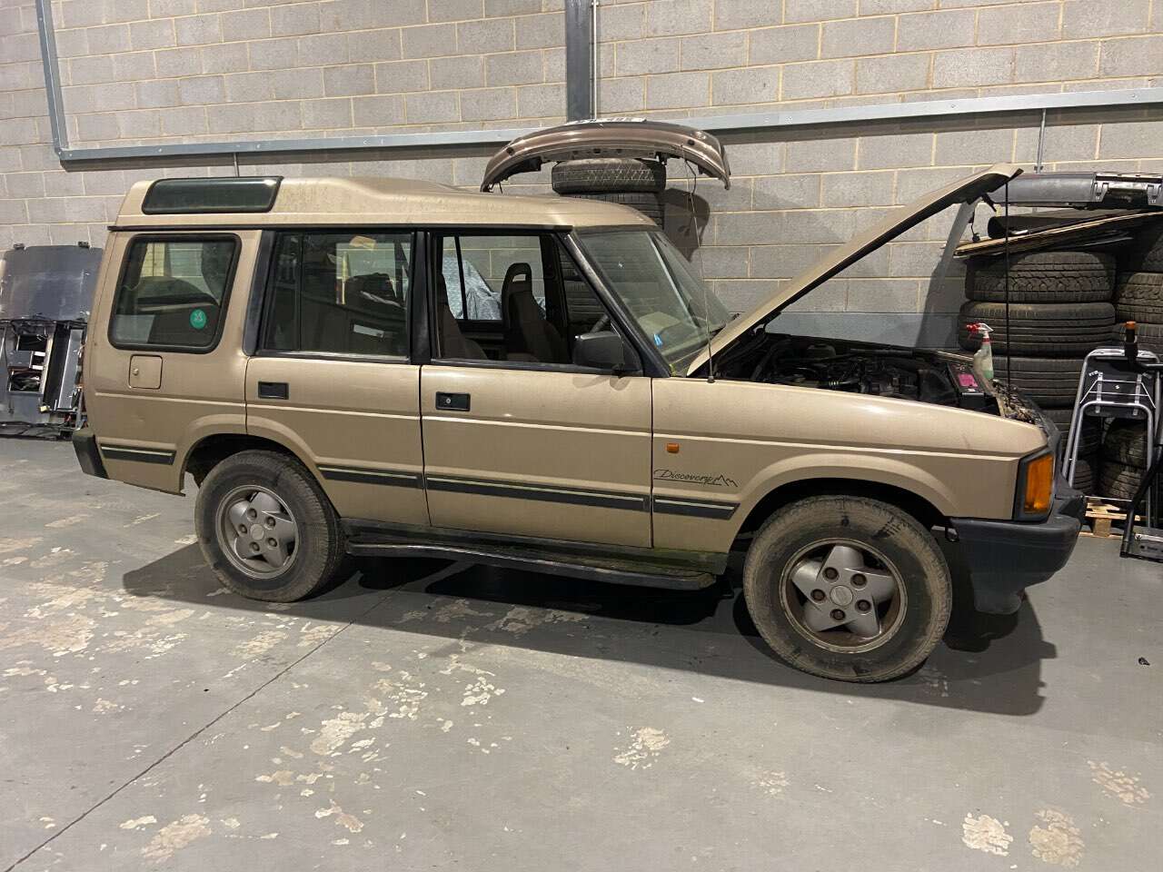

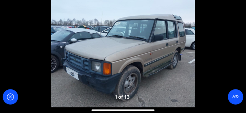

‘The mathematical equation used to determine how many Land Rovers deemed acceptable to own at any one time is n+1, with n being the current amount of Land Rovers owned’
I was fucking useless in school and especially at maths but I can understand that for sure. With that in my mind, a clear workshop and fresh funds from selling some vehicles it was fate that a Land Rover I’d been pining for since I sold my last popped up on Copart.

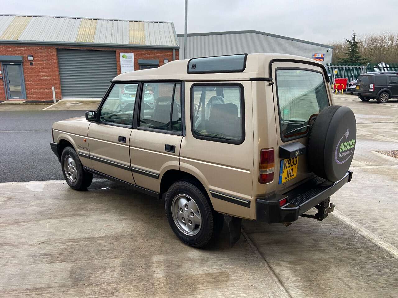

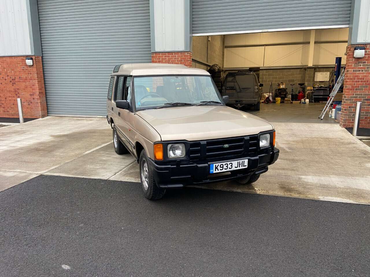

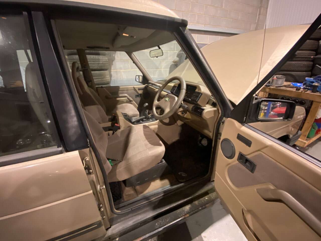

Of course it was miles away, a non runner and the photos made it look really sad but my mind was made up I had to have it - these just aren't that common anymore. Despite the negatives, it only had 2 previous keepers and the MOT history was quite tidy, a sign of either a life of care or a dodgy tester.
So what was it that had me so smitten? Well it was only a bloody proper Discovery wasn’t it. A 1993 200 tdi manual to be exact.
Trailer hitched, I hot footed it down to Newbury and collected it. The second it touched down on the trailer I nervously looked around and it was only bloody solid with a chassis still in factory black and even a boot floor and inner wings still present. Bumping the key revealed firstly a battery with charge, but secondly a 200 tdi engine that turned over evenly.
Back at the workshop I quickly worked out we had no fuel due to a very limp lift pump. Nipped to the local LR parts place and grabbed a new one for a whopping £20, primed her up and hit the key… and she fired right up!
Wasn’t as easy as that though, it ran but badly. Would miss when revving up and at idle had an awful knock. If you could get it to clear up it would sound sweet so I knew there couldn’t be too much wrong, a closer look at the wobbly crank pulley and centre bolt gave some hints
Oh dear! Some screwdriver stethoscoping confirmed the knock to be coming from the front near the pulley, so looks like this was another victim of the age old 200 tdi loose crank bolt. Some Die grinder action and welding a nut on the remains of the crank bolt, plus around 12ft of bar got the crank bolt out. Sure enough the woodruff keys were destroyed as were the pulleys, that was the cause of the misfire - variable timing! Great for valves, not so for mechanical fuel injection pumps…
This is mid reassembly with new timing belt etc, new crank bolt yet to come in
Got it all back together and hit the key, and she fired in less than a full revolution. Even better it ran perfectly and no more knocking!
Over the past couple of days between jobs it’s got a bit of a wipe down and the manky horrible side steps have got ripped off and thrown on the scrap pile. It looks ace as is so can’t wait to see it with a proper detailed clean. Currently waiting for the logbook coming back, going to do a couple of small repairs on the sills and then fire her in for an MOT.
