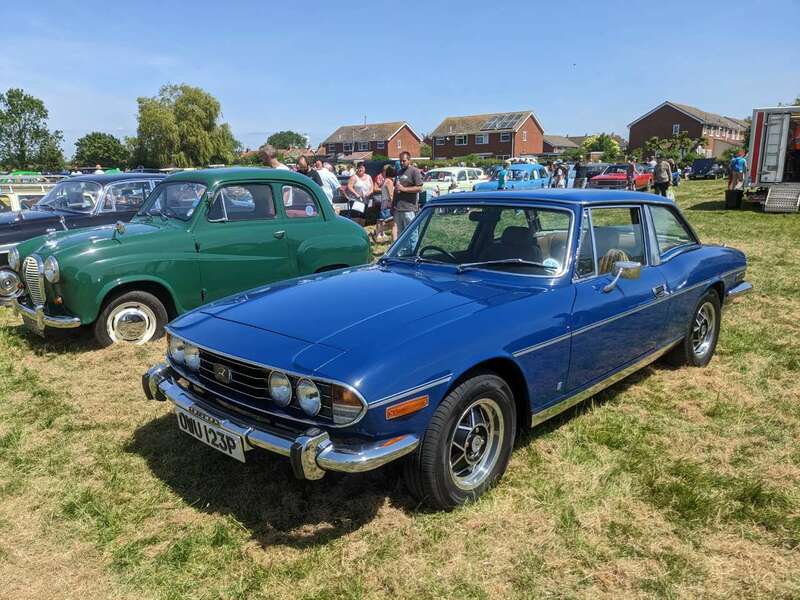

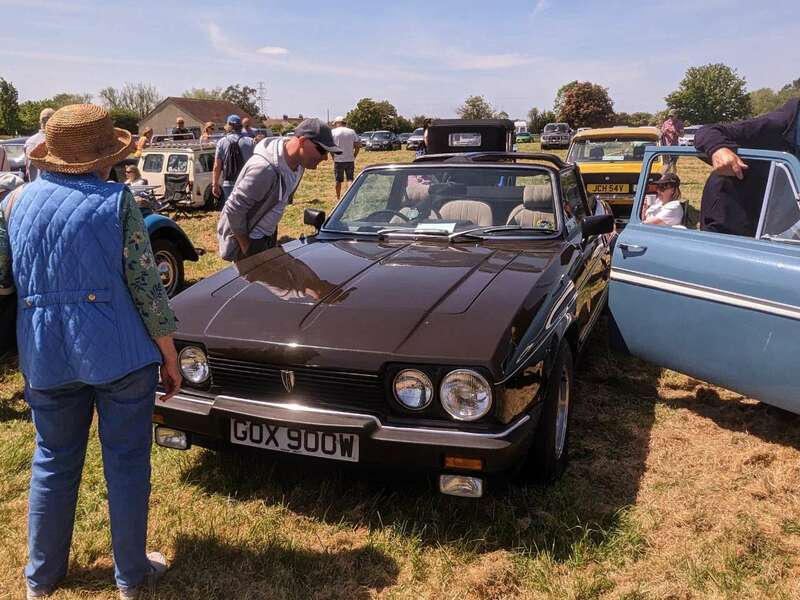

Today I went off to a local classic car show. It was in a village park and a great selection of very varied cars turned up.
I arrived an hour late so snuck next to some other British Leyland shite.
I don't know why but this car does attract an awful lot of attention. Far more than any other of my classics I had on the road. Maybe because of the colour it catches peoples eye?
I'll upload all my photos later as I have loads but I'm being badgered by the other half to get up from the sofa and sort stuff.
Brilliant progress, as ever. Whoever wired the fan in (not me, honest!) was a right numpty, so nice to see another rats' nest sorted out.
I see you've been picking at the dash varnish 😉
You're not wrong about the attention. I don't think I took that car out once without someone commenting or starting a conversation about it. It must be the colour, although Spitfires aren't nearly as common as they used to be. And the shape is gorgeous.
So the car show! There was a good selection of everything and a few odd balls thrown into the mix. Its always nice to see old Renaults and such in attendance at a British village car show - I do quite fancy a Renault 4 one day.
