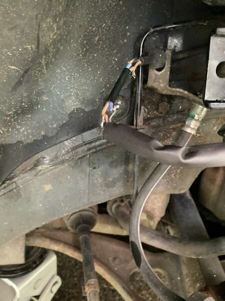

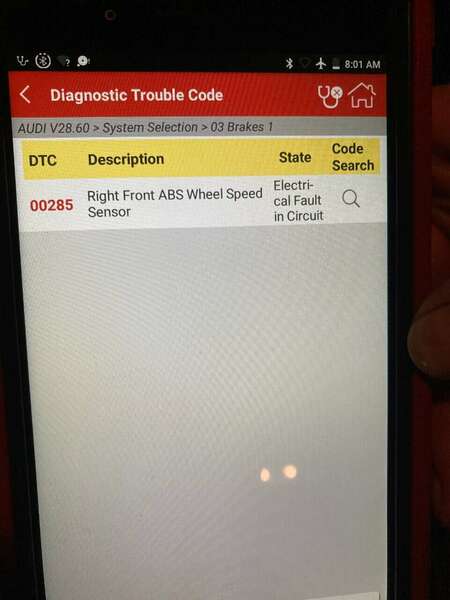

I had a go at soldering in a bit of temporarily ABS wiring in the drivers wheel arch to see if it was the chaffed wiring that was the problem.

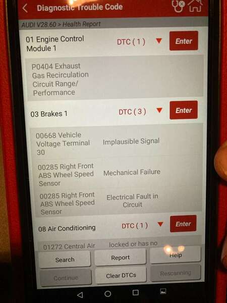

ABS light still on. Our ever helpful neighbour has a fault code reader so he plugged it in to have a look at what was up. Lots of codes showing so reset and had a look at what came back. Code for mechanical failure of the drivers side ABS Sensor showing so that will need replacing to hopefully put that light out and get it MOTed. Other fault codes related to the EGR stuff so not sure whether the EML is on because of the Oil Level Sensor or whether it's something EGR related.

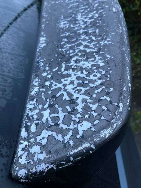

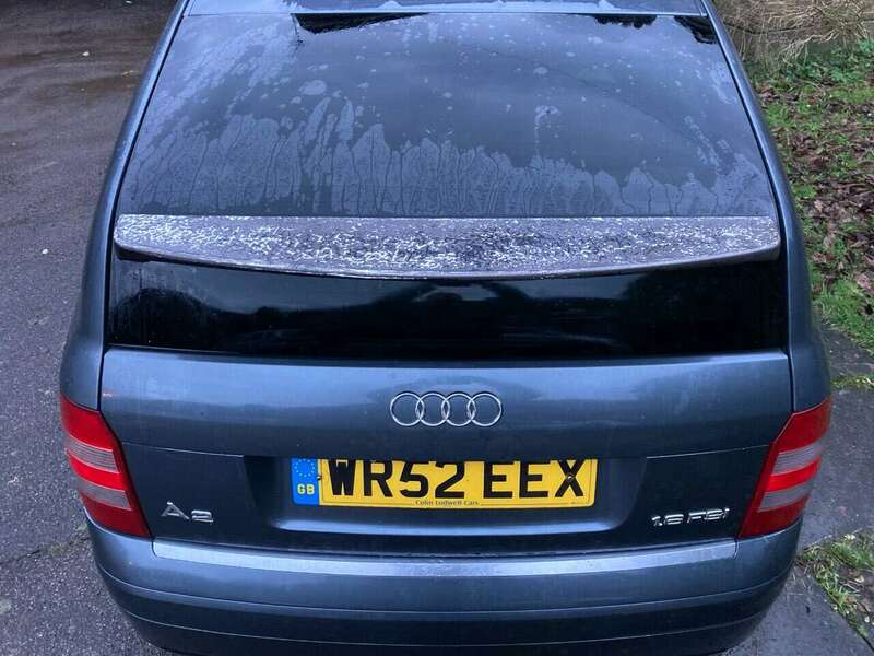

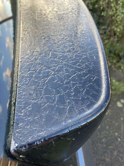

I had a go at the paint on the spoiler. Rather than doing what you're supposed to and check the results of the paint stripper on a tiny bit that is out of sight I merrily slathered the stuff all over, waited, repeated, waited and hosed off.
I mean, I couldn’t make it look any worse could I?
Oh, yes it appears I could.
Going to leave it as it is for the moment while I either work out a plan for refinishing the spoiler or I find a cheap replacement tailgate the same colour to maybe do a swap (the spoiler is bonded onto the tailgate).

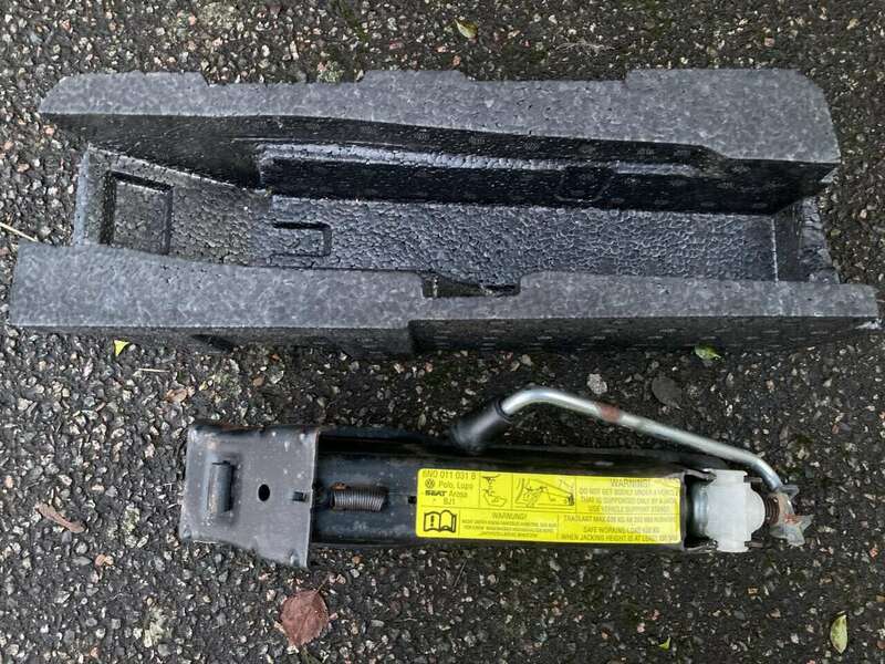

Someone on the A2oc site noticed from one of my pics I had the wrong jack.
Correct jack now bought, the old Lupo/Polo/Arouser one available for cost of postage if anyone wants it.

Last week it went to the mechanic for new ABS and oil level sensor, and a general check over. He cleaned out the EGR flaps and pipes and stuff I don't understand. Came back with no warning lights on and he'd even put it through its MOT which was due next week, so it's got a fresh MOT! Hurrah!
I can now spend some time and effort fixing some of the other low level niggles. Looks like it’s a keeper and will remain in the fleet for the time being, so I thought I'd introduce it to the 924, both cars were built in the same ex-NSU Neckarsulm factory 21 years apart!

  I had quite a productive day with the A2… neighbour plugged in the code reader thingy and we got a code P0404 Exhaust Gas Recirculation Circuit Performance. He cleared it and recommended using a can of Wynns EGR cleaner on it to see if that helps. So we’re back to no warning lights.

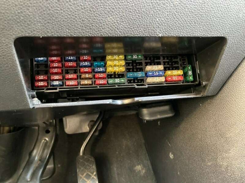

I noted a few missing bits and pieces (studs for fitting mats in the passenger footwell, dash fuse cover) I managed to clean up a lot of the hard plastics like the sills and glove box cover so they all look more presentable and now it now feels a bit more like it’s our car.
image.thumb.jpeg.f31a52a44342eb396cc25c39616d7ab4.jpegimage.thumb.jpeg.554a8060f1d6dc0c9bf91e8ccd646455.jpeg

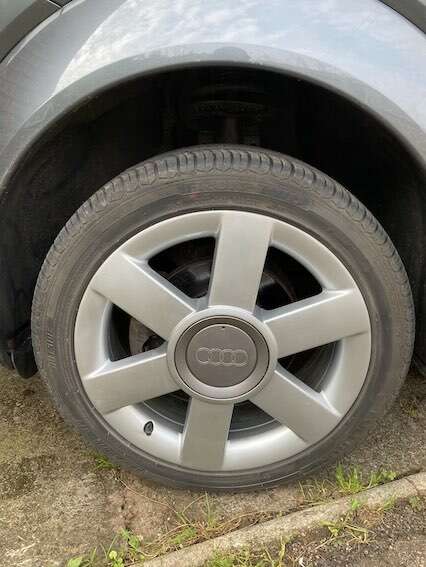

I got the alloys refurbished, and while the bloke was doing them I took the centre caps into work and had a go at removing the nasty water damaged chrome rings to see what could be done as I didn't fancy paying the asking price for a new set.
Pushed the Audi badge through from the back to remove
Used a screwdriver to bend the edge of the metal ring back
The grey plastic behind was very dirty but all four cleaned up really nicely.
I decided to put the Audi badge back on and re fit them without the chrome. Who needs chrome?  Especially on something avant grade like an A2. I think they look great!

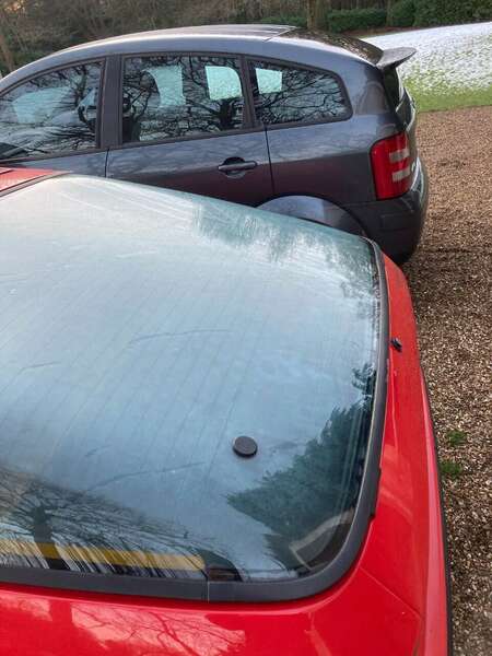

That same weekend I decided,  since the weather was good (and I found some of Screwfix’s finest paint stripper in the shed) that I would have a go at sorting out the spoiler. Here's a reminder of what it looked like when I bought it:
Took several goes on the stripper and plenty of scraping, and lots of sanding with the palm sander, but eventually about 4-5 layers came off and left the bare white plastic spoiler.
I was tempted to leave it white plastic but decided to paint it satin black, with a few coats of filler primer first.
A couple of coats of filler primer:
First thin coat of satin black
Another coat of black:
One last coat
Once dry took all the masking off to see what it looks like
I’m very happy with how it came out, especially for rattle cans, it doesn’t look 100% perfect by any stretch but most importantly is now isn’t the first thing that grabs your attention when looking at the back of the car. I'll clean up the edges, wash the car and get some better photos.
