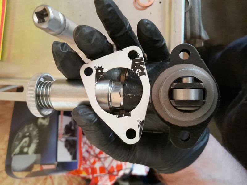

Checked the package tracking on the lift pump and it had arrived at my local post office. So after a 40 km round trip, the new lift pump has arrived.
And I'm sorry, there weren't a lot of pictures because I was a bit eager. But this is what the new pump looks like.
383409292_Screenshot2022-08-1521_05_25.thumb.png.7c9af15c37d0d124ad8aba30e64e513a.png
And here is a reminder of what the old one looks like.
So some differences. Then i took off the fittings and screwed on one of the old pump and this fits on the new pump.
Then I tried it on the engine.
And this seems to fit. The only thing is that I can't easily slide it all the way in. I think the reason for this is that since the lift pump is new the spring that presses on the part that rides on the lobe on the camshaft in the main diesel pump is stiff. The part that does this is marked in red below and this moves in and out.
822657406_Screenshot2022-08-1421_24_46.png.11604a4c07c29111402390ab44e907a2.png.998d849fd09769087657196bf3bf8737.png
And I don't think that a to stiff spring can cause problems, hope not. But it is impossible to know what the old pump was like as it is worn out so have to guess that it was also stiff when it was new.
So now it's getting close to trying to start the engine. Is just one more package I'm waiting for, which will probably arrive on Monday.

Is it possible that the cam that drives the pump has stopped on a high point i.e. would rotating the engine by hand (or rocking it in gear because diesel) make the pump easier to fit?
They'll be stiff - a non-lever assisted pump like that will be very hard to press.
The spring has to be very firm so the roller follows the eccentric and doesn't bounce or float.
At 3000 crank RPM the camshaft is turning 1500; that is still 25 pumps per second!
That's a good idea, I hadn't thought of that. So I will try / check that. Thanks!
This is good to know as I have no experience with these pumps so it seems almost too stiff for me. But then it should probably be like this.

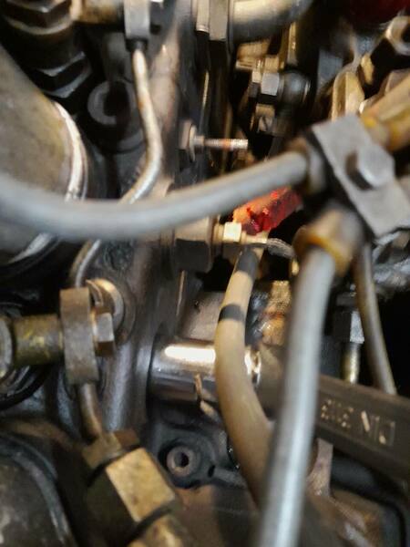

Started today to replace the glow plugs and these have clearly been here for a long time.
Cylinders 1 and 2 were changed without problem, but on cylinder 3 the problems started. It is tight here so there is little room for tools and the glow plugs are 21 mm which makes it difficult as I have few tools in this size. So I ended up modifying tools but unfortunately got nothing to work. And Cyl 4 is the same.
So I have to have a new tool so there will be another delay before it can be tried to start. And I want new glow plugs in before I try to start it.
And after this I assembled the new lift pump.
But one thing that was surprising was that it came with a new gasket and this one is for the newer type of lift pump on Mercedes diesels so it doesn't fit.
Then the next thing was to attach this to the engine. And I had problems when I tried yesterday to get this pressed in enough to enter the nuts on the threads but RayMK  suggested yesterday to turn over the engine so the lobe the pump rides on will go in. Don't know why I didn't think of that but after doing that I got the pump in enough to get the nuts on and now the pump is mounted on the engine.
So I'm very close to having a running engine now.
Just be very careful undoing those glow plugs,a snapped one is a pain in the hoop,ask me how I know🙄
Yes, Im trying to be careful with them. Hope I can get the last 2 glow plugs out without any problems.
