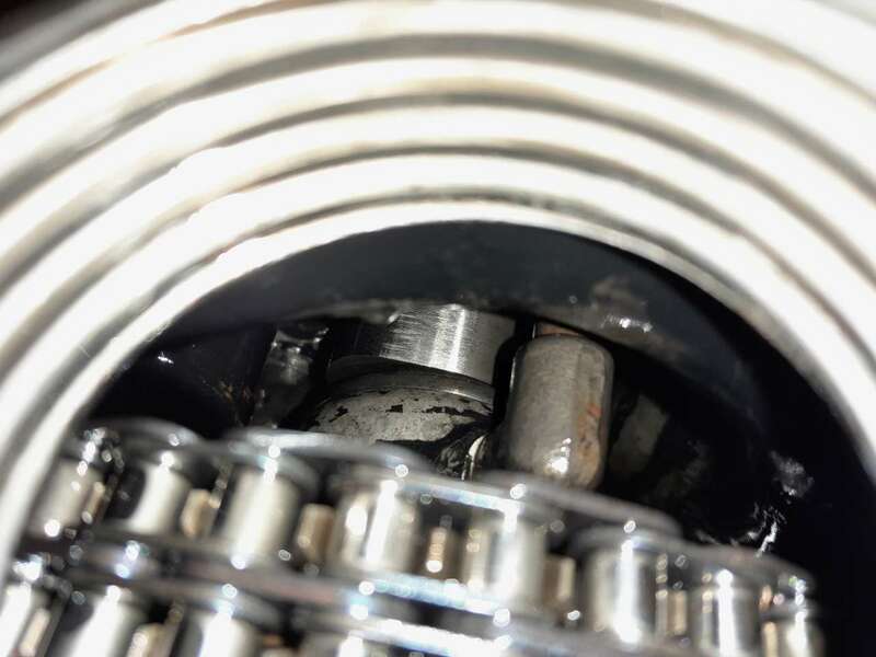

Put a new fan belt on yesterday and it calmed down the noises more than I had thought, so that's good.

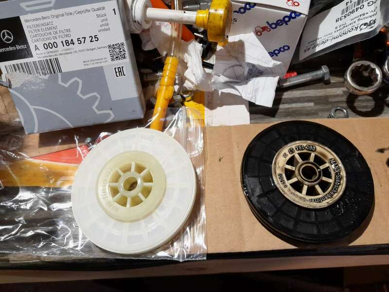

And have now had another short oil change done today It was 260 km since the last oil change and will now run normal oil change intervals on this one going forward unless something else happens.
And the important thing I got done was to change to a new oil pre filter, these should only be cleaned and not changed, but the one I have is so clogged that I struggle to get it clean and have doubts whether it can be saved.
And the difference between new and old prefilter is quite clear.
And with the filter housing cleaned, new oil filter and new oil pre filter, this was ready to go back on the engine.
So with new engine oil and filters it was started and runs fine. Feels like this engine just gets better and better with oil changes and use.
Good to see Mercedes still stock filters for an engine they made in the 1950's.

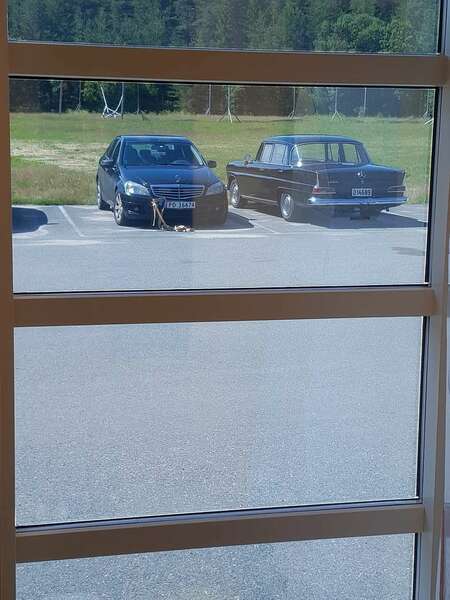

And on the way home I stopped at the local garage and booked an MOT appointment for this in August and the Mercedes met a younger sibling.

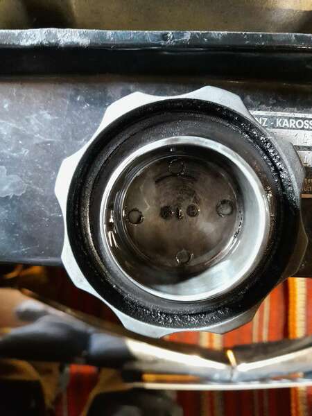

It got a real workout today with high speed and heat, so I'm curious about the oil level and the color so will check later when the engine is cold and all the oil is in the sump.
I've put about 160km/100 miles on this since the oil change on Sunday and things are looking promising now.
The oil level is exactly where it was in the middle and the oil is still clear.

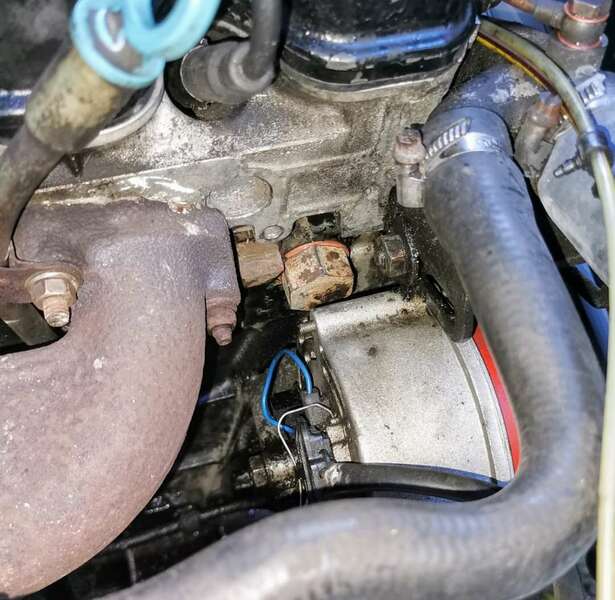

And this engine has no major oil leaks and is only  moist in some places.
The only place where there is some oil is on the passenger side  front of the engine but no drips. And not quite sure where this is coming from maybe around the big nut area in image 2?

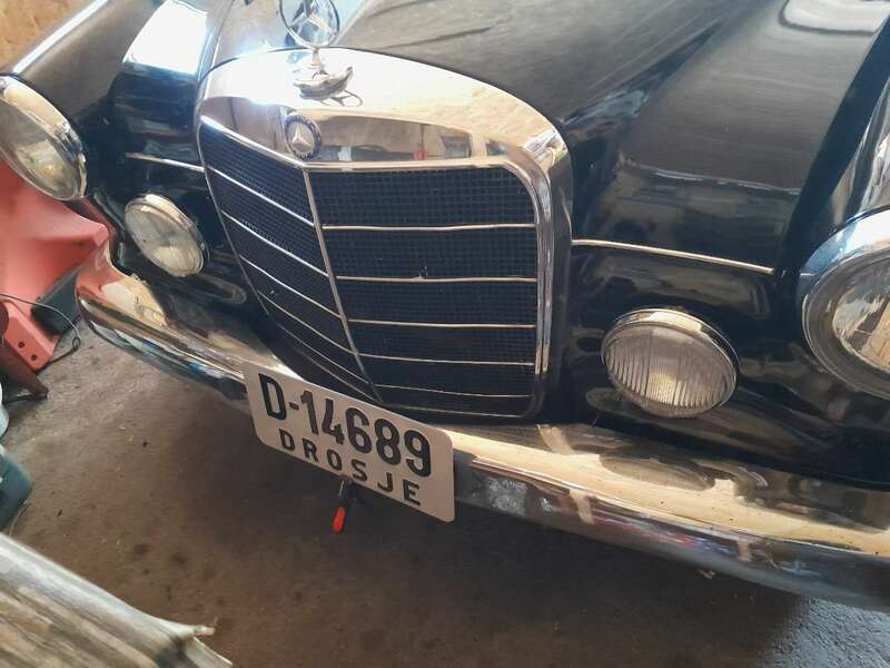

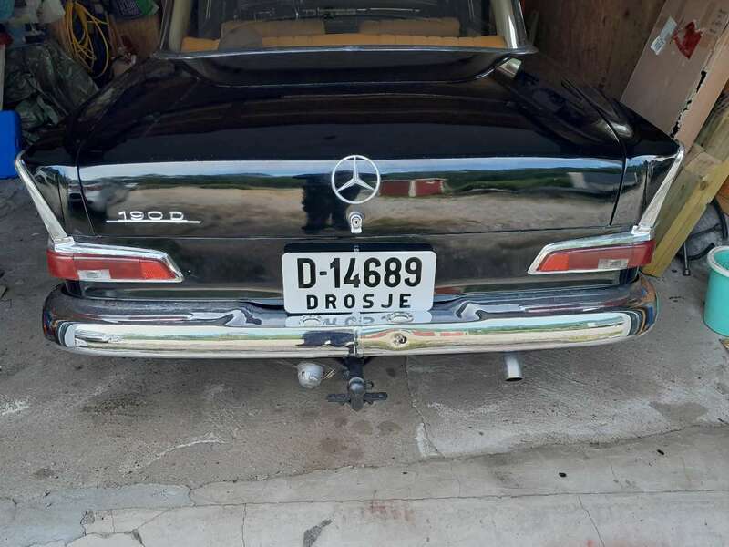

I got the original taxi registration plates that this one had in the post today.
And they are big, much bigger than I thought and after studying the old pictures, these new ones seem bigger than the old ones. I am not sure what I think, I may have to check if it is possible to get smaller ones.
And at the back, there is a problem that the registration plate attaches to the hatch for fuel filling and if these new ones are to be used, I will either have to cut a notch in it for the handle to the hatch or attach it to the outside of the plate.
What do you think?
  • Like 9
I like the intention behind the plates, but I think the size is intrusive.
I have checked and it is only these Drosje plates that can be bought now unfortunately.
That large nut looks not unlike the timing chain tensioner used on the W123, in which case it could be a source of the leak as it had full engine oil pressure behind it.  Wouldn't surprise me if it's a very similar setup given Merc's tendency to stick with designs that work.
The thought has crossed my mind that this could be the timing chain tensioner. So when you now also mention it, that's probably it.
And It's not a big oil leak, so it's probably best to leave it alone, but  there is probably a gasket or a o-ring there that's the cause for the oil leak.
