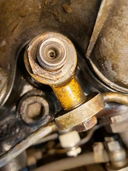

Maybe the injector fitting use an olive under the top nut to create the seal. Like this... (hopefully olive translates appropriately from English to Norwegian)
nutolive1.jpghttps://www.darwendiesels.com/search?controller=search&orderby=position&orderway=desc&search_query=olives
It is possible so will look for it when I disassemble it. Thanks.
The pipe ends appear to have conical fittings

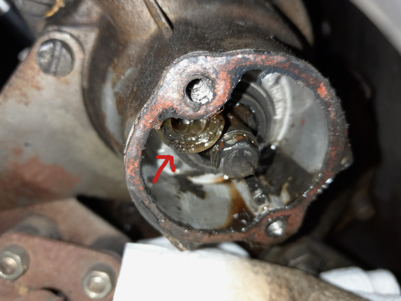

Had the leaking coupling checked today and found nothing clearly wrong but cleaned everything before putting it back together.
After this I tried to get out the bolt I put in where the oil leak is but this is difficult and is tight so gave up on this today. Then I started it and backed it out and let the engine run for 20 minutes and at the end at a slightly higher rpm.
And to my great surprise the oil leakage at the bolt seems to have stopped and the leakage at the coupling with the injector has also stopped, there is only a small drop there now which is almost not visible in the picture below. Marked with an arrow as usual.
But I wont  believe that these leaks have stopped until some time has passed without leaks. So now it's just a matter of getting the turn signal to work and I can drive it again. Will pick up the relay tomorrow.

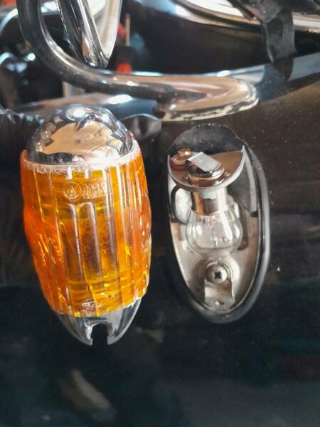

But one of the lamps would not cooperate so had to disassemble a bit of it and clean contacts. And these only have these big lights on top of the front wings as turn signals at the front.
And after that this light worked again and all the turn signals work on this car now.

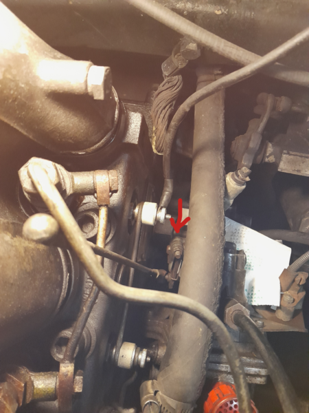

Disconnect the throttle linkage from the lever on the fuel pump. Then see what the maximum travel of the fuel pump lever is.
Reconnect the linkage and then get someone to press the accelerator to the floor, while you check that that moves the fuel pump lever to the maximum position.
This, but just to add that a strategically placed phone to video record the movement can get over the lack of an assistant!
Thanks. This is a good idea to check so I will. The linkages are among the worst parts on the car now as all the ball joints are worn out so there is a lot of slack in them and they are about to fall apart. I have replaced the 2 worst ones and was planning to replace the rest this winter. This makes me think, the ball joints I replaced were for the flap on the air intake, so it is possible that something is wrong here as well. But it's strange that this has a kind of throttle flap in the air intake, I didn't think that mechanical diesels needed this?
Are the brakes servo assisted? If so if they run on vacuum from the inlet manifold the flap is required to create the depression.
No, they are not. Are non servo drumbrakes front and rear on this one.
And I think this one has a vacuum pump like most diesels but I'm not sure but in that case wouldn't what you're talking about not be necessary?

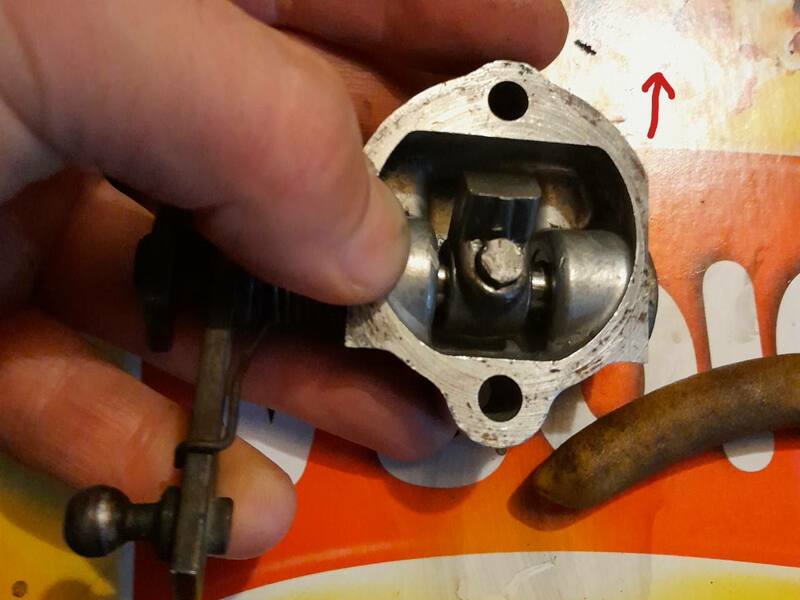

Had a bit of troubleshooting on this today and quickly discovered that the throttle on the diesel pump doesn't move as much as it should, so I took off the linkage and the throttle on the pump hardly moves an sticks and after moving this a lot in one direction it got completely stuck. The throttle on the pump is marked below and is not very easy to get to.
So since this is now really stuck, there was no other choice but to remove the rearmost part of the diesel pump where this system is. And when it came off, it was clear why it was stuck and not working as it should.
So after disassembling this and cleaning it thoroughly, I put it back together and greased it up. And now this works perfectly again.
Then I took a picture inside the diesel pump as it is impossible to see inside there. And noticed something very strange has marked with an arrow.
And this strange thing was this
a piece of a hose. How did this get into the diesel pump? I really wonder how this is possible. And I never cease to be amazed at what you can find on old vehicles.

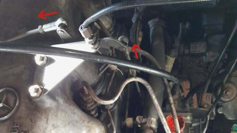

But there is a  problem I have discovered in all this and I desperately need help with this, so I hope someone can help and it will be a bit technical. I will make a separate post on that here.
When the Sabb (not Saab) engine in my sailing boat was not revving properly under load I took the governor to the local truck specialist for them to service. Half an hour later I had it back and my problems were solved. It was money very well spent :)
I have then discovered a problem after that in the post above that I desperately need others to look at and think about.
But first how the linkage to the throttle work when the throttle pedal is pused down. And this I have marked with arrows below.
So the throttle lever on the diesel pump must go up to increase the throttle and I have marked this with a red arrow below on the throttle part that came from the diesel pump. But this will cause the part marked with the blue arrow to go into the wall behind.
So something is wrong here. And on a parts diagram of this, it can look like something is wrong. The part marked in blue above is part 15a and 15b below and do you see what I see that this blue part is mounted incorrectly? Look at the mounting bolt to the part and the part.
1679413200_Screenshot2022-10-0418_02_06.thumb.png.4012965a1ad77278eb0aab8de6fd1112.png
What this part which I suspect is fitted incorrectly does is press on the part below marked in red and pushes it inwards also marked in red. And the blue is the stop on which that part should rest on when the engine is idling.
So is this mounted wrong or have I misunderstood? And post pictures below where I move this and arrows show the way that is up. And the first picture is full throttle.
And the picture below is idle.
So I don't know if I have misunderstood how this works and find it strange if this is wrong that the engine has worked at all. So I hope that someone can look at this and I hope that I have explained this well enough.

Your explanation seems entirely logical to me, although I am not a diesel specialist.
You are suggesting that the cam 15 is fitted upside down.  This will prevent it reaching full throttle.  It is surprising that anyone would do this, but it is possible.
 Since you have got this far, I can see no harm in refitting the cam in the position shown in the diagram and trying it.  Note also that the position of lever 16 can be adjusted on the shaft which may affect things.
Don't take my word for it though.  What do others think?
Thanks. This is exactly what I think the part is mounted upside down. And I think you're right here, but it will be interesting to hear what others think also.

Is that why there was a bit of hose in there? Basically somebody didn't realise the cam was back to front so put the hose in to operate the pump and give the car full throttle.
I'll concur that it looks like it's upside down. It looks to me that there's wear on the cam's securing bolt, so I'll suggest that it's worked at all because the diaphragm spring - part #13 in the diagram - has pushed the plunger up to the incorrectly mounted cam, and it's the bolt head it's made contact with.
Could've been like that a long time: neither part is massively stressed, and they seem from earlier pics to have been well lubricated.
If the bolt can secure the cam from either side, that might be how it's happened, and the means to rectify it.
Thank you both. And it's possible that's why there was a hose there. And it is possible to put in the bolt on both sides of the cam.
So tomorrow, unless someone says otherwise, i will turn the cam to the right way and then start the engine and see what happens. I am excited to see what will happen then.
Make sure you have a means of shutting it down in case of runaway when starting. I would suggest removing the air filter assembly and have a piece of wood handy to press over the air inlet so you can starve it of air. Will probably be fine, but better to be sure.
