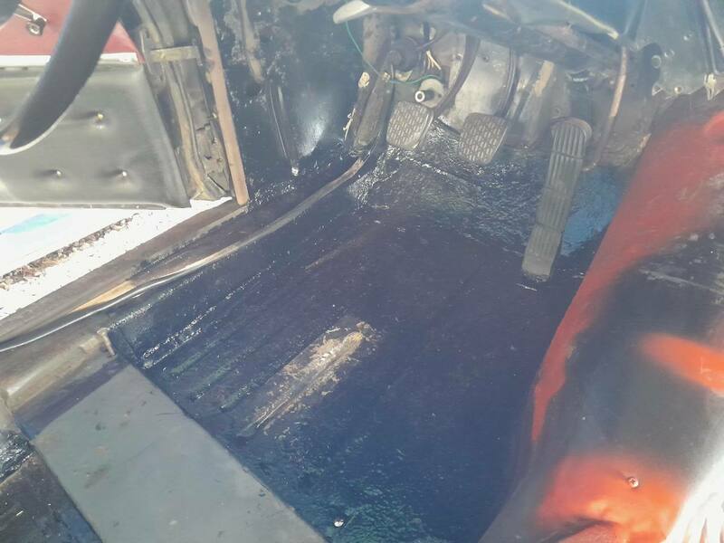

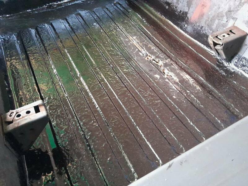

Things have been wild this past month and I've been pushing hard to get as much done as possible with this one and now I've run out of weather and money  it's time to calm things down.
And I have realized that my welding will never be at the level this one deserves so I have decided to get someone else to weld the 2 holes in the floor. But this will have to wait until spring as I can't afford it now.  But I have painted the floor, excluding the areas around the rust holes, with 3 layers of Por 15 and I am very happy with the result.  And the red is all the places where I exposed metal when I scraped away the sound dampening materials and the reason why I didn't use Por15 there is that it probably won't stick as well to clean metal according to several sources. And I also got some paint on the underside of the floor.
I have put a lot of trust in Por 15 on this one, so I hope it is as good as everyone says. And hope all this work I've done can keep the rust away for a while. I have also sprayed the inside of the cavitys and the sills with Fluidfilm I have good experience with this so that should calm down the rust that is there and it is not toxic or flammable so it should not cause problems for future welding if necessary.
