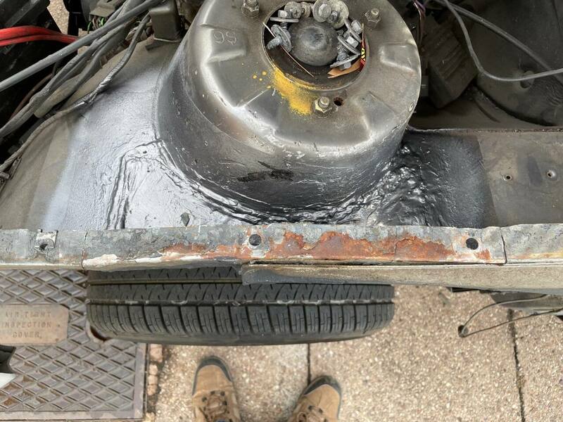

Nice tidy strong job with the welding tho.. did save yourself soem 440 quid on top too.
I just need to get a better hammer or some big adjustable pliars to bend this outward a fraction before I weld it back up.
Your repair is strong, the strut tower isn't going anywhere and that should last well enough.
Seal it up and carry on. Shame about the pressed steel tosspot.

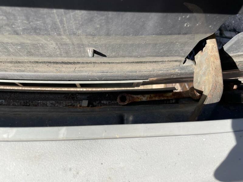

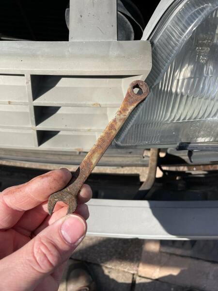

Both front wings are now off and away at body shop being repaired. To my surprise I found a 10mm spanner behind the front bumper!

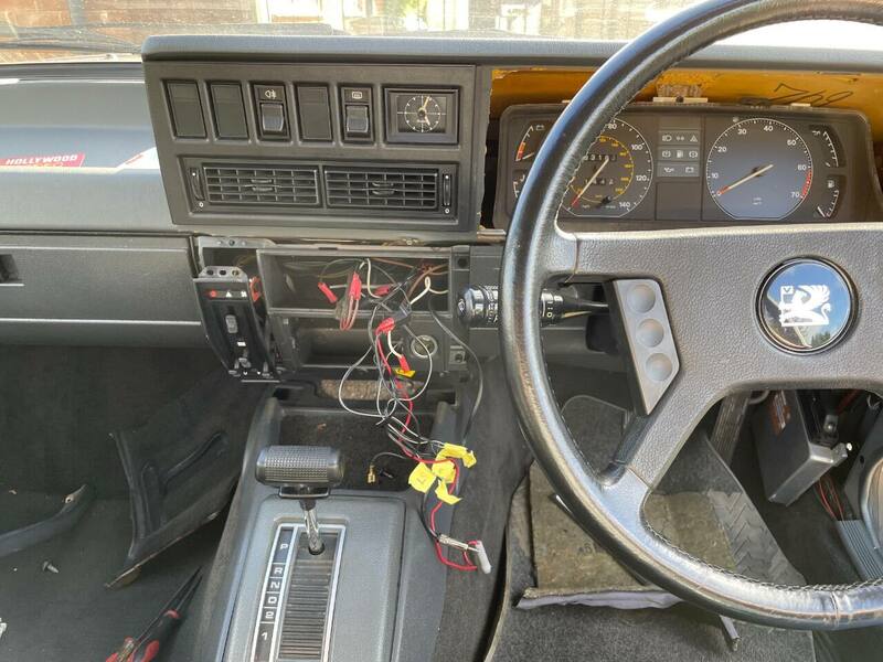

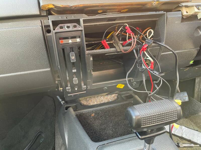

m the heater blower was seized, which I managed to get under the scuttle to free off slightly. It does now work off the switch but it draws a lot of power so I’ve bitten the bullet and started stripping the dash down so I can get the motor out and free it up properly.

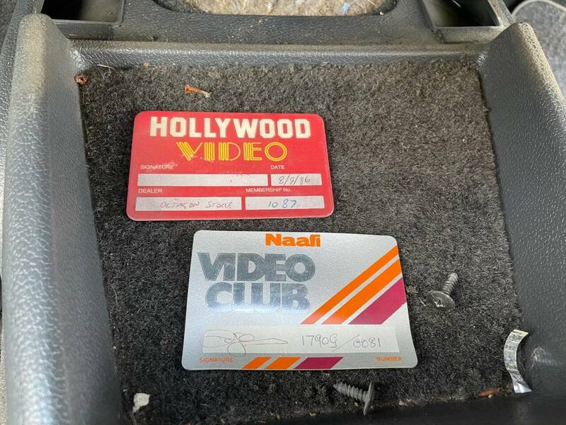

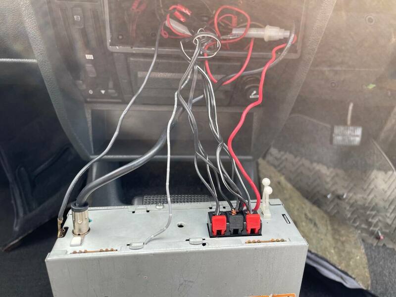

surprisingly found some old video cards, one from 1986. Must have lost that quick! And a naafi card, forces? E4284F45-EB7F-4BE8-82F5-EE7676050991.thumb.jpeg.261fda8f1fcfbb78e8486e966e7564c6.jpeg
NAAFI is recreational facilites for the armed forces and their families. The armed forces lot did seem to like their Carltons and Senators.
Navy Army Air Force Institution.
so father sutty says. So yes, entirely possible it was owned by someone in the forces. Fairly certain the 85 rekord was ex forces owned too.

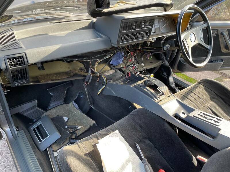

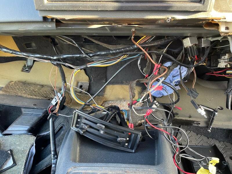

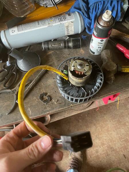

I finally got the heater blower out. It’s a shit job, well and truely. Half the dash comes out along with the heater matrix.

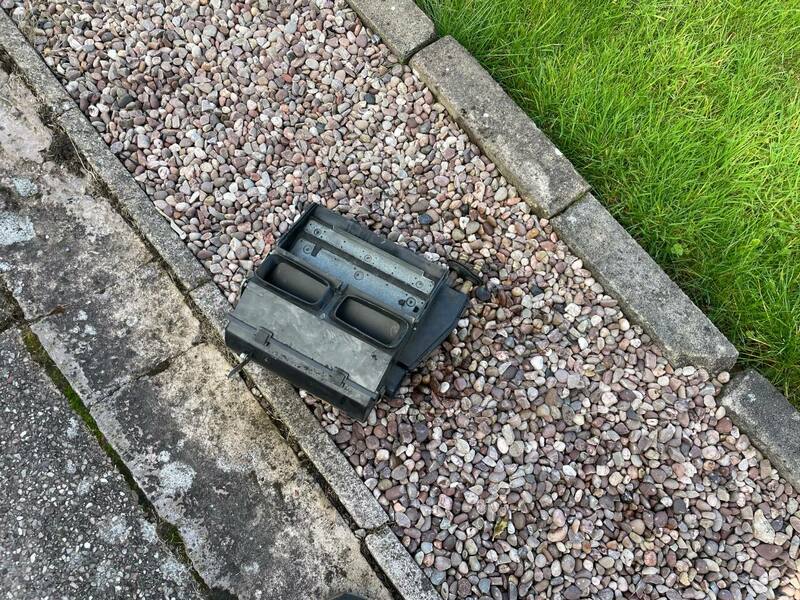

heater matrix exiled from the car.

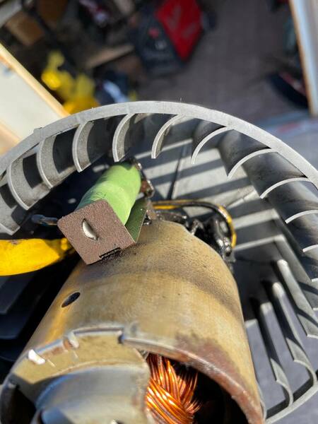

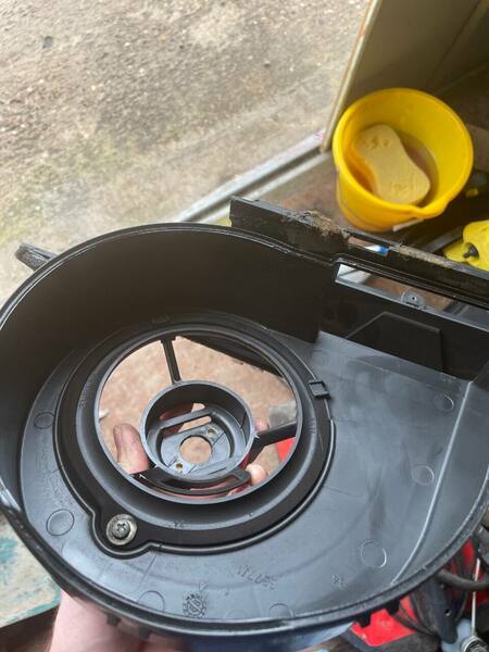

i think I’ve tried to dismantle these before without success. The last one I did didn’t go back together very well. But it’s freed off a little so I put it back in loosely to try. It only works on full blast. I’ve taken the switch gear out and cleaned the copper contacts up but it’s not loving life on the slower speeds. I set the slower speed on the switch, then poked the fan until it started turning. This then decided to fill the cabin with smoke. I think it’s broken. The green “resistor” ?? got hot. Finding a replacement is proving tricky. VERY tricky. Don’t really know what to do now. Other similar Vauxhalls blowers are either completely different or don’t exist any more. 666B79D8-4FF8-4332-976F-A88411BD4AA8.thumb.jpeg.6e0570b5e62fca991e0f51c3326b2baf.jpeg

I have tried to disassemble this and it’s not gone well. Getting the rear plate off was easier this time, but it seams it’s the inner bearing that’s seized. It’s fallen to pieces inside. So I’m now on the hunt for something to replace it with.

Is it a GM part? Any numbers on it?
its a delco part I think. no GM number on it.
Wonder if it’s the same as a Cavalier one….
No it’s different. Senator, royale, Corsa, nova, all different.

That’s worth a punt for 21 quid

Yeah found one for 19 posted. Bolt holes look similar but narrower, can deal with that. But the wiring up might fry my brain.
This item is a *straight swap into the heater box void [must be in airflow!] on my Carina.... Will give you all speeds 😉👌
