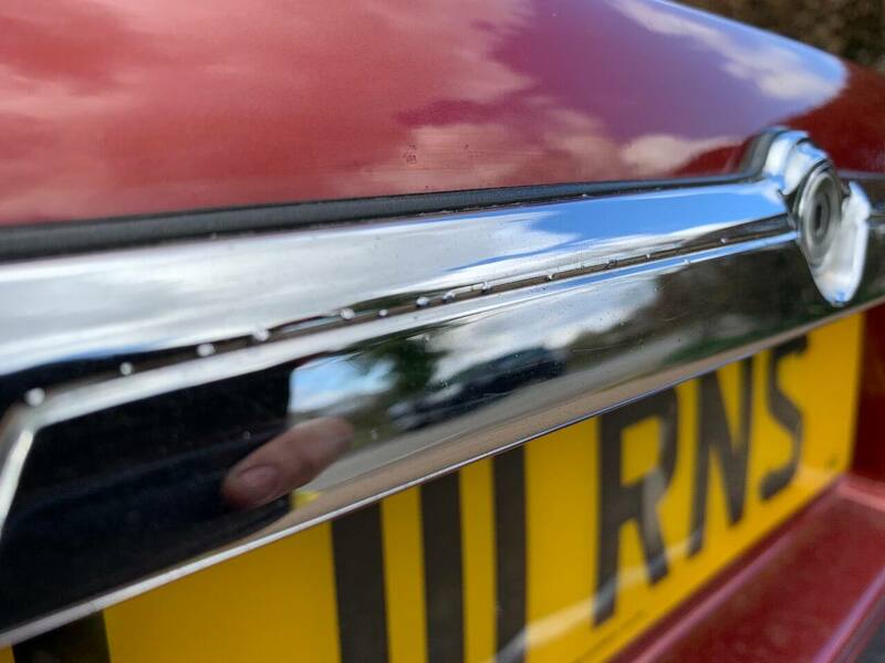

straightSix Posted May 25, 2022 Posted May 25, 2022 On 4/1/2022 at 2:36 PM, Carl1981 said: The boot lock trim was looking tired (up close) so I fitted the new one… what a faff, the boot liner had to come out. So did the number plate lights. The rubber between the trim and the boot lid has a life of its own, so you need about 7 hands to do this quickly! Took well over an hour in the end. so final prep is a quick wash… and now it’s snowing 🙄 a satisfying day of tinkering though! I think the xj40s are possibly my favourite Jaguars. Did you used to post over on xj40.com? Feel like I recognize the car

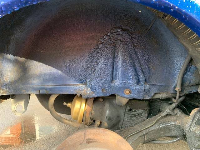

Carl1981 Posted July 28, 2022 Author Posted July 28, 2022 Finally, the Metro... I still love this car, gingercators and all! But she's proving to be hard work, I've had her just about one year now and have made many improvements in that time, but she hasn't been running properly, the MOT has expired, she's had to have a tickle with a welding stick and she's been overheating! It got that bad, I sent her to the naughty corner (MIL driveway) and forgot about her for a couple of weeks months whilst I tried to get my Metro mojo back. Welding in the rear arches is sorted now, Whilst finishing that job, I cleaned the arches out properly to ensure we'd found and repaired all the rot properly. I was pleasantly surprised by the condition... I've now touched up any chips or damage and painted the welded areas with the same zinc primer, stone chip, body colour similar blue and then two coats of black dinitrol. So I'm fairly confident she's solid now, and protected from the elements a little. Next on my list was the rich running and lumpy idle, unwillingness to run without a bit of choke etc. Fearing all my symptoms could be OMGHGF, I consulted my big book of knowledge... Took a brave pill and told myself I'm already a couple of grand into this car, she's not completely rotten, must be worth saving and a bit of effort, come on man get a grip! I thought I'd start by cleaning the carb as I have already replaced all the electrical service items within the last 300 miles. Cleaned everything I could get to without completely dismantling beyond the point of my confidence to re-assemble again. Whilst putting it back together I consulted the haynes manual for cause of rich running on these, the Haynes manual made reference to a vacuum hose and also a breather hose that if blocked can cause rich running. I checked the breather, fine. Started the car, it was better but not 100% and still wouldn't idle warm without a bit of choke. So disconnected the suggested vacuum pipe and the car settled down, this vacuum pipe goes from the carb to air filter housing and from what I can make out there is a temperature operated switch in the air cleaner housing that should switch vacuum between cold air from the filter and warm air from the manifold, the switch must be past it's best as the car tries to stall if you put your finger over the disconnected vacuum pipe and if you reconnect said vacuum pipe to the air cleaner housing. It's running properly better now, but some further investigation required here I think. Next up, overheating. I started with a drain and re-fill on the cooling system. I had to fit a new expansion tank cap a couple of months back as it was hissing when the engine was running and whilst cooling down, which I think was letting air into the system. I hadn't been able to bleed the air back out properly so a drain and re-fill seemed a good start point. Flushing through with the hose didn't see anything untoward flush from the system, and the rad was replaced just about 2 years ago, so I was fairly confident to proceed to refill. One thing I noticed when the car overheated last, just before coming off the road, was that the fan wasn't coming on. It works if you short the wires, so i suspected a faulty switch (or an air lock in the system). I decided the safest thing was to install an override switch in the dashboard. So if the temperature does head for the red I can switch the fan on if it isn't working automatically for any reason. All these jobs done, I started the car, ran it up to temperature and left it to tick over. It ran well, didn't need much choke and none when warm. Doesn't smell like it is running rich anymore. Fan cut in on its own when temperature reached 3/4, so I'm thinking it was an airlock, but I'll keep my eye on it. MOT is booked for Tuesday at 11:00, fingers crossed we can get her through and get back to a bit of metroing! I may even be able to get miles on it at last 😲 phil_lihp and Lacquer Peel 2

Carl1981 Posted July 21, 2023 Author Posted July 21, 2023 Good news for once this morning, the Metro now has a new MOT. Last years advisory on the rear valance became a fail, which the garage knew about and were going to repair today anyway. But now that repairs done the car has a new MOT certificate... Plus a new advisory for corrosion on the front floor, not terrible yet, but needs attention before it deteriorates any further. So re-fitting the rear bumper and getting the front floor cleaned up, painted and resealed look like jobs for next weekend. I have no photo's of the repairs yet as I can't get to pick up the car up until Monday, but i expect MOT repair quality welding rather than restoration quality, it's all hidden by the bumper so it doesn't make any difference really! Saabnut 1
bezzabsa Posted July 21, 2023 Posted July 21, 2023 picky MOT tester if he failed the rear valance......but good to hear its all legal again
