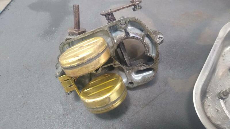

red5 Posted April 29, 2022 Author Posted April 29, 2022 So, 'new' carb arrived. I went on holiday because Easter and I'm a religious sort. However, air/fuel mixing device fun. Lid soaked - nice and gentle and wehey . Dick Cheeseburger, LightBulbFun, sdkrc and 1 other 4
red5 Posted April 29, 2022 Author Posted April 29, 2022 35 min later and some slooooow, gentle persuasion - one piston unseized from the accelerator pump chamber. Eventually. I'll take that as a win. Esp on a 40 + year old carb. chadders, Dick Cheeseburger, Dyslexic Viking and 9 others 12
red5 Posted April 29, 2022 Author Posted April 29, 2022 Little bit of brake cleaner and some rag-onna-stick™ GT85. Brake fluid. Piston gently re-introduced with special tool. 'Slow, skill shot ahead'* . Oh yeah...... LightBulbFun, Dick Cheeseburger, Mrs6C and 3 others 6

LightBulbFun Posted April 29, 2022 Posted April 29, 2022 1 hour ago, red5 said: Update, etc. 1 hour ago, red5 said: So, 'new' carb arrived. I went on holiday because Easter and I'm a religious sort. However, air/fuel mixing device fun. Lid soaked - nice and gentle and wehey . 1 hour ago, red5 said: 35 min later and some slooooow, gentle persuasion - one piston unseized from the accelerator pump chamber. Eventually. I'll take that as a win. Esp on a 40 + year old carb. 1 hour ago, red5 said: Little bit of brake cleaner and some rag-onna-stick™ GT85. Brake fluid. Piston gently re-introduced with special tool. 'Slow, skill shot ahead'* . Oh yeah...... 38 minutes ago, red5 said: See below - VID_20220429_152817608.mp4 41.38 MB · 0 downloads 37 minutes ago, red5 said: But more.... VID_20220429_153109327.mp4 7.43 MB · 0 downloads Woo! as always thank you very much for doing all this work and persevering when the going gets tough its very awesome to see the replacement carb is so far playing ball! even tho big al had done his best to make 1 good one from 3, I was still a bit worried about the serviceability of it given where they had originated from so I am very pleased to see you where able to get its accelerator pump working, and hopefully the rest of it too! NorthernMonkey 1
