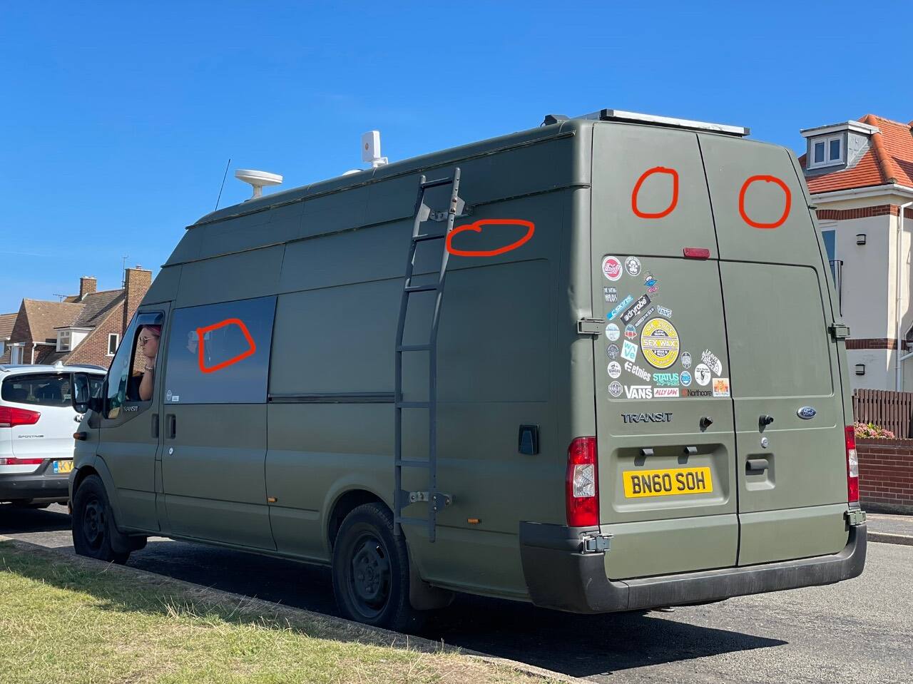

Can’t remember if I’ve mentioned here before but we’re desperate to get an opening window fitted on the drivers side but I just can’t get my head round how to install it with the van already being converted.
Usually you’d start from the inside with the bare wall, cut out from the inside then bond the window in, frame it and clad round it.
Im going to have to try and somehow make a stencil, cut from the outside, remove the metal which will then leave me looking into the van from the outside so I can then remove the insulation and somehow cut the ply lining out from the outside, I guess using a jigsaw or a multi tool.
Cant think of any easier way of doing it, removing the inside is not an option.
Very fine blade on an angle grinder/dremel type cutter? I think a jigsaw would snag and jump around quite a bit, particularly with the blade going into the insulation and cladding.
Obviously measure many times cut once.

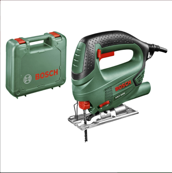

Not sure what these are called in English, but I have used these saws before with metal blades and they are quite good in car body work. The only thing that is probably difficult is cutting a perfectly straight line, but it will proberly be better with someone that is more patient than me.
1511836506_Screenshot2022-07-2908_03_09.thumb.png.0114c33067b16f60ee4c407131d095c2.png
That's a jigsaw, @Dyslexic Viking :)
A bit left field, but what about an oscillating multitool with a fine metal blade? I've found them to be fairly effective when I don't want to cut into whatever is beneath the cut surface. It'll probably be neater than a jigsaw if you take it slowly, and it won't rip up the innards quite as much. Do you know if there is any wiring etc behind the wall?
edit - didn't spot that you'd mentioned multitools already!
Reciprocating saw with a short ,fine blade ? you could even shorten the blade so there's only 10-15mm cutting length so it would be quite controllable
Thanks guys
yeah a jigsaw wouldn’t be top of my list as every time I’ve ever used one, they seem to try and veer off rather than cutting where I want.
Angle grinder or multi tool would be my top choice.
Im 99.999% sure there are no wires behind - there’s nothing electric on the wall that side and the lights on the ceiling don’t run that way so fingers crossed!
Any way of using a cutting disc in a machine with a guide like a circular saw, so that you can set the depth on the blade. Not sure if you can get a guide on an angle grinder or a cutting blade in a circular saw, but I hope you can understand what I am proposing.
I wouldn't really recommend using anything like a grinder as you don't know what the insulation is and whether being bombarded with sparks will set it alight.
I'd make a template, cut a rough access hole with a jigsaw and a fine blade a good few inches on the inside of your line so that you can see what you're dealing with and then open the hole out to suit.
The insulation is Kingspan so thinking about it, a jigsaw shouldn’t be too bad as it won’t grab like typical insulation would.
Aye, I reckon that's your best bet, get it as closeewith the jigsaw as you can and then use a grinder to trim up to the line.
TBH That's how we did them when I did it for a living.

Just as a guide remember that the edge around the window doesn't normally need to be that good a cut. There is normally quite an overlap and the trim covers the inside as well. Just in case you are worried about quality of cut.

Good shout re the edge actually, it’ll be boxed in with a frame regardless so hasn’t got to be perfect I suppose!

Re. cutting a window appeture: use self-tappers and maybe some glue/sealant to fix a guide rail to the piece you're going to remove. Butt the cutting tool up against it and viola, nice straight cut. Like so many jobs preparation is the key.

We have a list of things to do over winter, main thing being windows and ventilation. It’s just too warm in bed at night at the moment - luckily on sites we just sleep with the back doors ajar but we want to be able to wild camp next year.
Going to replace the sliding door window with an opening one, two opening porthole windows in the rear doors and two small opening side windows up high on the rear/side area so when you’re laying in bed, there’s a window to the side of you.
window plans:
That’s the main issue we’ve found, full timing in ours for the last 7 weeks. The heat a few weeks back was brutal - we’ve got two big roof lights that open, one with a 12v fan integrated, but there wasn’t anywhere to draw in cool air from low down in the van and no side windows. Grim!
Looks like a nice balance that you’ll have there - do you have any roof ventilation? We found there were some serious hot spots wherever there was stagnant air that had no reason to move. Looking great though, van holidays are awesome!
A decent roof vent is on the list but further down as I think it’s going to be a pain in the arse for various reasons - the only space will be towards the front of the van (in line with the side door) due to the solar panels, and the inside is obviously already insulated / ply lined / has electrics for the lights etc. One day though.
All we have are 2 small approx 6” extractor fans, mainly for when cooking.. they’re noisy too so never get used.
I think with a few opening windows we’ll be much better - currently we tend to leave the back doors ajar when we are somewhere safe and it makes a huge difference over being in a sealed box!

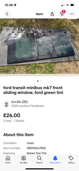

Just won an eBay auction for a window to go on the drivers side, this goes basically where the sliding door window is but opposite side.
Genuine Ford and opening too. For £26 I’m well chuffed.
