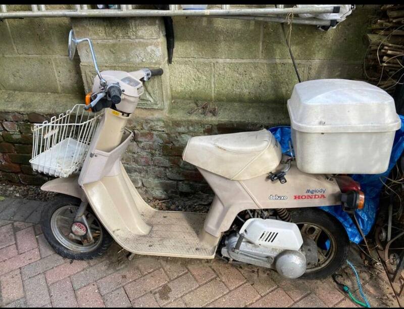

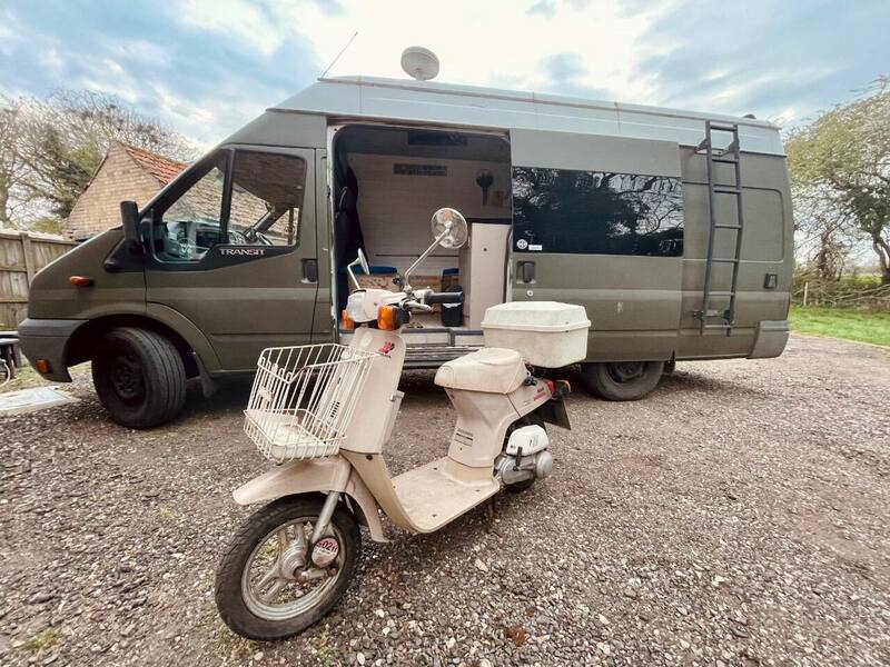

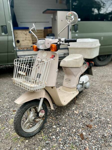

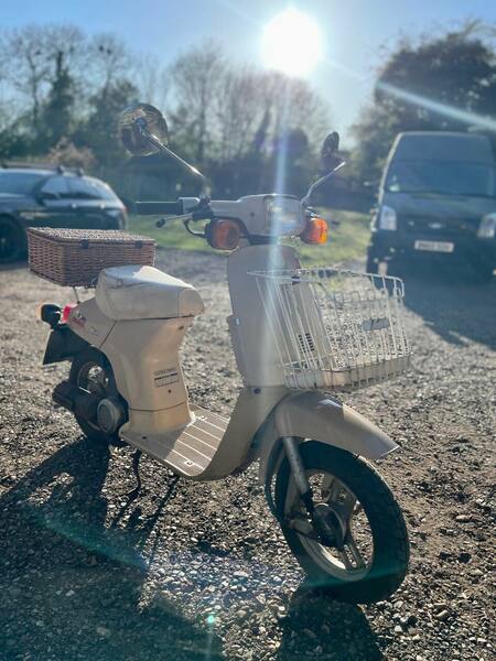

Tyres are knackered, turns over with a jump pack but obviously after being sat 10 years plus it’s never going to fire without at least a carb clean, fresh plug and fuel.
£100 well spent. Love it.

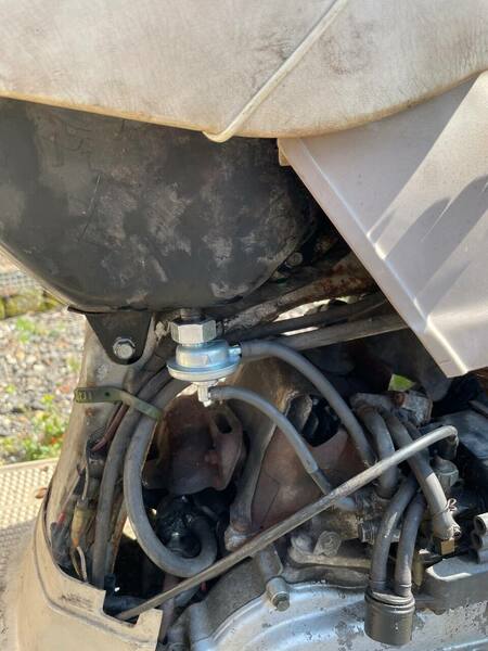

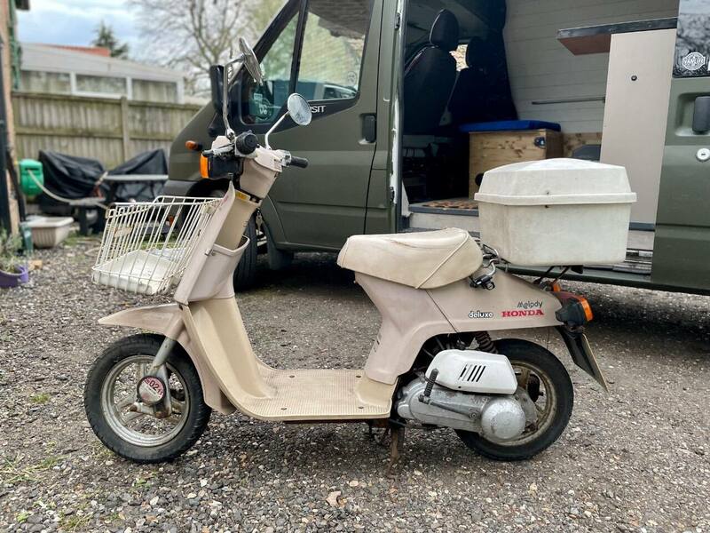

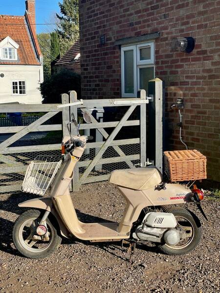

Drained the tank, removed the vacuum fuel tap as it was knackered
Second time it’s been started in 11 years. It fired as soon as I pressed the electric start the first time!
Throttle doesn’t do anything, cable is moving on the carb but the revs are just doing their own thing.
I’ve never stripped a carb before so I’ve got the choice of trying it or fitting a £13 eBay Chinese job. It’s definitely fuelling the issue at the moment.
I hadn’t blocked the vacuum line hence it revving out. Stuck a bolt in it and she’s away.
still no throttle so guessing something is blocked

New vacuum fuel tap fitted, throttle cable is broken but managed to ride it round through garden with 2 flat tyres and my left arm revving with the cable coming out of the carb.

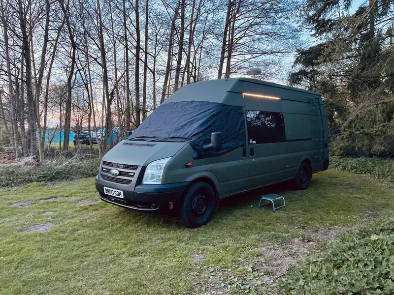

Trip out was a success. Even found a stall at a car boot sale selling John Lewis end of roll fabrics with enough to do the seat pads so got some for a fiver. Happy days. Hated that blue crushed velvet!
Sorting that front bumper out has made it look like a completely different van.
I must admit im chuffed with it. Last night on the camp site a chap came over and asked about the bumper and his wife said he had bumper envy 😂 it does look great in person I must admit and im not one to blow my own trumpet.

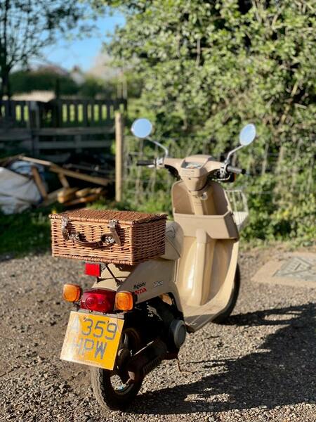

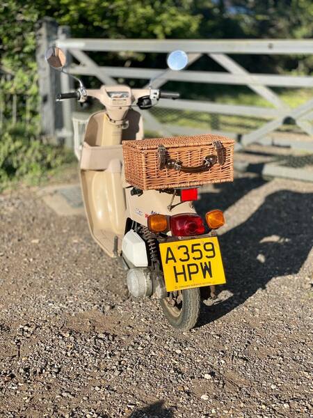

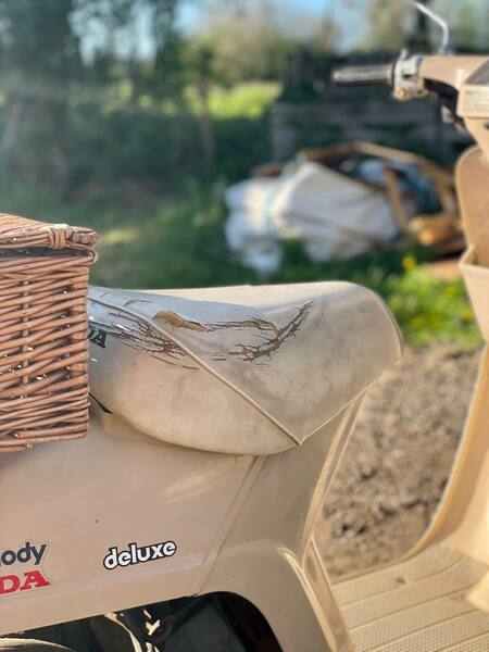

Got the Melody riding properly today, throttle is fixed, stuck a new plug in it and replaced the top box for a super deluxe wicker basket. Oh and got some air in the tyres.
Oil light is stuck on so must have a dodgy earth somewhere, Speedo doesn’t work and the indicator relay is sticky.
Getting there but plenty more to do. Progress is progress though!
