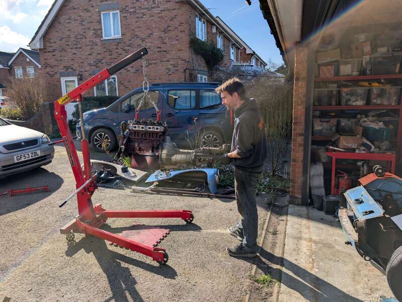

I have to say, the Midget engine/box came out without too much pain thankfully. While a hassle that you can't just drop the box to do a clutch change, once out everything is much easier to deal with.
PXL_20250301_122420974.thumb.jpg.0faa200baee5e95f1b2c29abeff20670.jpgPXL_20250301_122520700.thumb.jpg.3157b1ca5f8bc07f1dd46f192267dfe5.jpg
