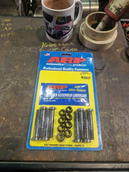

As some will be aware, the original conrod bolts failed whilst torquing up. Which wouldn't have been an expensive problem if I had standard conrods. But I have AEG521 conrods. Which are magic, highly sought after conrods. Which also don't take standard rod bolts. And no one sells the ones I need.
Enter MED Engineering who kindly relieved me of £150 (still hurts) for these beautiful magical things. Which are made of gold 😆. Sexy though

20240125_200702.thumb.jpg.c21d884afebdbecd19c580fcd7c13a81.jpgAll done. Sexy ARP goodness for 8000 RPM and big power!

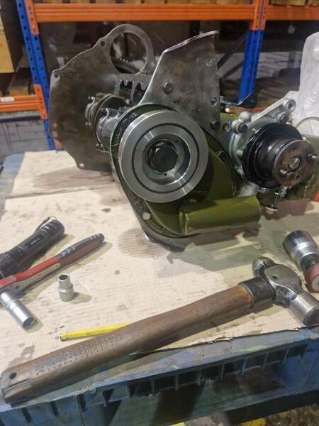

20240125_214912.thumb.jpg.508536f123ee39e7bdade202a36a0c13.jpgAlso removing household funds was the crank pulley which also acts as a harmonic balancer. Mine was cracked through the boss and had chunks missing from the flange so i couldnt in good faith reuse it.
I hope the new crank pulley does no cause problems. On one of my Minis I had the synchros replaced in the gearbox. Unfortunately the flywheel had spun up on the crank and had to be cut off. The replacement flywheel caused some horrible vibrations as the assembly had not been balanced as they did in the factory. It was a 1275, which are a bit more vibey than the small bore cars, but it was not a smooth as it was before the gearbox work.
Good work so far, and yes, those ARP bolts are big money, but then you wouldn't want a bolt dropping and making a mess of everything.

I'll be honest and admit that I didn't buy the dearest. They're surprisingly expensive for what they are. This one came from MGOC spares on line operation.
