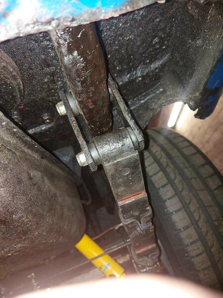

Starting at what I hoped would be the easy end, I've changed the rear telescopic dampers for Spax adjustable gas units. The reason for this is twofold. Firstly A40 teles are for some reason as rare as hens teeth. The club have just managed to bring some NOS back from Austrailia of all places! These were relatively dear at 50 quid a side. To be fair that has to reflect the cost to the club of acquiring them. However I figured that after decades sat on a shelf somewhere they might be no better than mine. The Spax ones were twice as dear but very much uprated and the damping rate is fully adjustable.

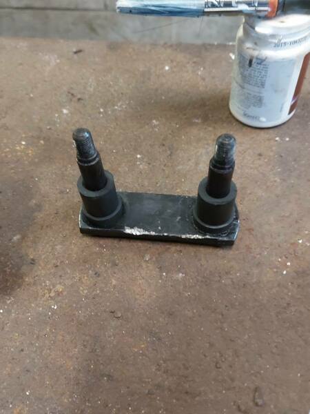

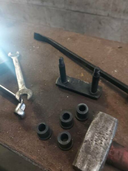

Whilst still at the back of the car, the bushes in the spring hangers were perished. I looked for poly items but it seems no one makes them. So new standard rubber ones from the club went in instead.

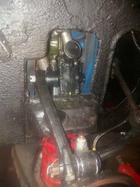

To the front. I bought 2 refurbished armstrong dampers from the club on an exhange basis. I figured this would save me time and having to take the car off the road while I did my own.
While researching on the Web I came across a firm called AJ Barnard. They make adjustable valves for lever arm dampers. Really clever pieces of kit they are a like for like replacement for the standard valves except instead of being a sprung full bypass valve they are a fully adjustable needle valve. All I had to do was drain and flush my refurbished shocks, refill with 15w fork oil and bleed. Then fit the new valves. Externally they look identical except for an 8mm hex on the crown of the valves. This is the adjuster.
As you can imagine the one under the steering box was a twat. Otherwise an easy job. I changed the top trunnion, wishbone and anti roll bar bushes to poly items while I was in there.
