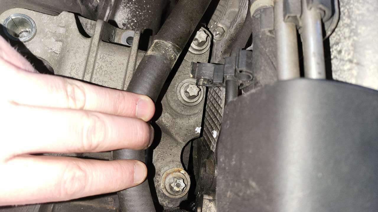

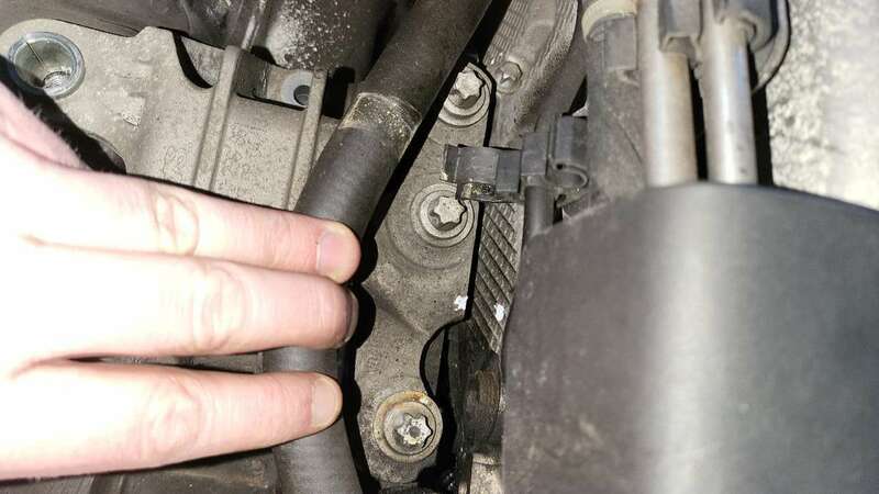

Don't worry too much about aligning them. You can make some marks to help you out but it's not crucial 👍
11 minutes ago, PrinceRupert said:
Thanks both. I don't really like disturbing engine mounts after having a nightmare relining them up on my 205 (and helped @wesacosaonce with a similar problem on his xm) but seems silly to put it into a garage for what should be relatively straight forward so will try and find some time next weekend to try again.
its not normally like it was on the XM! The engine canted back massively on that and quite heavy and the front mount had been disconnected for months so the other mounts had likely sagged a bit
Haha yeah i know i did two mounts on the 75 and it was pretty straightforward i just have this fear of getting it apart and not getting it back together (for some reason took me bloody ages to work out how to line them up in my 205, but i was a very very amateur home mechanic then (now only very amateur 🤣)). Way my drive is it also means the tvr is then stuck and atm would have no working car (well not that the tvr works 🤣)
Bought a Haynes manual and in classic Haynes manual style, it simply says "unscrew and remove the centre bolt from the crankshaft pulley".   No mention of the metal in the way ...
Also, it seems you don't need extra large circlip pliers for the Mk2, only the Mk1. Glad I bought a set. Wonder if they will ever come in useful ...

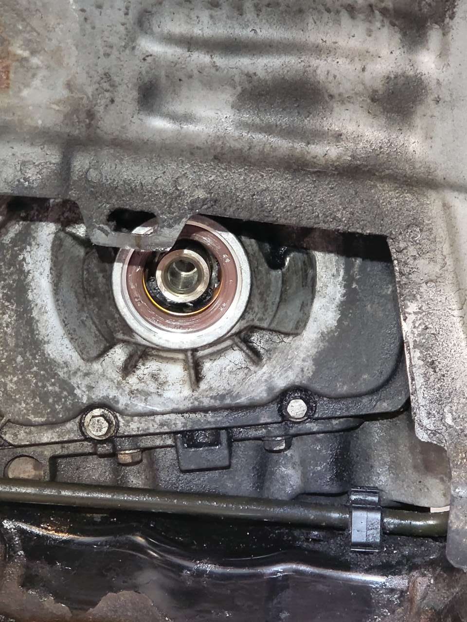

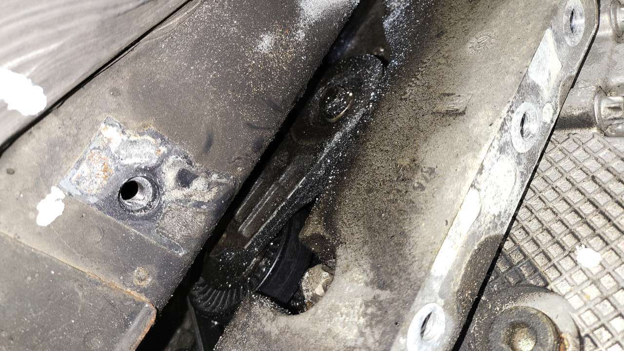

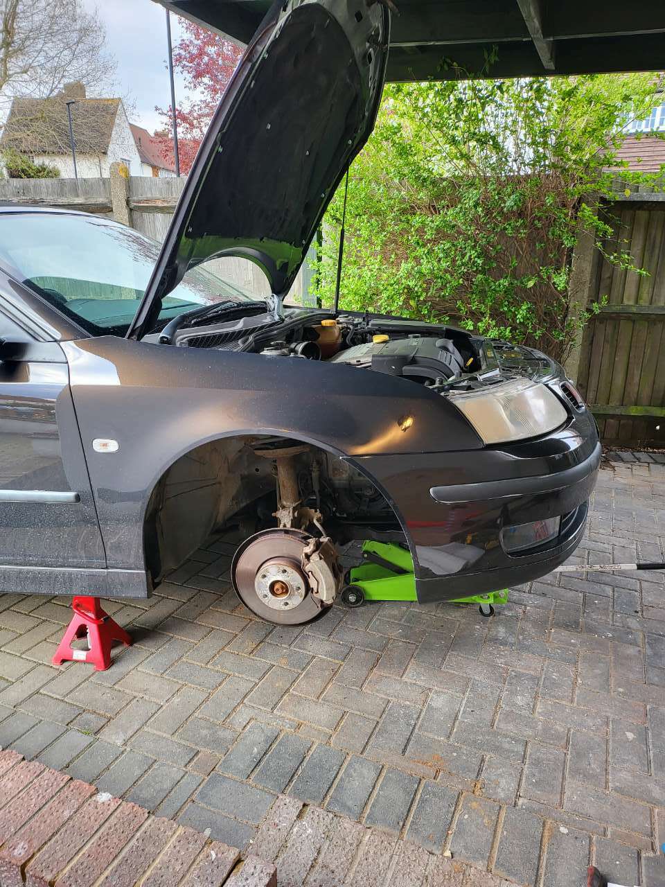

Tackled the front crankshaft seal today as promised.  Went okay, with a couple of snags.
Car in air, onto axle stands, wheel off, arch liner off.  Air box off, chassis cross brace off (eight bolts).
Support engine on jack, remove six bolts. First snag, three of the bolts were an unusual star shaped bolt I didn't have a socket for. Luckily @wesacosa came to the rescue, as he had a set in his garage.  Apparently a GM thing, why normal bolts wouldn't work no idea.  Marked a few alignment marks with tipex just in case.  Mount off, drop engine three inches.
Next snag, no special tool for the belt tensioner and a socket wouldn't fit into the square slot. However, managed to get purchase on the tensioner with a pry bar to release tension.
Belt off, very oily, gave it a quick clean and tried my best to clean the surrounding area but wasn't easy.  Locked crankshaft in place by selecting fourth gear and jamming brake with long bar.  Spun crankshaft bolt off with impact wrench easily.
Pulled seal out with seal pick, thing was very hard and broke apart.  Greased new seal, hammered in with a socket.  Crankshaft bolt in.  Next snag - Haynes send 100nm + 75 degrees. Got to 100nm with torque wrench but couldn't for life of me get further. Very little room for breaker bar.  Got it maybe 35 degrees round with impact wrench (950nm so pretty serious one). Managed to find a way to get breaker bar levered but it wouldn't tighten any more as the crankshaft just moved.  Figured it would probably be fine but views welcomed   ...
Getting aux belt back on was a pain, had to rope in a very unhappy fiancee to hold the tensioner with the pry bar whilst i got the belt back on. Belt got pretty oily, cleaned it up as much as i could but not much i could do.  Hopefully not likely to lead to belts quick demise?
Jacked engine back up, mount back on, bolts in and torqued to spec.  All went back together easily. By this time it was dark and had been at it all afternoon so time for beer and pizza and will put rest back together tomorrow. Hopefully nothing falls apart when engine is turned on...
Few pics below.
