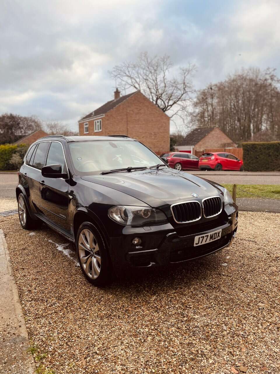

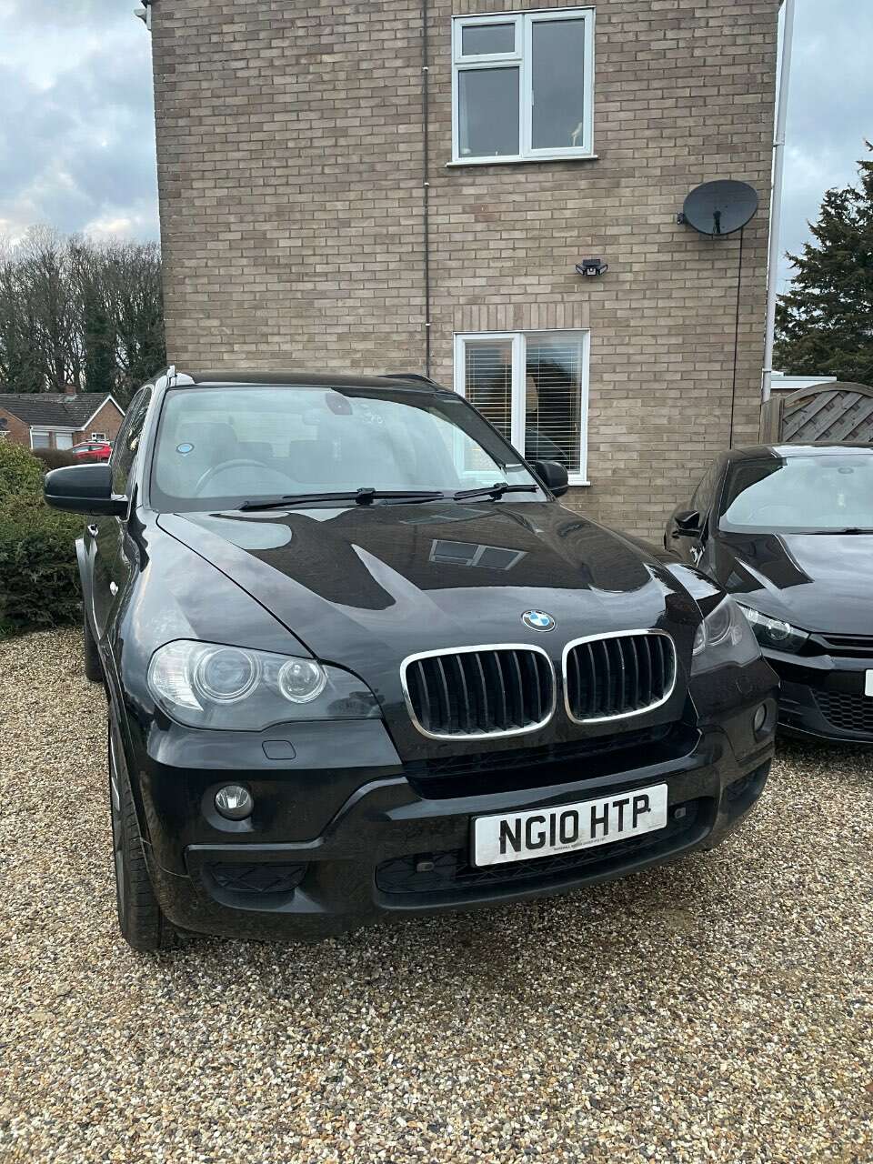

Fitted some black grills today but now they’re on I think I prefer the chrome so might revert back. Going to give it a week or so and see how I feel.
  • Sad 1
They're not the worst aftermarket grills I've ever seen but 99.5% of aftermarket efforts look gash so that's not saying much
Expand
No Msport flashes on them!
I think the originals would look about a million times better, but they're good for aftermarket grilles!

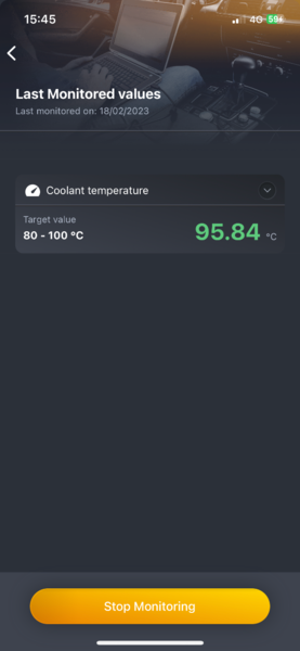

I changed the main and EGR thermostats today as the M57 is prone to them sticking open and then running very cool
It was struggling to get past mid 60’sC so replaced them both and it now sits at the perfect temp and my MPG went from an average of 22.4 to 29.1 in the space of 8 miles!

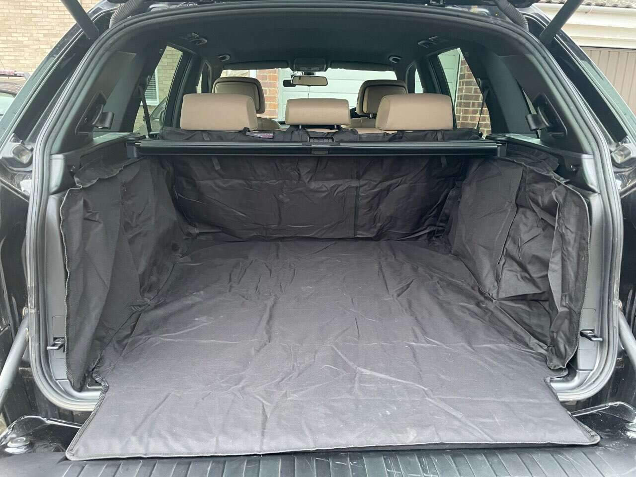

Dog hair proofed the boot tonight, had one of these in the 5 series, they’re expensive at £53 but worth it in the long run.
‘UK Custom Covers’ proper full tailored boot liner

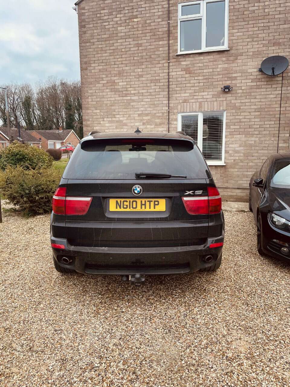

Finally got my plate on but now I look at the pic and it makes me think the black grill would now look better 😂 might give them another try. Cars filthy so will give it a wash then decide.
Rear plate looks too small to me and would probably look better full-sized, in my opinion, don't put the black grilles back on 😉
  • Like 6
Expand
Expand
I think the rear looks weird because the cars filthy but I cleaned around the plate to ensure it had a decent surface to stick to, will see how it looks when the whole thing is clear - I may well get a normal size set made up but for this reg I currently only have these plates made up unfortunately!

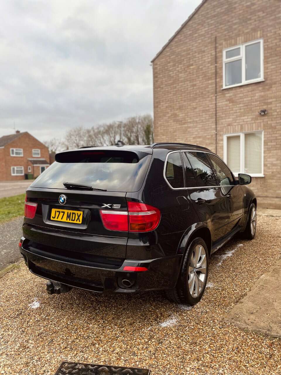

Got all my work hours in early this week so had time to wash it today
BMW paint always seems to clean up well. Plates look better now it’s all clean IMO but I may eventually get a set of full width ones. Probably not in all honesty as I’ll likely sell the car in 6 months when I get sick of the MPG 😂

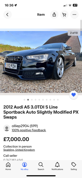

this has also caught my eye and will be a more sensible 35+mpg
Why do I do it to myself ffs
