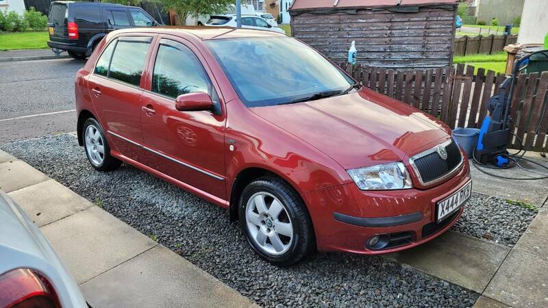

I often canny be arsed writing long update post things on my phone... and this post is no exception. So I'll keep this brief. Nothing new really, a little bit of screeching at the car, low MPGs, and just pottering about really. This here will be a vague attempt at being in a chronological order, or so I tell myself in a blatant lie.
We'll take it from the top...
New tyres... Falken Ziex Ecoruns. Weird name, but absolutely class tyres, you can hear more broken/loose things. I also don't feel like the car is going to skid massively now. Meaning clean trousers for me.
MAP Sensor... following on from previous drama with MAP sensors, I managed to procure a known good one that had been plugged from a BME code engine that had cacked it's timing at 170k miles. That side of things is running fine now, performance is back. However, fuel economy has nosedived... again.
Now got a replacement pre-cat lambda sensor (NTK/NGK) to try on this car as it was also reporting dodgy figures. Hopefully I'll be able to see MPGs that are above 40 again. Will be fitting this on Sunday, hopefully.

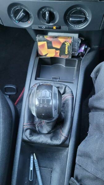

CD Changer... following on from acquiring a VW Gamma stereo, I purchased the matching in-dash 6 CD changer, because I'm down with the youth of today and that. Doesn't fit right, so will have to investigate why, but it sits nicely enough and works. So job done-ish.
Cup Holder Hing... procured a cup holder from the same guy who sent me up the MAP sensor, a wonderful chap from Briskoda. It replaces the ashtray, it's easier and cheaper to have a cup holder rather than taking up smoking... 🤣
I'm a sucker for OEM accessories, so this is nothing new.
Squeaky clean... as seen in the 'what makes you grin' thread, I cleaned my car. All proper, like, innit.
Interior still needs some work by way of cleaning but I'll get round to it eventually.
